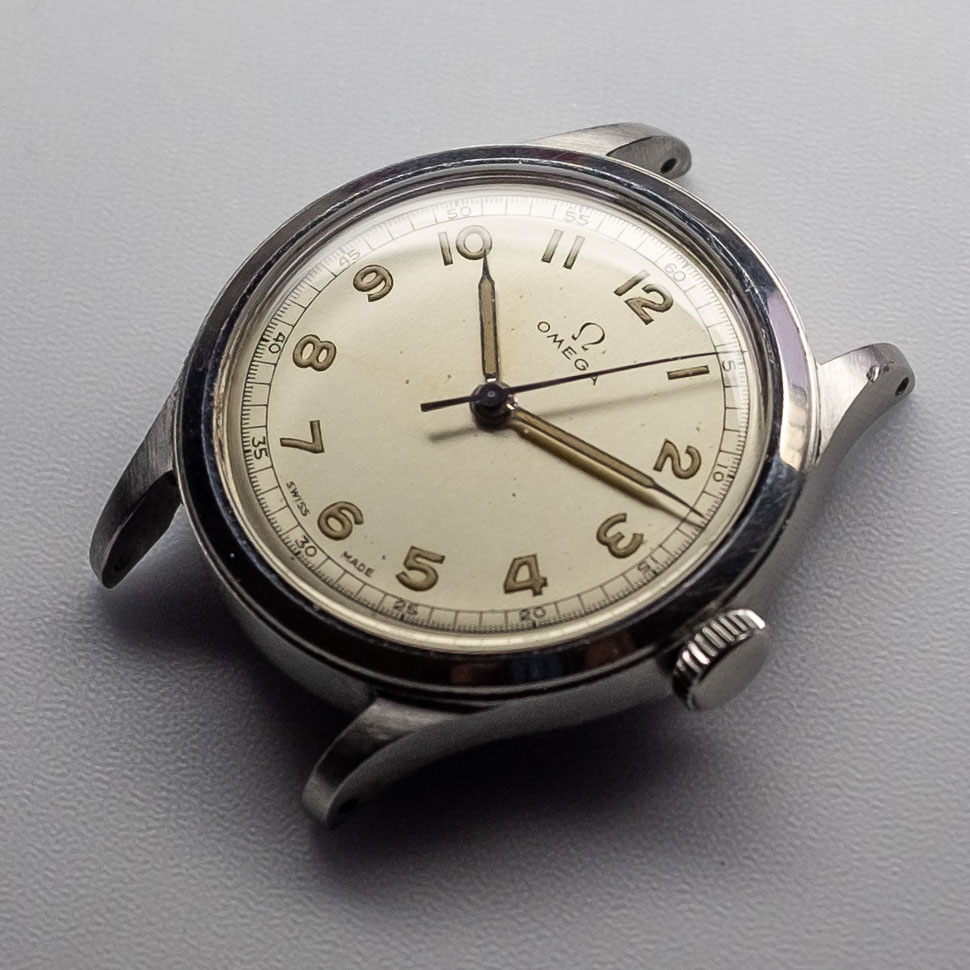

I'm thinking about offering this "1930s Omega Cal. 26.5 SOB T2, 30.5 mm" to my wife. Looks good to me. I have some doubts on the hands : are those original to the watch (relumed for sure but is the shape correct ?).
The movement number put it in the middle of 1934 to 1939.
Here are some pics :
Does everything seems legit to you ?
Looks nice. Every help appreciated.
4,035
45,496
Bonjour... Not sure about this. Would you have better bigger pictures? For sure the hands are newer, not only relumed.
They seem too big (long), what the size of the watch ? 30mm?
EDIT: I'd say it should have blue hands instead (non lume) and not sure about the crown either.
The resident experts will advise you more and better
8,264
29,207
I agree with the above. Larger images are required to judge the dial, but neither the lume, nor likely the hands, are original.

Here are the only pics I've received. Your comments comfort me in the fact that the hands do not fit somehow. The seller mentioned they have been cleaned and relumed but that they are original.
Looking at Omega from the 30s I've not seen similar hands but it's not clear what would be the correct ones either...

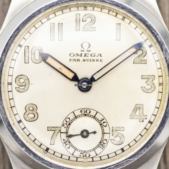

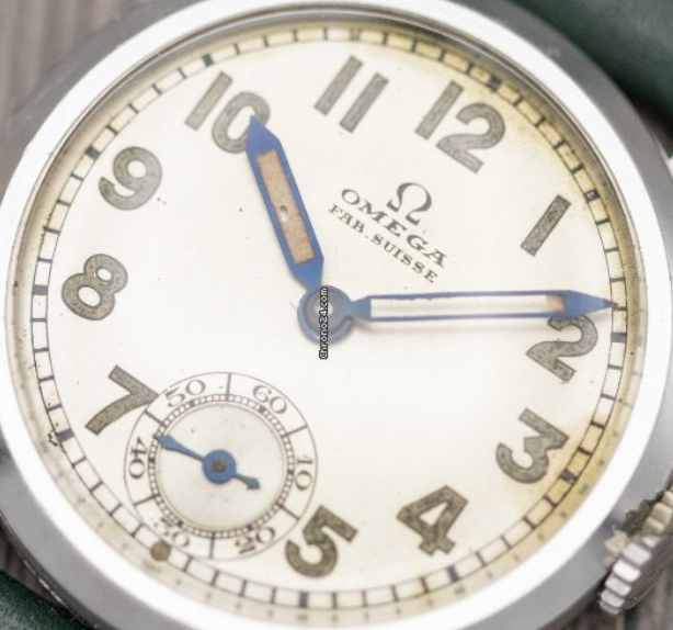

Looking at your original photos my best guess would have been redial because that subdial script shows up on a lot of redials… but it’s always fun to dig deeper.
Here’s a better picture of the dial from google.
Here’s an older picture of the dial, also from google.
The dial appears original to me.
It seems an artist tried to lighten the lume with an overpaint? Could be the photos… light changes everything.

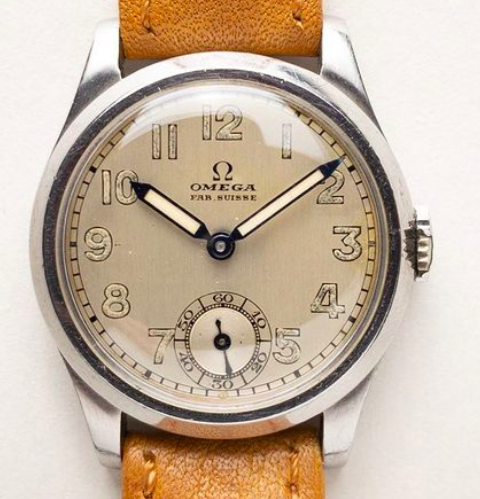

The seconds hand on your watch @YYTIN is absolutely standard for a cal26.5, the tip is missing but it may have been paired down originally. The minute and hour hands may well be original as well, I’ve seen that style installed on plenty of radium Omegas.
1,349
3,736
Hi everybody,

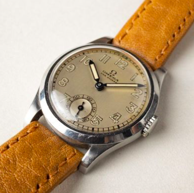

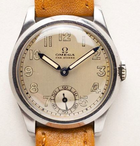

The hands of the watch shown by YYTIN are perfectly right for this model and period, and the dial looks fine and not repainted to me (as far as one can judge on a picture). Thinner hands appeared later.
This model is a ref 816, probably one of the best selling 26.5 models. It remained at the catalog for a long period and based on the number of them that still can be found today, there must have been a large production. Like most of the Omega production from this period, it was manufactured with variations in dials and hands.
Here in a 1938 catalog with the exact same dial/hands combo :
Here is one of mine with luminous (but different layout no 'Fab Suisse' under the logo but swiss made at the bottom) dial and hands that have lost their radium :
Another one of mine with the same dial as the OP but in a non luminous version (and a wrong crown) :
I don't resist to post this third of mine wit a nice two tone dial :
I really love this model, I have accumulated an unreasonnable number of them.....
