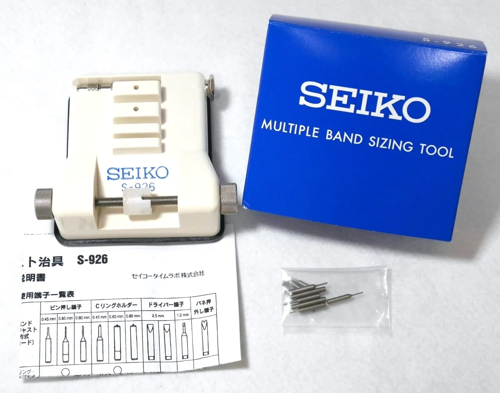

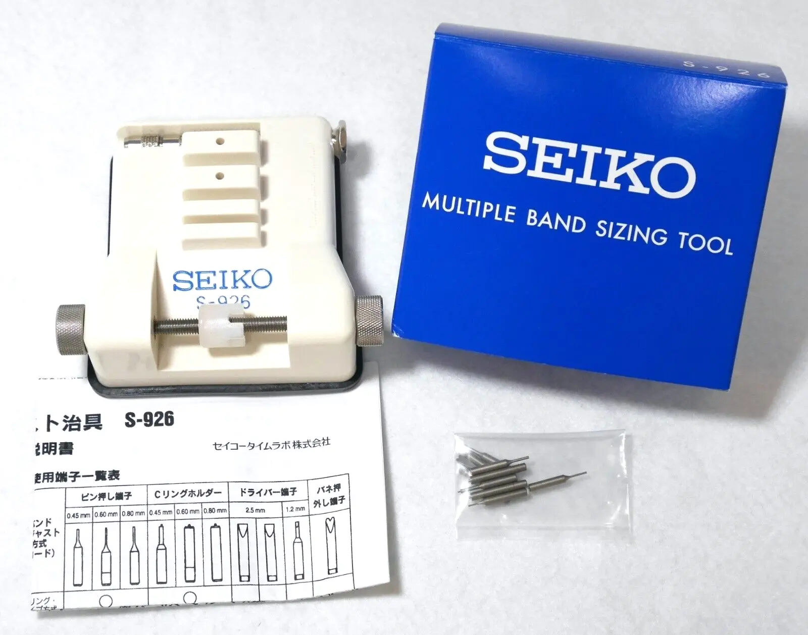

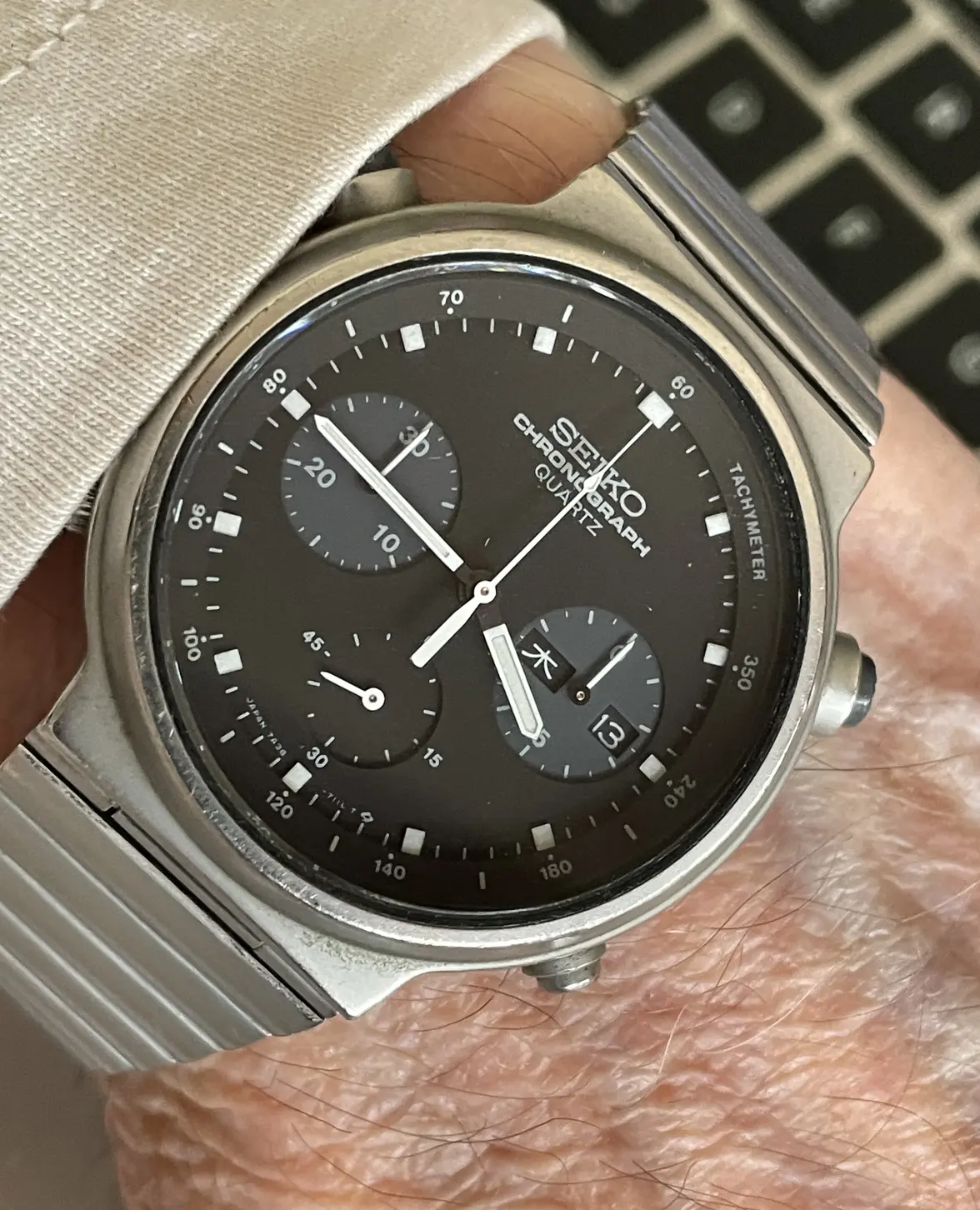

Just had to find new pins and collars for my Seiko Speedmaster (bracelet to case connection).
Took ages to find them. Eventually found some in Houston TX for USD$6 and got them shipped to Australia (SUD$20).
Took five weeks to get here after travelling from Houston to Elk Grove Village (Chicago) to Australia, then to The Netherlands and back to Australia.
Found it was very handy to have a Seiko bracelet tool to do the installation too.
Also had to do bracelet sizing with a pin/tube bracelet for my Grandson. It's not a bad system but you need the right tools to make it easy.
Anyhow, I can now wear my Speedmaster without worrying about it falling off.
Now I need that Seiko bracelet tool!
