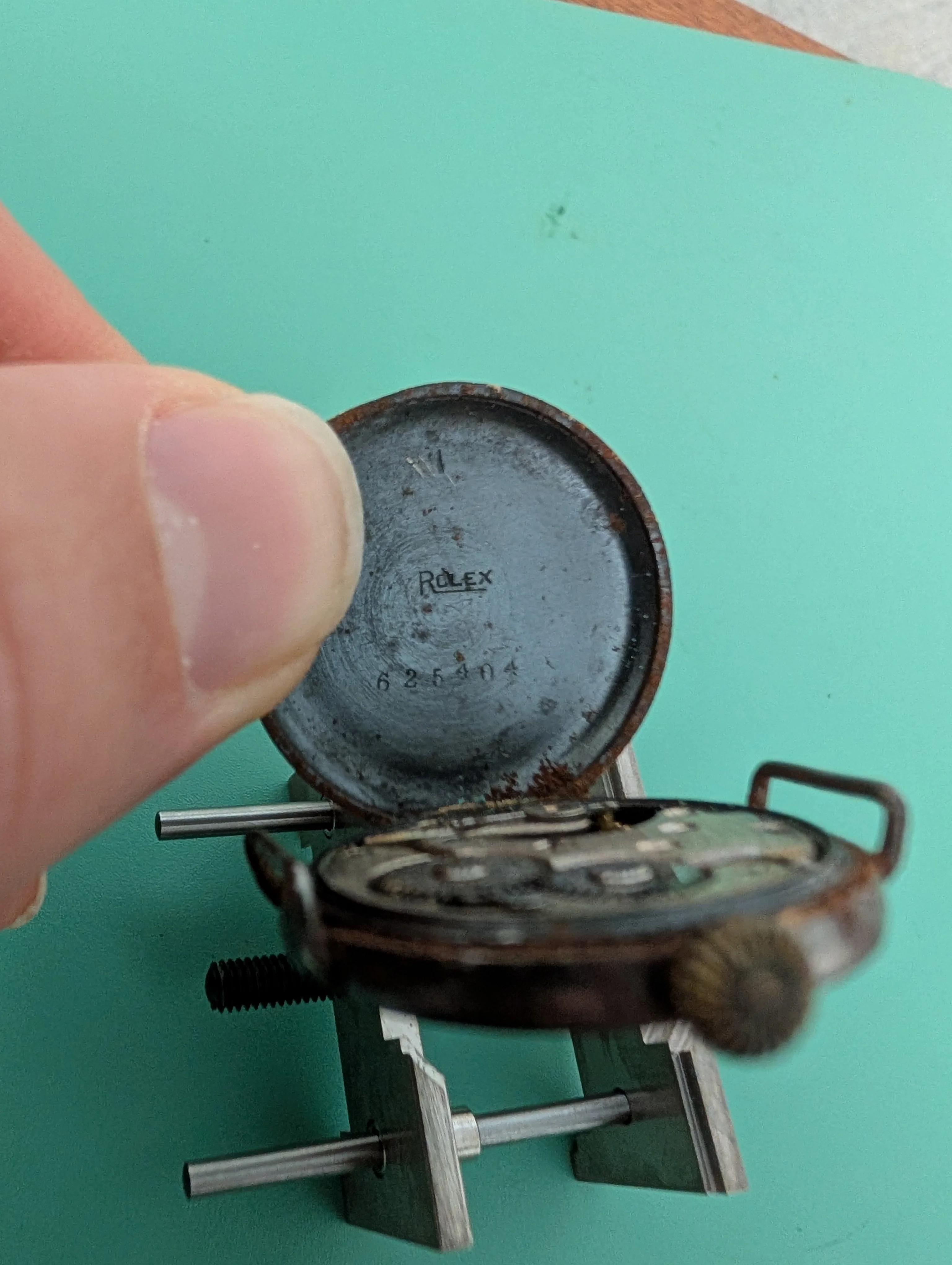

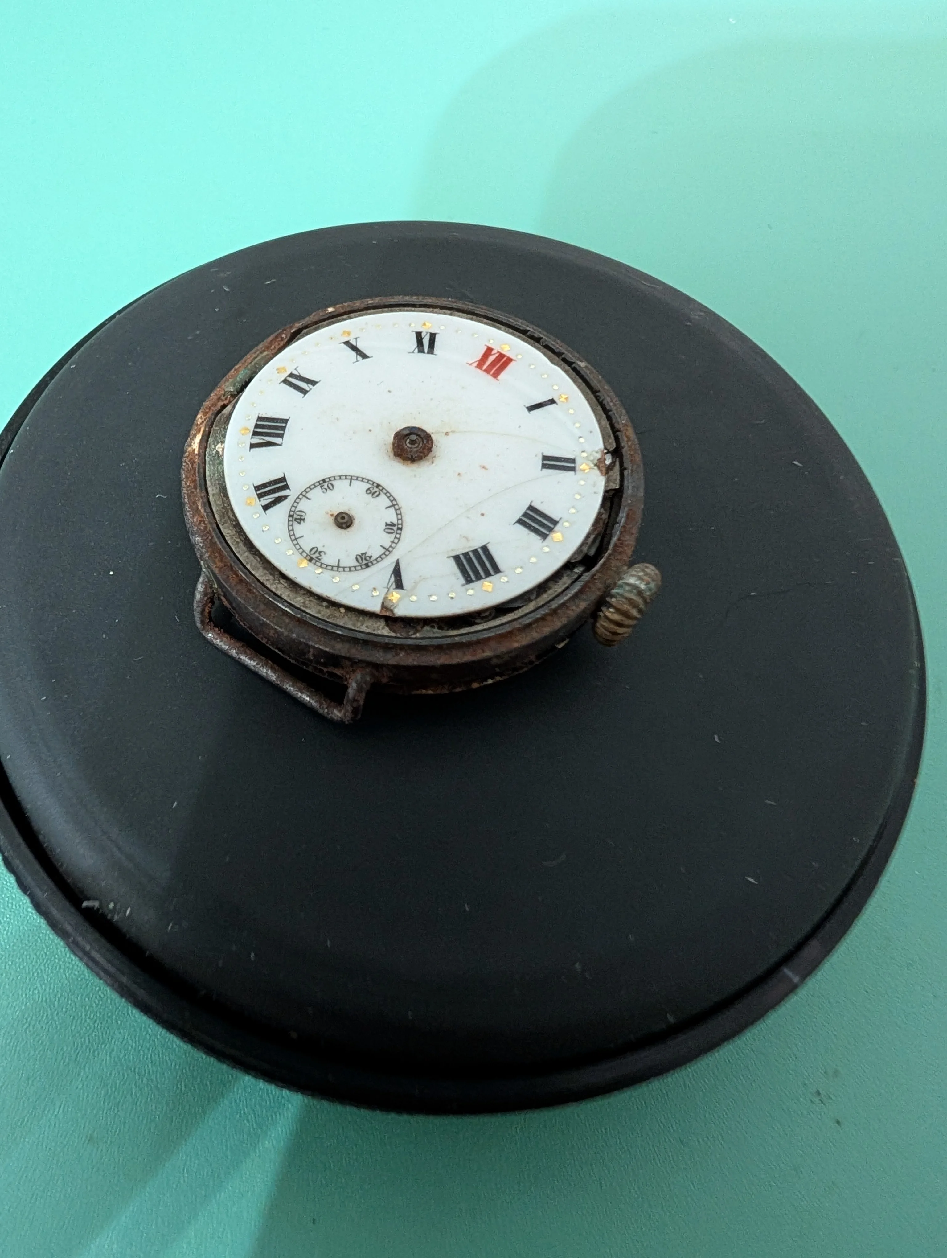

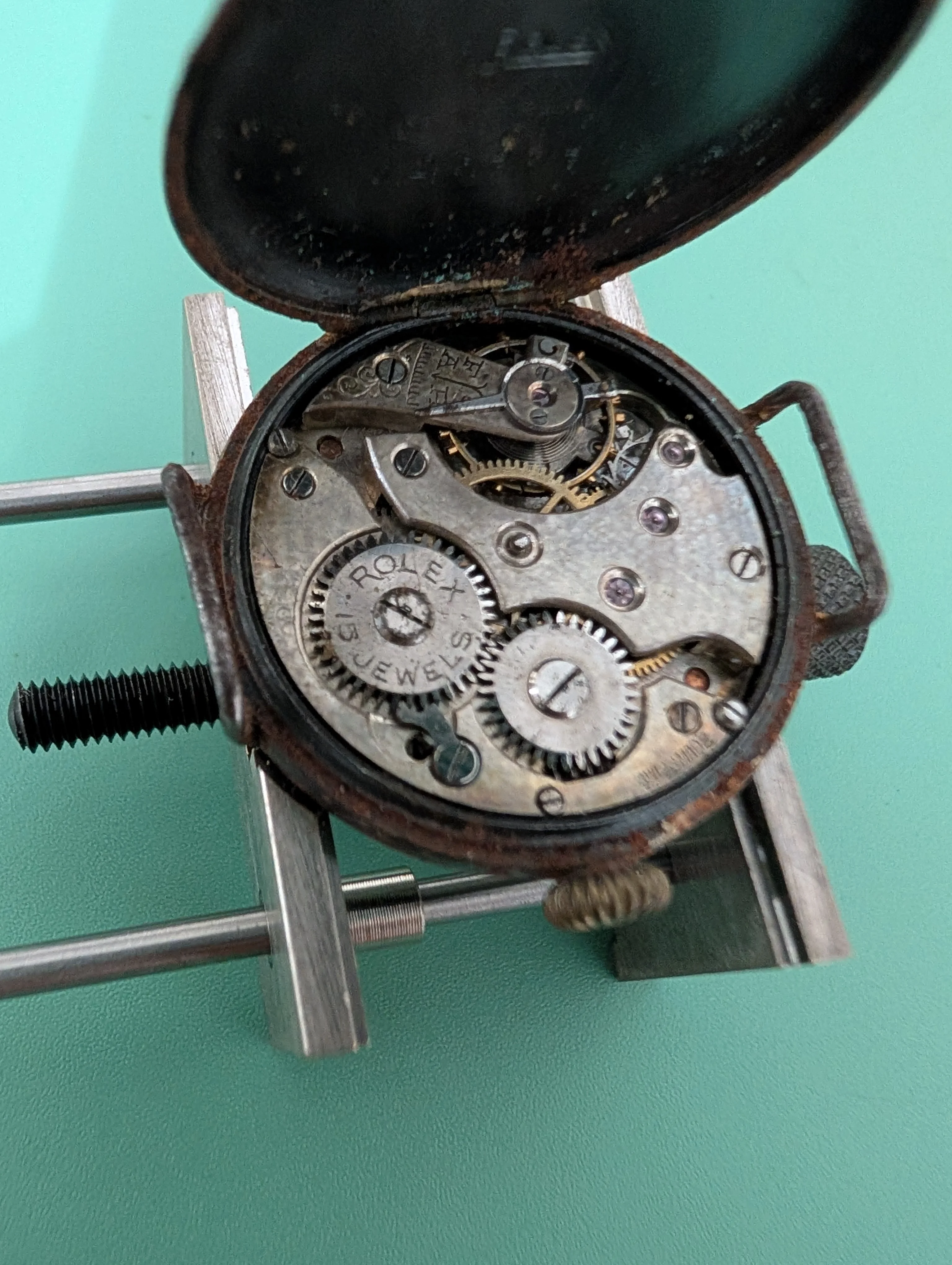

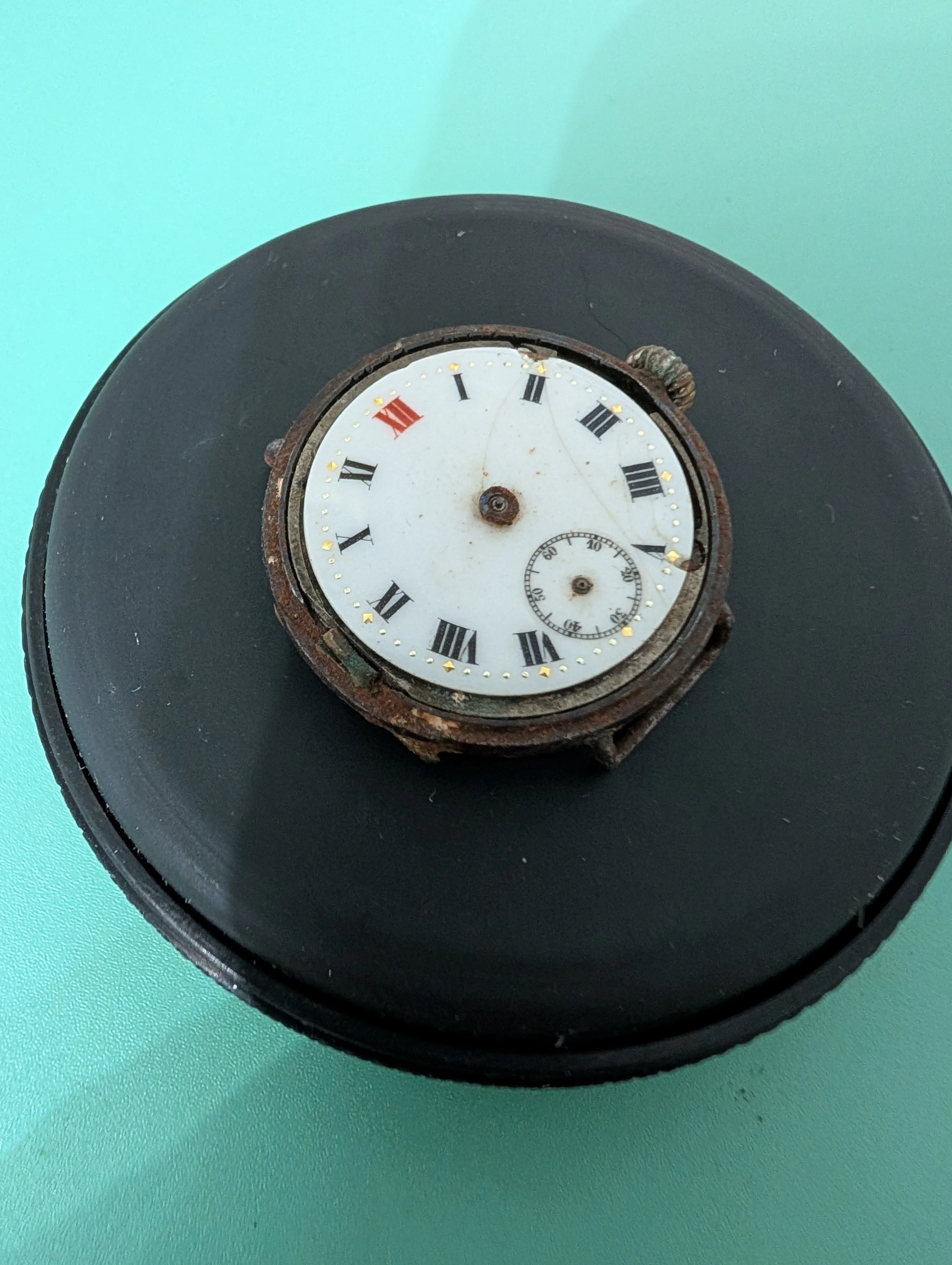

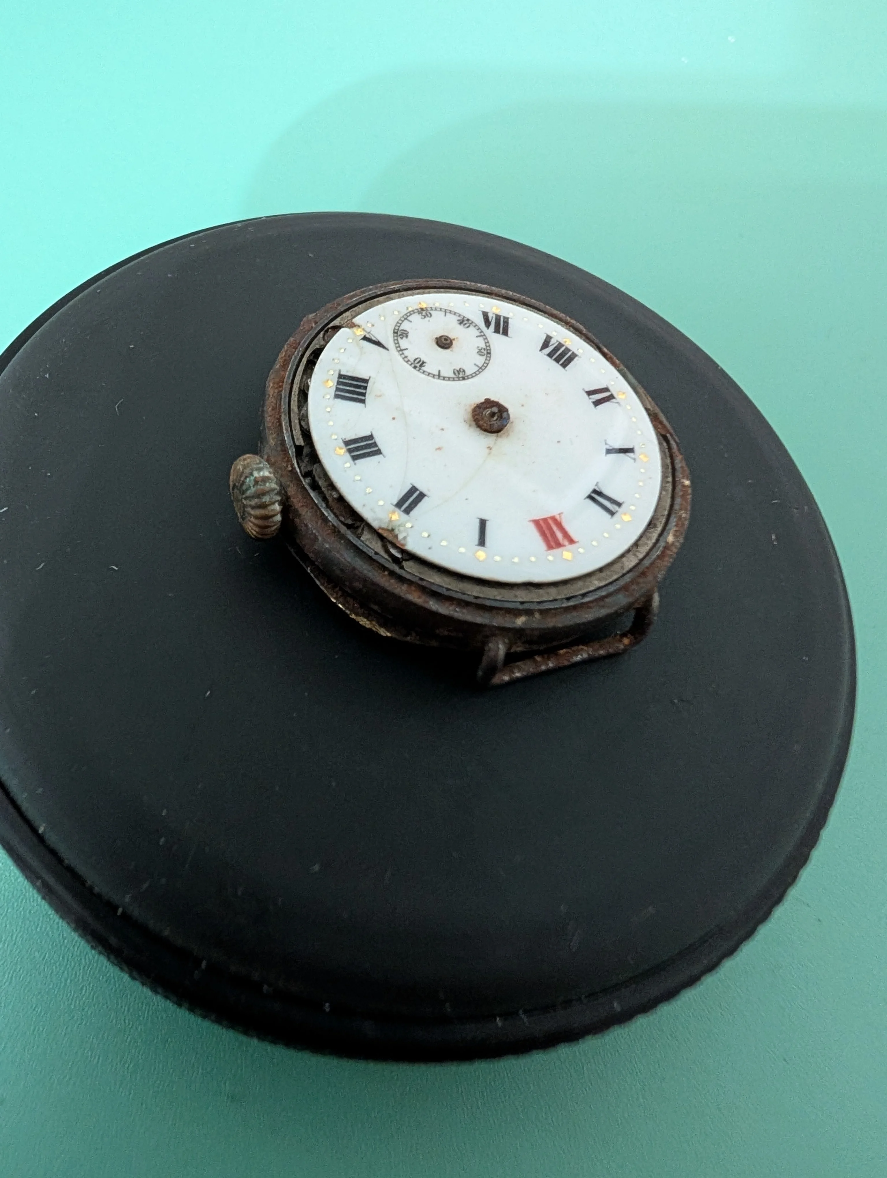

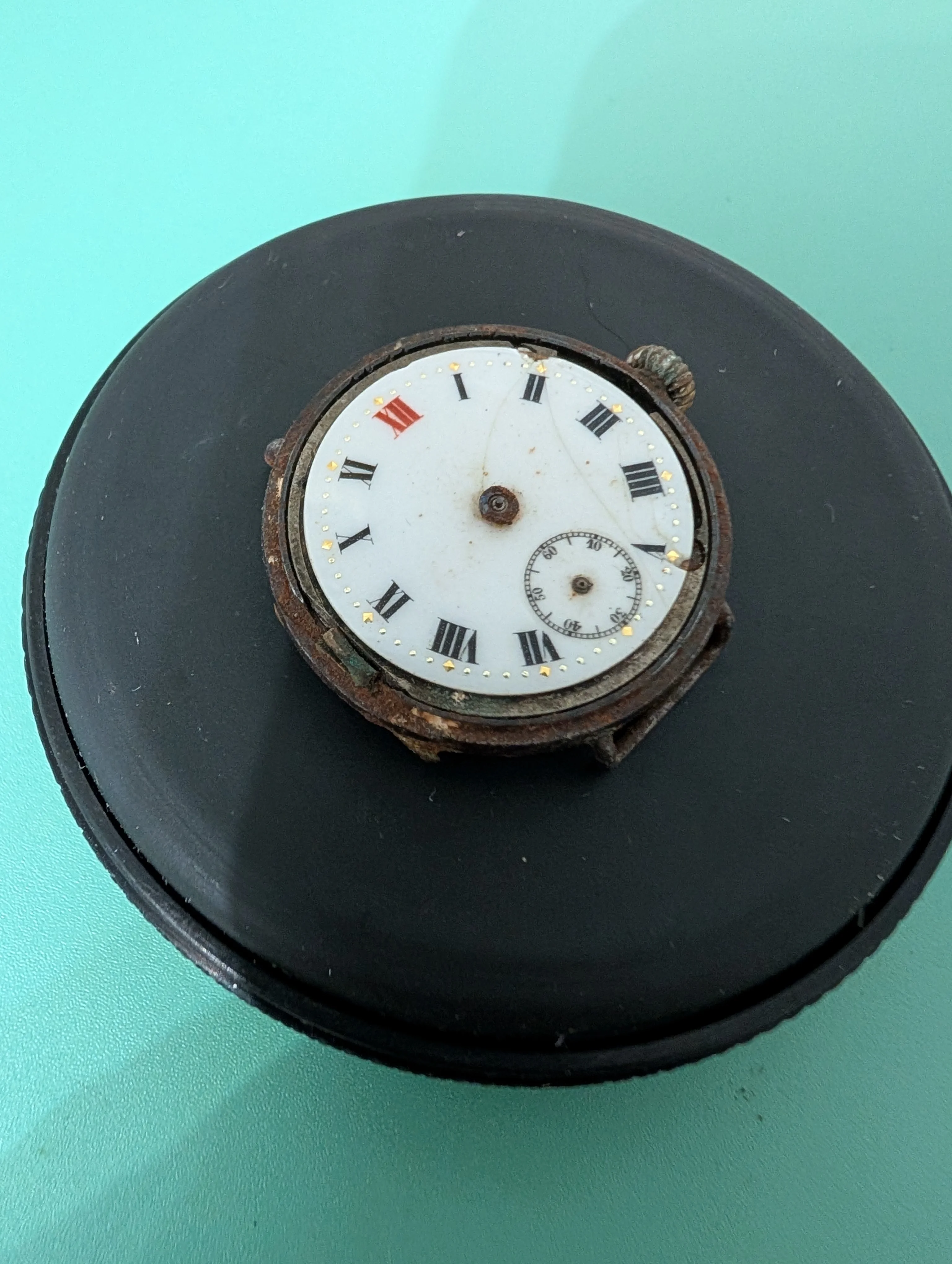

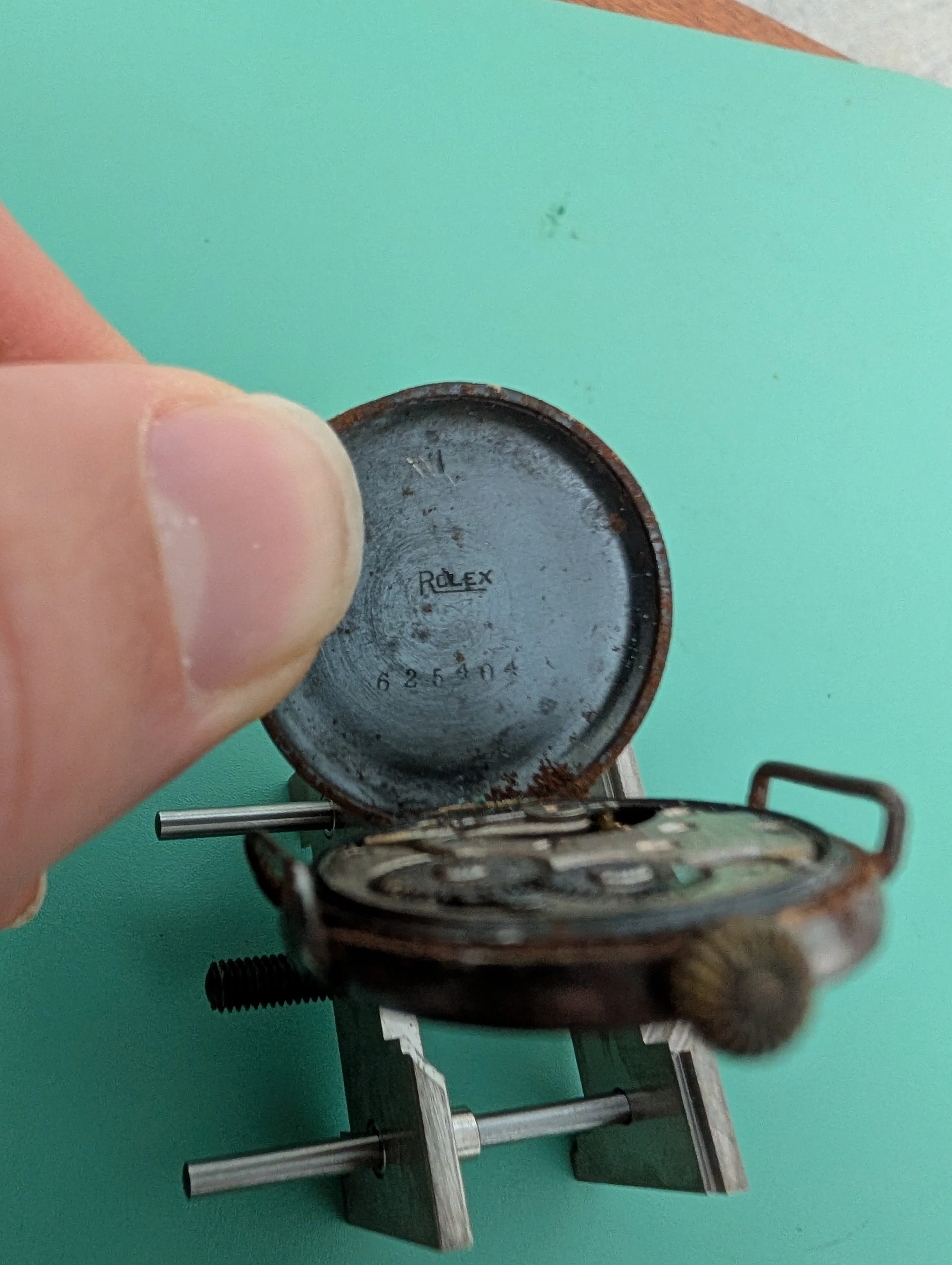

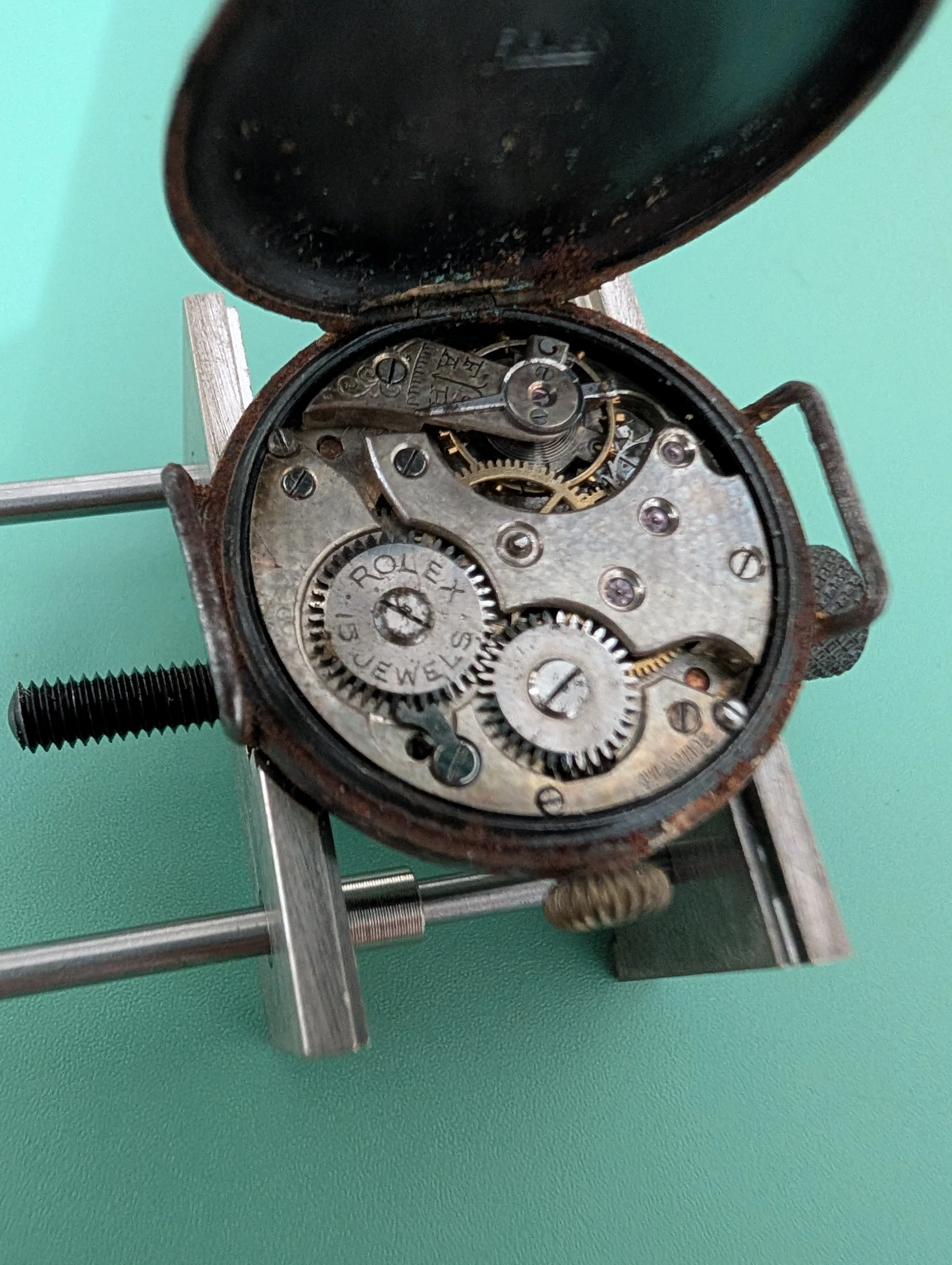

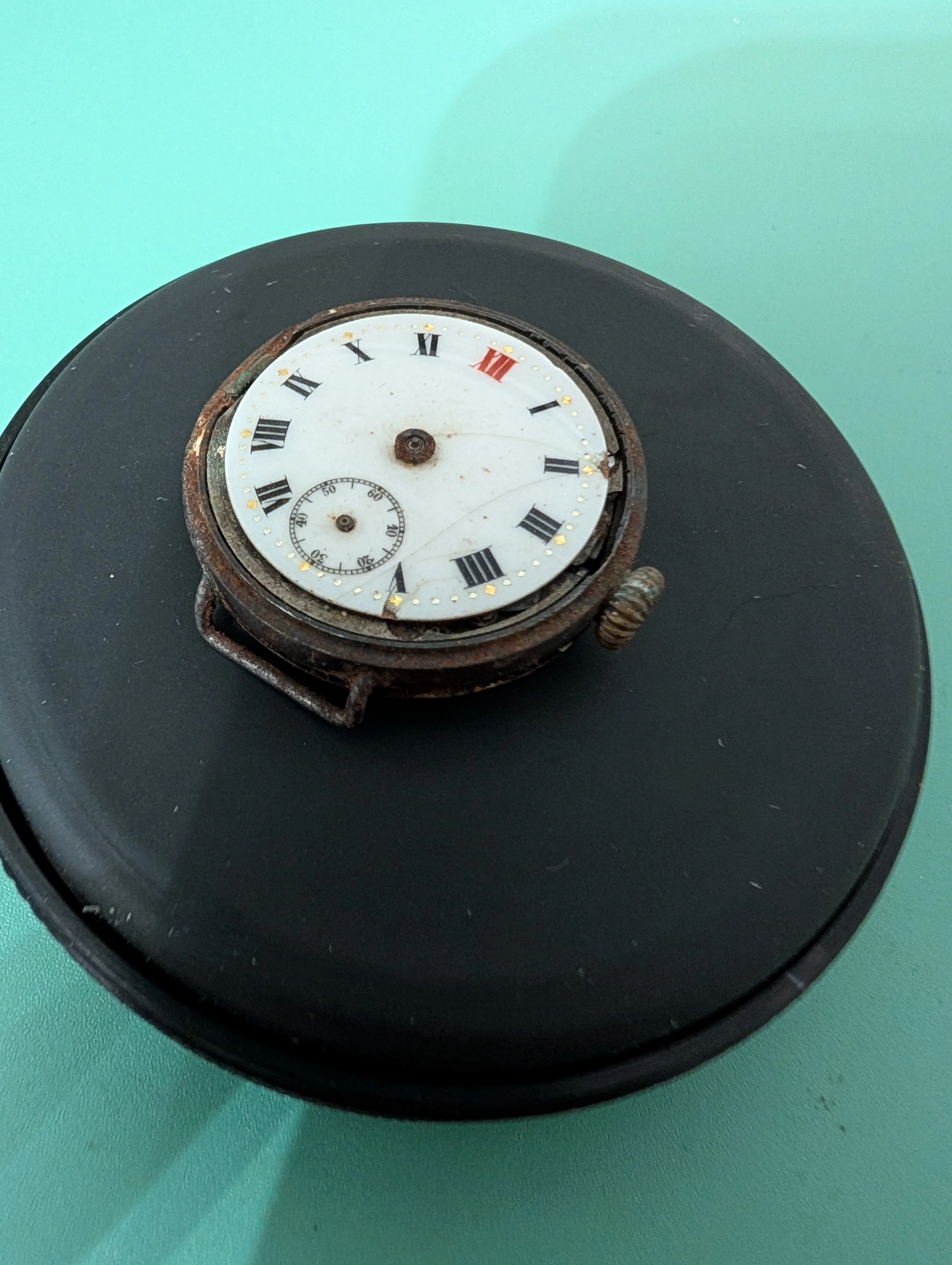

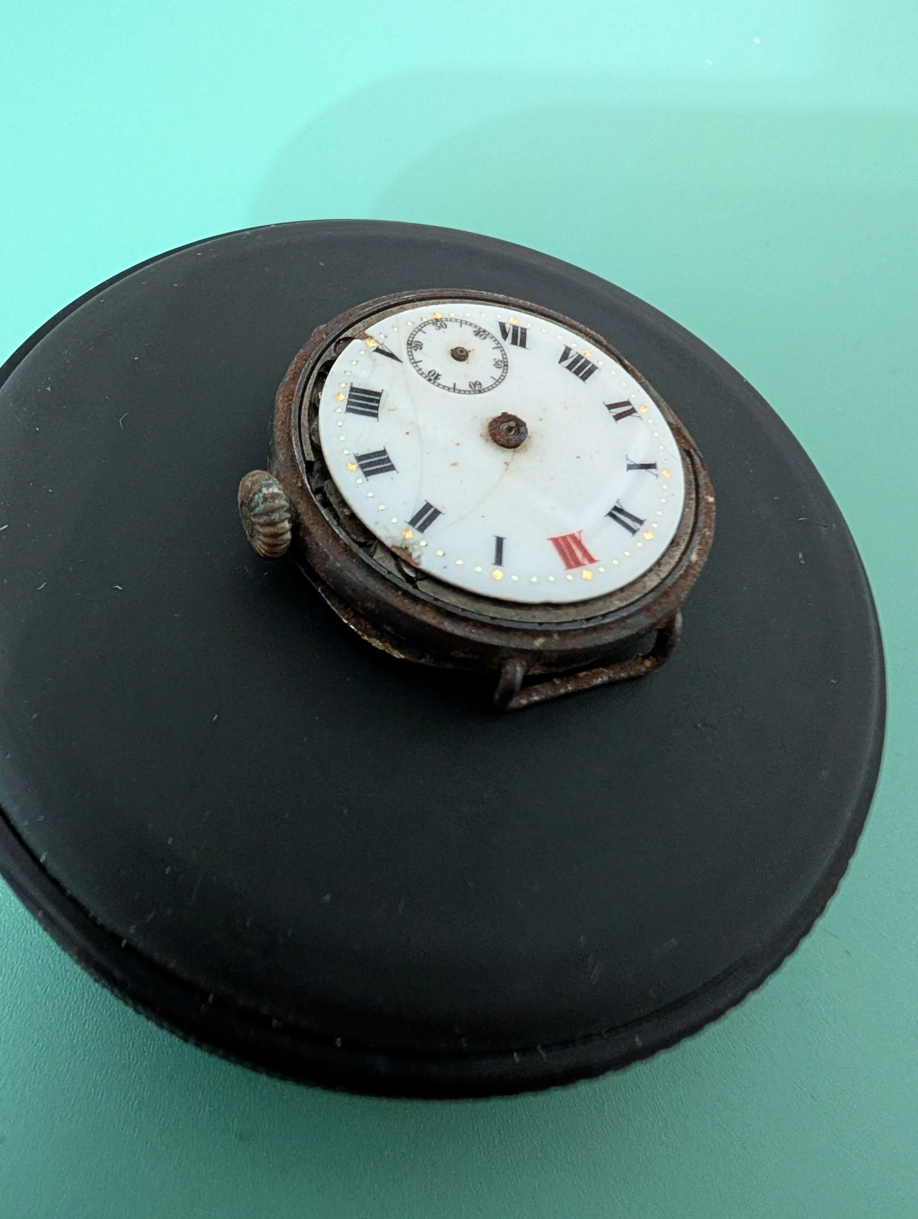

Hey all,
I've been working on getting in to watchmaking and had put "antique mechanical watches" on my Christmas list this year that I could practice on (ie cheap watches from the antique / thrift store).
I received what seemed like an old no name watch that would be great for practice. Upon getting it open, I discovered its actually an old antique Rolex (some searching seems to indicate ~1920's WWI watch). Certainly a splendind surprise! But now I've paused to reassess how to approach and would really appreciate some advice!
I will preface I am an extreme novice when it comes to watchmaking (one pocketwatch and one wristwatch service under my belt only). Originally this was just going to be a watch to get some experience with that it didn't matter if I broke it. Now, I'm a little hestitant to simply have at it. One half of me thinks this could be a great experience / story to have received this watch and restored it myself, the other half of me considers sending it off to be restored professionally.
Any thoughts on if this is the kind of watch that only experienced hands should touch, or maybe this is something that could be tackled by an amateur (thinking I would likely shelf it for a while to practice on a few others before I touch it). I will note that it still is able to run in certain positions, so seems likely it can be restored to working order.
If I do attempt this myself, any specific things on this type of watch to be congnizant of? Ie any major no-no's when it comes to a watch like this that I should pay attention to so I don't destroy it (either physically or from a collector's stand point)?

I wouldn't worry too much.
Rolex was just another brand in that era.
Then in 1927, Hans Wilsdorf got the idea of promoting Rolex watches with attention grabbing events like the English Channel swim by Mercedes Gleitze, so since then, Rolex has had two products, watches and marketing.
Your watch pre-dates this time so it's not like your working on a pristine vintage Oyster. Just do your best with it and good luck if you get it going.

Okay great, thanks for the expertise!

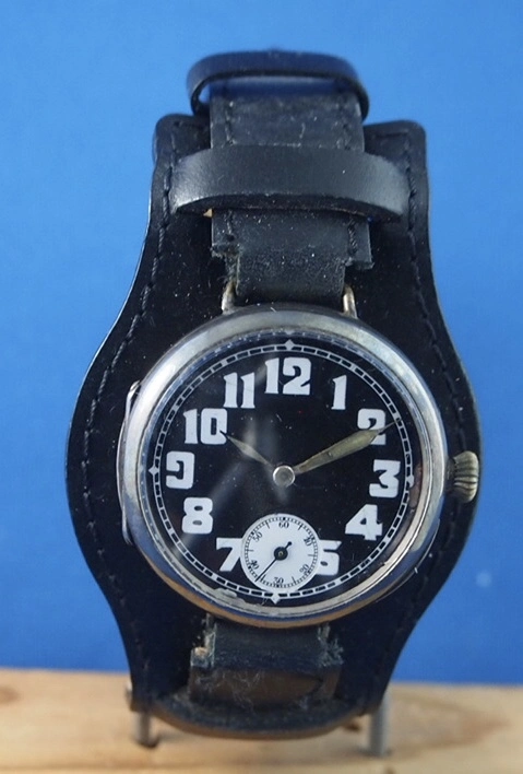

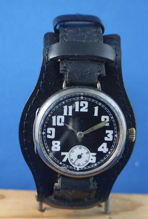

That movement was the “Rebberg” movement produced by the Swiss watchmaker Herrmann Aegler. My guess is it is over 100 years old. If you have hopes for this movement, my suggestion is to not rush it! I speak from experience. Decades ago, I acquired the same exact movement as yours, with no case. I put in my “pending” drawer, keeping my eyes peeled for a case for. It. Lo & behold, roughly 5 years later, I got a call from a brother collector. He acquired an original sterling silver Rolex W & D (Wilsdorf & Davis) case hallmarked in 1915. We worked a swap, and I finished the Rolex you see in the picture. Rather than to render it a paper weight by practicing watchmaking on it, I’ll just bet it would be worth loot to somebody. Sell it and buy a bushel basket of scrap watches to practice on.
The dial isn’t marked Rolex (yours isn’t either), but the movement is marked Rolex (just like yours). In these early years, Wilsdorf (& Davis) were heavily involved in producing private label watches for retailers, not so heavily involved in building market share for the Rolex name.

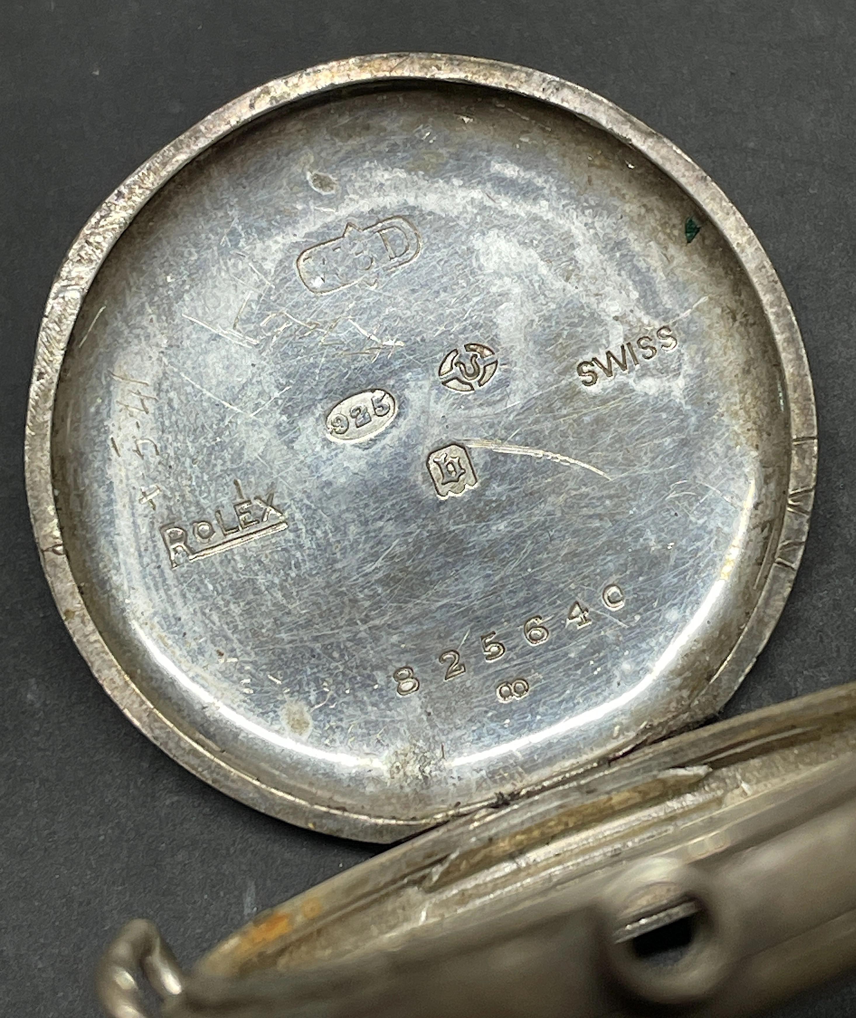

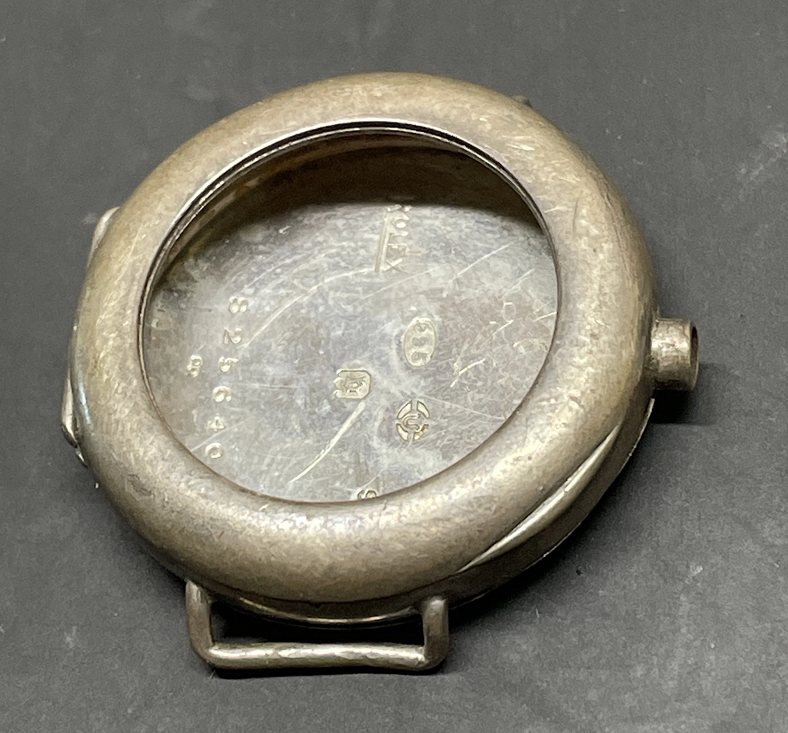

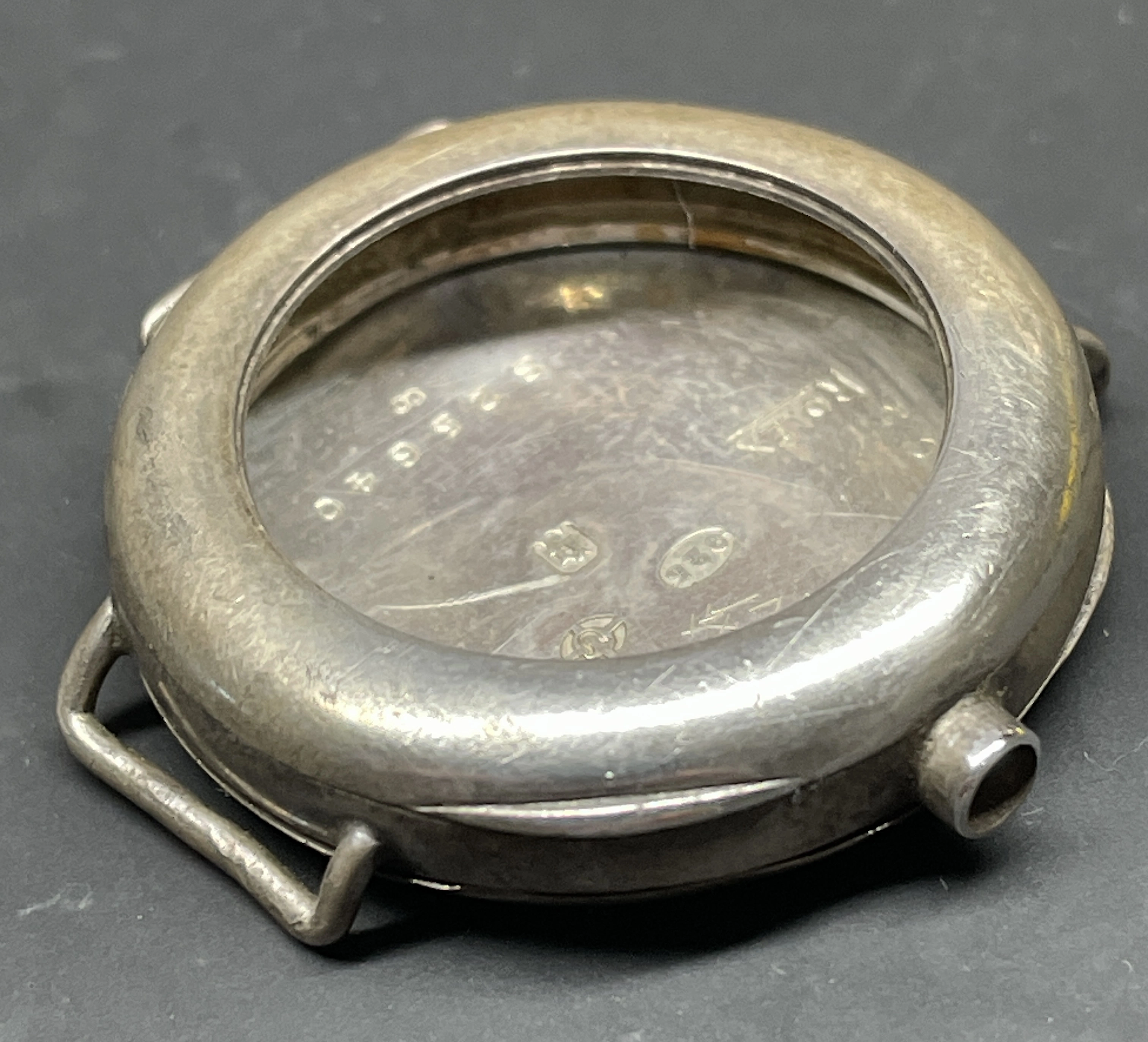

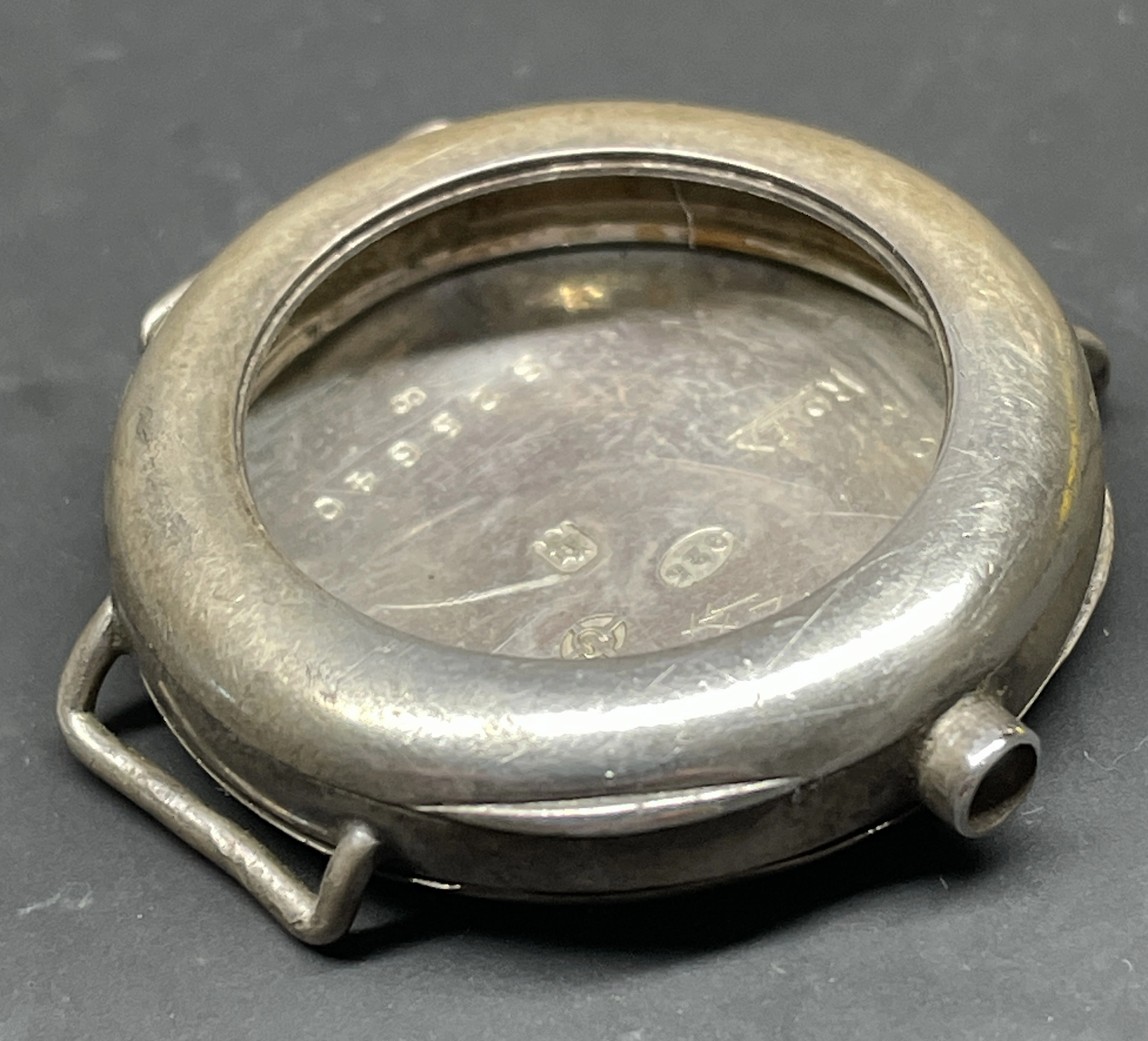

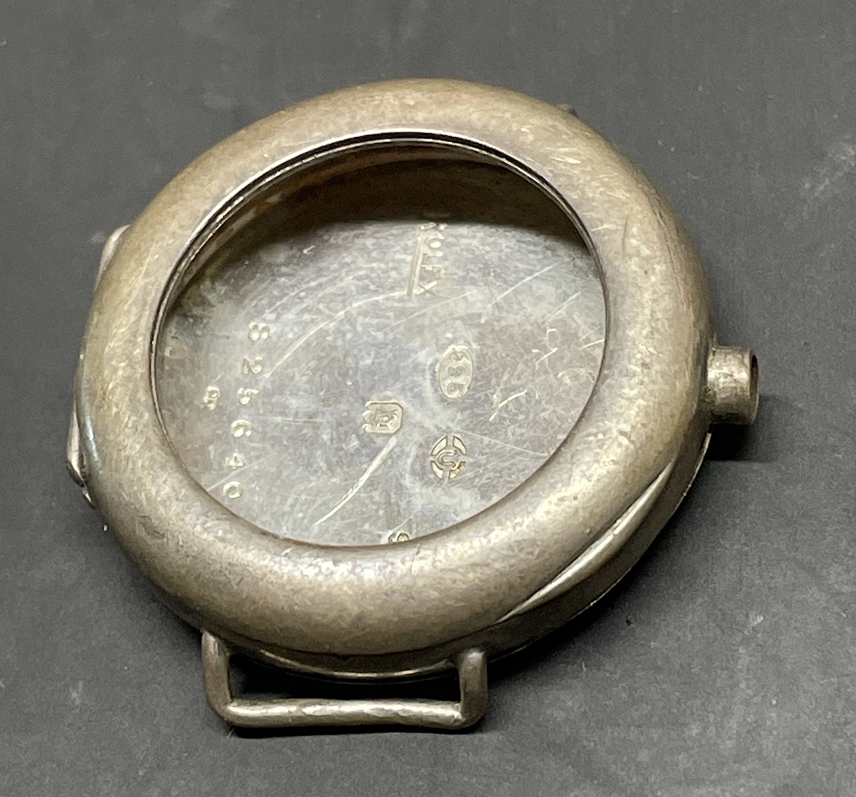

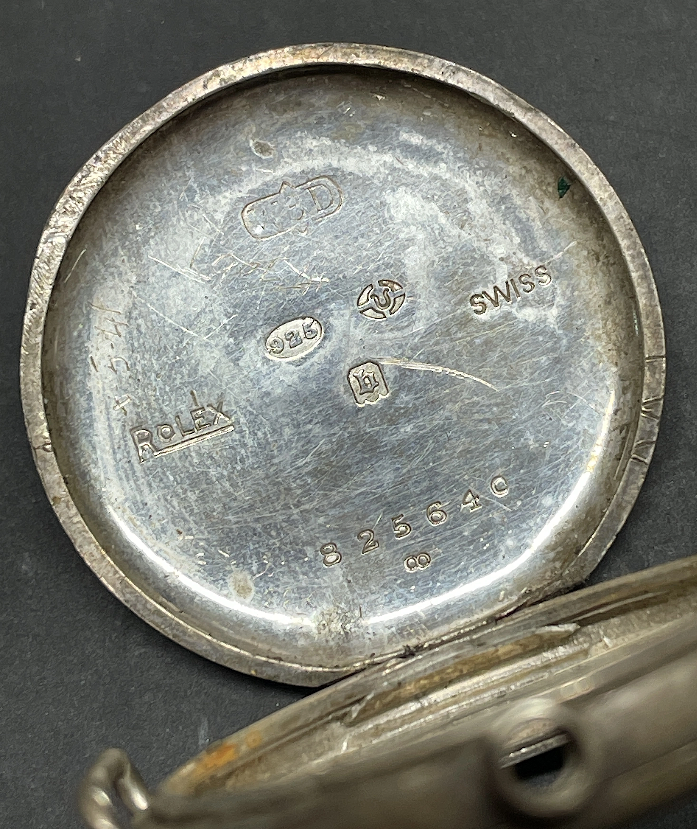

I've got a little silver case that'd look much better than the one you have.
Genuine W&D Rolex, 925 silver, London Import mark for Swiss made, London date mark for 1917.
Case ring measure 24.4mm, so 11 ligne. Can't tell what size your movement is.
Yours if it fits and if you get the movement up and running.
Will come up well with a polishing cloth.
Wow that's a great story, the finished watch looks so great!
Oh wow that's so kind of you!! I will get some more practice and then see about getting the movement running again!

You’re 75% of the way to a very collectible watch! Please don’t muff it!

I certainly will be careful and patient with it!
