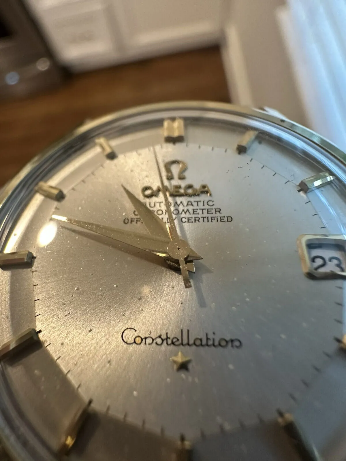

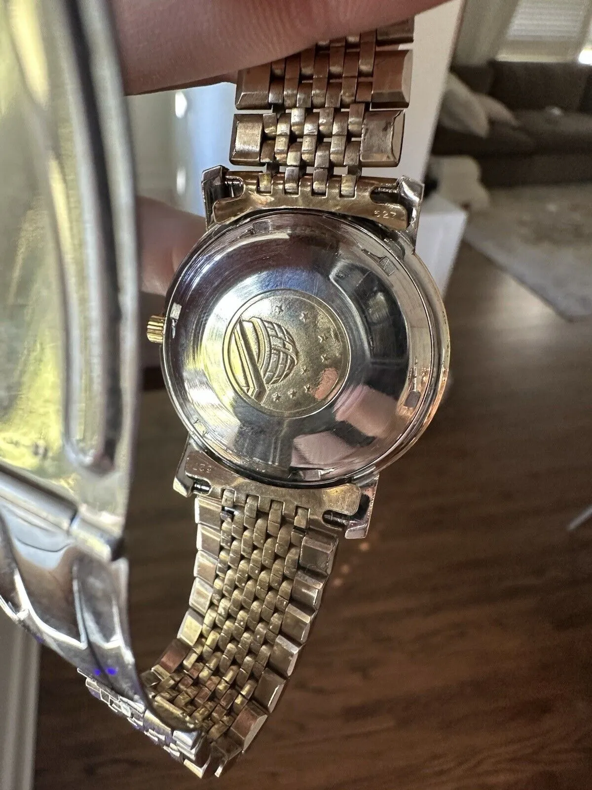

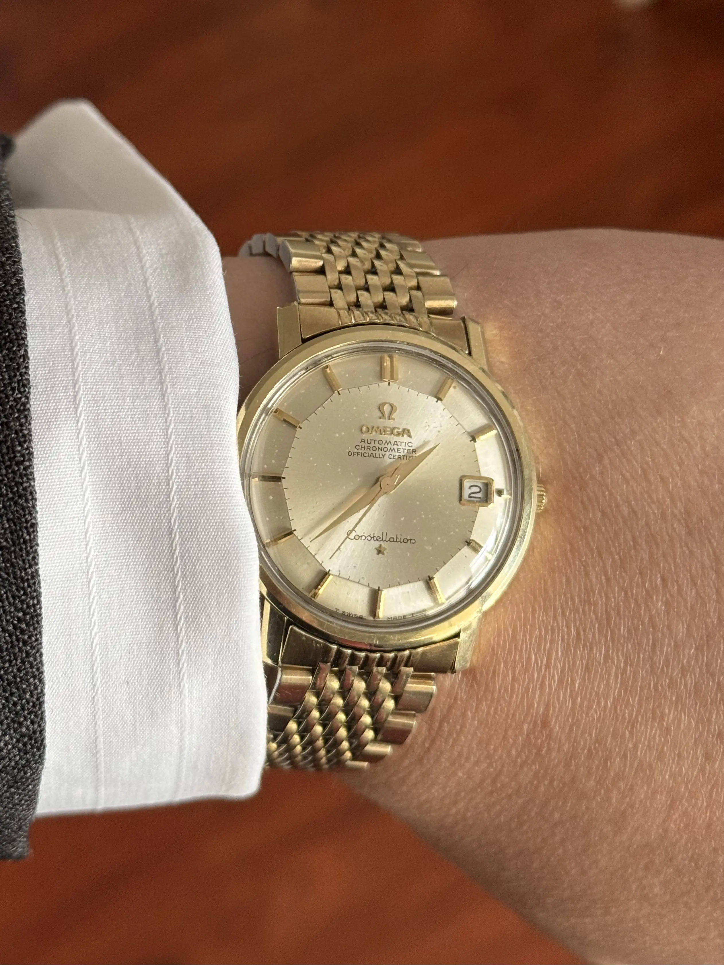

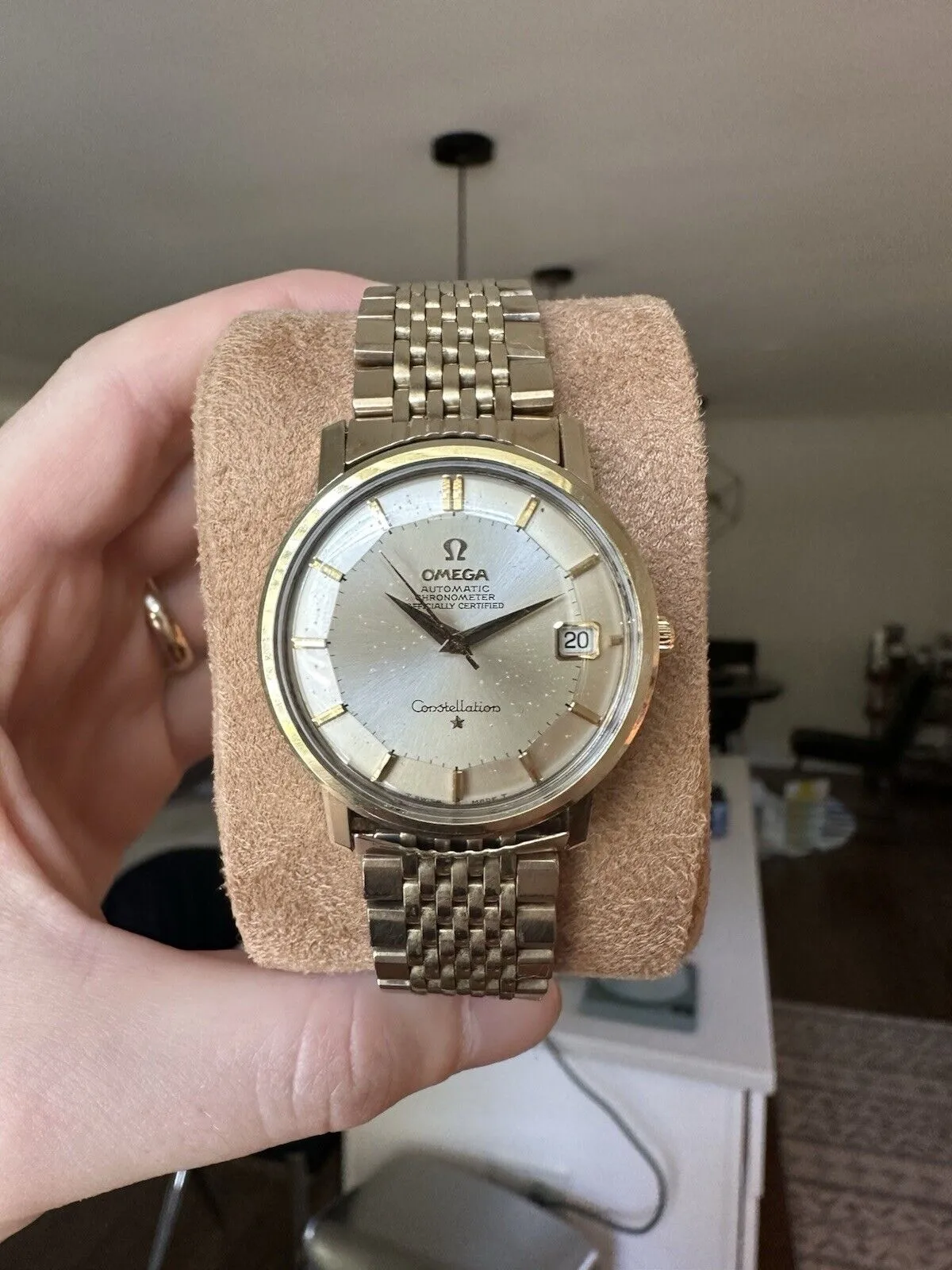

Looking at picking up this pie pan constellation for around 1300. Any red flags here?
Thanks for your help!

Just a noob omega lover. Looking to acquire my second omega. Current watch is a d6672 14K with fairly damaged dial that I picked up for cheap.

"T Swiss Made T" - Is there lume on the dial / hands??
13,520
23,458
Looks like the version with the lume inset to the hour markers

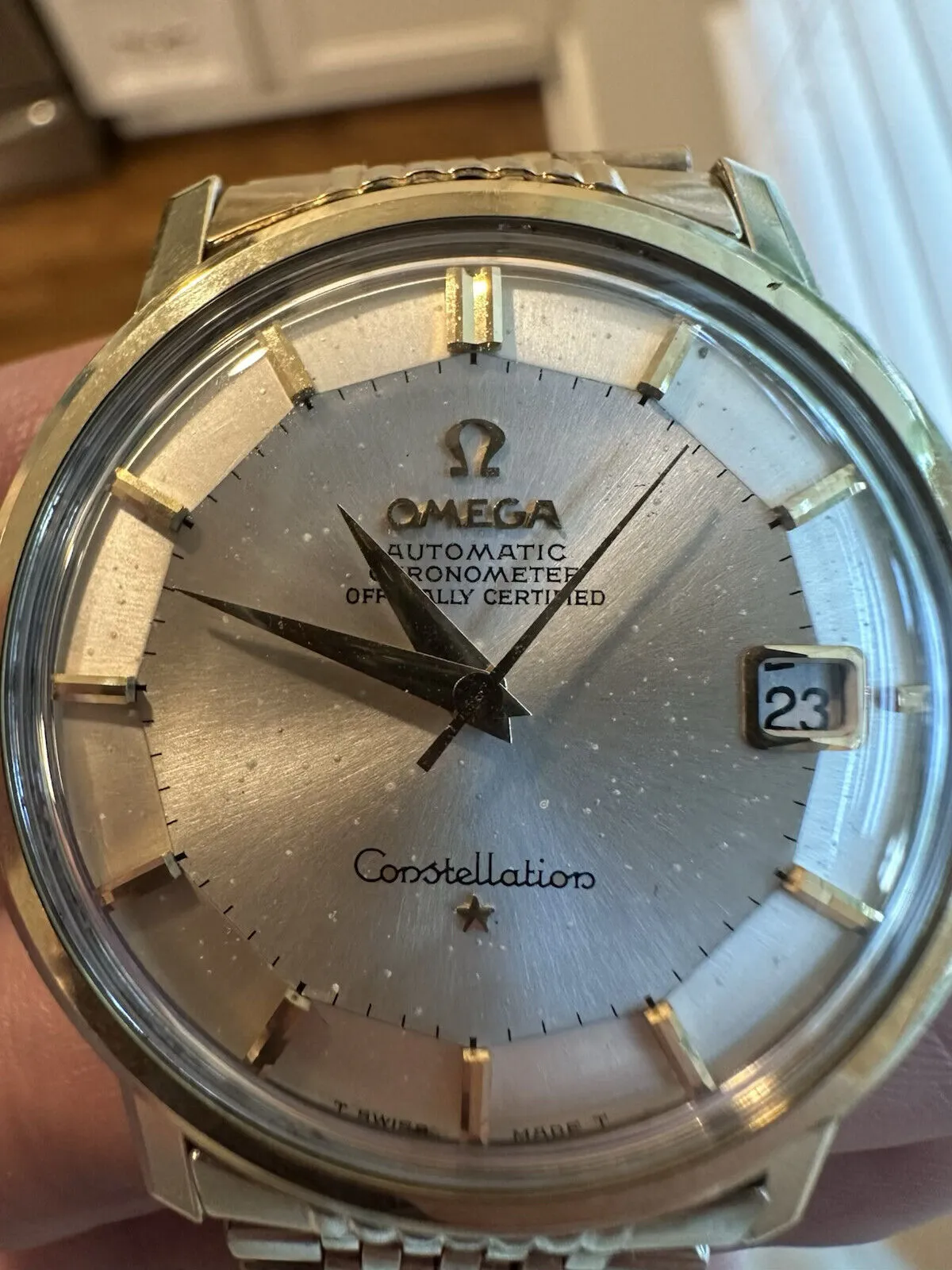

Additional photos of the hands/dial. From what I understand the lume on these hands were thin lines in middle? Maybe I can see where it used to be? Or is my brain filling in details. Not sure what to think about the speckling on the dial either.
8,818
62,459
Speckling is pretty much, but not always, present due to materials and age and UV light. I have one from the early 1950's I call my Big Dipper Constellation from the design of the specklin'
And, the date wheel may be needing help, or you are in the initial stage of it changing the date on the above pictures.
24,798
55,079
The lighting in the photos makes it hard to see color, but I assume this is gold-capped, i.e. the backs of the lugs are SS? The dial and hands appear to be no-lume, FWIW.
Ultimately, the main issue will be the blisters on the dial. TBH, I couldn't tolerate it, but that's just me.

On the second set of pictures it does look like facets to the hour markers rather than lume
14
6
So probably an old redial?
24,798
55,079
Sometimes T SWISS T dials weren't lumed. I really don't think that's the issue.
13,520
23,458
I still think the dial is good. Look at the print, the serifs on the text and the hour markers.
14
6
I was initially tempted because of the price and it coming with an allegedly original band, but now I'm waffling due to the blistering. Some more time to think, I think.
6,765
10,421
If you look closely you can see lume notches at the ends of some of the indices.
I think the dial is all original and correct.
The hands on the other hand look like non-lume replacements.
The dials on the 168,010s are almost always blistered, some present worse than others.
The case looks pretty good.

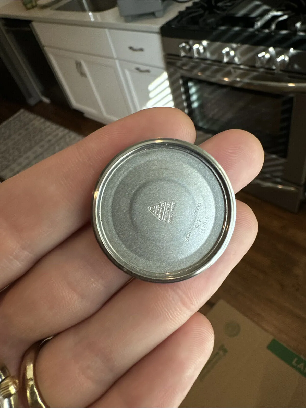

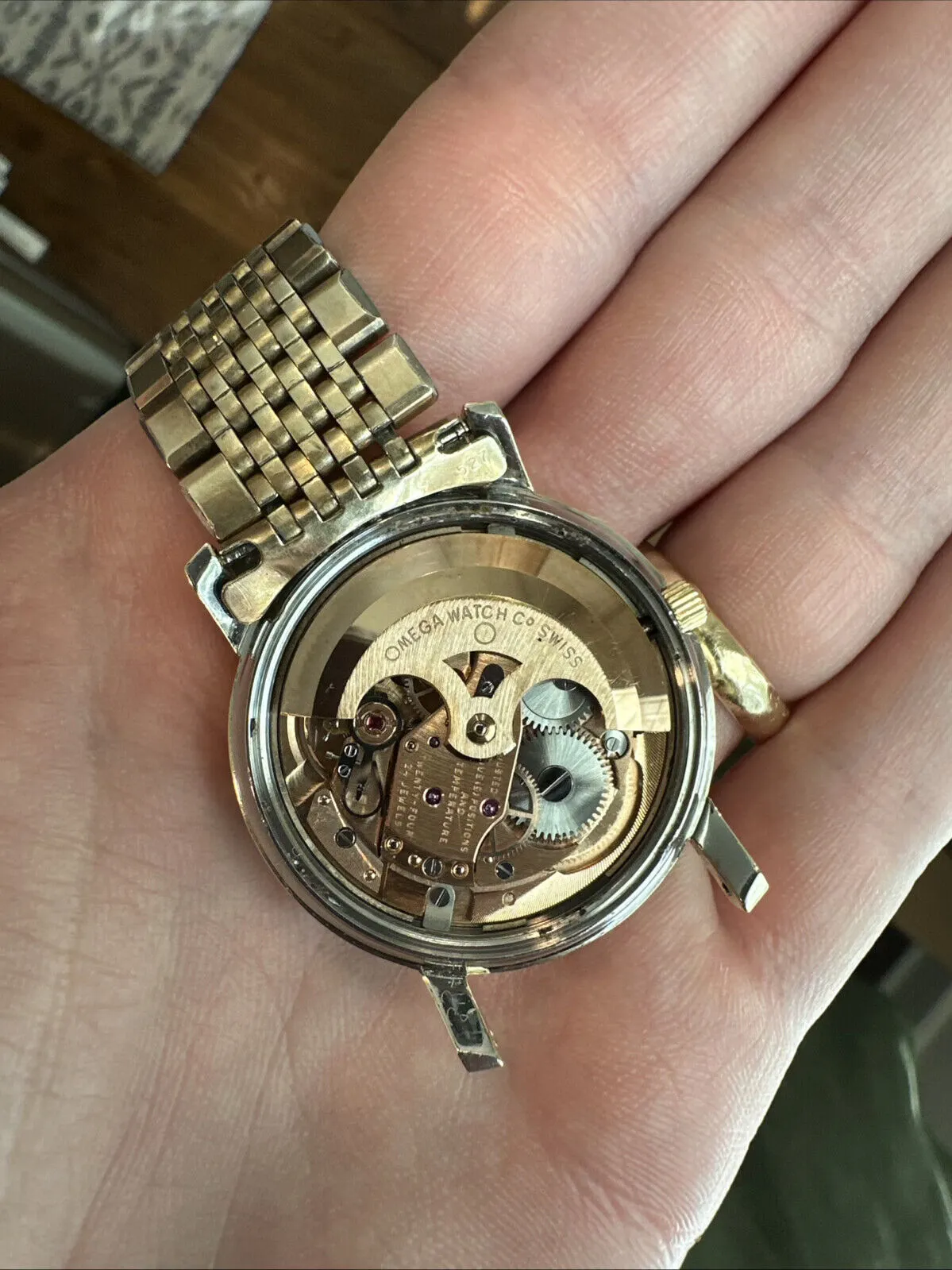

Replacement crown.
Replacement rotor but may have been to remedy the rotor rub.
Although I think the ‘new’ rotor is also rubbing.

Ended up pulling the trigger, got it for just under 1200, citing the rotor rub. Should be here next week!
14
6
Thank you again for all your help! I'm really quite happy with it. Dial rub was corrected by just putting in a caseback dial. Hopefully if there is play in the rotor area, it won't be an issue for a good long while.
24,798
55,079
Congrats on the purchase, but this is gibberish. What is dial rub? What is a caseback dial? Nonsense words. Repairs with replacement parts in the auto-winding mechanism are required to fix the underlying cause of rotor rub.
If you don't want to fix it, that's fine, it will just gradually get worse and the auto-winding won't be efficient. But you can still wear the watch, and add some manual winding as necessary.
14
6
Gibberish seems harsh. Yes I mistyped and meant rotor rub. The issue was corrected, so not sure what you're on about.
24,798
55,079
And what is a "case-back dial"? Rotor rub was addressed by putting in a "caseback dial"? Come on, either you're trolling us or very naive.
Whatever it is, that's not how to correct a rotor that isn't rotating properly. If you don't want to fix it properly, ok, but don't kid yourself. If a "watchmaker" told you differently, you should probably find someone better.
Rotor rub is addressed by replacing parts as necessary (axle, bushing, etc.) so that the rotor spins properly, without touching anything.
14
6
I'm not naive, just typed wrong. It was fixed with a case back gasket so the case back wasn't sitting as close to the movement. It's not that complicated to figure out.
