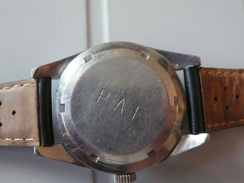

  3. Privateday7 quotes Miss Universe Sep 22, 2013
    5,753
    2,893
    The PAF inscription in the case back?
  4. Joe K. Curious about this text thingy below his avatar Sep 22, 2013
    1,643
    2,085
    I can't see the PAF marking on the case back. I thought these should also have the serial number outside on the back. IMO, without the extract of records this is just a civilian watch until proven otherwise. My 2c

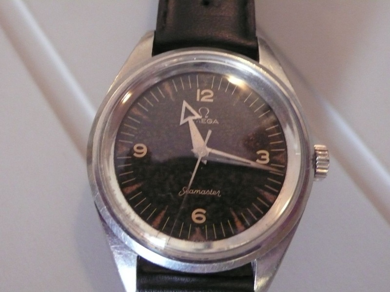

  5. watchyouwant ΩF Clairvoyant Sep 22, 2013
    4,412
    7,233
    one more hint........you can not fake the PAF railmaster caseback. unless you shave every engraving and pretend, the military did it... kind regards. achim
  6. sohail Sep 23, 2013
    445
    152
    PAF and 2914-6??????????
  7. watchyouwant ΩF Clairvoyant Sep 23, 2013
    4,412
    7,233
    the main issue with this one is the nature of the PAF deliveries: like the preuvian pilots requested something different to the rail service on their dial ( flightmaster front and back), the PAF pilots had the same problem. but they were o.k. with seamaster ( as long as it had nothing to do with Rail....). and seamaster it is on the thick AMAG dial with the luminous wells and the back ( inside with the correct railmaster model references; they actually did go with the next model generation as well...) outside is engraved with seamaster over the horse and the mvmt. number in an arc below as well. so, this one here has only P.A.F. on the movement. that could have come from an early dress model and the archive would show delivery to pakistan. but the model number is crucial here. therefore: not convinced, that this railmaster is a military model. here is a correct outside case back.........
    kind regards. achim
    [​IMG]
  8. sohail Sep 23, 2013
    445
    152
    Hi achim , is this 2914 or 135.004? This case back in my opinion came only with 135.004 PAF railmasters.
  9. sohail Sep 23, 2013
    445
    152
    This is the case back for 2914-5
  10. watchyouwant ΩF Clairvoyant Sep 23, 2013
    4,412
    7,233
    yes, mine is a 135... example. confirmed by the factory. any dial pics. from your PAF? kind regards. achim
  11. sohail Sep 23, 2013
    445
    152
  12. sohail Sep 23, 2013
    445
    152
    This is 2914-5 with PAF markings on the movement . The 135 did not have PAF marking on the movement , if I am not wrong......
  13. watchyouwant ΩF Clairvoyant Sep 23, 2013
    4,412
    7,233
    a very well kept beauty, my friend ! kind regards. achim
    [​IMG]
  14. watchyouwant ΩF Clairvoyant Sep 23, 2013
    4,412
    7,233
    correct, no PAF on the movement. just outside the case back. kind regards., achim
