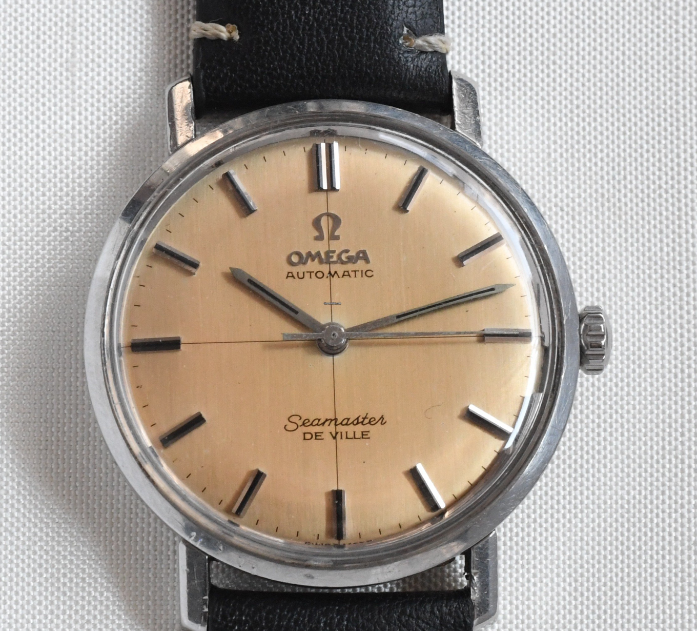

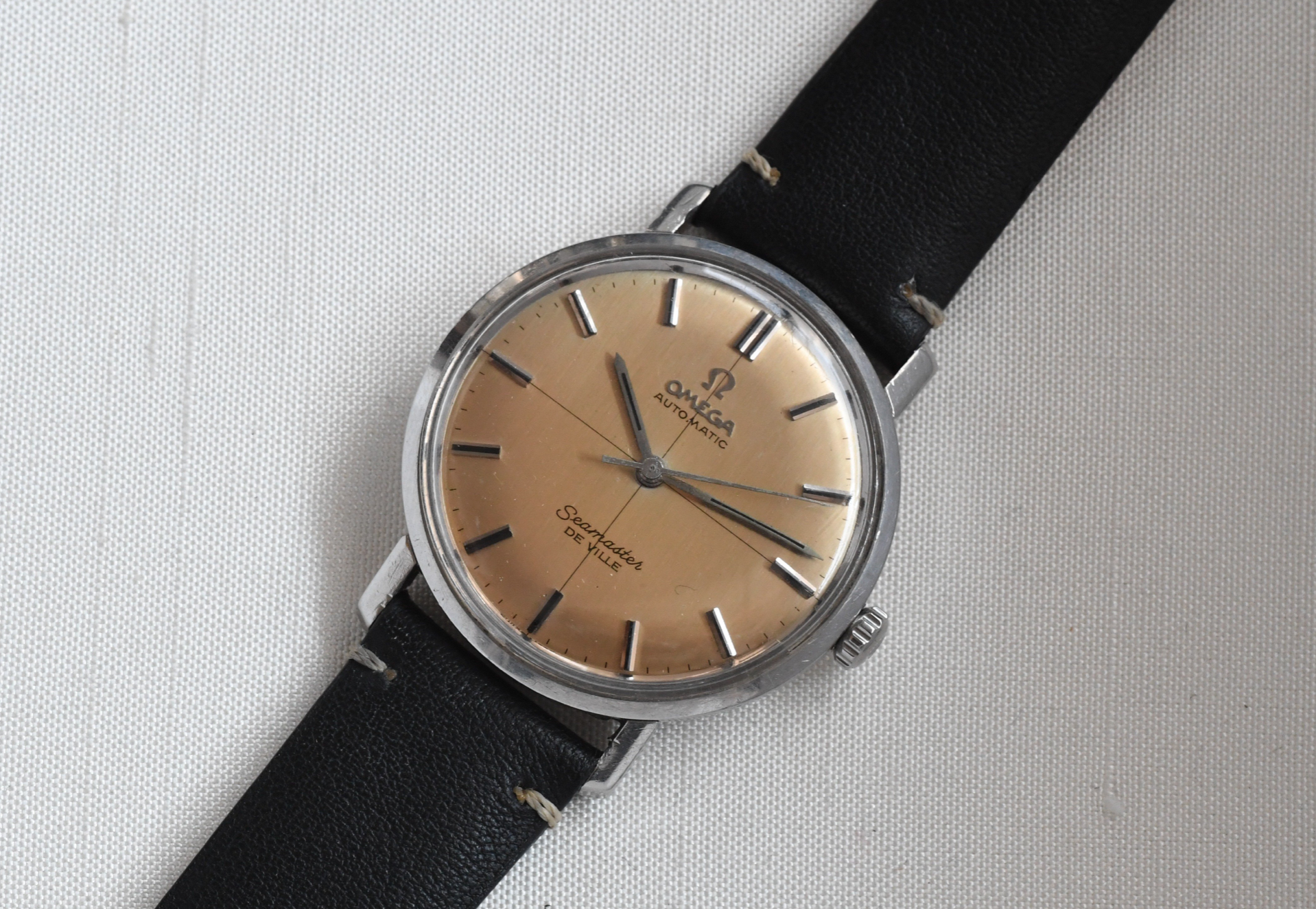

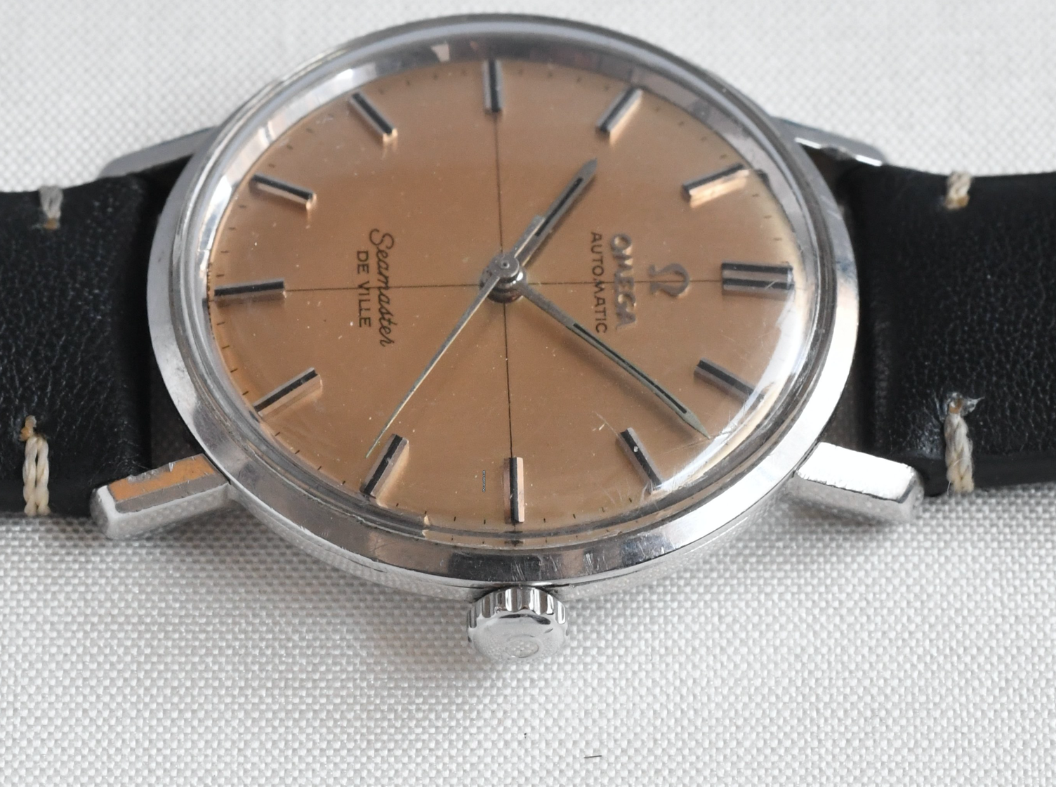

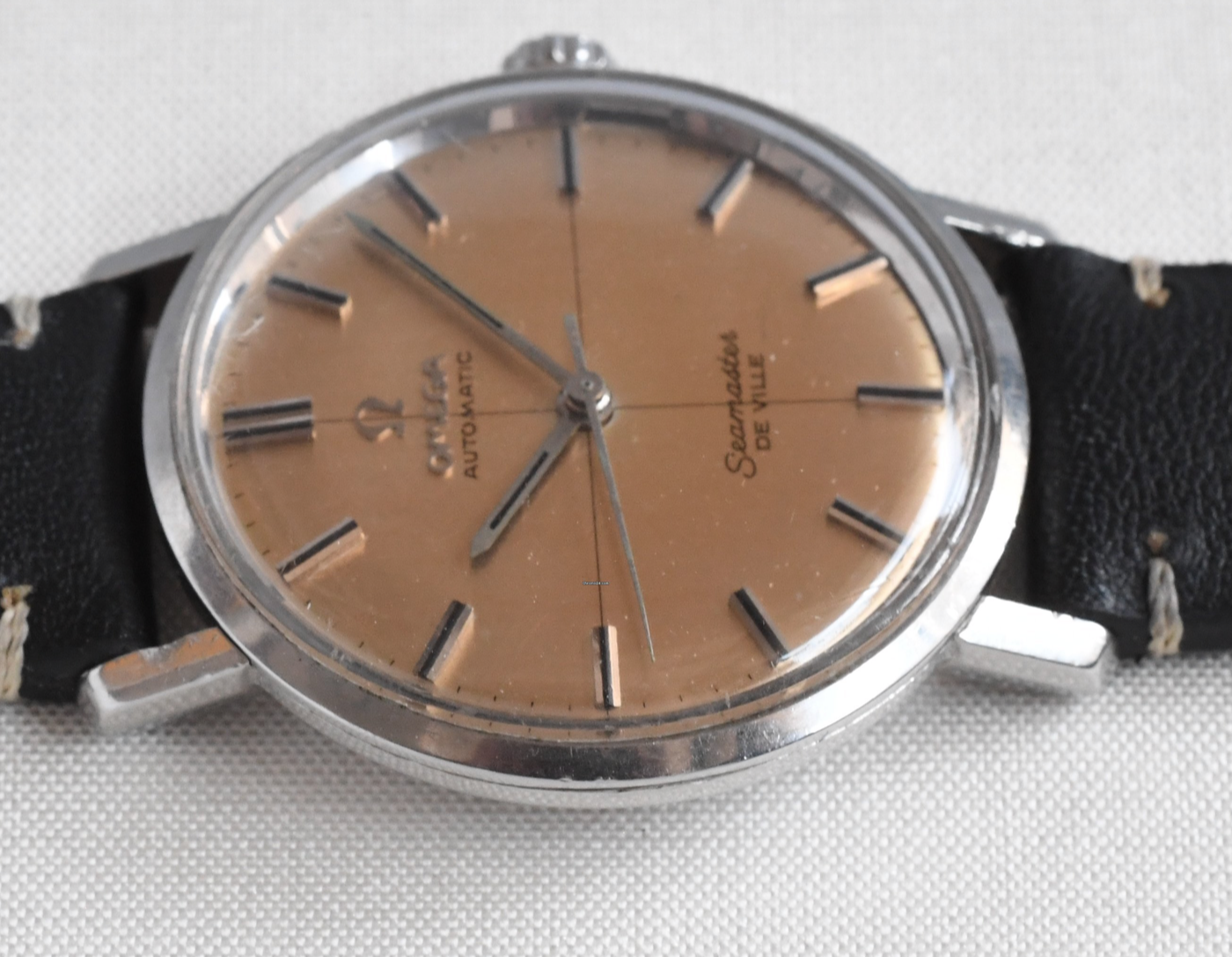

Hi guys,
First post on Omega forums, Speedy owner here.
But anyways, I came across this online from a merchant I've purchased from before and was happy.

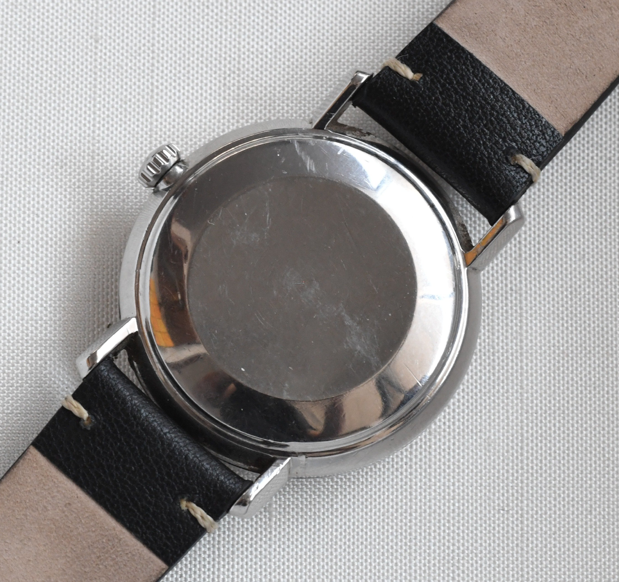

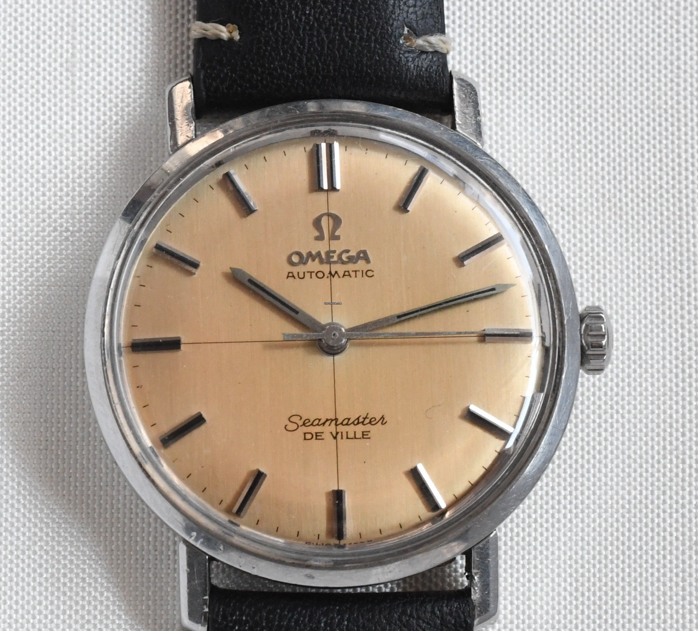

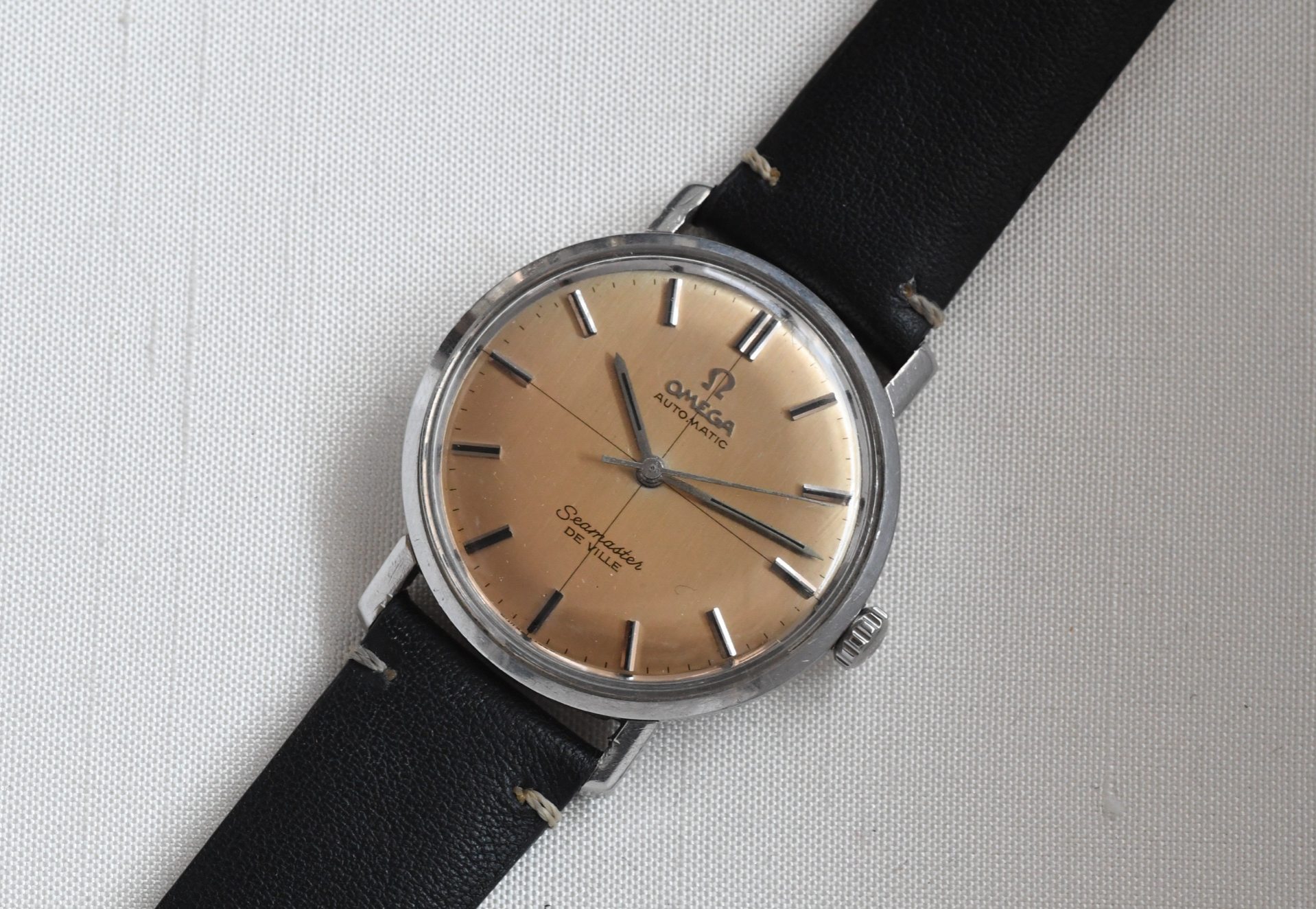

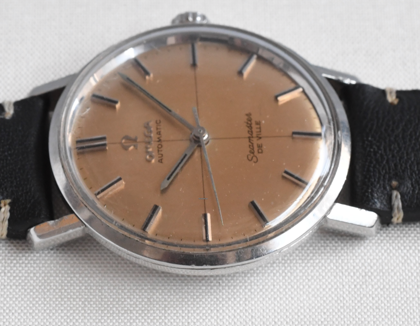

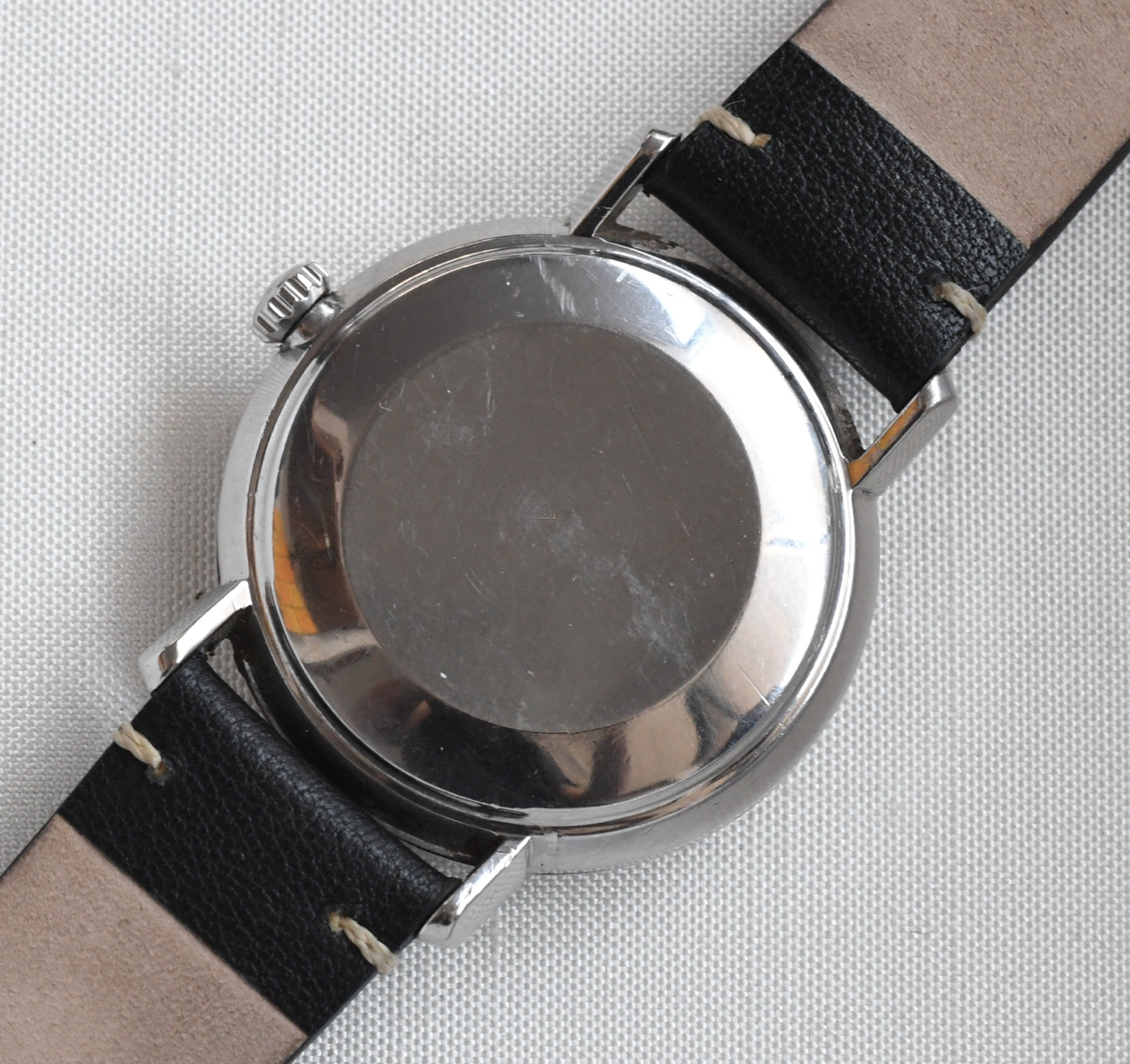

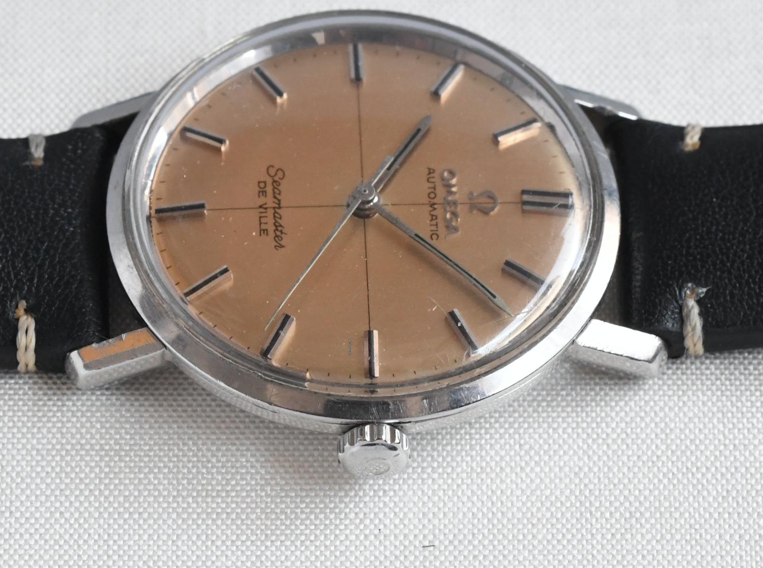

Just wondering if this is redialed/authentic
The caseback doesn't have the omega stamp, from what I've seen on the forum here, most if not all do.
The crown has the omega logo
I really like the patina copper of the dial
No photo of the internals also got me worried
Posted at $1400 CAD
Thanks in advance for your expertise

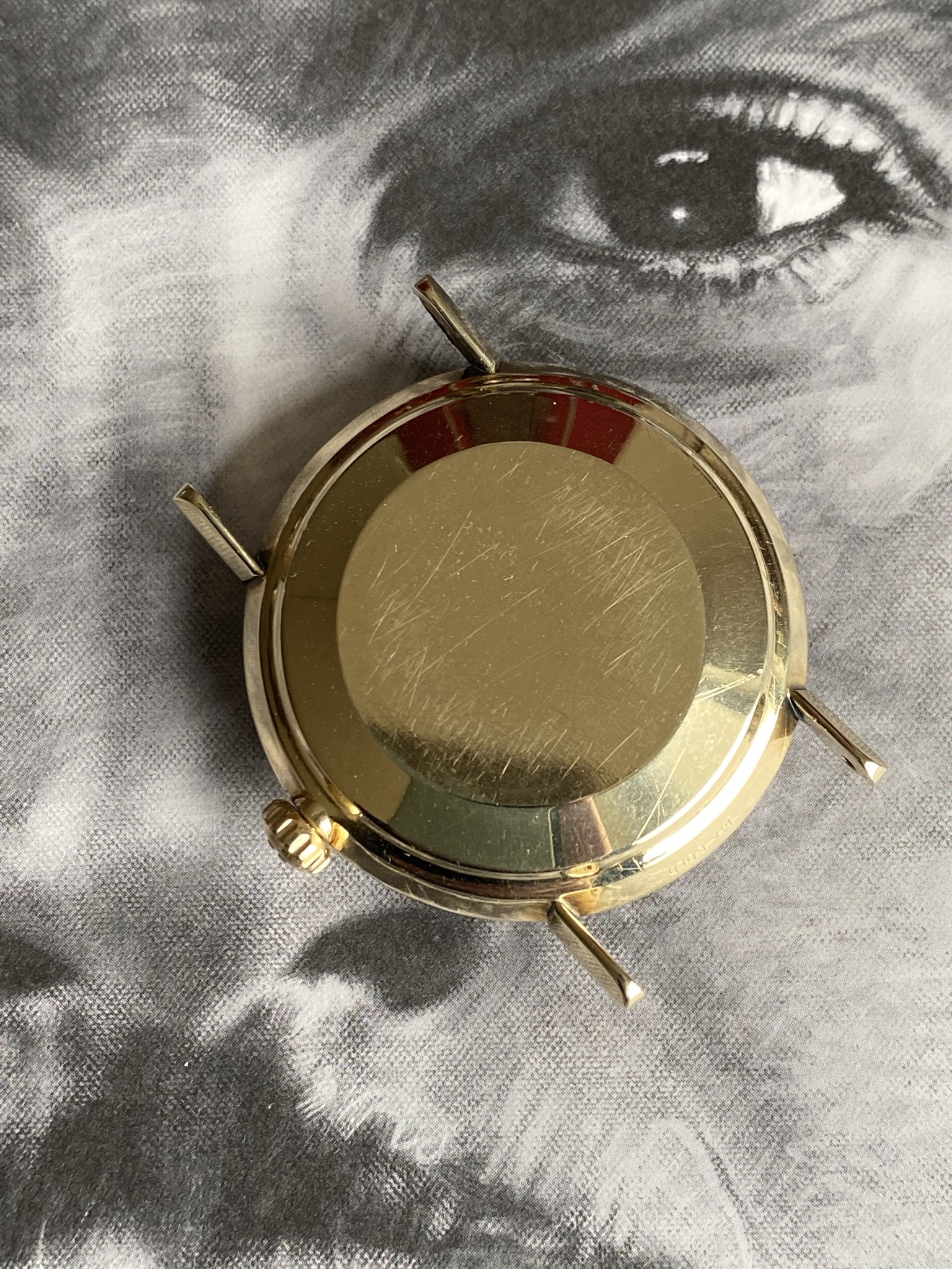

+1 regarding the price. And the case back is completely fine, here鈥檚 a picture of a 14k example I used to have (and sold for less than the asking price for your SS example 馃う):
2,082
2,840
Especially both upper lugs look on the available pictures like they have been significally polished
As far as I know Omega delivered 'plain' case backs also
That鈥檚 a beaut!
