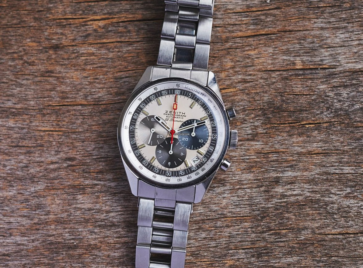

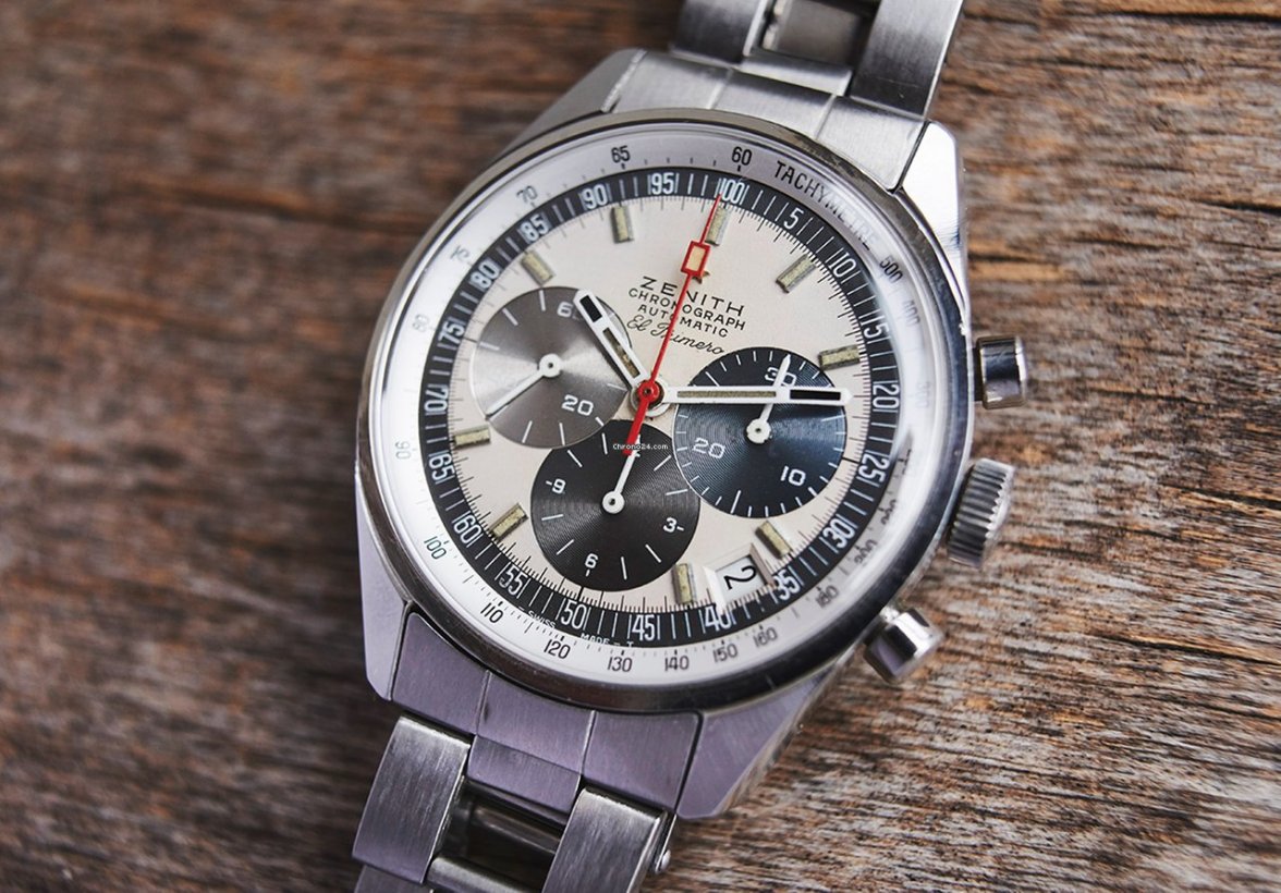

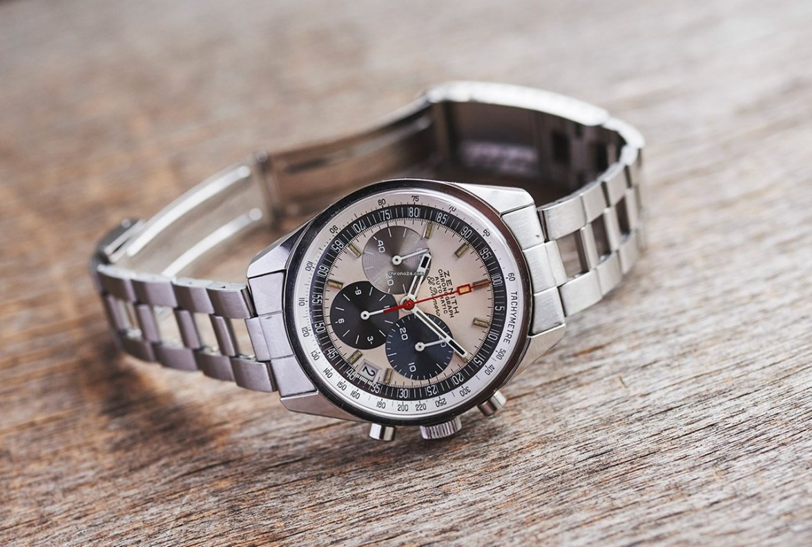

    Hi all, I found a zenith A386, that looks in really good shape but I have some questions. You can find it either at http://www.rarebirds.de/ or https://www.chrono24.com/en/zenith/a386--vintage-el-primero-from-1971--id4474809.htm.
    As I said, I think it looks really good, but I have a question about the subdials. I've tried to read all the A386 and El Primero threads on this forum, but I've probably missed this. Specifically, are pointy subdials original, or are they replacement? Also, I've never been able to tell the difference between original and replacement hour and minute hands. Are those original, if not, can you educate me on how to tell the difference?

    this example looks indeed quite nice, but the pointy sub-dials hands are defeinetively service/replacement ones, the original ones have a flat top (and they are very thin for MkI and early MkII, becoming then thicker for later MkII and MkIII).
    The center red chrono hand I also believe is a later/modern replacement, I am not 100% sure though, it is more of a "feeling" it looks too "slick and shiny and new".
    As per the minute and hour hands I tend to believe they might be original but again, not 100% sure.
    Given the sub-dial hands for sure and probably also the center red chrono hand are replacements it wouldn't be impossible to conceive that also the remaining 2 hands are as well....

    The chrono seconds hands are very prone to the pipe splitting when they are removed and refitted for service so for a well maintained watch, it is quite likely that it has been replaced at some stage.
    Of my three original El Primeros, one had the hand glued to the post, one was split and the other was OK because the watch had never been serviced before. From time to time, you do see tritium service hands for sale but at huge prices - c. €200

    Congrats! i would have bought it, but i was a few minutes too late. i like it. the hour subdial should be skinny (and not pointed) like the other two. i feel like they should have mentioned that in "what you should know". not a big deal, wouldn't have prevented me from getting it :)

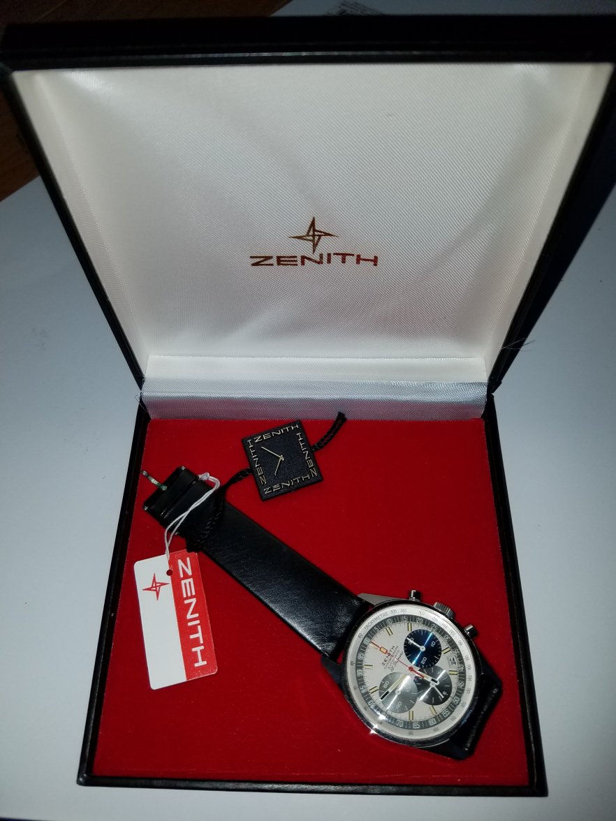

    My Zenith El Primero A386
