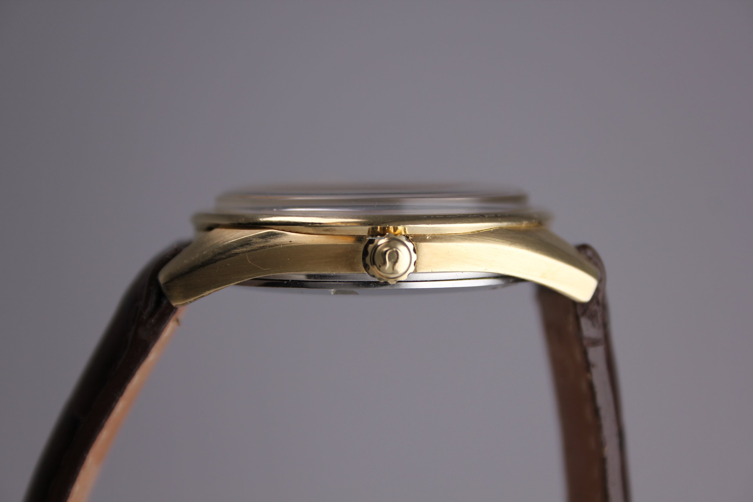

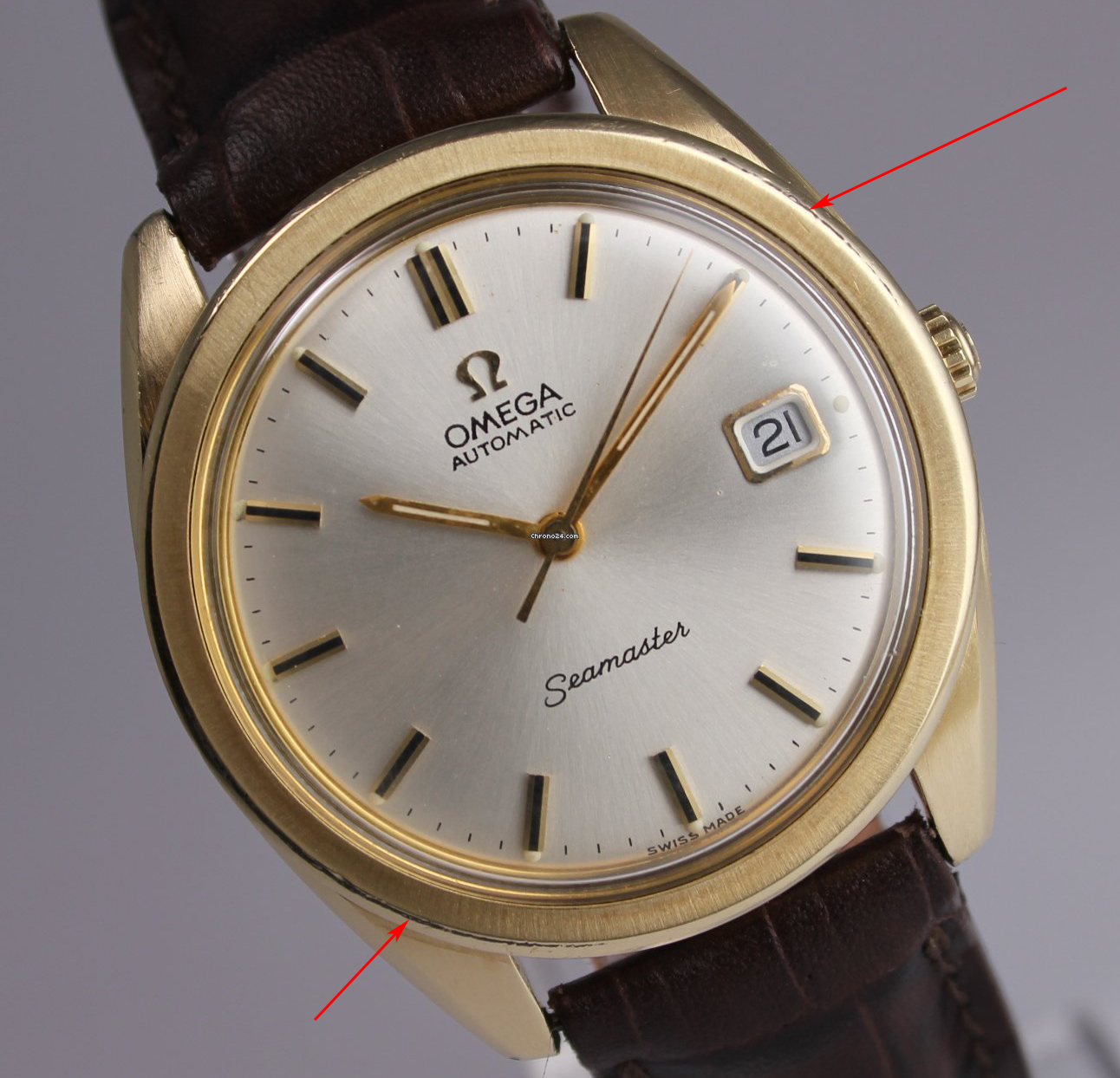

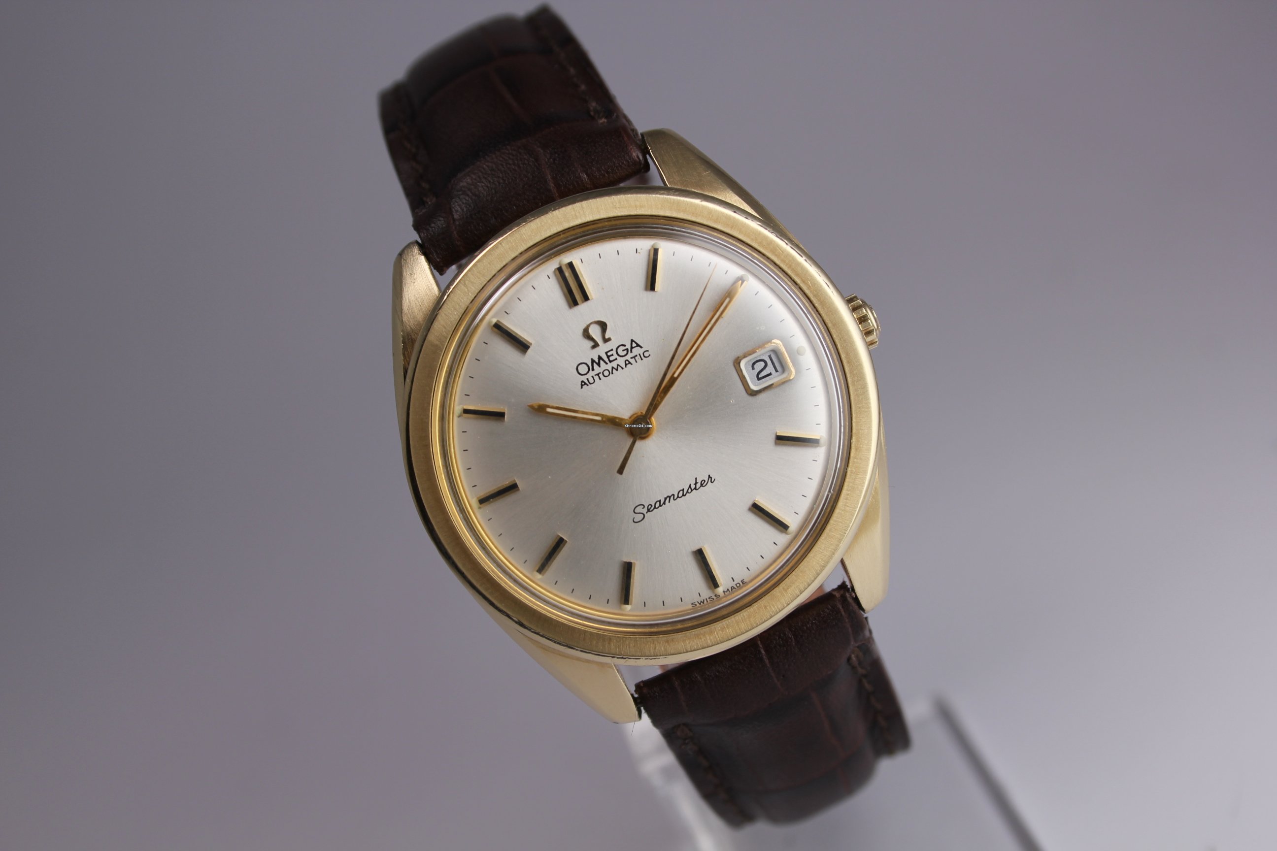

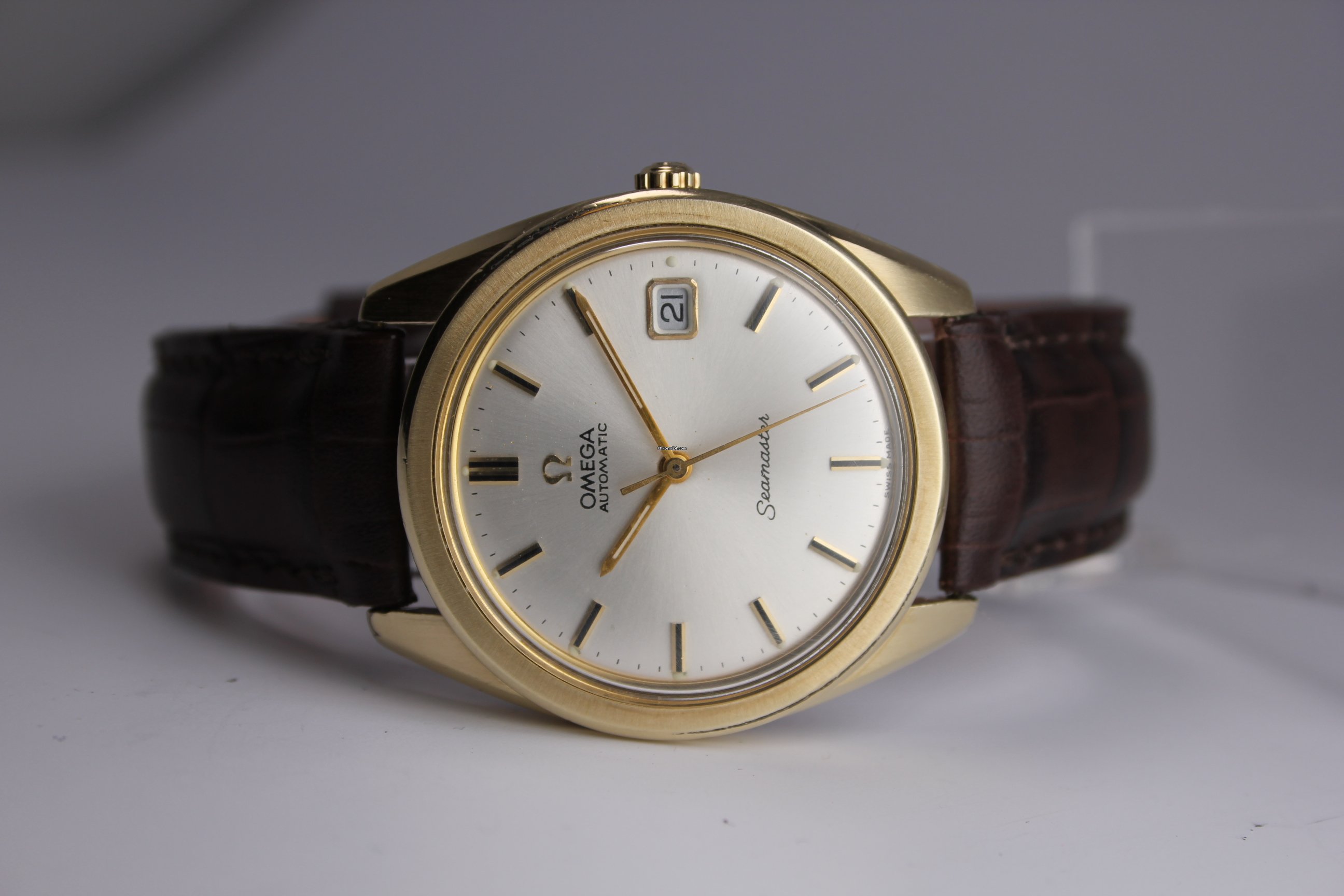

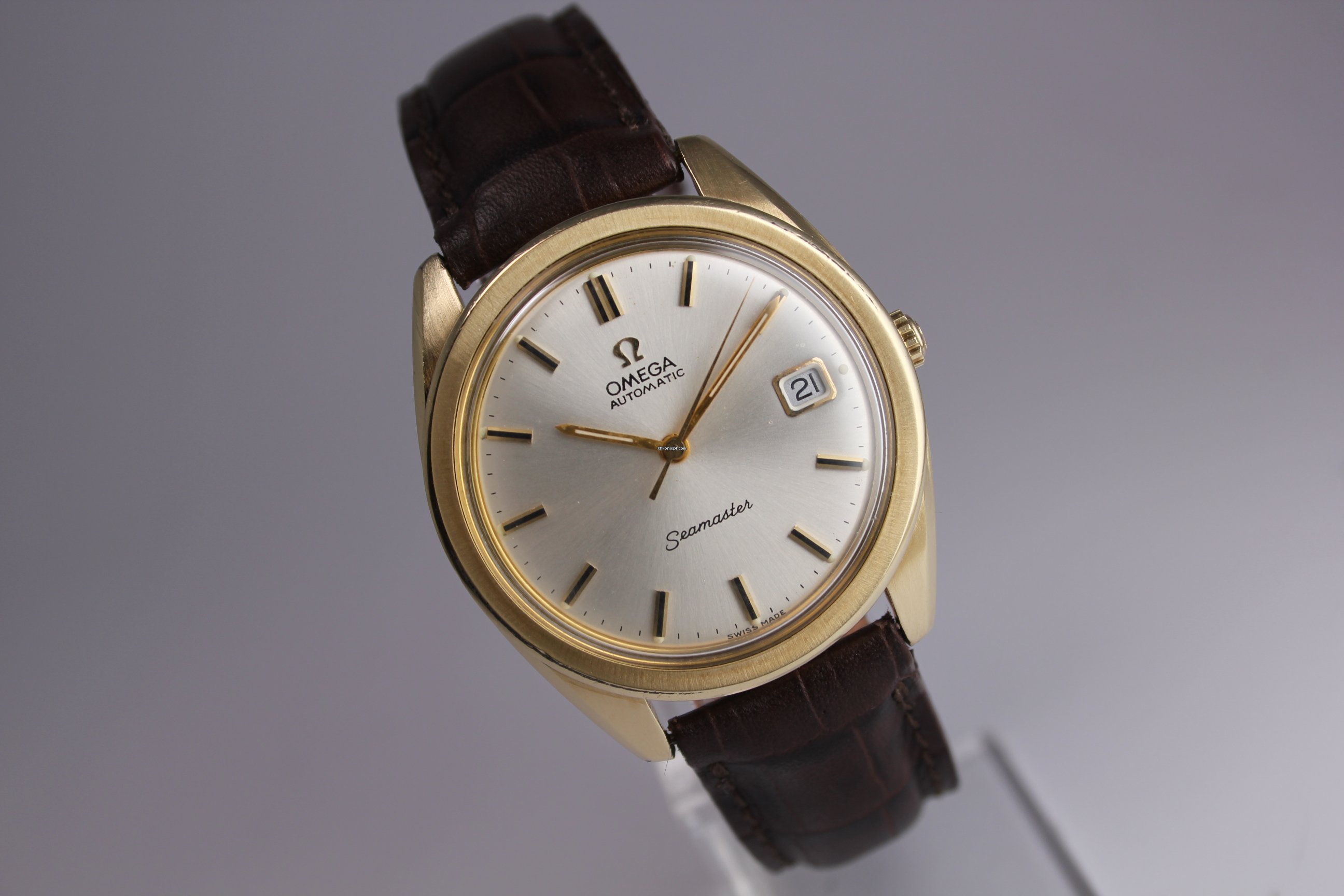

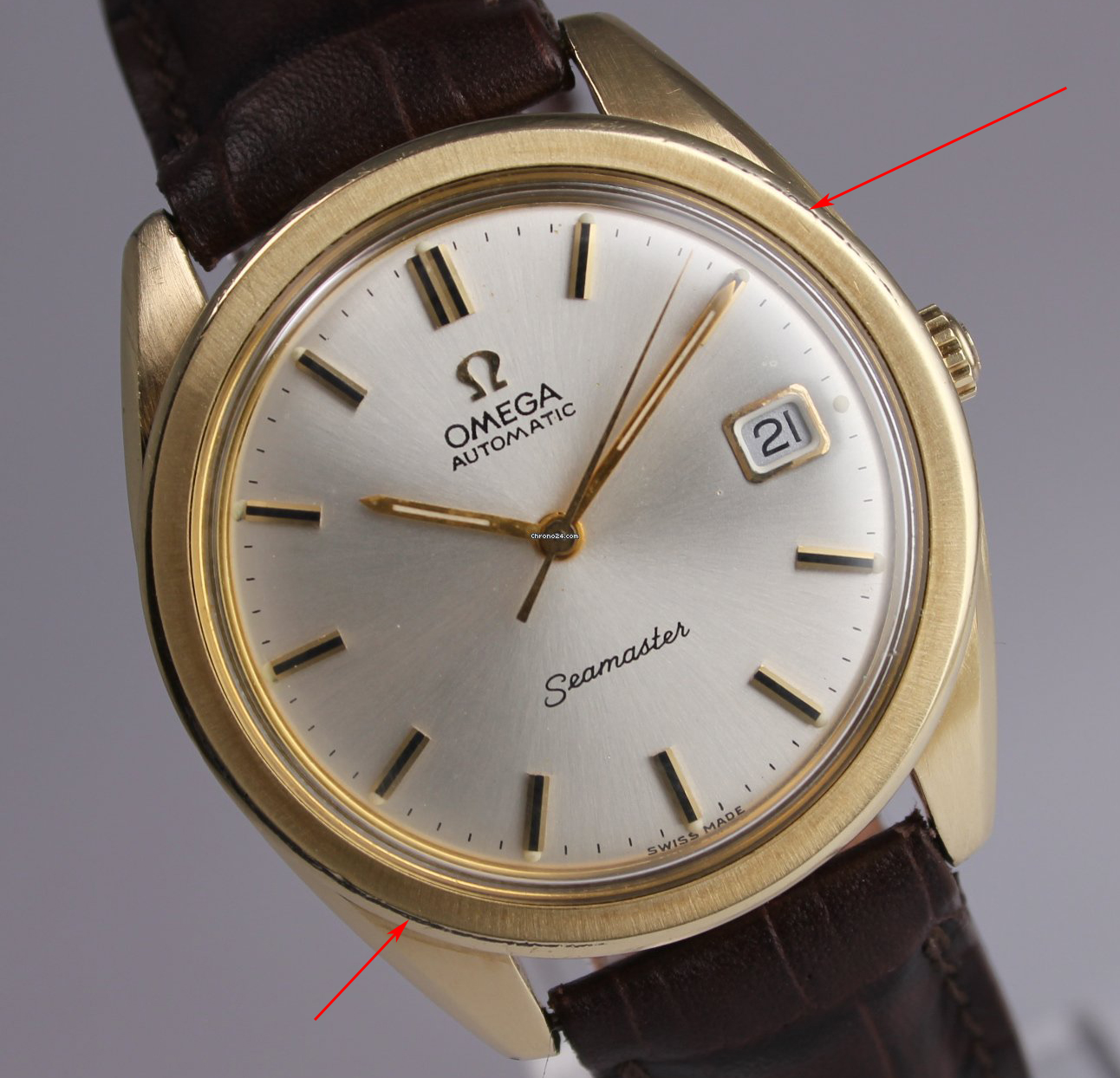

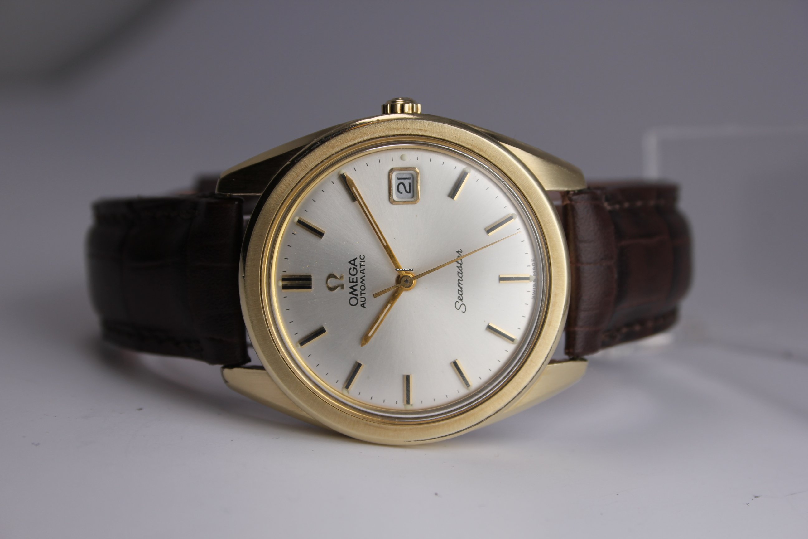

ROUND 2: My wife is "surprising" me with a wonderful 5th anniversary gift of a vintage Omega Seamaster. This is our first foray into what we would consider a more serious watch, and want to make sure we do well. This is my second thread on the matter, and I've spent all day honing my recognition skills. Still definitely a novice. Upon our further search we have found this 1969 Seamaster 2281 CD 166.028.
My initial concern after learning more is that this too may be a redial, so please let me know your thoughts. My concerns were:
1) The "Omega" script does not look as clear as the Seamaster script. Is it painted?
2) The luminous elements look to my untrained eye to be likely "too new" to be from 1969.
It seems my other half is more drawn to the newer appearance of a refurbished watch, while I'm inclined to appreciate the healthy aging of a true vintage, so we need to find the right vintage that looks nearly immaculate I presume.
Omega Seamaster 2281 (ref. CD 166.028)
Other information:
Price: $1,368 plus $73 shipping
Case Material: Steel
Bracelet Material: Leather
Year of Production: 1969
Movement: Automatic 565
Crystal: Plexiglass (assuming this is a no no?)
Dial: Silver
Inform away!

Oddly enough, the crown looks to be too old for 1969. I could be off here, but it has the old style Omega symbol that phased out in 1967. Perhaps it had to be replaced, and the watchmaker had old stock on hand.
I am not sure about the gold capped version, but I wonder if it should have the black inlays on hands with lume only near the tip like this watch:
https://omegaforums.net/threads/omega-seamaster-166-028-166-022-case.65456/
Plexiglass is correct for this era, you can call it hesilite if it makes you feel better. That is what Omega does.

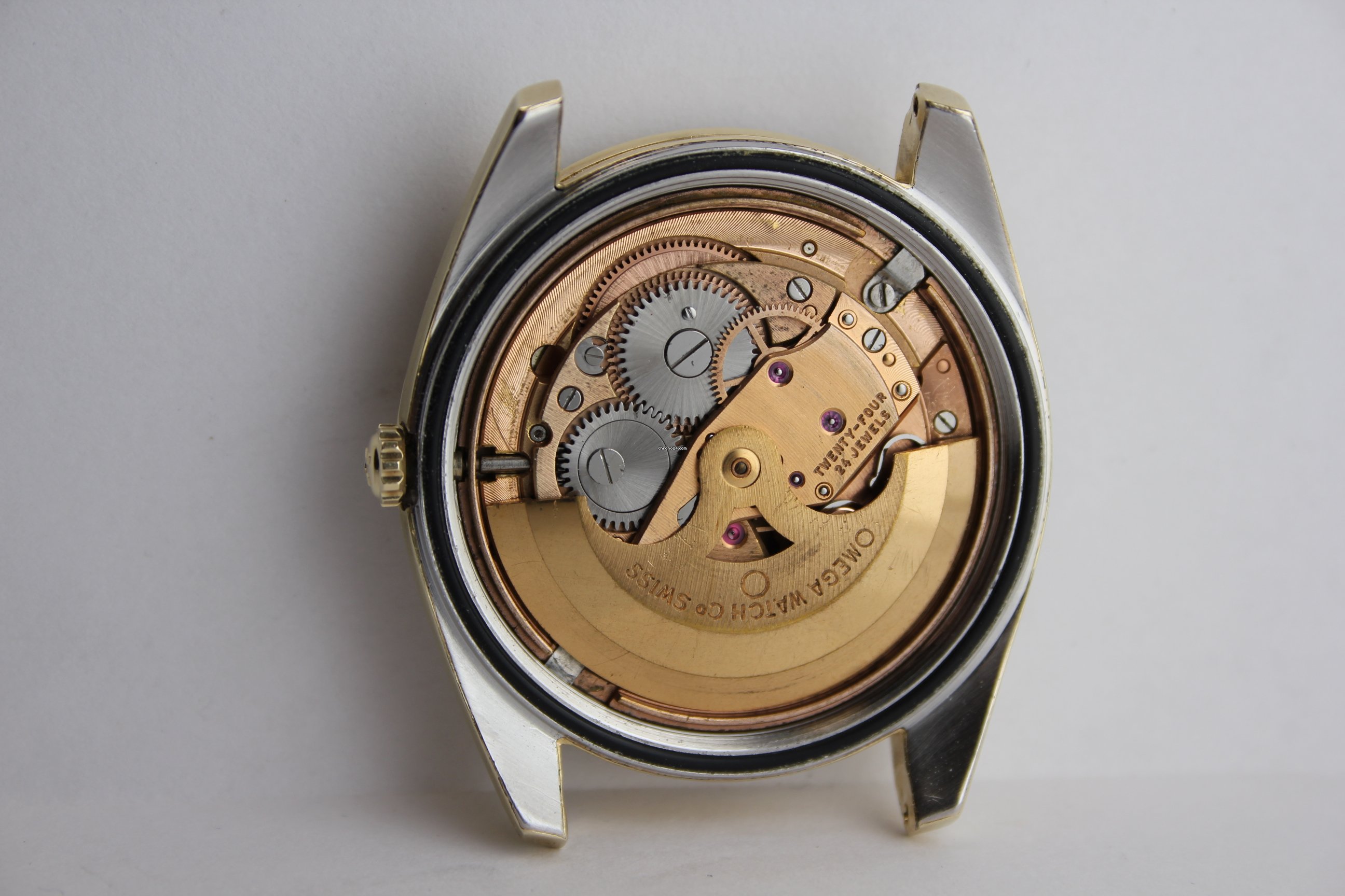

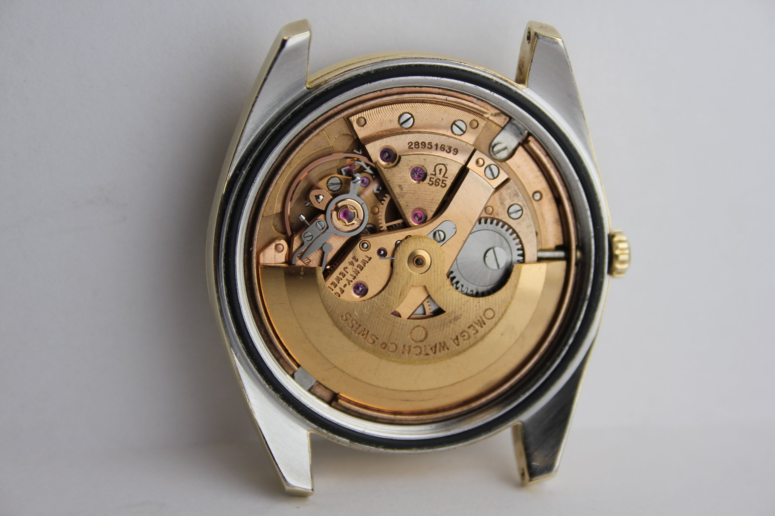

I don't see any other issues, but I am still a novice. Wait for the real experts to weigh in. Has it been fully serviced with a guarantee? If so, I would say the price is high but not outrageous. If not price definitely too high.

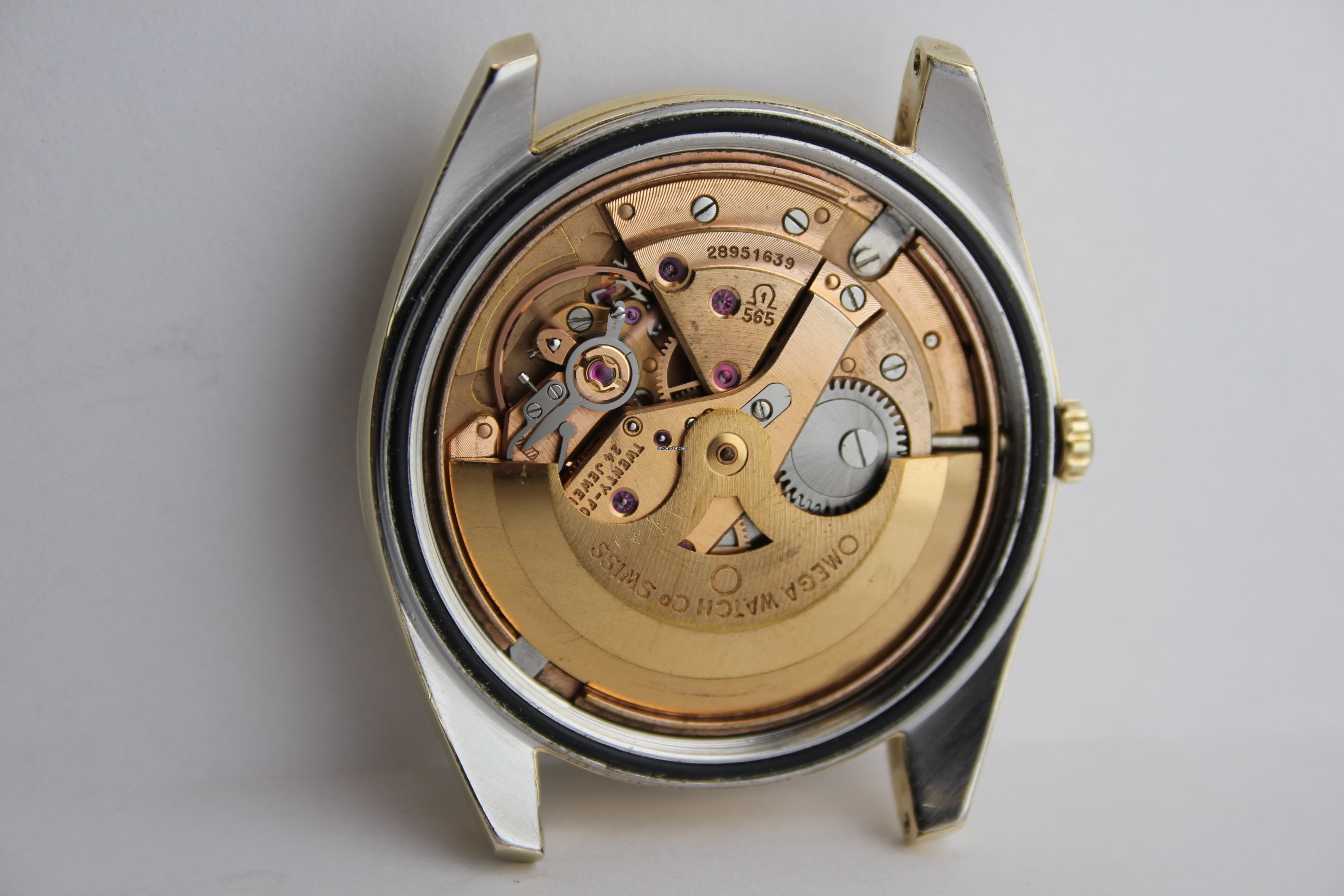

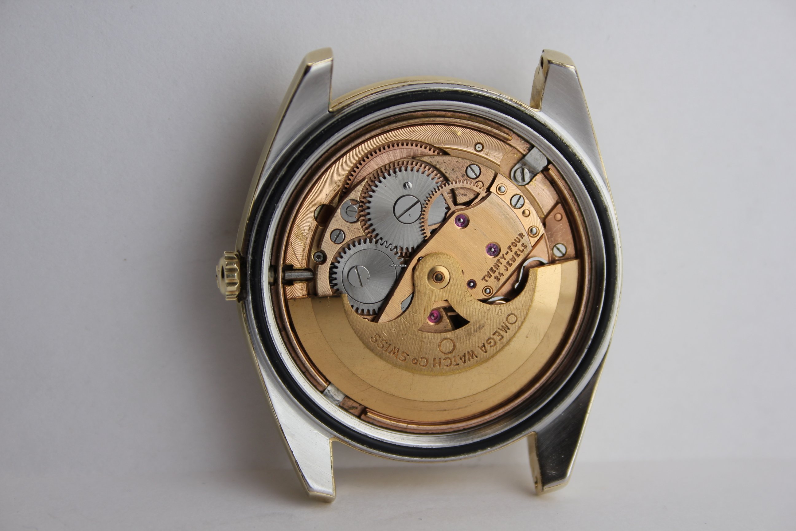

Edit: Movement looks to need a service, aka looks dirty. Rotor has been replaced at some point (not a big deal).

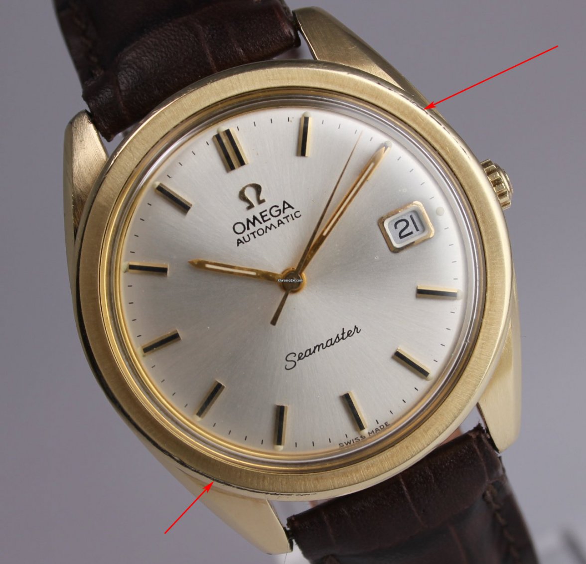

Looks like a tarted up resale watch.
Refinished dial, OMEGA and AUTOMATIC are not nearly crisp enough.
Bezel has wear on the edges from over aggressive refinishing.
Price silly.
PASS.

A pass for me as well for the reasons previously stated.

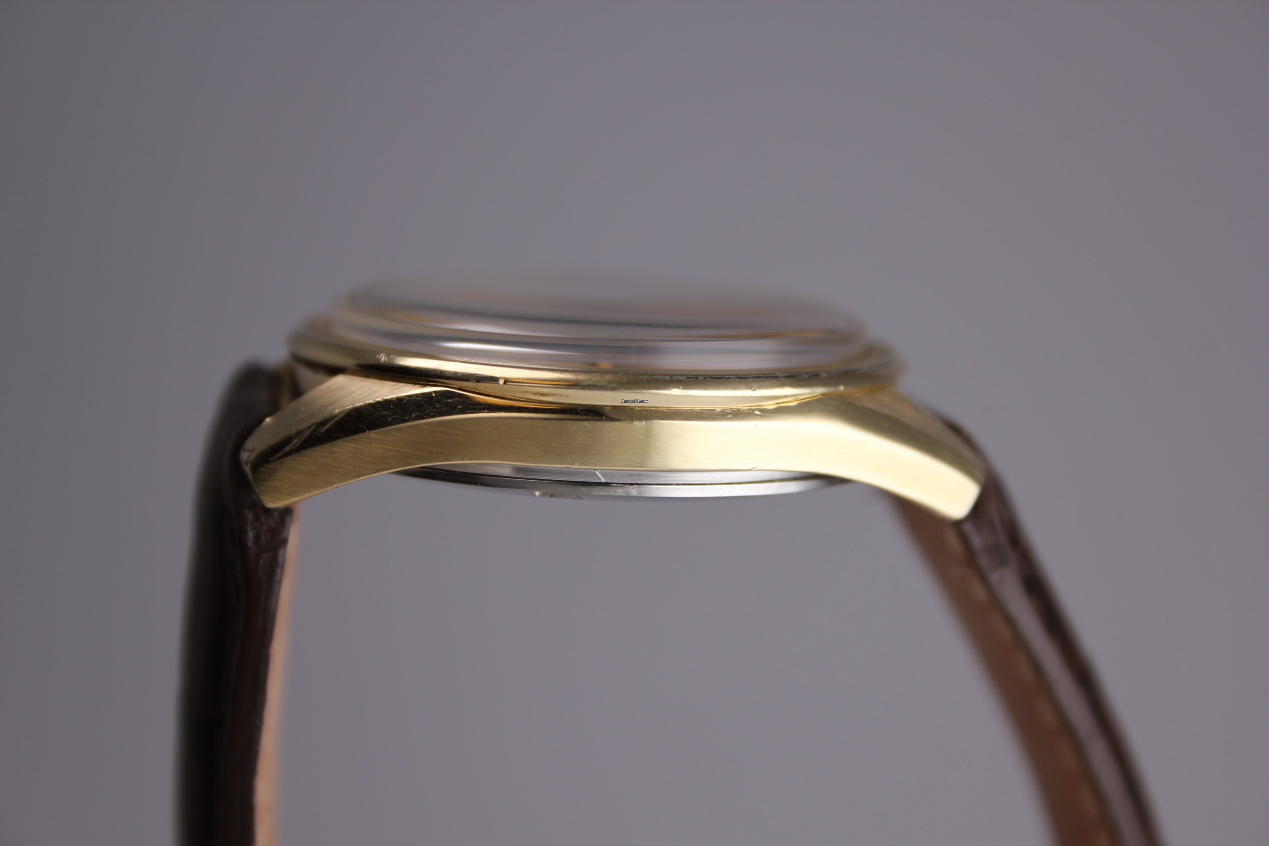

Few weeks ago I was offered exactly the same reference, but these goldcapped cases is so hard to find in good condition nowadays. This one seems too worn, the other one I was offered had huge dings so I saw the steel case thtough gold layer. Skip it, you'll find another one in better condition for better price!
