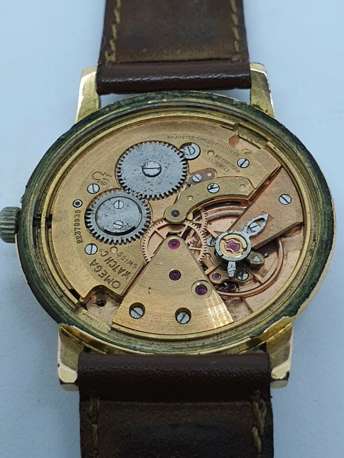

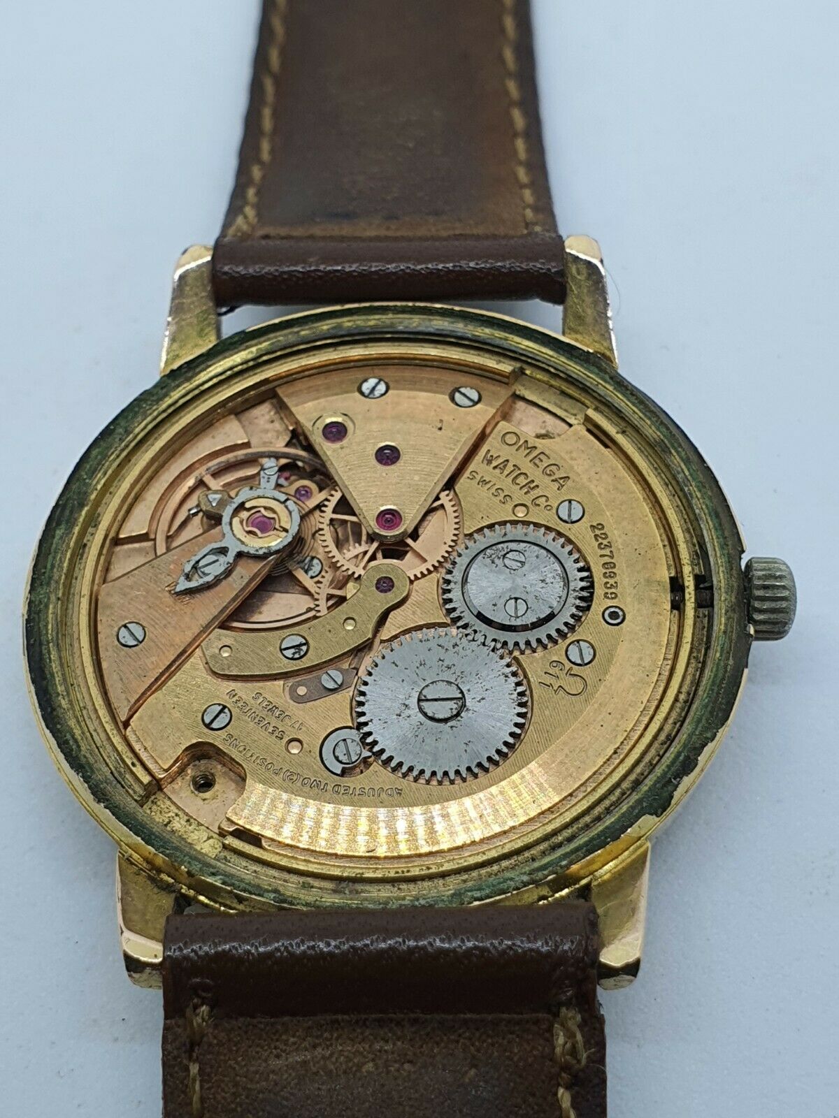

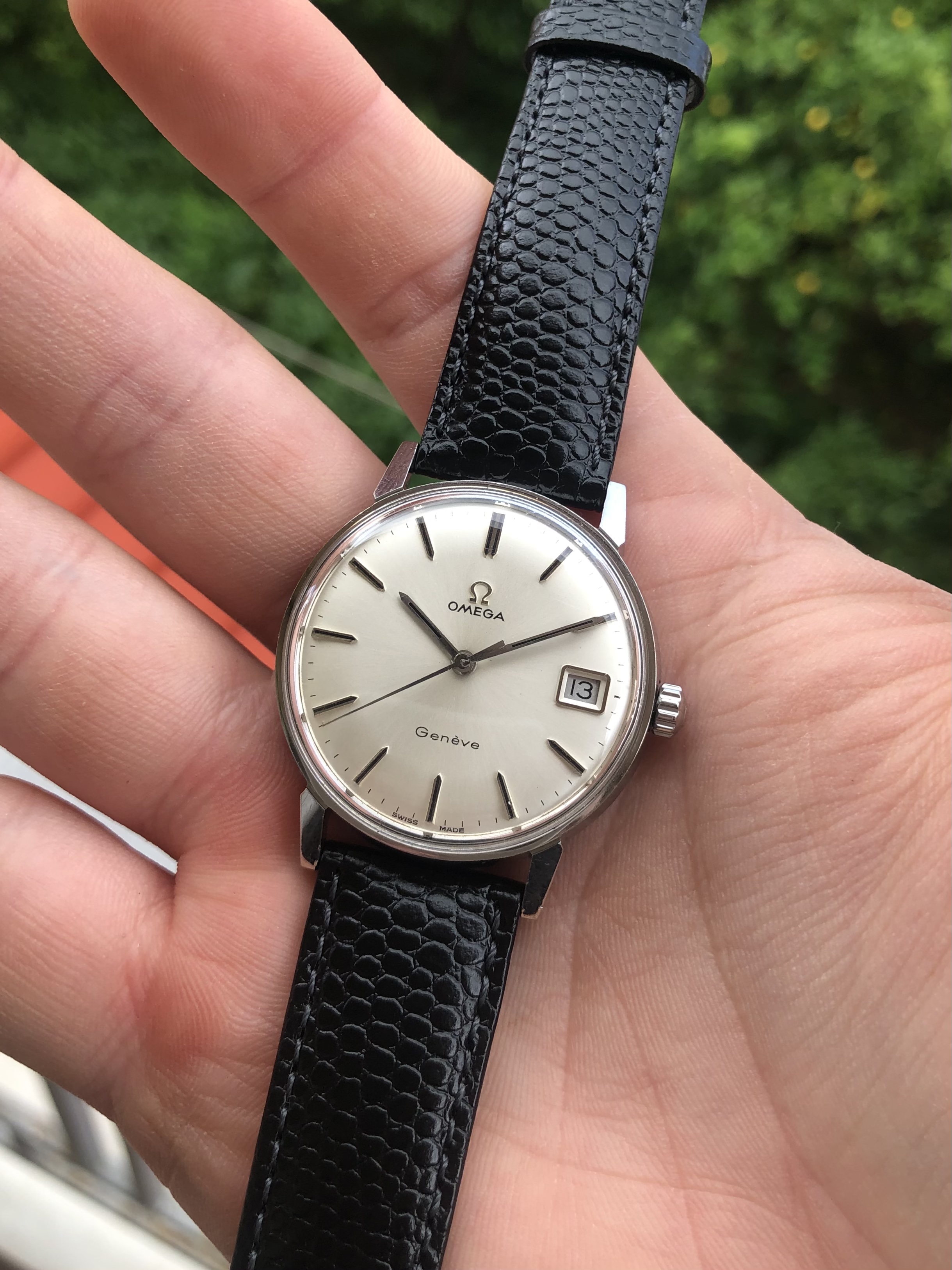

hello guys, in my small watch journey it happens to own around 25-30 omegas , i had just receive from ebay a beautifull 136.011 with the caliber 613 . When i took it to my hands to inspect it everything was good , i try to wind and after 4-5 winds i hear a snap and now it doesnt work at all, i can still change the hours but it doesnt work, needles to say i didnt feel any resistance like when you wind a manual watch . what i can right now ? i should sent it back ?Thank you very much in advance!

Sounds like if the mainspring has snapped, or its attachment to the arbor.
If was sold to you as serviced, you should send it back. If not, replacing the mainspring is an easy enough job to do , during the movement overhaul

Well, since it was sold as is, and the mainspring snapped while in your possession, it looks like your bad luck. Mainspring is always replaced at service by reputable service providers, so this doesn't add anything to your service costs. Get it serviced and enjoy.

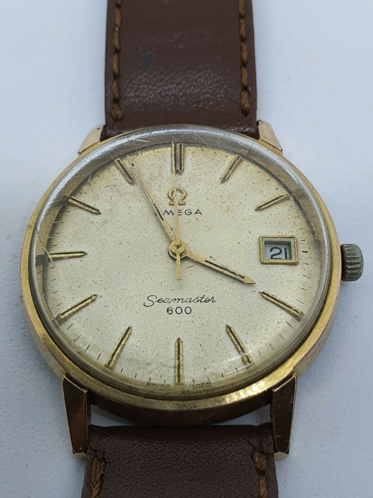

Please post a pic, let's see what you've got!
I always assume, if the seller doesn't state that the watch has been serviced, it's going to need service ASAP.
