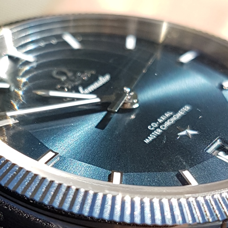

Not an expert in macro photo shots, but I though it was worth the try ...

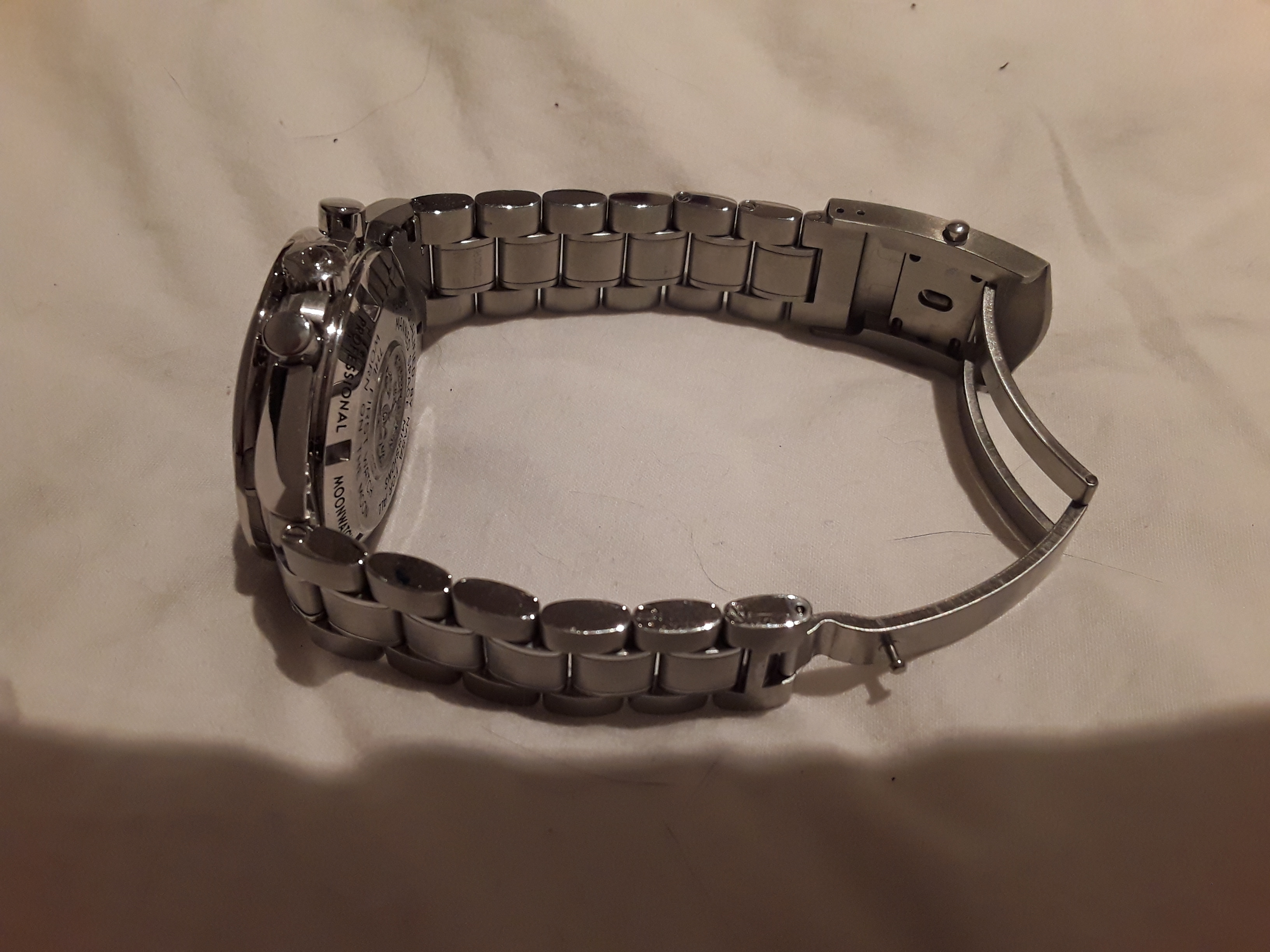

This is my Omegas Speedy Pro in the latest incarnation with the big box. You can see how many links are in my bracelet. How many links do you think will be removed from a GM that will fit me? If you are 18 and you took 1 link out, then I'll have 2 to 3 out which would mean the watch will weigh 161 minus 4 to 6 g. Resulting 155g. That's halfway between a ceramic smp and a ceramic sub. That's awfully heavy for a dress/ sports watch!!
1,813
9,397
Assuming the OEM and after-market bracelets are the same size I would guess you would need to remove 2 links max. It looks like the GM is going to be too heavy for you. Maybe you should try a Grand Seiko SBGJ211 or SBGJ213, they are ultra lightweight Titanium and quite dressy. Take a look here:-

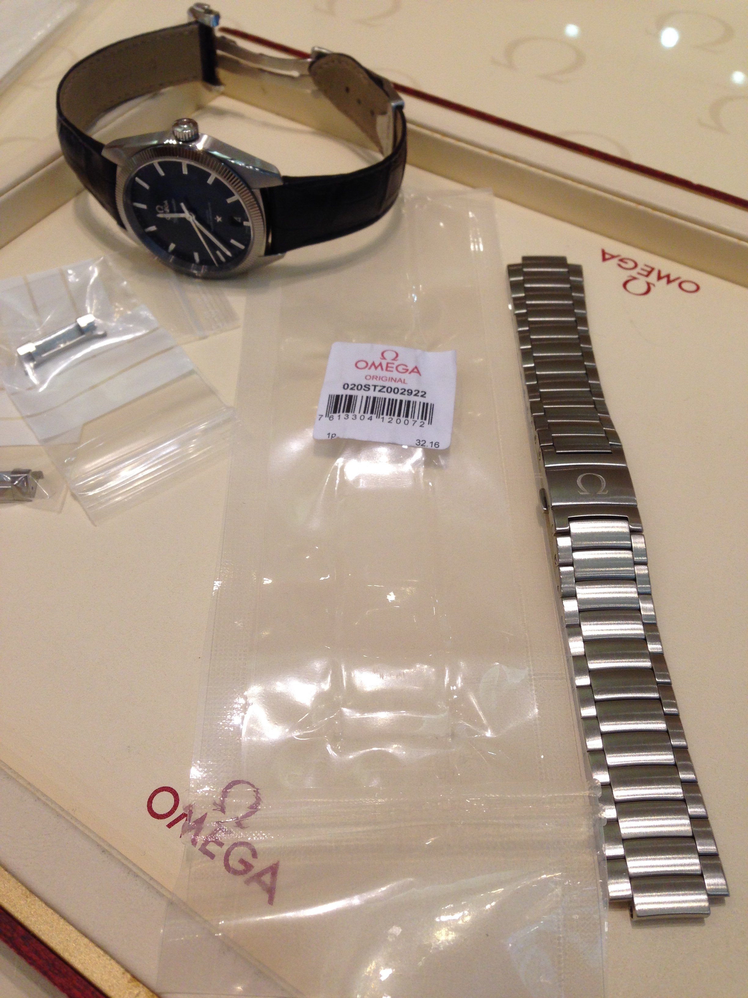

I’m not sure what the full Omega part numbers are for the dark blue strap and stainless steel deployant clasp, but these are the numbers that I found on those two parts respectively:-
