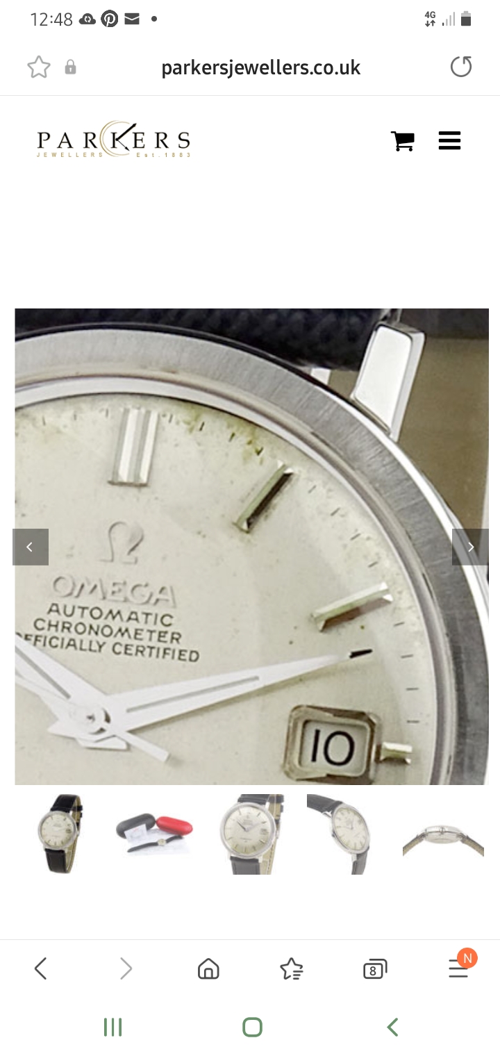

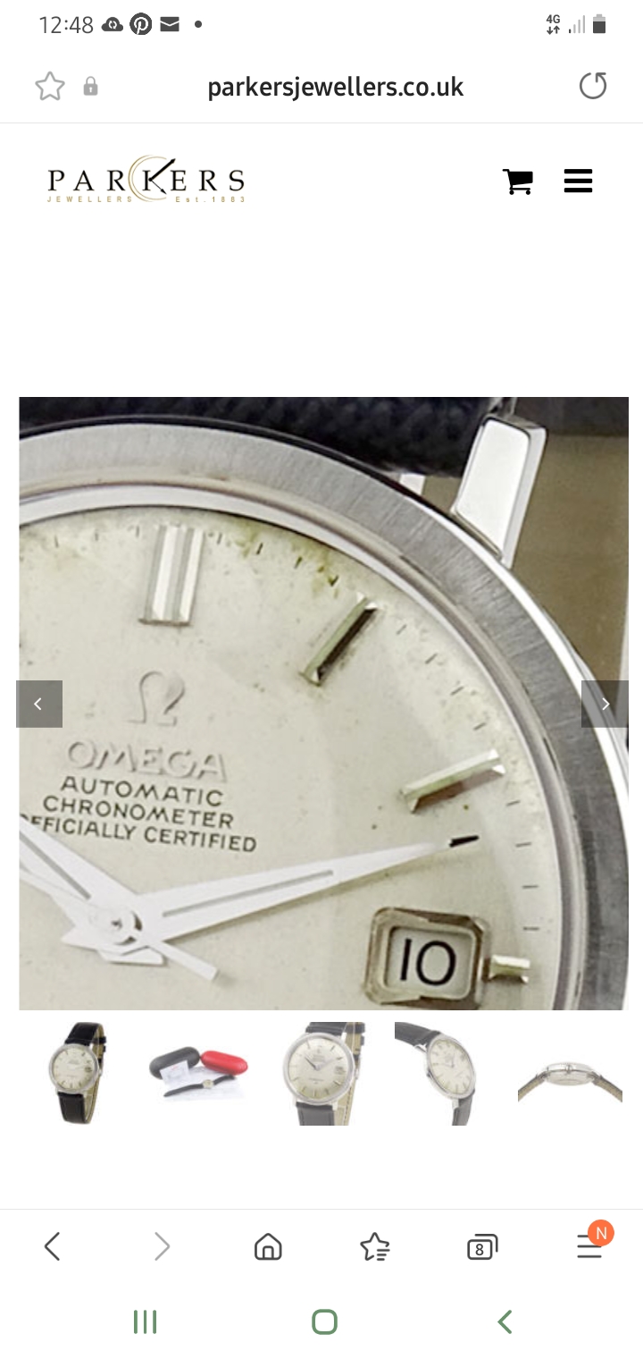

There is a Constellation in the shop that has slight dial blemishes but is good otherwise. It's 1966, dated and 564 calibre so not ticking everything but the nicest watch I've seen so far. Hands look immaculate compared with dial - would Omega replace element of watch if too shabby? Any thoughts?

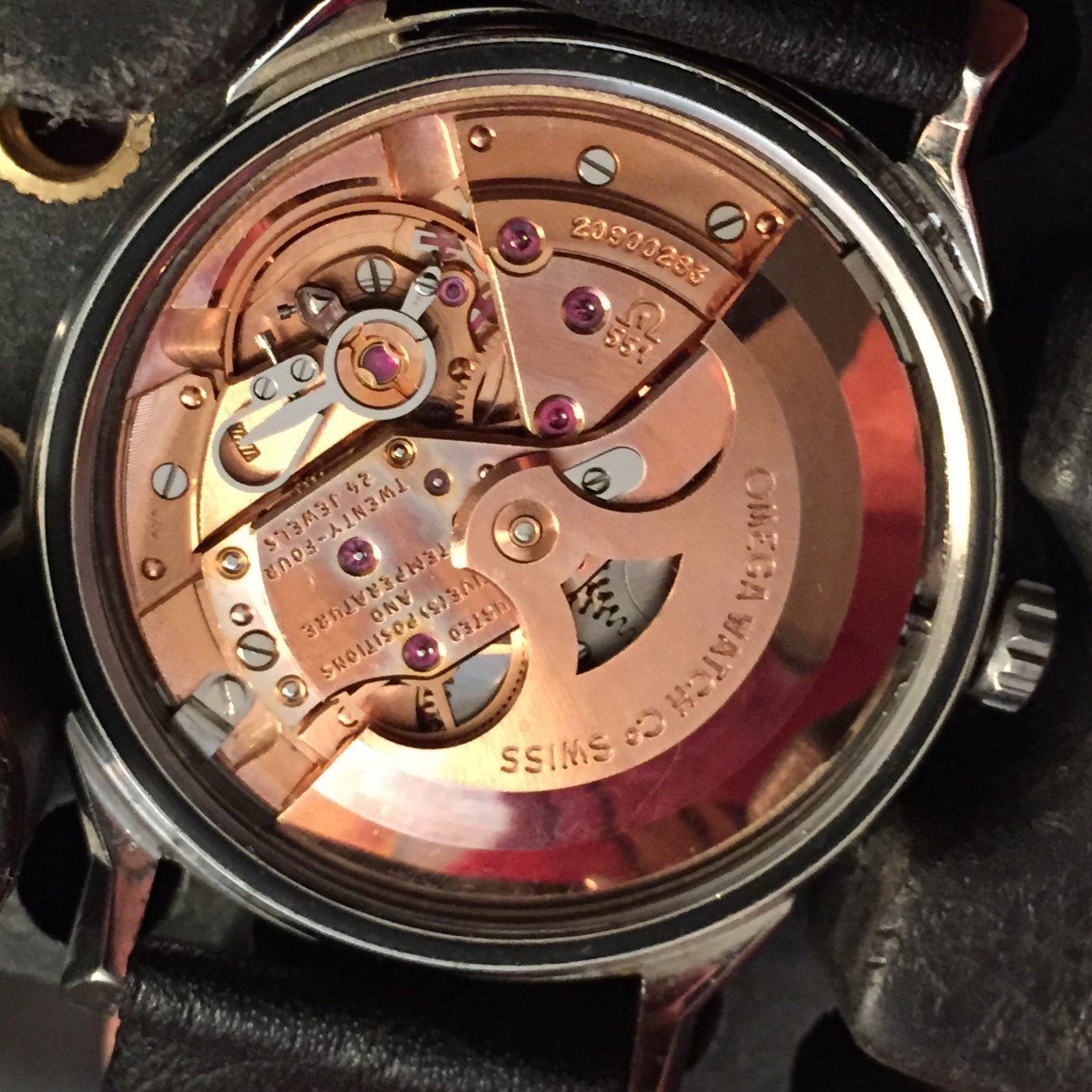

551 movement inside

That dial is not attractive. I’d you buy that, a few days/weeks/months from now you’ll likely regret it.

You can find much better than the one you posted (the greenish funk is water damage). Constellations of this period can be eye watering for prices, but Seamasters are still relatively reasonable,

I have some concerns about the one you show from Parker’s - it looks like a 168.018 case, which can have a 564 but should have a flat ( not dome) dial and was first released in 67
(And just FYI - Parker’s can be very expensive)
if you like the style of the one from Parker’s, research 168.004, 168.010 dome dials
You won’t get your birth year but they are very lovely watches.
Edit - I should have mentioned these only come with a date complication.

Parker's aren't known for anything but being straight but as I said I have concerns about the watch pictured that they might know nothing of - a good example of "option A'.
