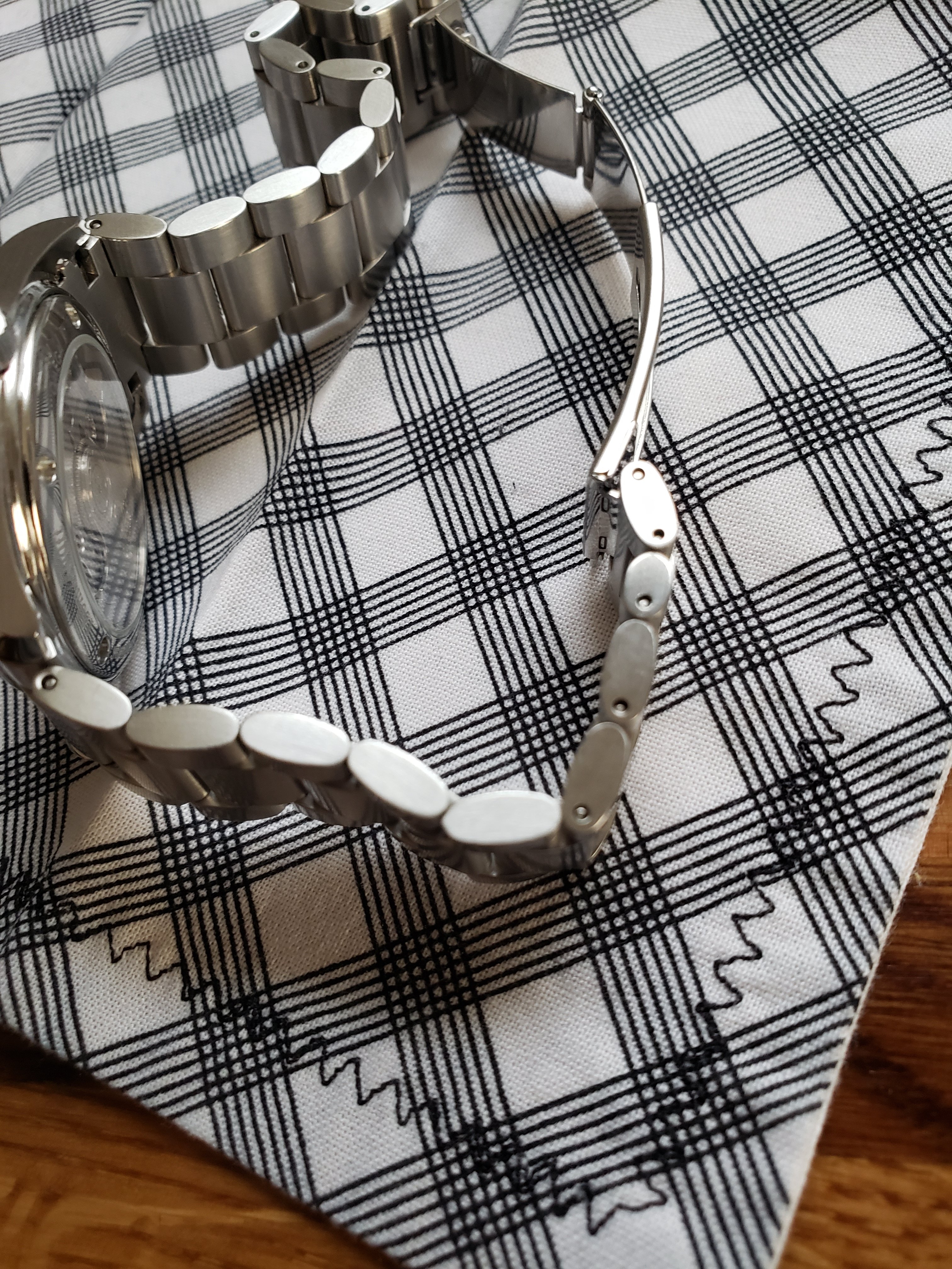

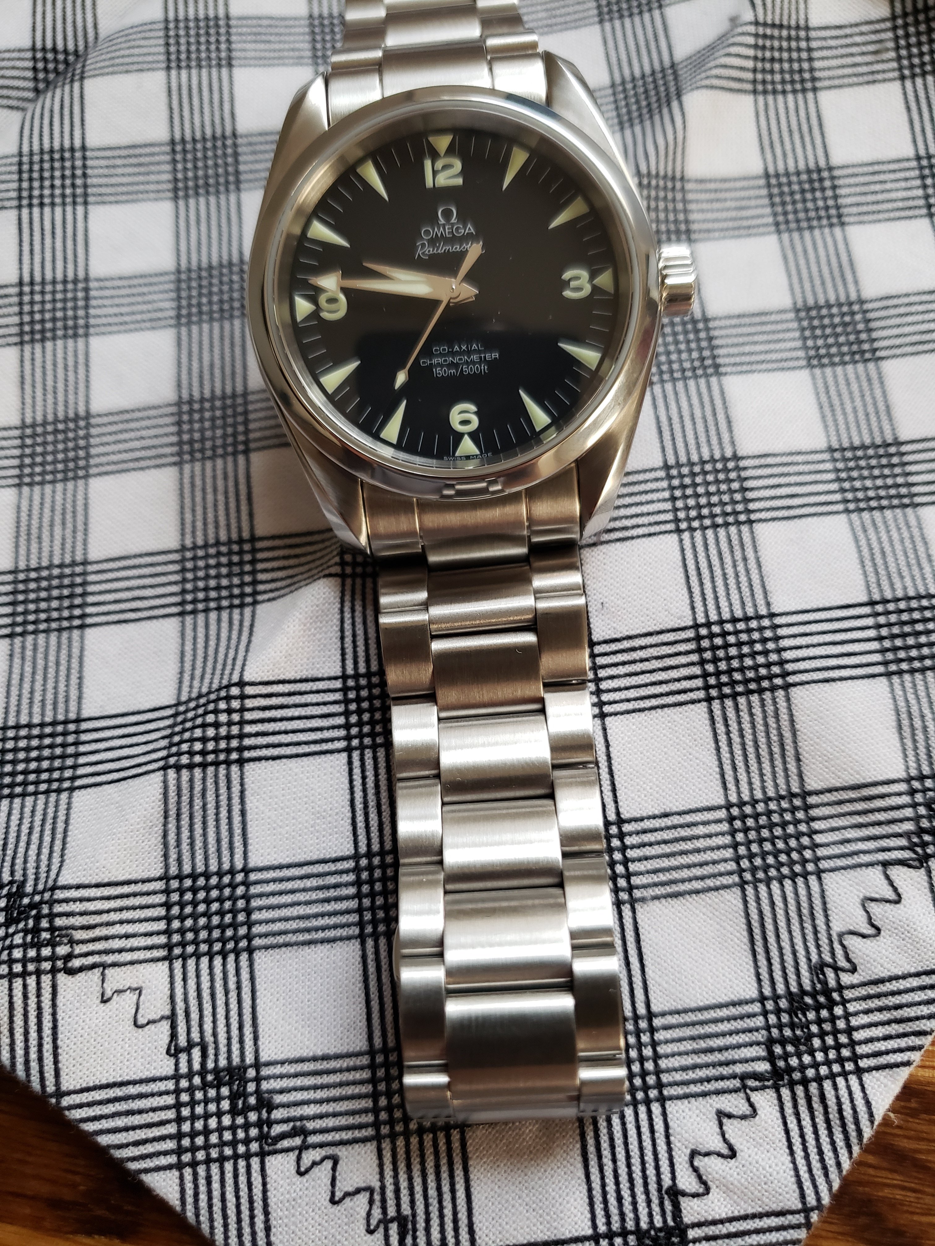

I just received my 36mm railmaster and I couldn't be happier but it needs either a full or a half link removed to fit properly. Unlike the speedy pro I have which was pretty straight forward on sizing, I can't find any info on how to size this style with the pin and barrel design.
Do I need to go to a boutique or buy a pin pusher tool? (I have no clue what the tool would be called) I see the arrow or direction marker on the bracelet so I assume, like other non omega watches I own, that's the direction the pin needs to be pushed. However unlike my cheaper watches I don't want to trial and error this journey Haha.
Any info would be awesome and if I need a specific tool I welcome suggestions on that as well.

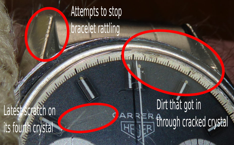

It's not your watch until you have personalised it! Like this:
Who knows what further damage I'll do in the next 40-something years of wearing it.
But it still looks great on the wrist 😜 😉

I went to an AD and they took care of it. I also ordered the pin tool so I can fine tune it myself. Took out a half link and it was still way too loose so he put it back in and took out a full and it fits good but I feel like it might be too loose still. It will probably be perfect in the summer but little loose now.
My initial question was really the process. Can I use the reverse side of my spring bar tool (the pin end) and just push it out by hand or would a tool be necessary. I know now it's in there good so I just ordered a simple pusher. As a machisnt I work with stuff like this day in and day out but when theres no instructions (looked everywhere online but nothing for this type of omega bracelet) I'm a little more hesitant when I cant just scrap the part I'm working on and start over Haha. Oh and a hammer was never an option, I dont even do that to my Tissots or even my Seikos lol. This watch took me a while to find and the condition its absolutely flawless.... borderline brand new so I'm just being over cautious.

MRC MRC
I guess none of my watches are mine yet 😁😁😁

Sounds like you need 2 half links. Interesting fact, 2 half links do NOT equal 1 full link. It's actually a little longer.
Not sure what spring bar tool you're referring to without a picture, but I think you're talking about the one with like a forked end for the spring bar and a regular round tip at the other end. If so, (1) the pin of the tool is not going to be long enough as it needs to go fully beyond the center link which is where the collar sits, and (2) it's near impossible to push it out like that unless the collar is worn.
