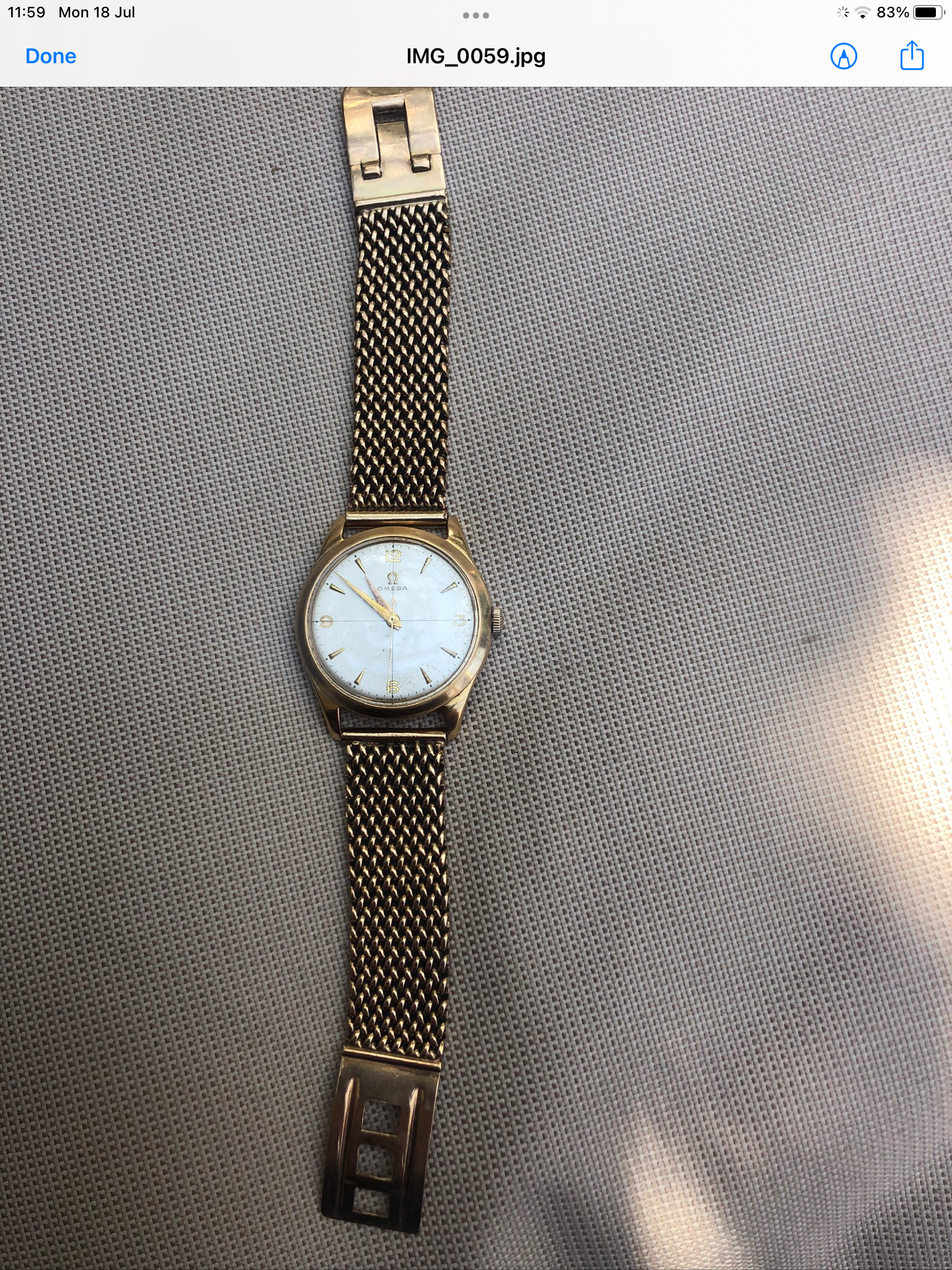

I have had this vintage Omega manual wind 36mm watch for a number of years. I had it serviced when I first got it, and the movement was photographed at the time. Unfortunately I cannot find the images. I do know that all of the movement was gold. The case is marked 18ct and I imagine the movement is too. It keeps excellent time and has an Omega button. I’ve struggled to find anything the same or similar on line. I’m reluctant to attempt to take off the back. Can anybody help me with its age and a value? The bracelet is Chaincraft 9ct. Many thanks. Mike

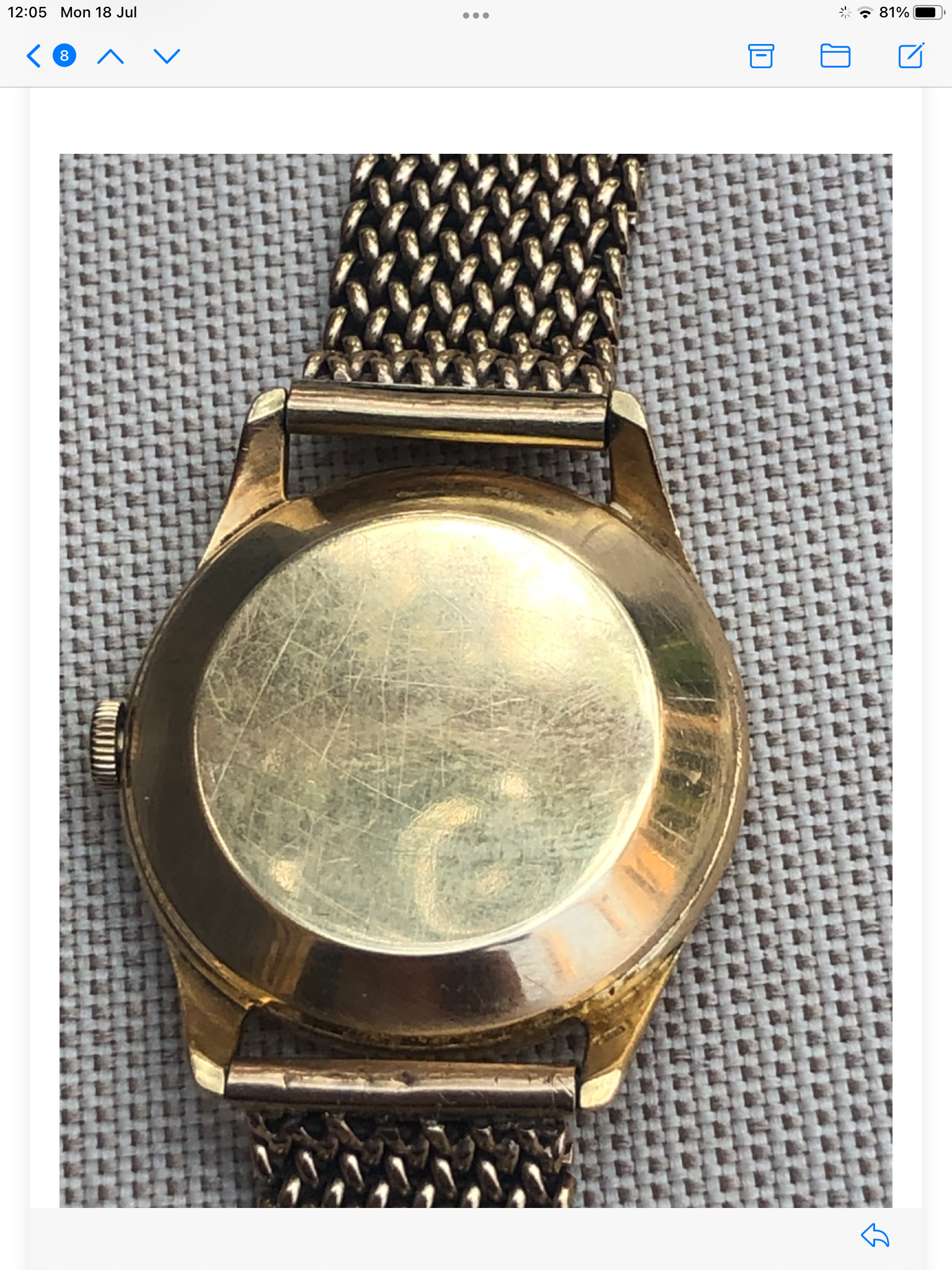

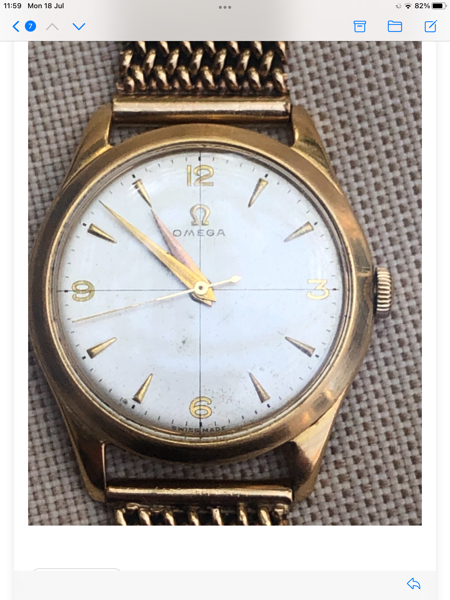

The movement most certainly wont be gold (hence Mark's post above), though it may be a bronze-gold colour as is typical for the era. One of the 30mm 28X series perhaps. The dial looks original and circa 1950s. The case could be local uk production, by Denisson or Shackman perhaps. The fact it is 36mm is unusual for the era, back when 34mm (exc crown) was more the norm. I like it. The info you need for further identification is on the inner caseback. The back is curious, normally the manual wind stuff has flat backs, that one has relief as if for an auto rotor but if it was auto it would say so on the dial. Maybe it is utility case used for both.

Mike, are the hands in different colours?

Case shape and crown reminds me of Dennison cases - would be surprised if they were not

Seeing that there is only one hallmark on the rear of the lugs certainly makes the case (!) for a national production watch. The 9ct bracelet is also an indicator of English origin/ownership.
