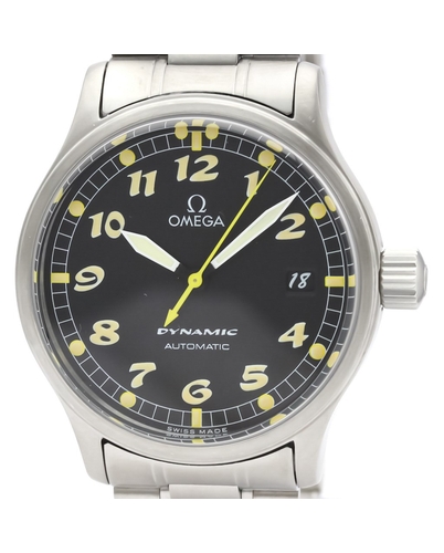

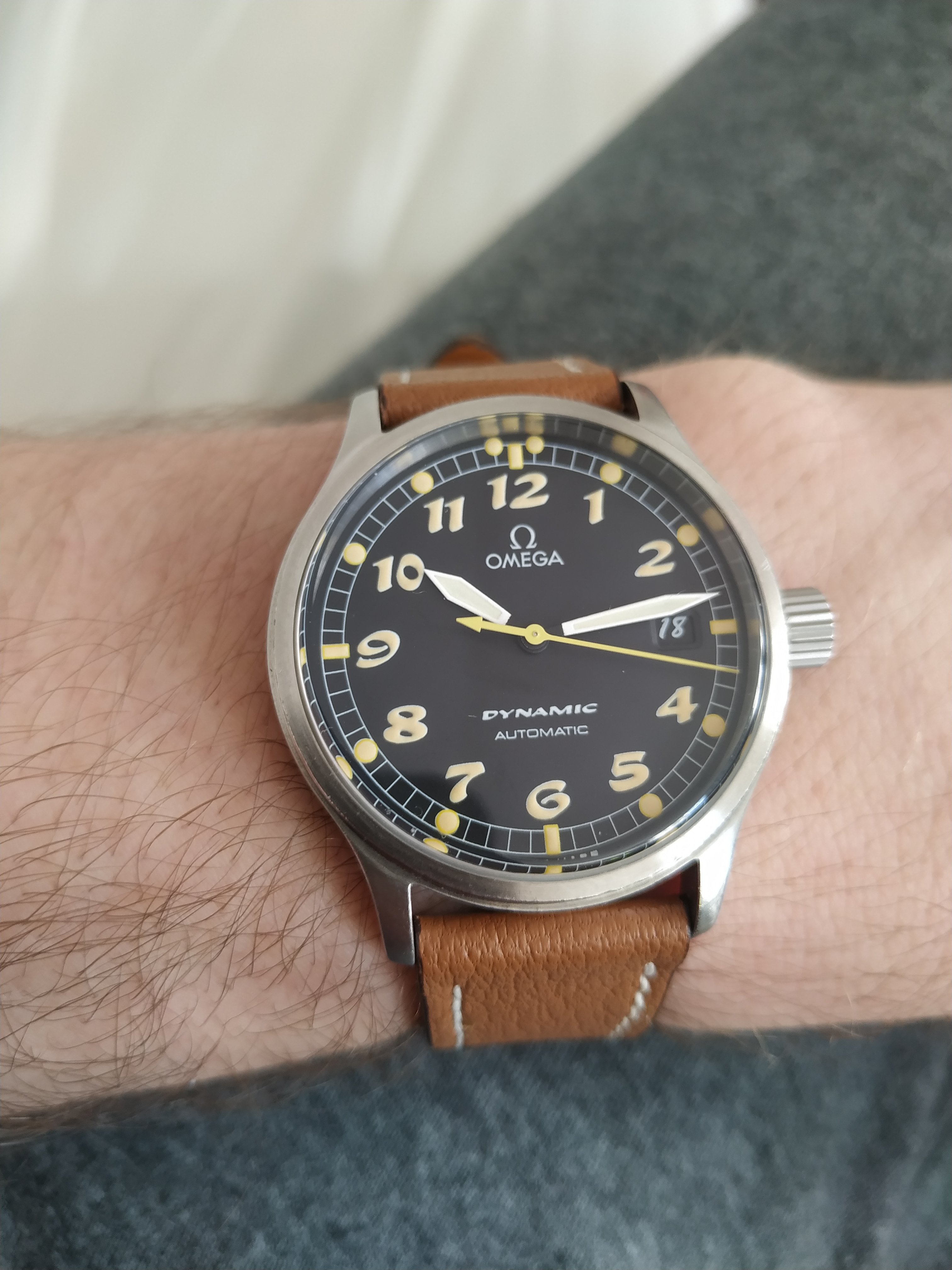

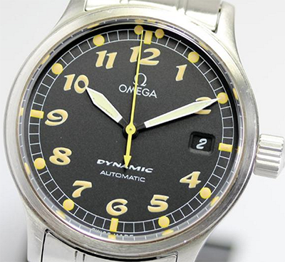

I have been searching all over the web to find differences between the models mentioned in the title but could not really find nothing. I even downloaded photos of the two models and still could not understand what’s the difference. Omega official site also does not include no information on this watch except of a totally different reference 5203???😕 🤦
If anyone has any info or experience on this omega line I would appreciate any help or info about their history and the differences of the models ...
Dynamic III 5250:
Dynamic III 5200:

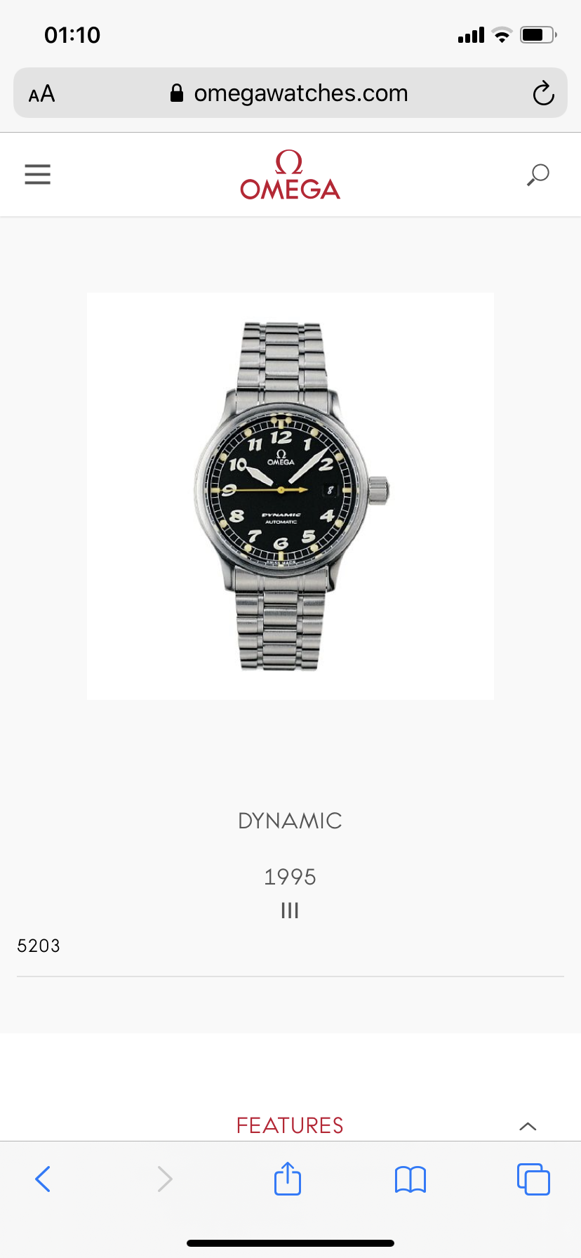

Dynamic III from Omega website :

PIC 5200 is for the watch with steel bracelet.
PIC 5250 is for the watch with strap.

Yes, 166.0310 is the reference number. 5200 etc is the PIC (Part Identification Code?).
Thank you, learned something new.👍
I guess you are right . Your vintage add above proves that. Internet is really messy . I got all the PICs with bracelet. I also mine is supposed to be 5200 but its on leather. I guess there is no way to find out the PIC of you only have the watch, or is there?

And what about 5203 on the omega watches official website?? 😕

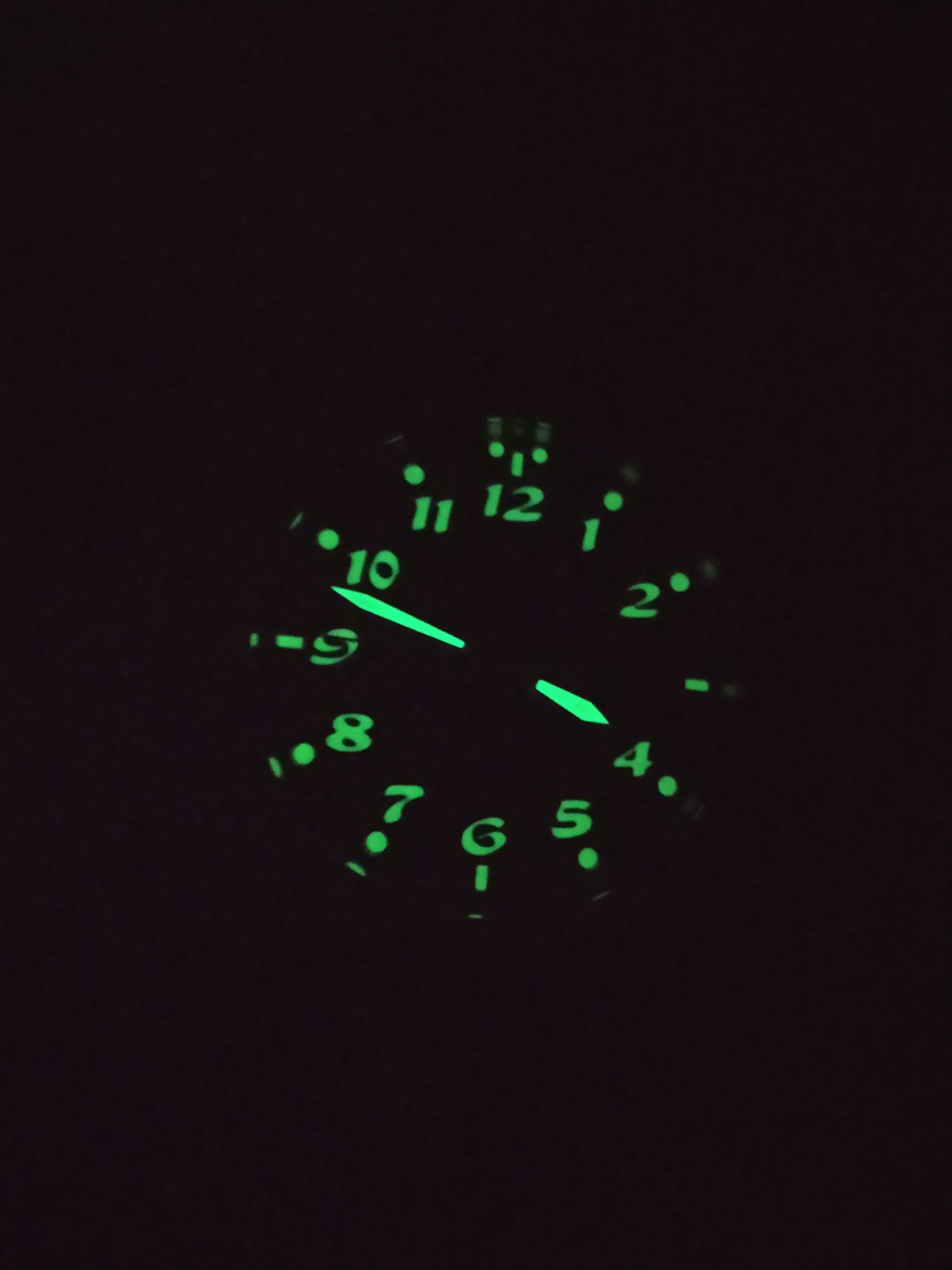

There were other dial variations seen for the Gen 3, particularly in the Japanese market but in the ROW the main differences seen in the Dynamic 3 is in the transition from tritium lume to SL. This model was produced circa 1997-98 so straddled the lume change over. Both types can be seen in the pics above, the beige examples are tritium, the whiter plot examples SL. I have an SL one, I love it.

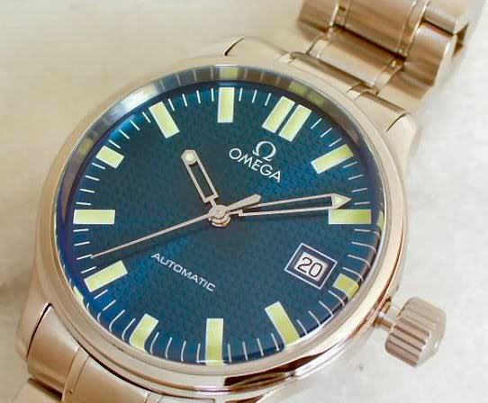

also the Targa Florio.
10,804
16,814
Was there a targa 3 hander? Only a chrono I thought but yes it’s another flavour of course. My experience with the Chrono wasn’t as happy. It put me off compound movements for life, my happy thoughts reside with the 3 hander.

Many thanks for the information provided above by JimInOz. I’ve always wondered why my example has quite orange lume, but virtually every other picture I have seen the Arabic’s look off white (well more yellow). I realise this thread is a bit old but does anyone know what bracelet this model came with? More specifically what are my chances of buying one somewhere. I assume it’s no longer available from Omega?
Bracelet is 020ST1570870, and is still available from Omega.
