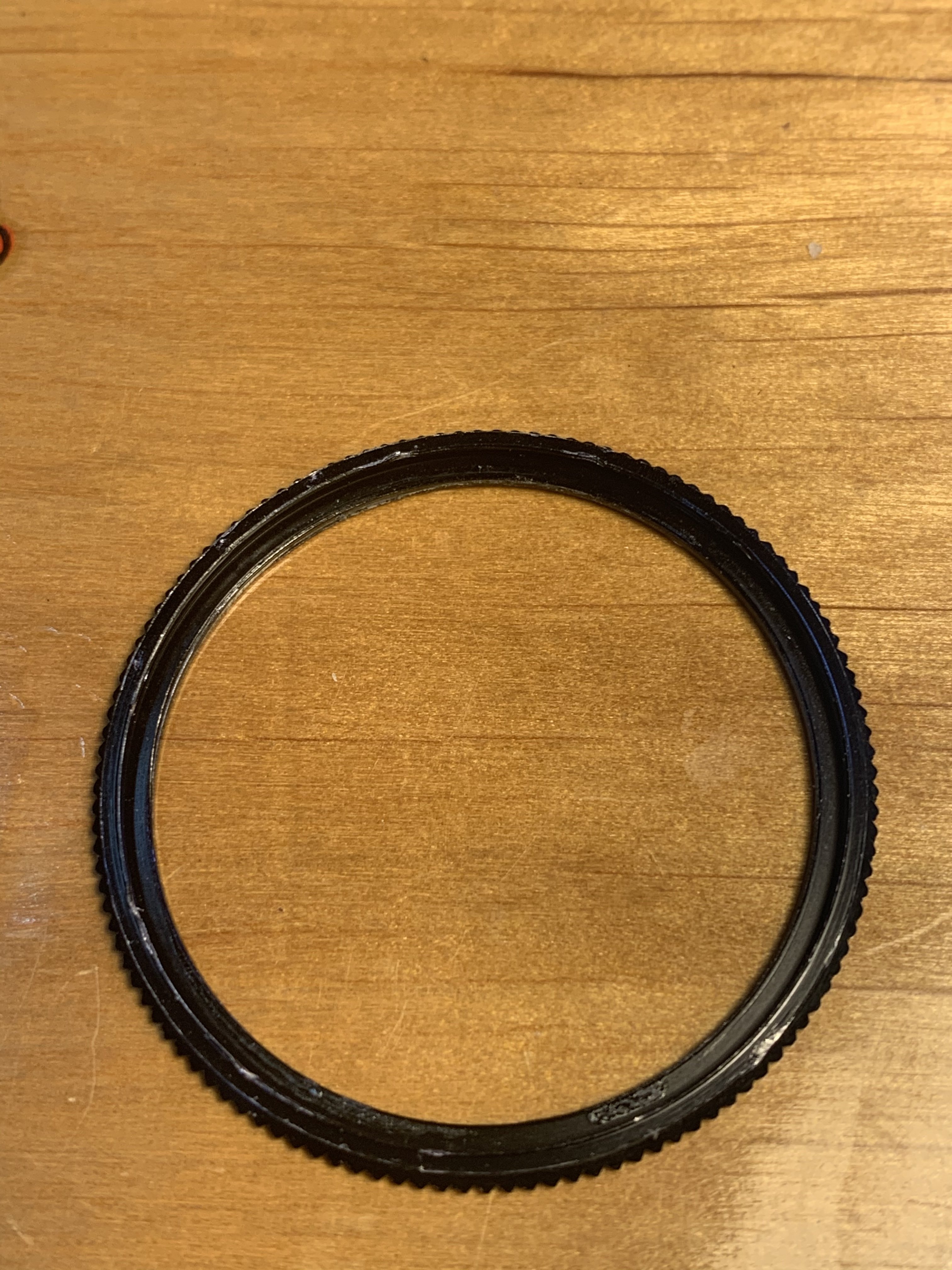

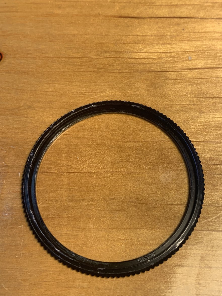

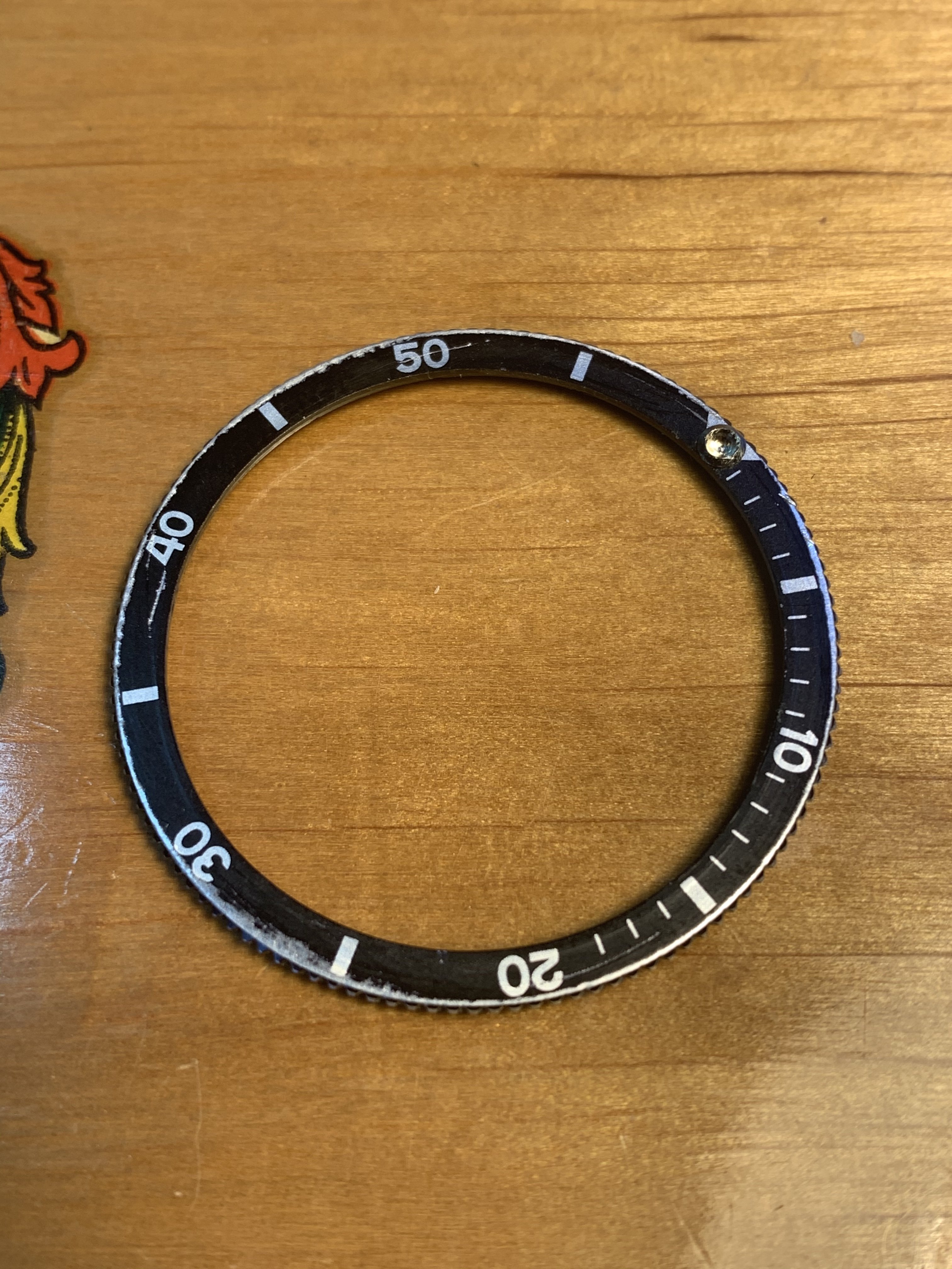

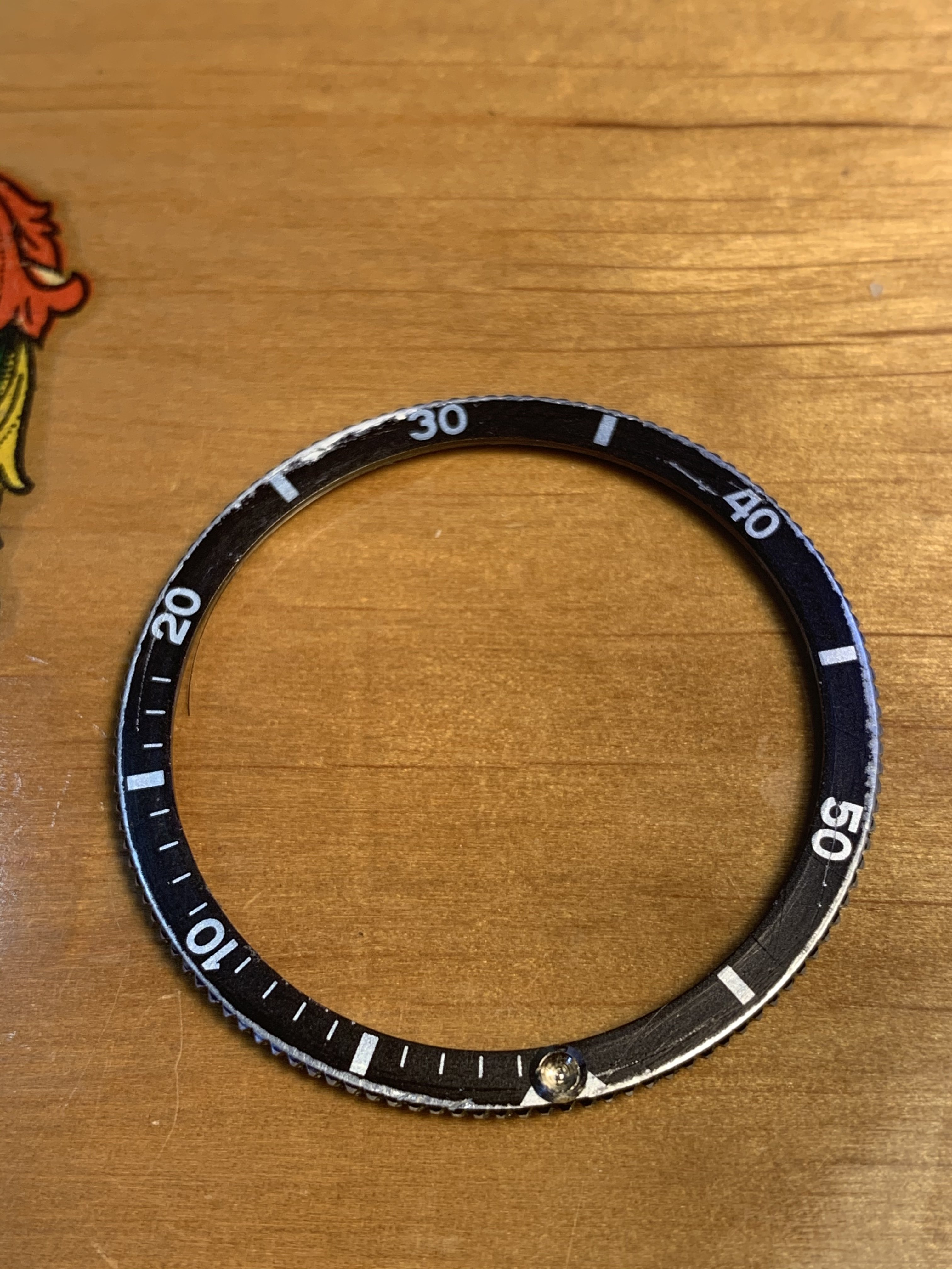

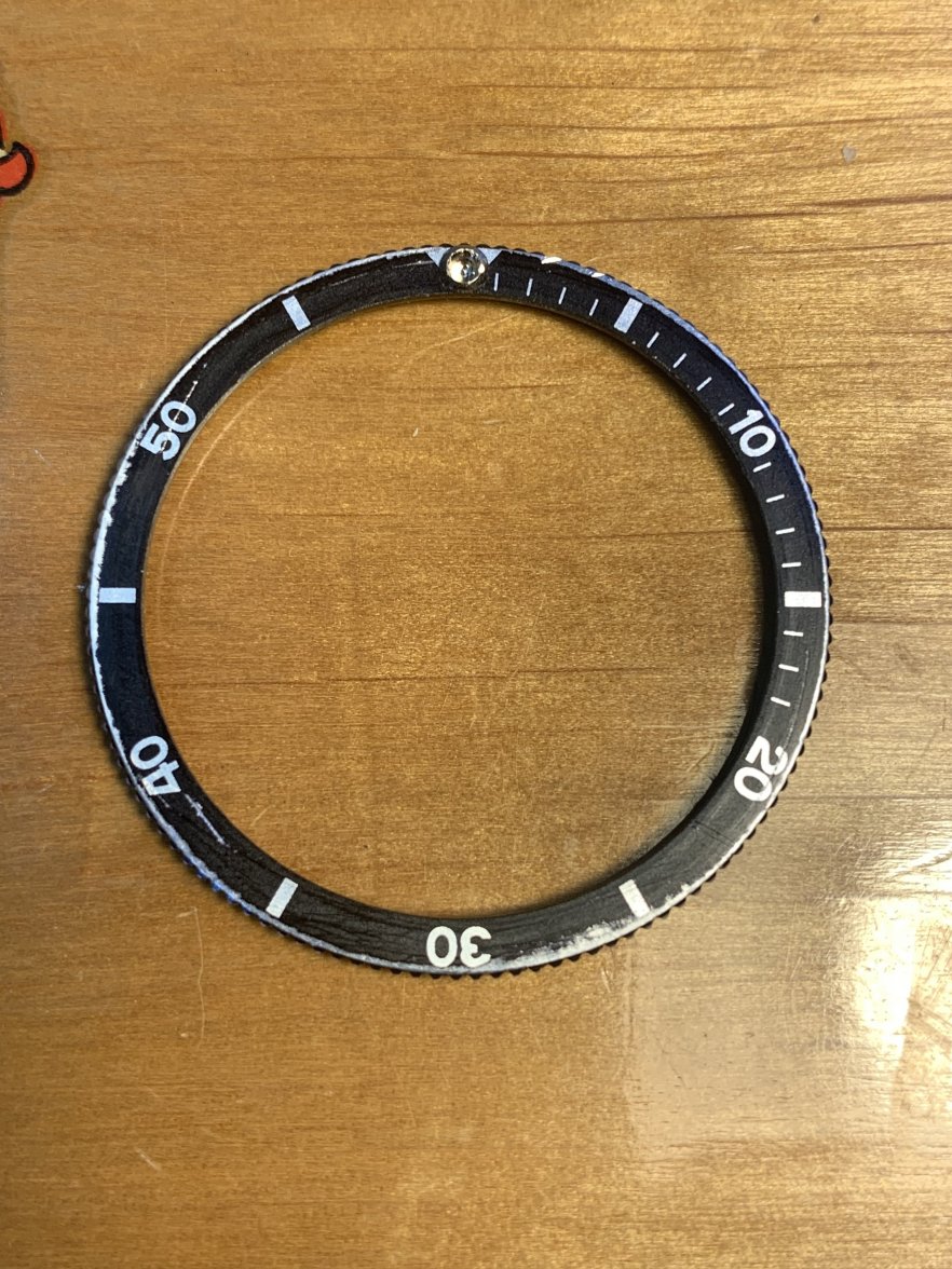

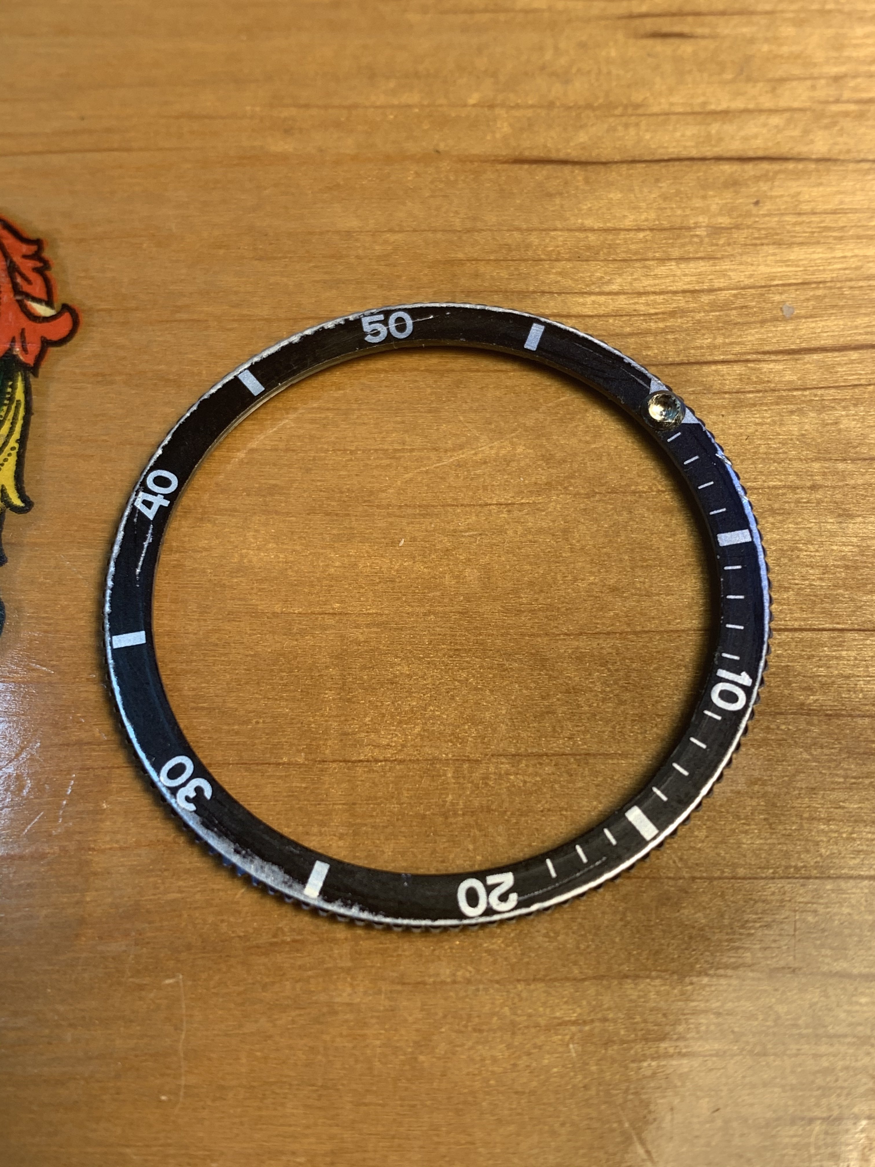

Advise Needed, Omega SM120 Bezel Original or fake ?
666
485
Fake :-(
Exactly what specified things are you first looking at when you can see that it’s fake ?
1,441
3,809
I am not so sure it’s a fake. Let me see if I have one to compare
6
3

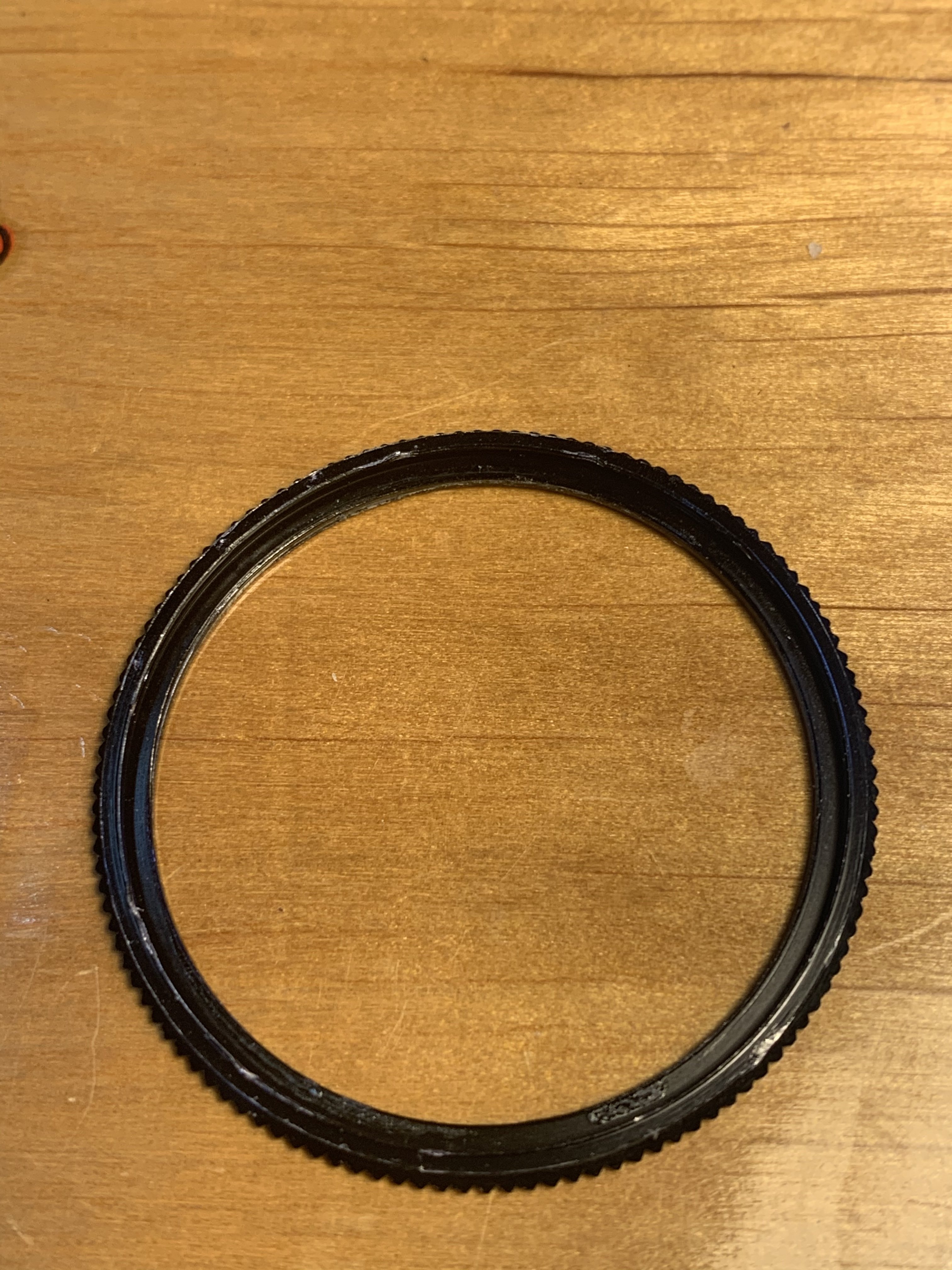

This one looks good for a fake, but you can spot it by counting the amount ot teeth between a 10 second increment.
A original bezel has 14, a fake has 11/12
13,492
31,811

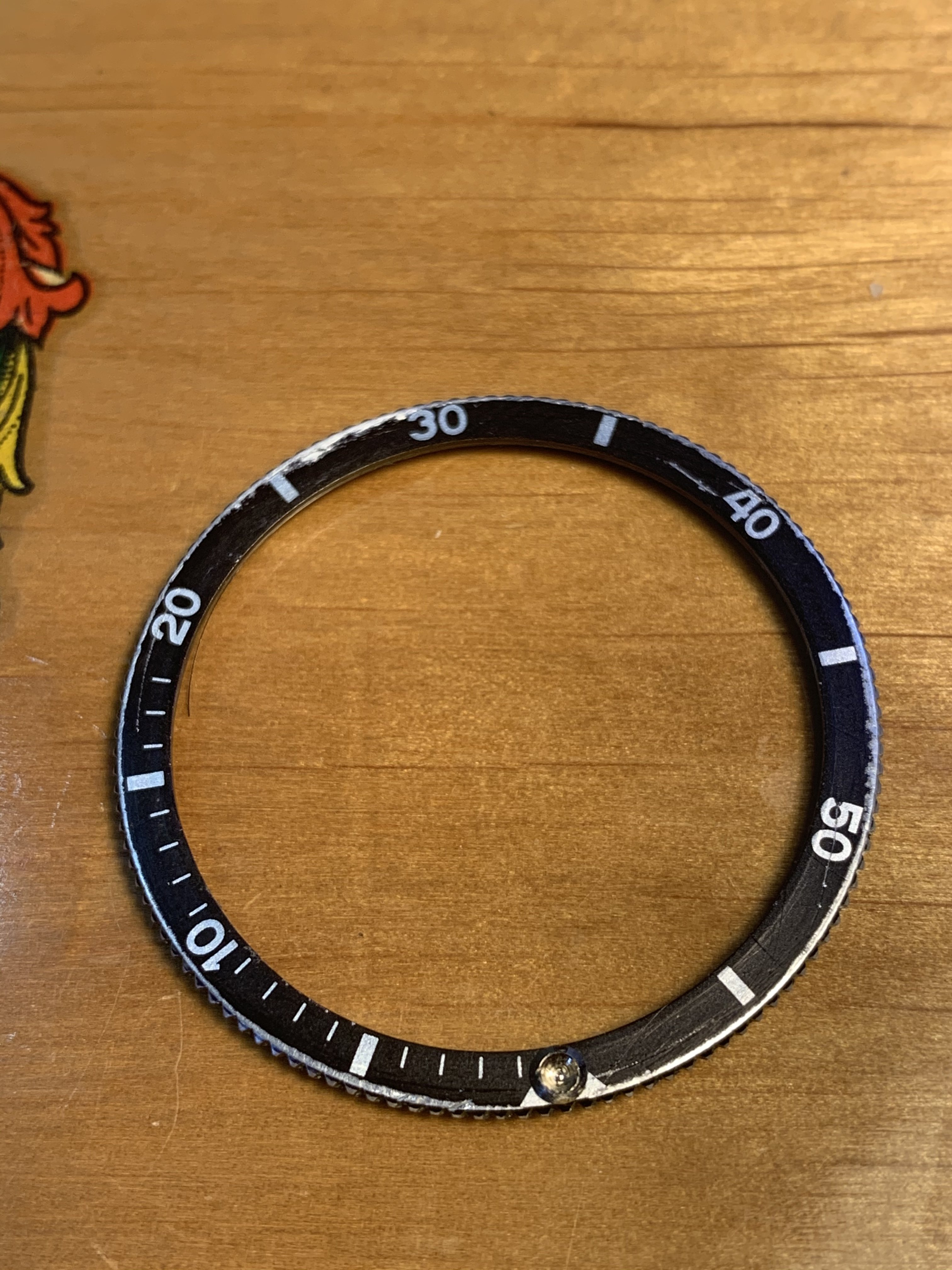

Fake. The easiest way to spot a fake is the lume pip. An original pip is clear acrylic with the lume encased within, the fakes use a metal pip with a blob of lume.
1,441
3,809
Checked and above and mine has 14 teeth as @justop pointed out. Didn’t know the acrylic/metal pip test
666
485
good info, sometimes it’s not that easy to spot fakes when you don’t know where to look !
