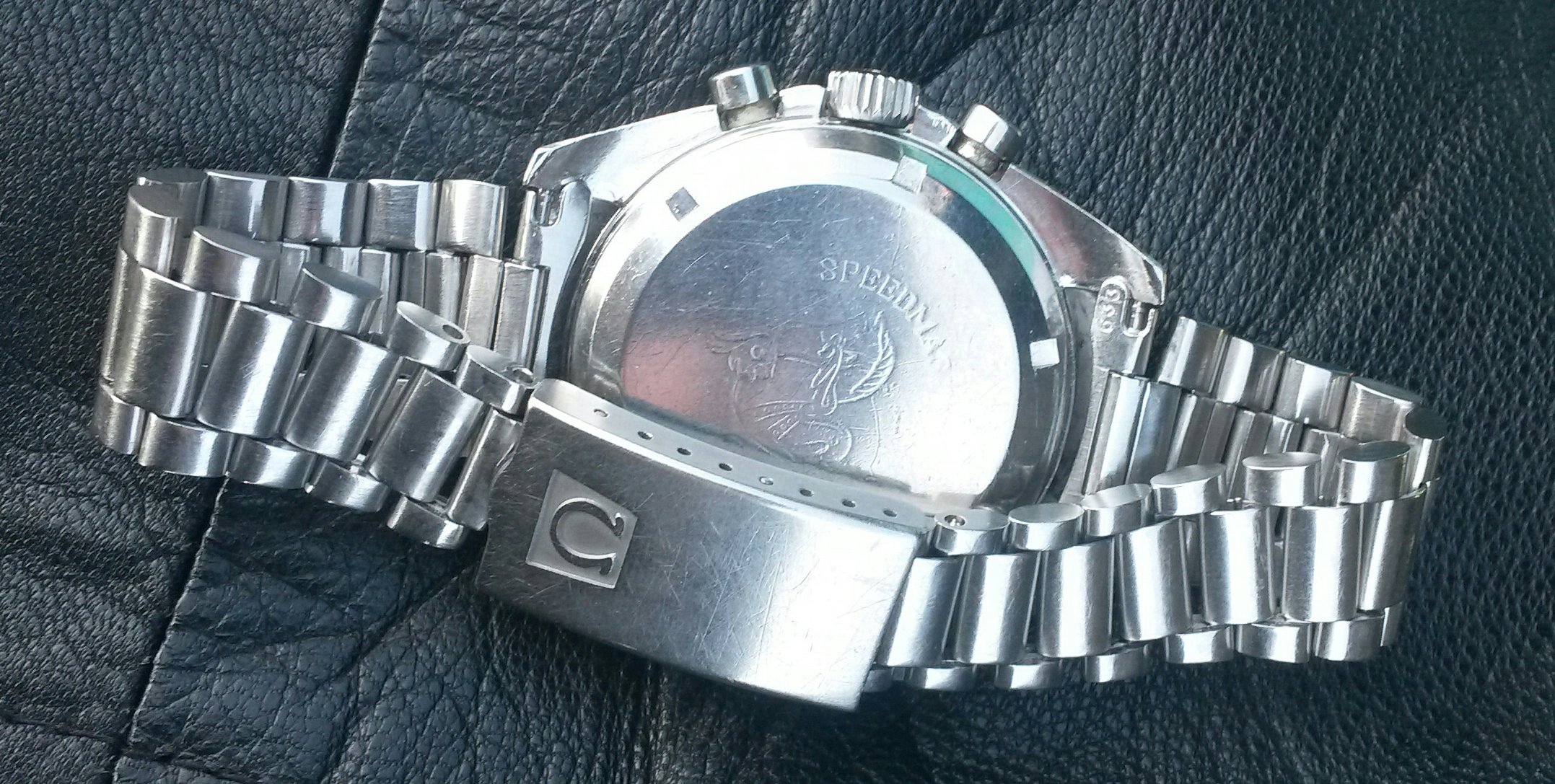

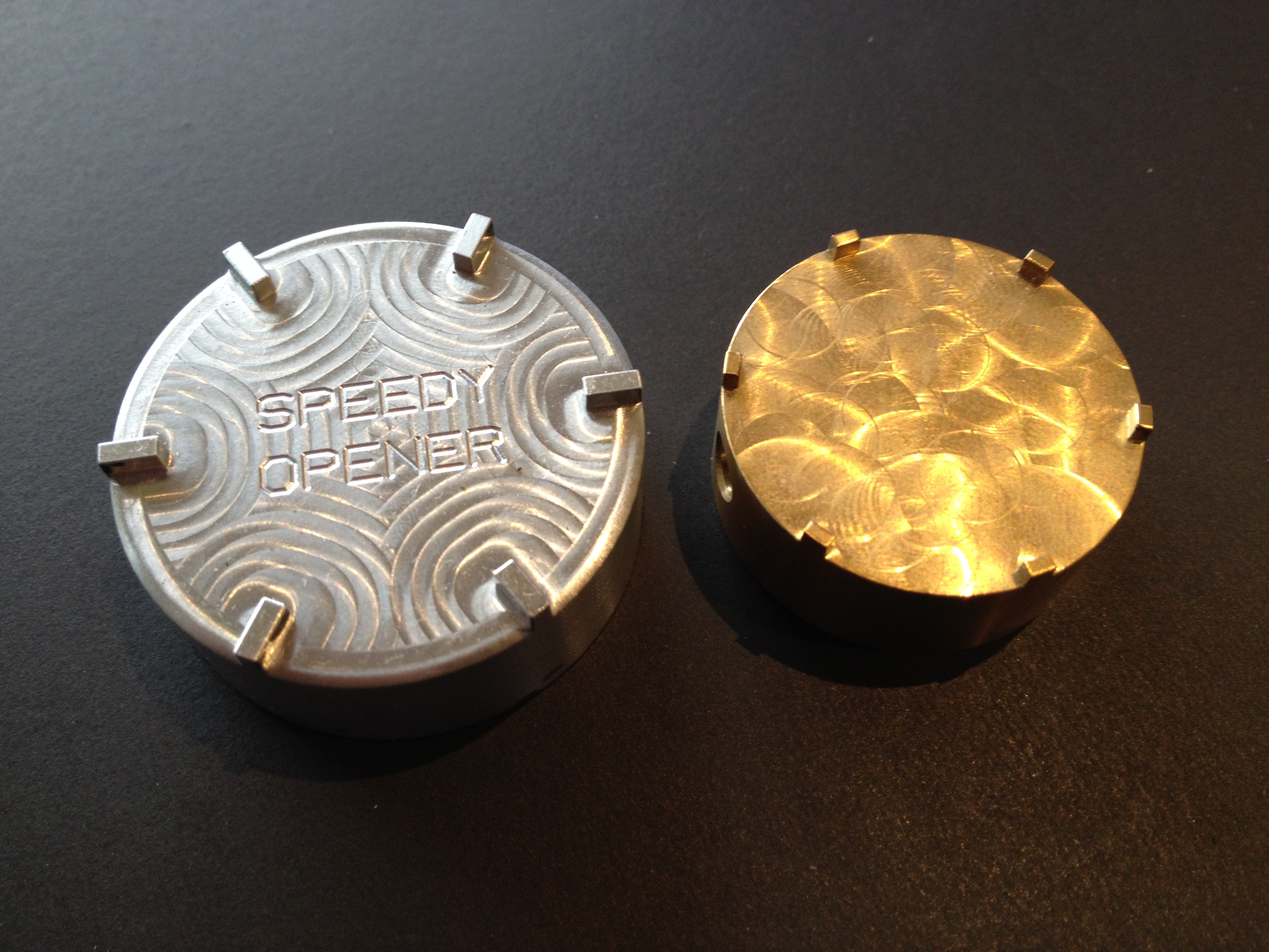

I must confess I have thought about buying a case back opener... probably a @Pahawi with 6 contact points??? ........ just to take another peek at the old 321 ticking away. 😕
but then I can here my old Dad's voice in my head from 50 years ago: 😲
"Oye!!!... what are you up to?...........don't start 'fakkin about' with my Omeeeyga! .... you'll get a kick up the arse!" 😡
I smile to myself and think " maybe I'll just phone Simon Freese". 😀

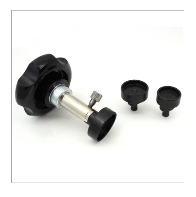

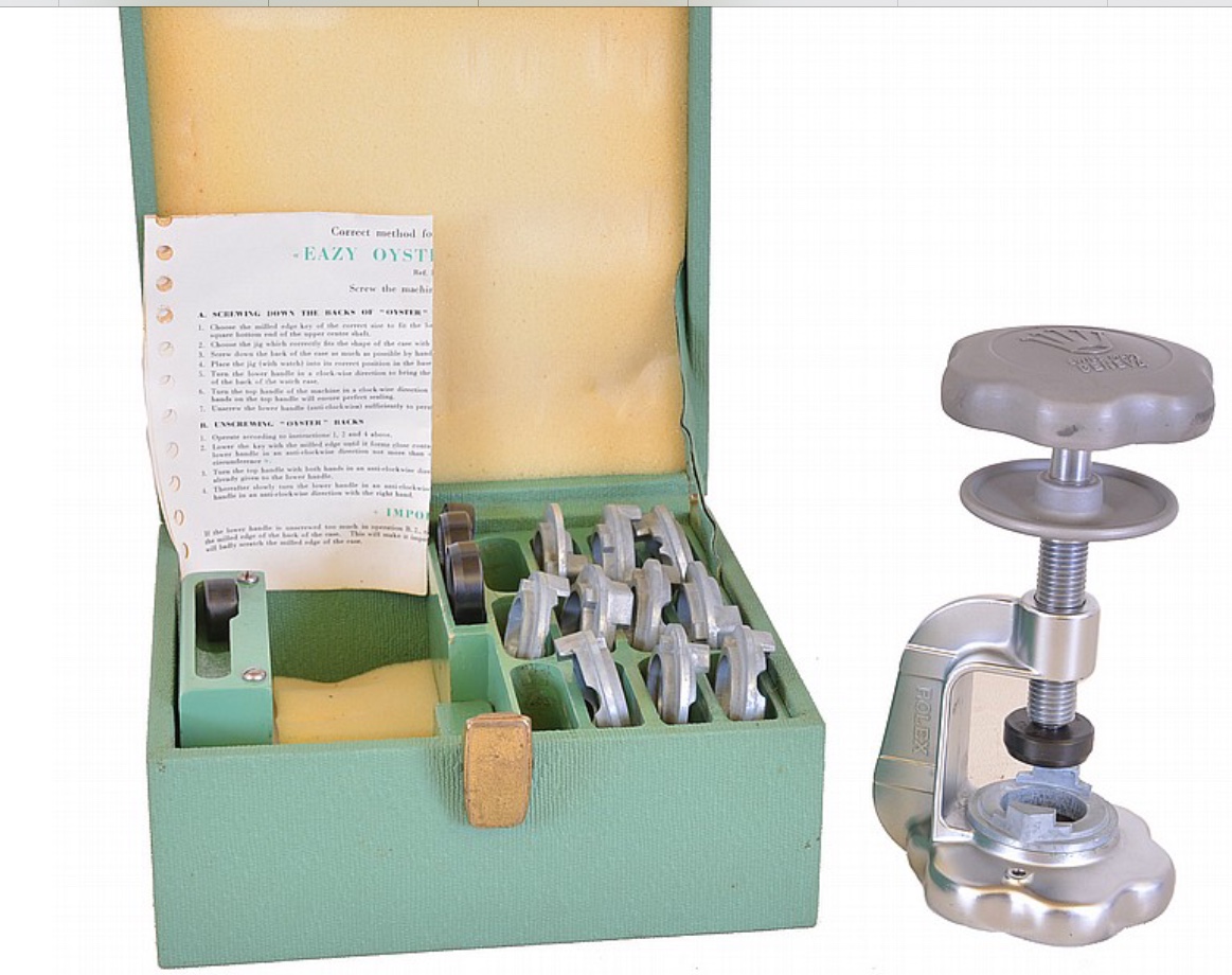

Looking for a nice caseback opener as well to check movements, etc. It would come in handy for purchasing some watches in the future. Is the sticky ball enough to open Rolex oyster cases or would the set from eBay/Amazon (usually around $23-25) be the better option?
I have the L-G "Openall" version of this tool that mounts in a bench vise. I have opened quite a few oyster cases with no mis-steps. Unfortunately, I think the price is closer to $100 than $25.
I also have an L-G case wrench that is my favorite for opening screw-in case backs. It's much less expensive than the Bergeon wrench mentioned above, and I don't know how a professional would view it, but it seems to be a high quality tool. It is solid, with very little play, and is a huge improvement over the cheapo wrenches that come in typical watch repair kits.
I like to use both of these tools with a nylon-pin case-holder, which can also be mounted in a vise to free up your hands.
