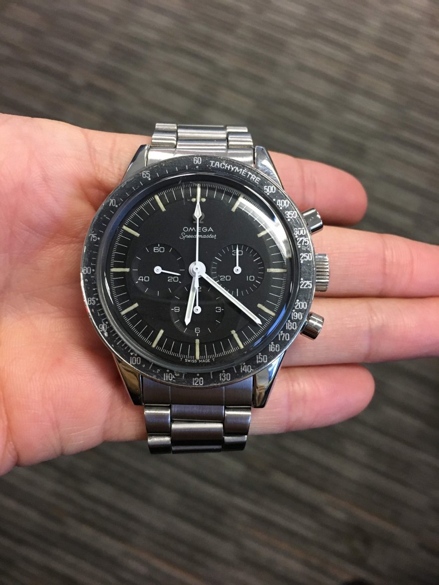

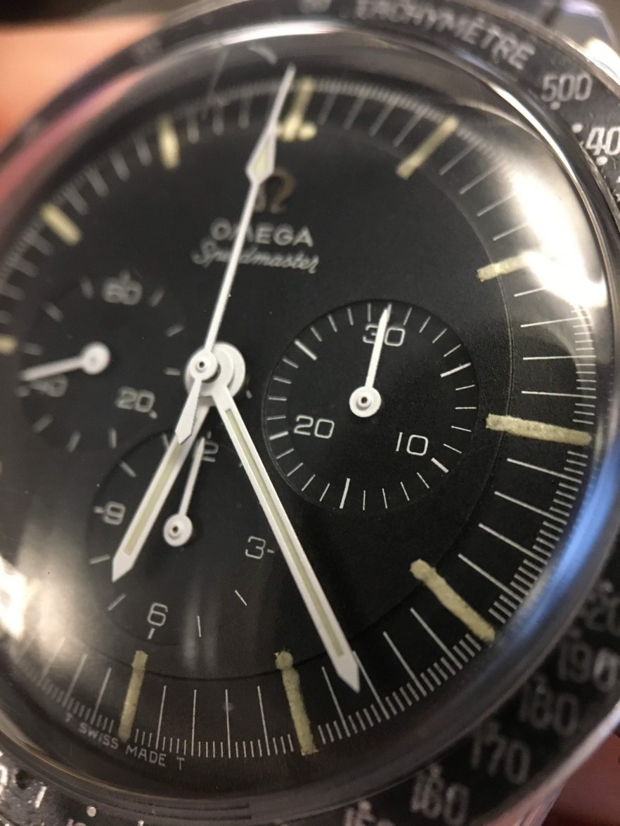

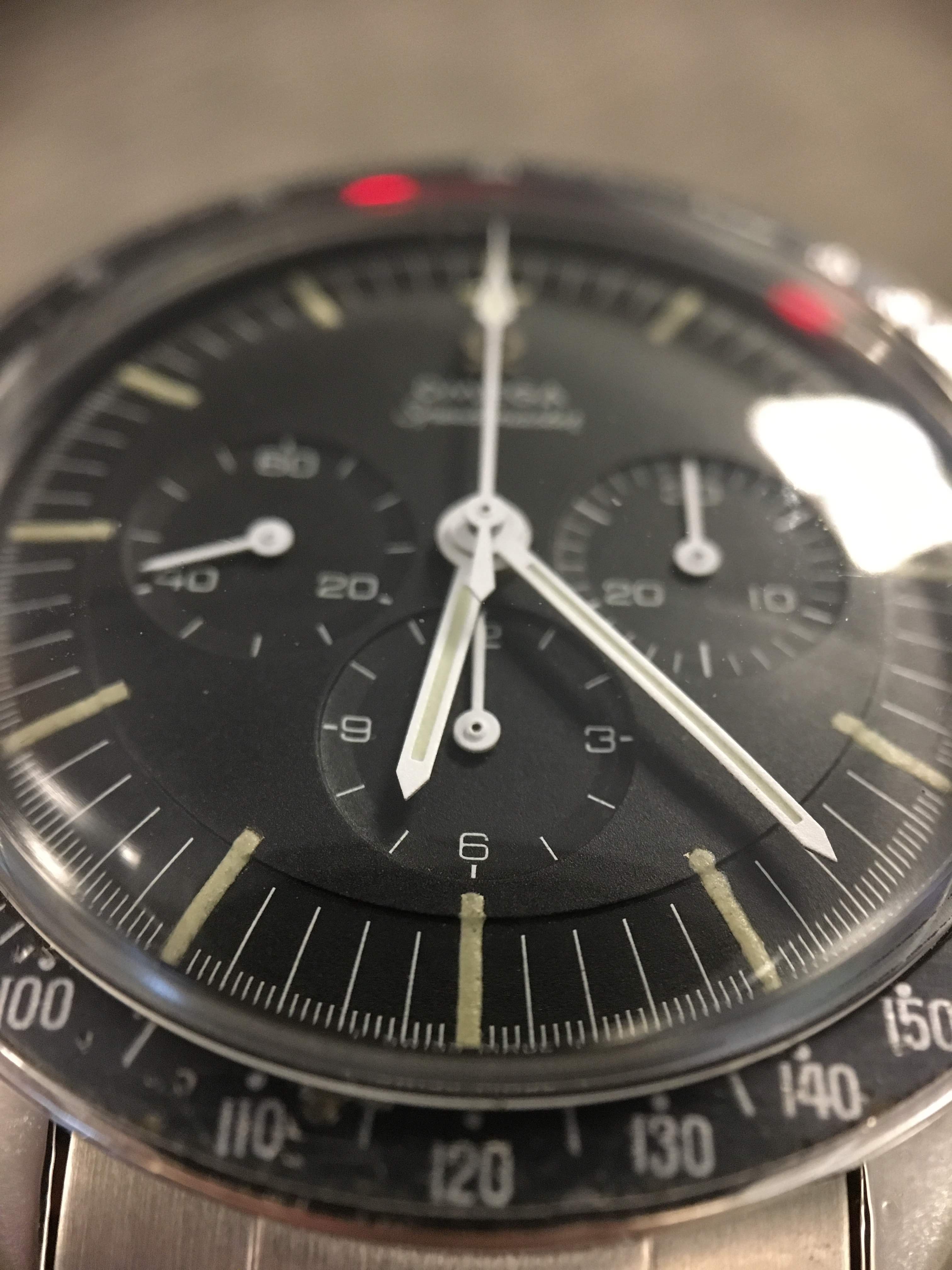

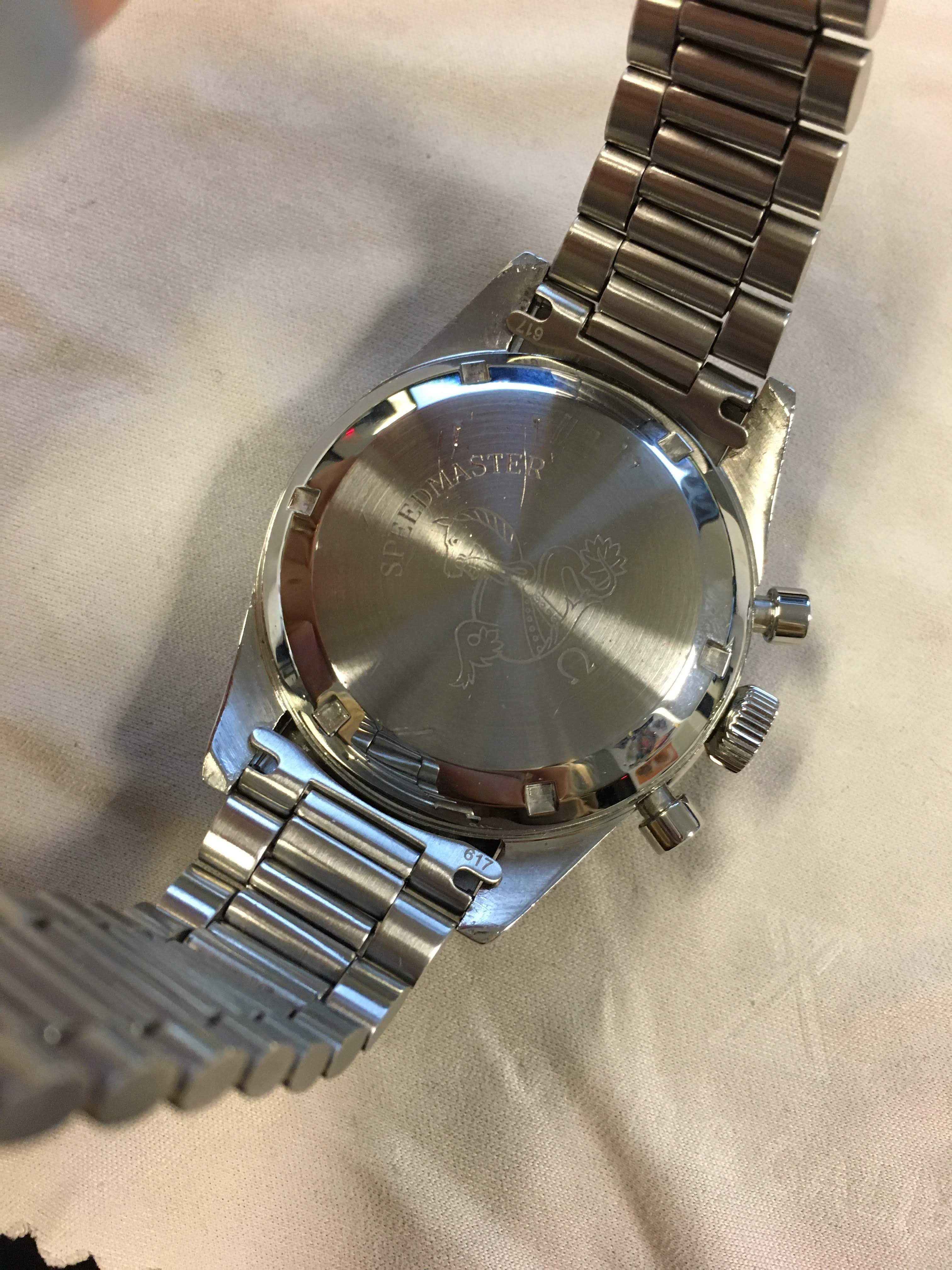

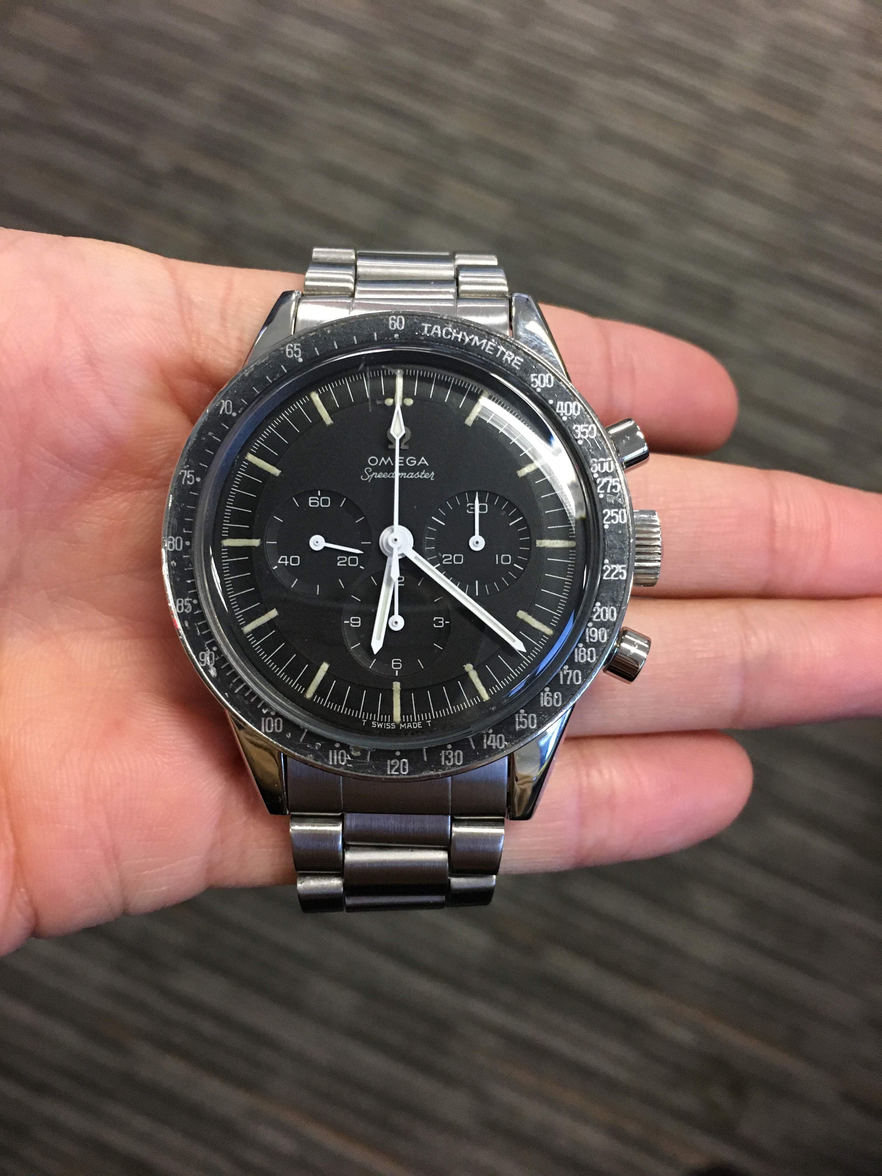

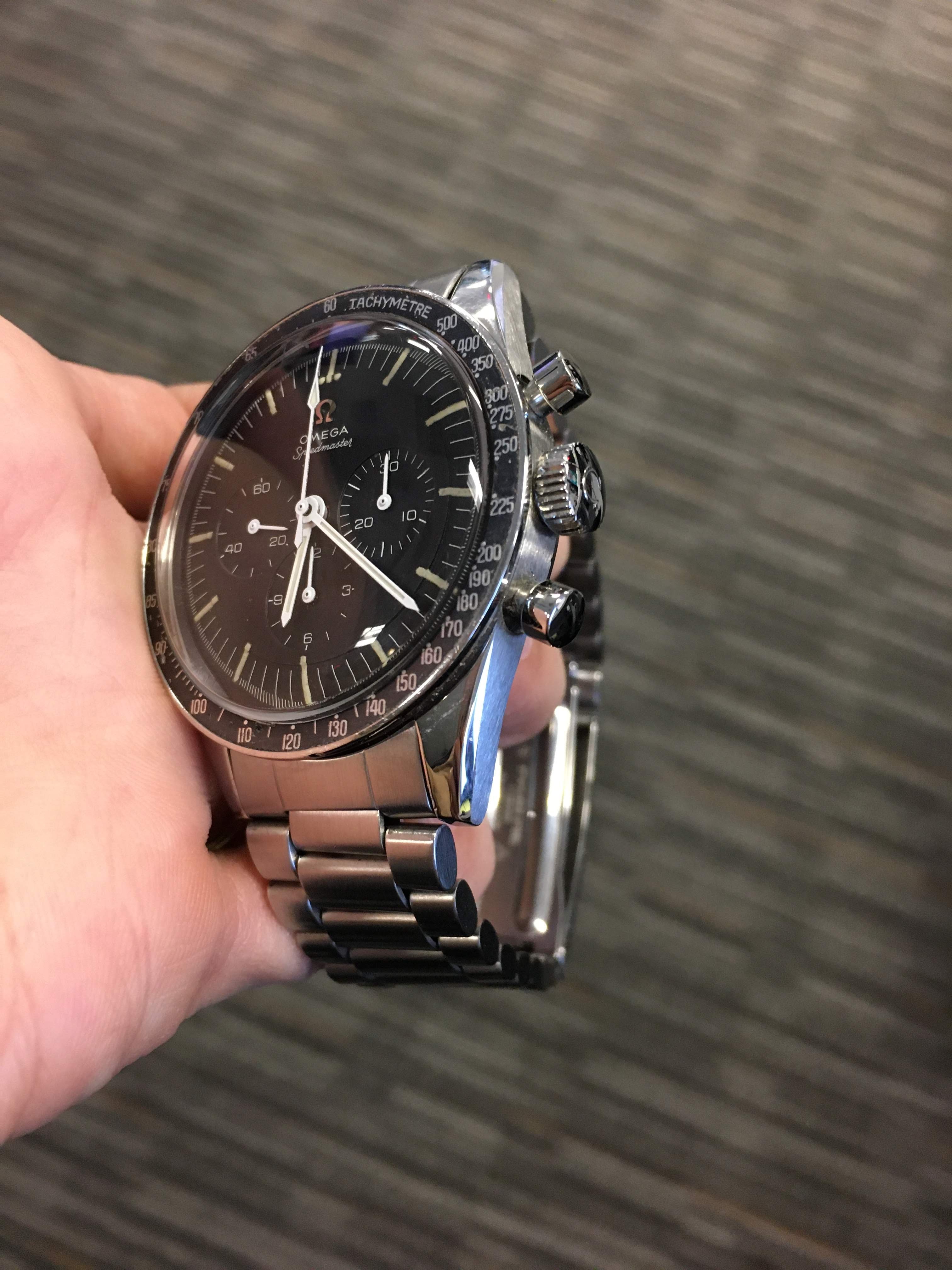

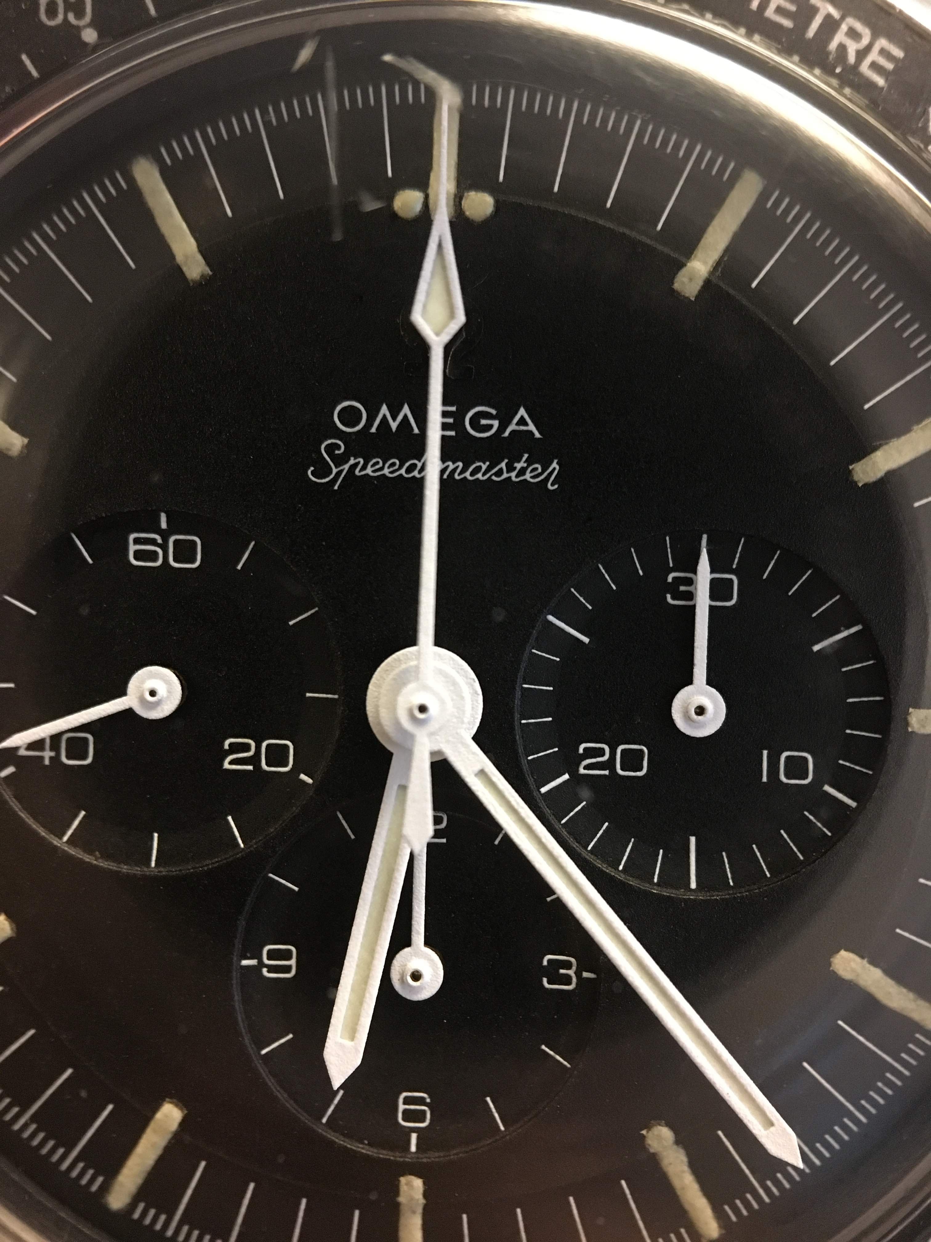

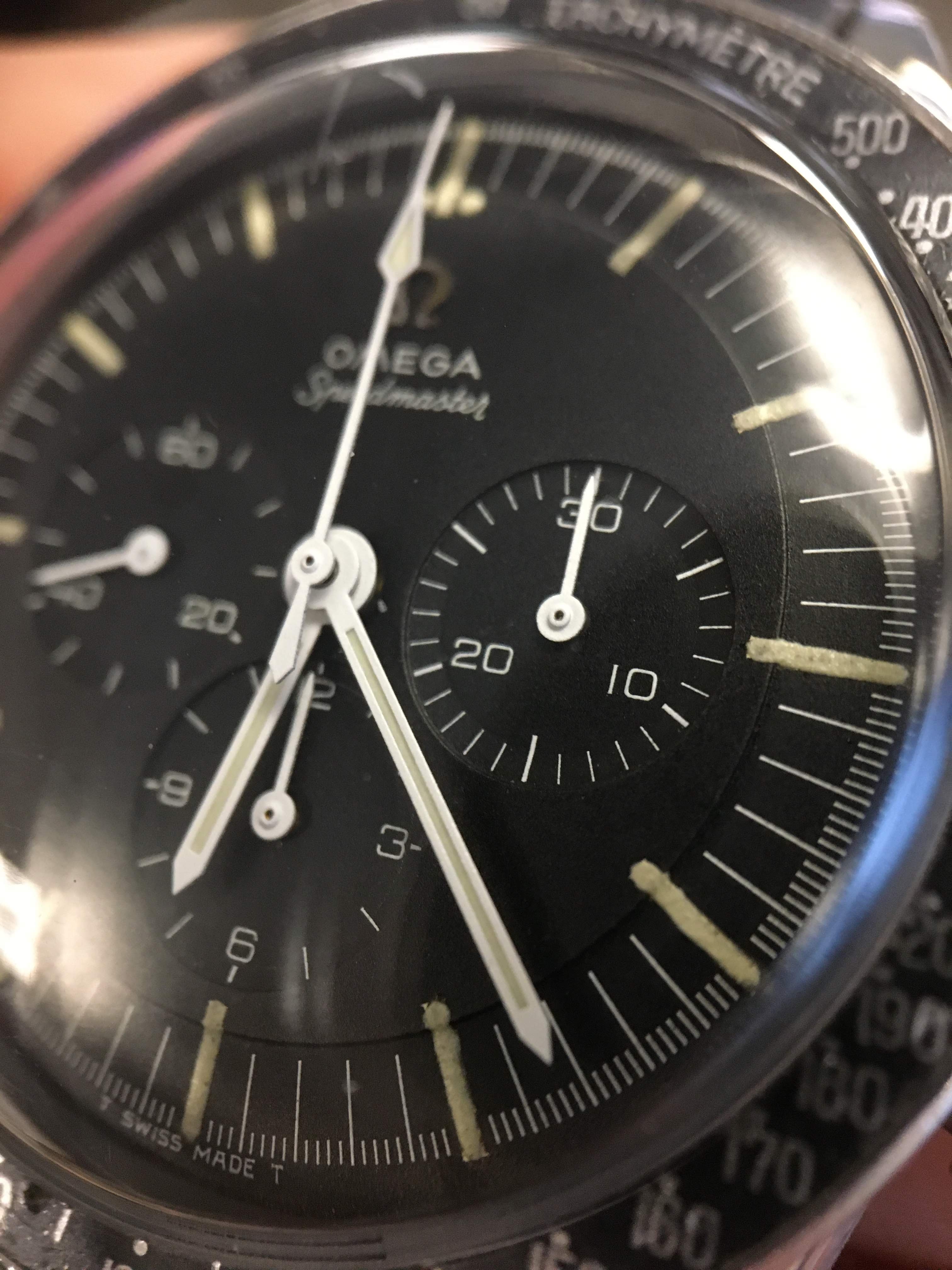

Here is one that I am looking at.
My initial analysis:
- Replacement Hands (uggh!!), Crown, and Pushers
- Replacement Crystal with some scuffing
- Dial looks clean, plots/lume???
- Don Bezel looks genuine and in decent vintage condition
- Case looks recently polished
- Caseback has damage at one tooth. Slight scratches that could not be removed during polish
- New 1125 bracelet?
- With Extract from Archives
My biggest question is the lume on the plots. I can't tell if they are original or relumed. The color looks off and it looks like brush marks on some plots.
The white hands really detract from the appearance and would be high priority to replace.

before anything else, those hands would bother me
Totally agree! Those would be at the top of the list to replace. Not sure how painful that would be.
Listen to that voice 😉 Yes, those are definitely not original. Looks like someone laid tracks of cheese on the hour markers, and grilled the dial till they started melting...

Ed White lume can be disconcertingly irregular but I am fairly sure that is a relume. The blobbiness is not a good sign. As for the hands...
