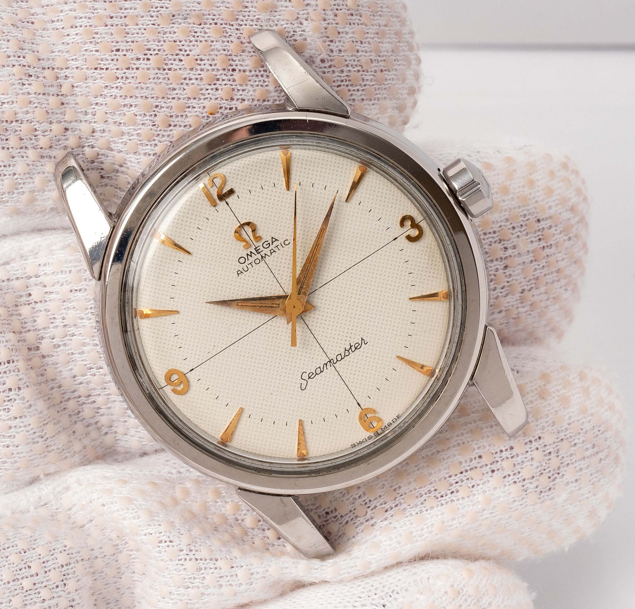

I'm considering buying this Seamaster. Caseback reference is 2577-12 SC, and 13M serial number dates it to 1952/53. It's a cal 354 bumper, showing lots of tool marks but recently serviced.
I've looked at many (many!) images of various 2577 variants. Lots of waffle dials, some crosshairs, plenty of repainted examples. So many, in fact, that I'm having a hard time sorting out whether this dial is original or not. So, hoping for some advice here.
I can see that the seconds hand Is wrong; maybe all the hands?
Thanks in advance for your comments.

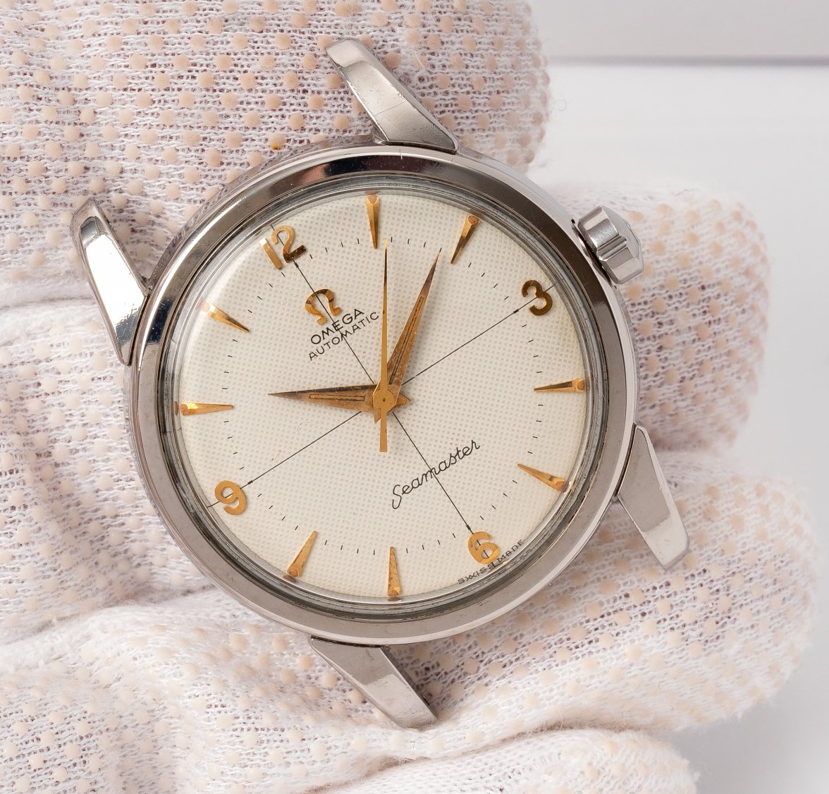

My feeling is that it is a re-dial and an incorrect minute hand. Seconds hand is broken, not sure about the hour hand ... it could be correct. Better photos would be needed, but I'm also seeing signs of over-polishing.

Super helpful, thanks guys. The pictures of similar waffle dials were great!
The crosshairs are bugging me just enough, and I'm trying not to be seduced by the (big) bump in the bumper--love that. But for now I will pass it up.

If it is a redial, it's a pretty good one. Is the vertical cross-hair centered in the logo?. It seems I always have to ask, Price?.

Minute markers around 1 and 2 are a bit suspicious.

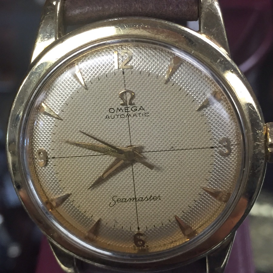

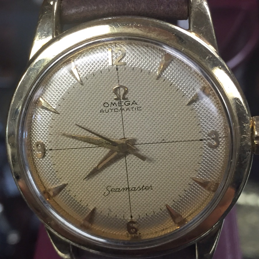

It is genuine in my opinion. The second hand is broken and the minute hand is replaced. Here is a ref 2767-5 with crosshair.

Pretty sure that is an original dial. It says "Swiss", rather than "Swiss Made", which is mid-1950's Omega code for US market. You should send a picture of the movement. There should be an "OXG" import code on it somewhere.
Omega used the 2-tone guilloche dials mostly on the early Constellations/Globemasters, but I have seen them on Seamasters like this.
I am assuming that this is a gold-capped case, as opposed to solid gold.
As others have pointed out, all of the hands are incorrect, broken or both. They can probably be replaced, but it might alter the vintage look of the watch.
You didn't state an offer price, but if it is more than $200 to $300, then I would pass. The major value here is the dial.

To answer some of the questions--I didn't take a movement pic, but it had the import code. There were lots of scrapes on the plates. It was not a pretty sight, but working fine. And yes, gold-capped.
The watch is in a local shop in Canada, and listed at $650 (that's the USD equivalent). However, I could get it for not much more than gatorcpa has indicated as part of a larger purchase, and I do a LOT of business there. It would include correct replacement hands from the stash and a one-year guarantee.

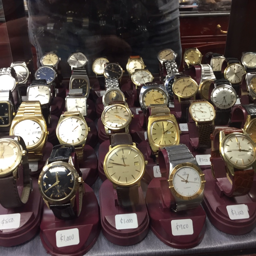

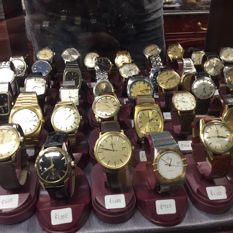

Here is a very poor picture of the vintage and not-so-vintage Omegas showing at the shop. There is one Tissot in this picture. Most of these are not collector grade. The best and many much worse (parts) are not in the display. Those are Canadian dollar prices, negotiable to some extent.
