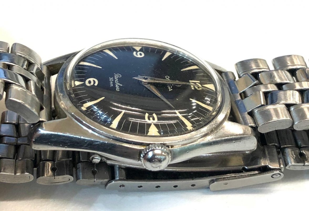

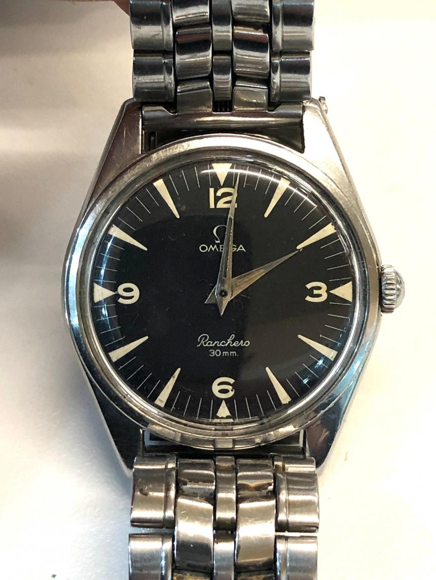

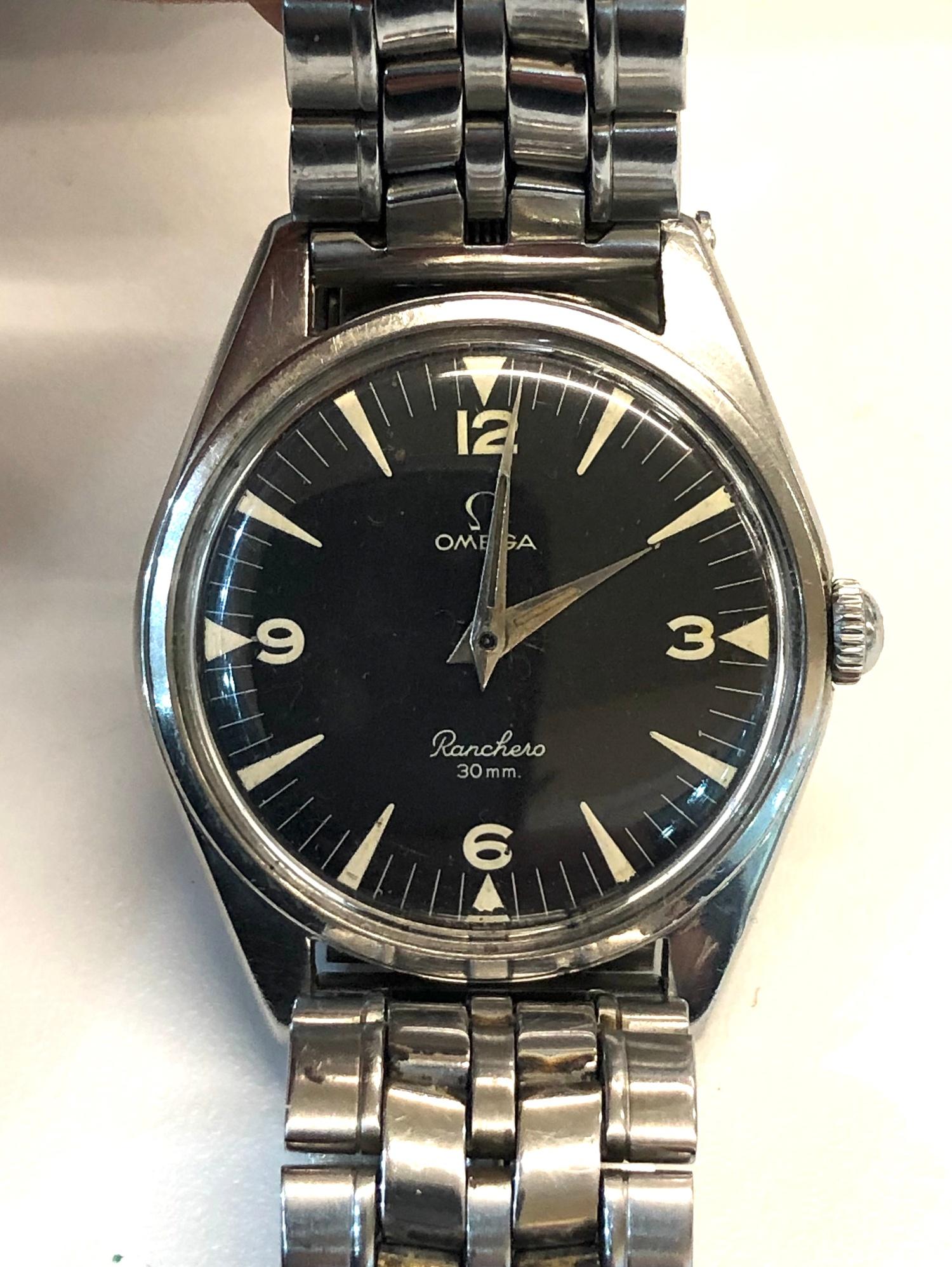

I saw this beautiful Omega Ranchero and thinking of trying to buy it. For me as a non-expert the dial and everything seems original, except for the hand. I am curious about you experts opinion about this watch. Would you recommend to place a bid? Thank you for taking the time.

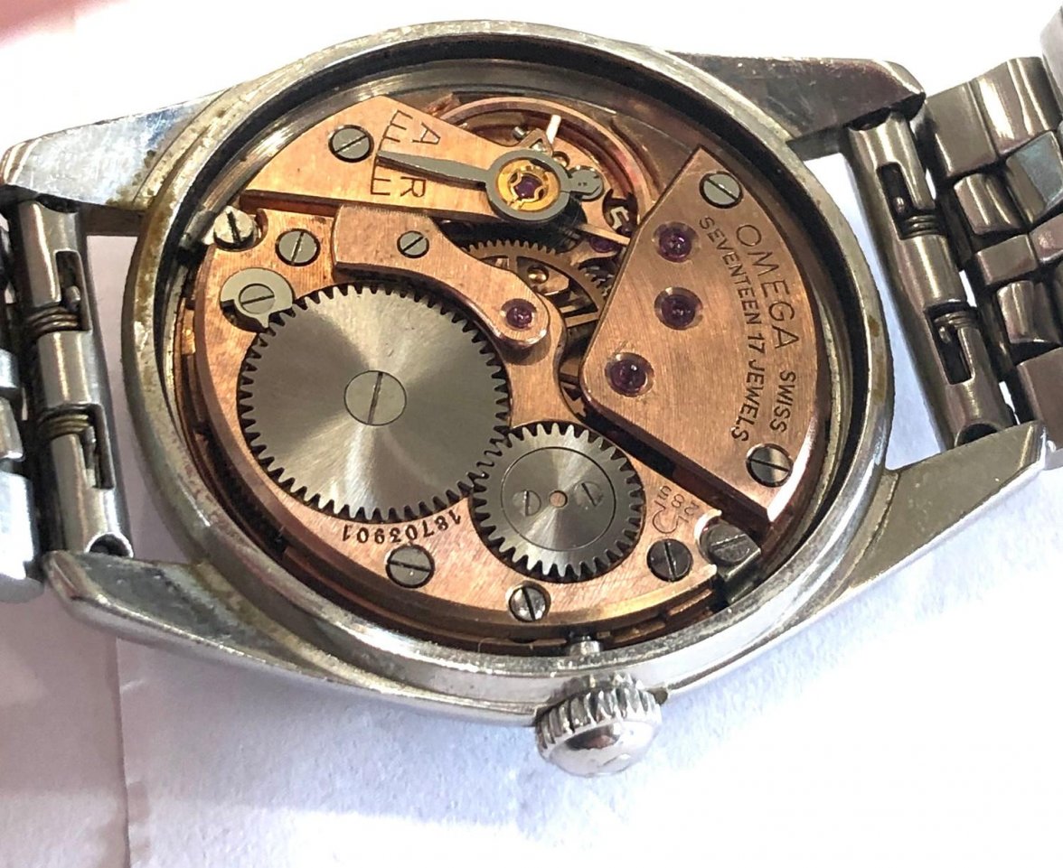

Thinking about this one, it might not be a bad buy 馃槙

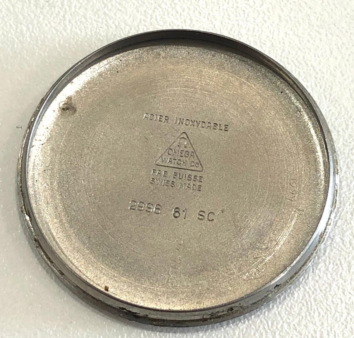

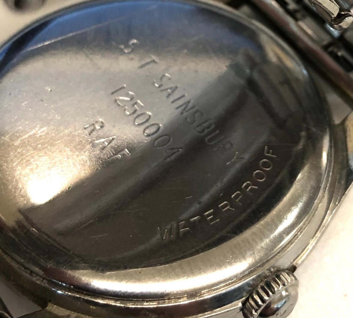

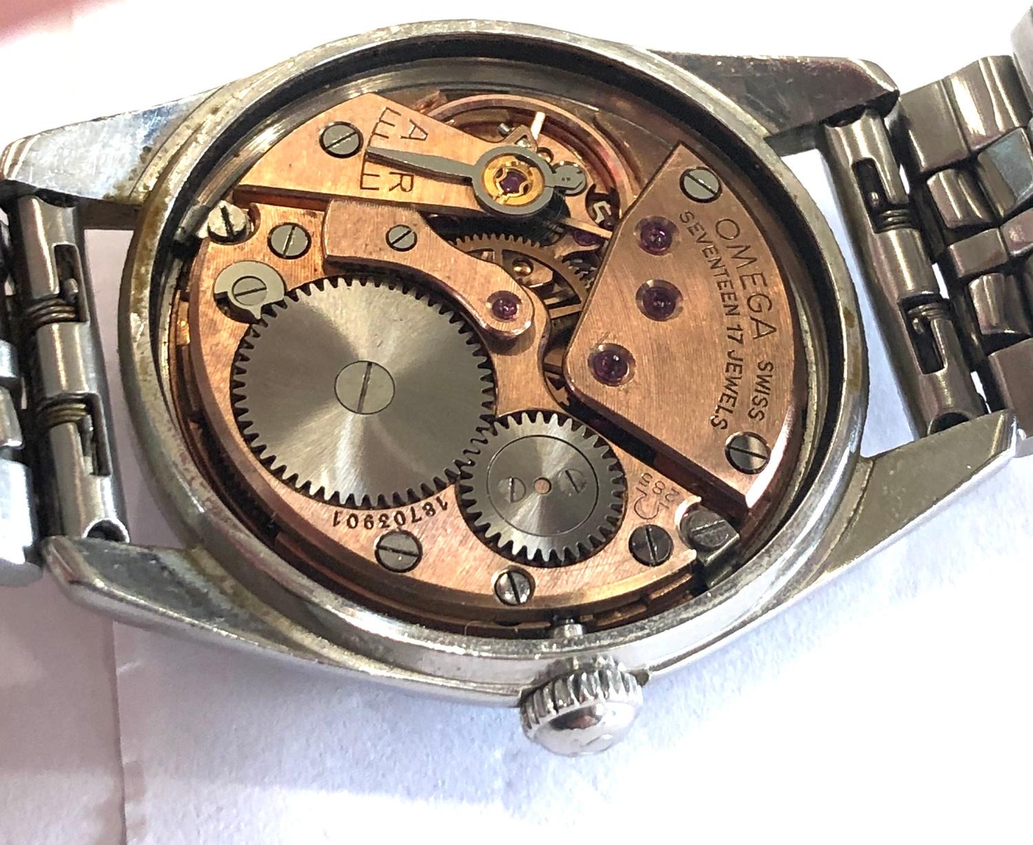

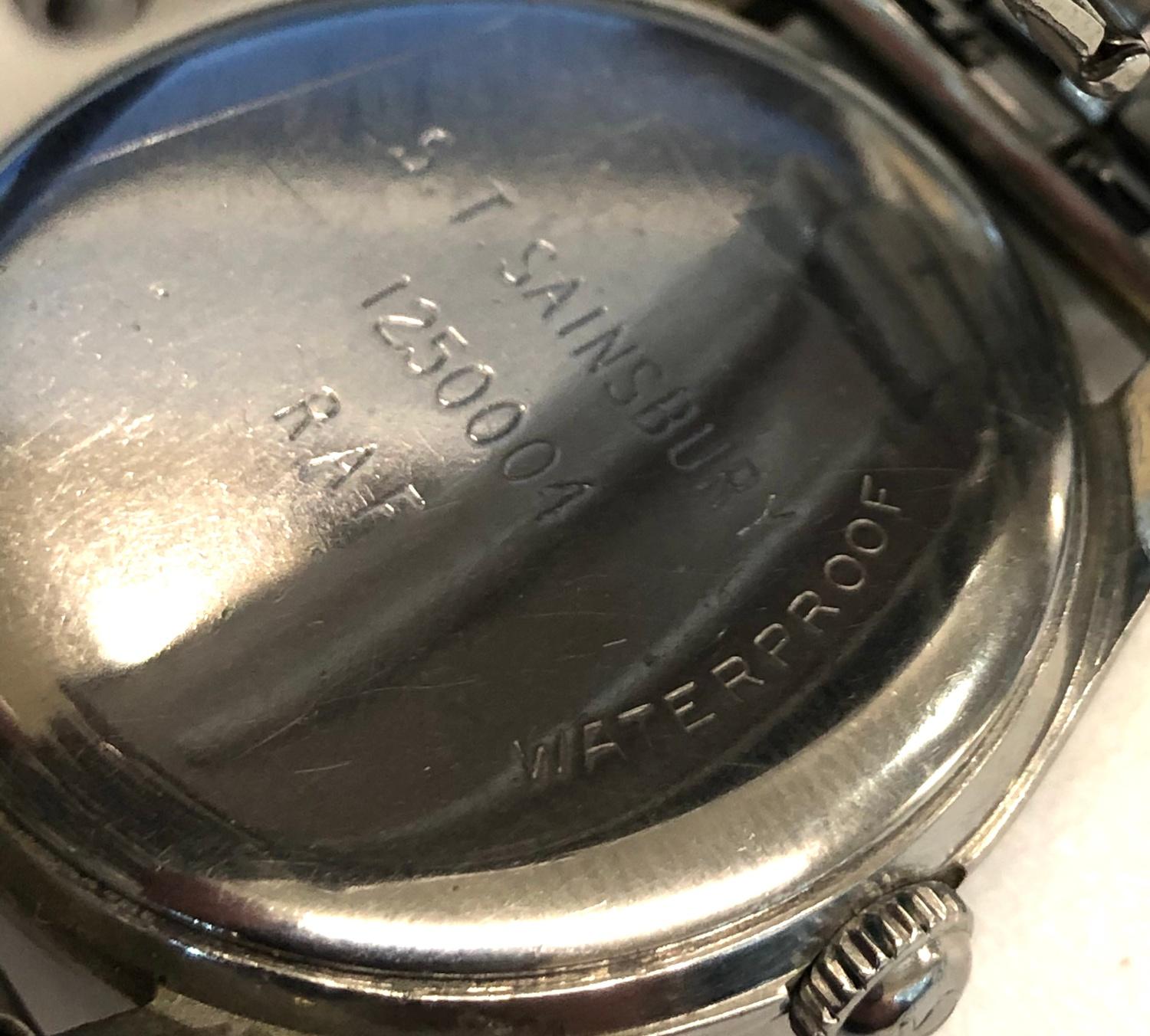

The serial number is high and despite issues already mentioned, it still has its original crown. If you sourced a central seconds hand and replaced that naff bracelet you might have a decent watch. Top it off with an extract from Omega, which if it confirms the caseback provenance you may well have a very good buy, especially if the bidding doesn鈥檛 go up much more 馃憤
You may also want to take into consideration the price of others on the market such as this ...
https://www.cartermarsh.com/product/omega-ranchero-raf-signed-ref-ck2996-calibre-285-c-1962/
and the lollipop 2996 for sale at Vision Vintage
https://www.visionvintagewatches.com/product-page/1958-omega-ranchero-2996-1-lollipop
Just my thoughts of course (so take it as you will) but seen as everyone else is being quiet about this one I thought I鈥檇 chip in
Good luck if you decide to bid 馃榾
