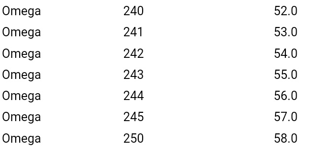

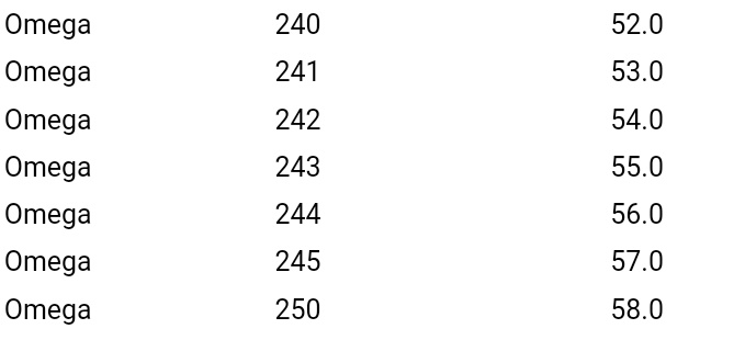

I suppose the reason you've not recommended one, Al, is that all these lists have errors. The first one is completely wrong for most of the 1000 series and, no doubt, others as well. I am sure that Christian's list is more accurate but I suspect he's also made some errors in copying down in Excel which likes to increment the numbers each time - look at the Omega 240 to 250 calibres, as examples.
Cheers, Chris
Hey, I never said those were good lists! 😉 But since people didn't want to use the Google I thought I should help. 🙄
Yes as we have discussed before these have errors, and since many lists are copies of other lists, a lot of the errors get perpetuated. I have spreadsheets made by watchmakers, lists in pdf from Wostep, manufacturer's documentation, plus all kinds of lists from the internets...I usually default to the manufacturer, but even sometimes their information doesn't agree.
