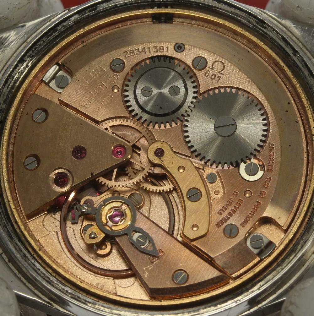

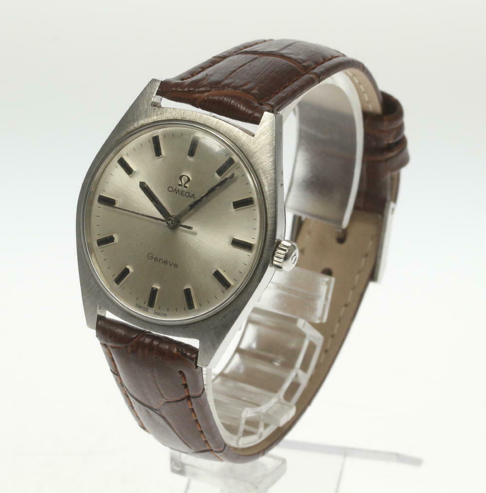

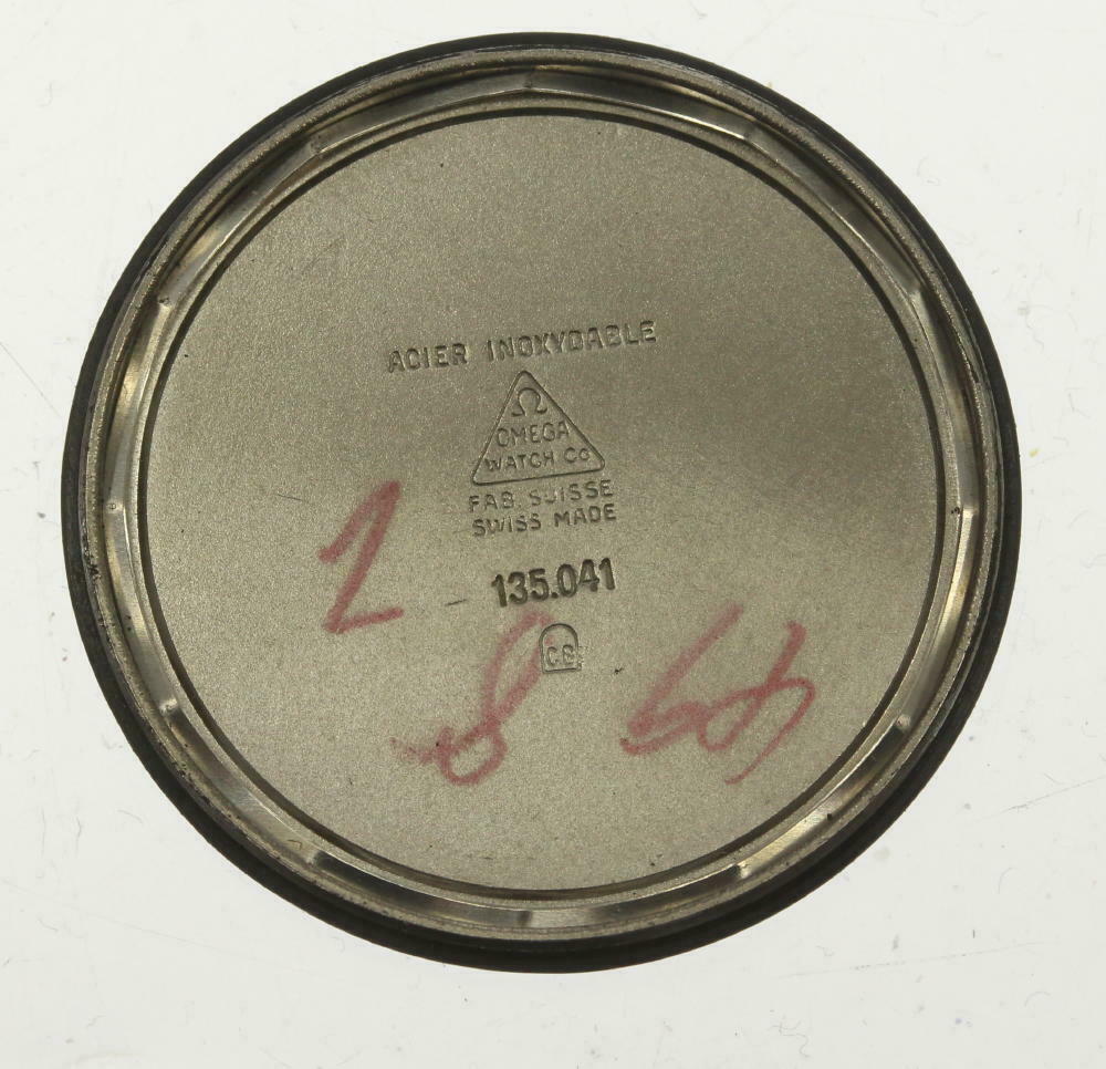

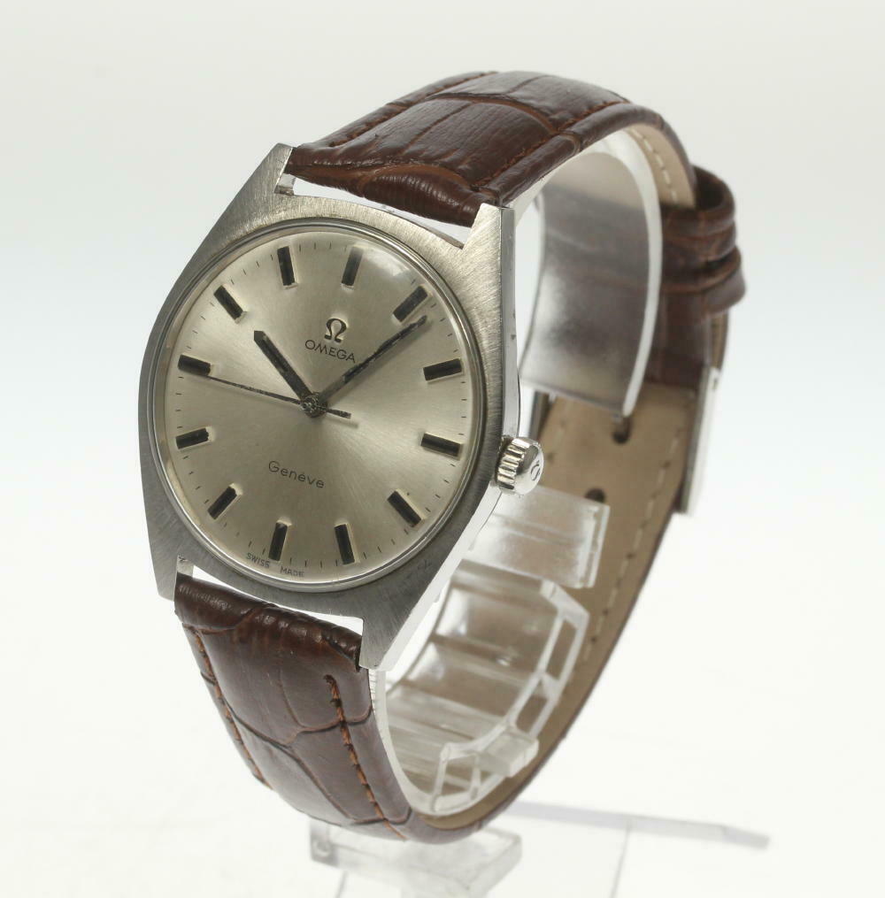

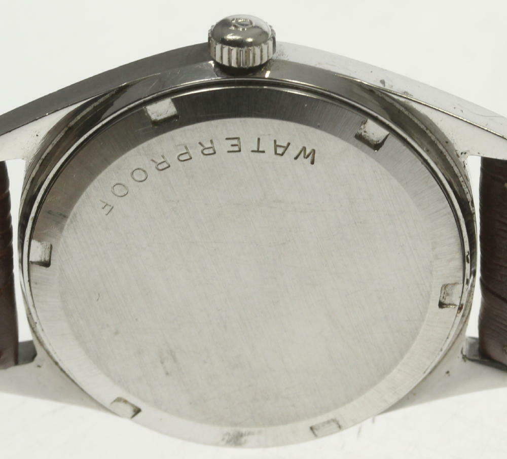

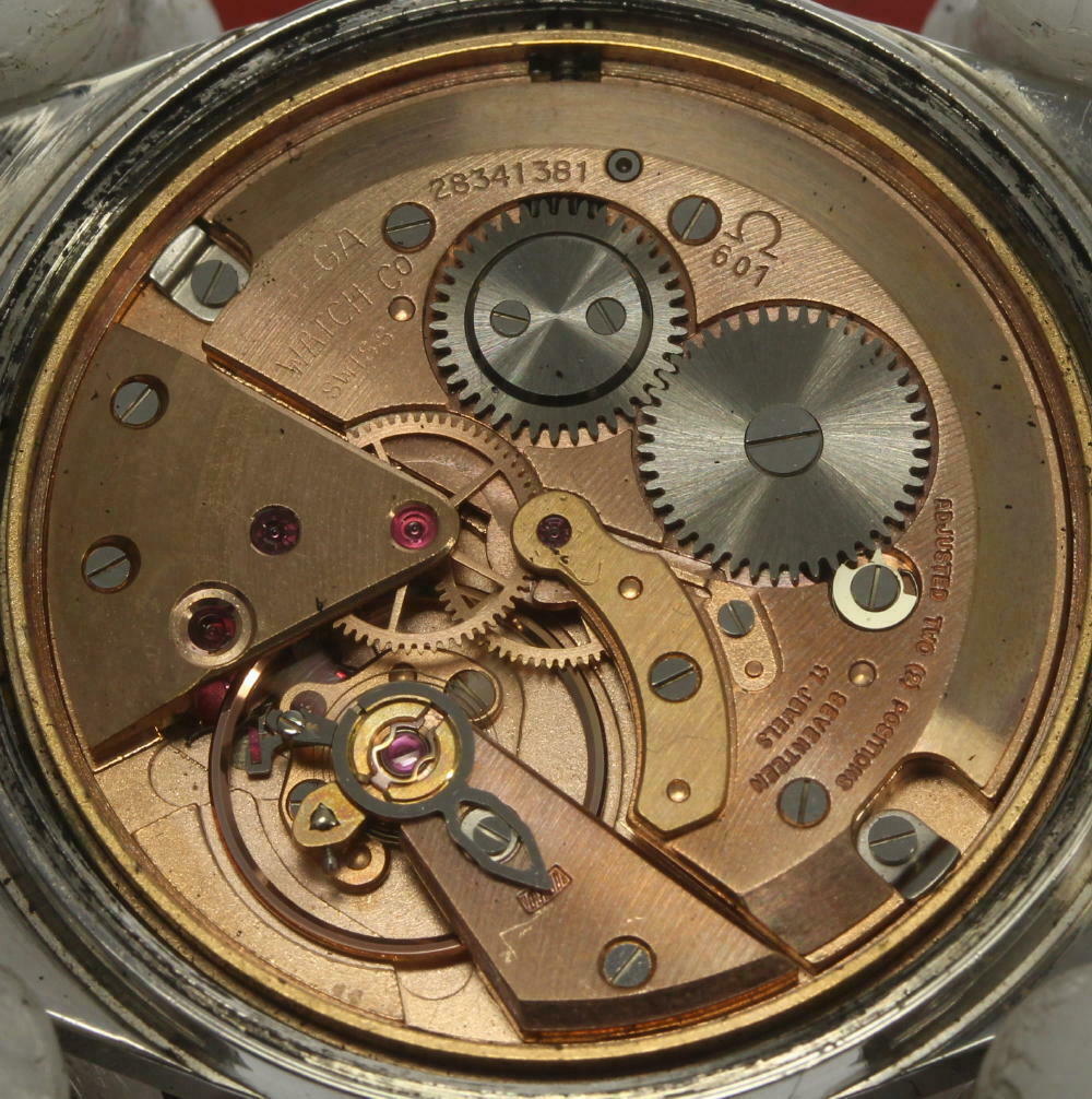

Hey! Was checking this watch out and was wondering what potential issues there are?
Specifically i noticed that the "OMEGA" engraving on the movement seems to be partially faded, what could cause something like that?

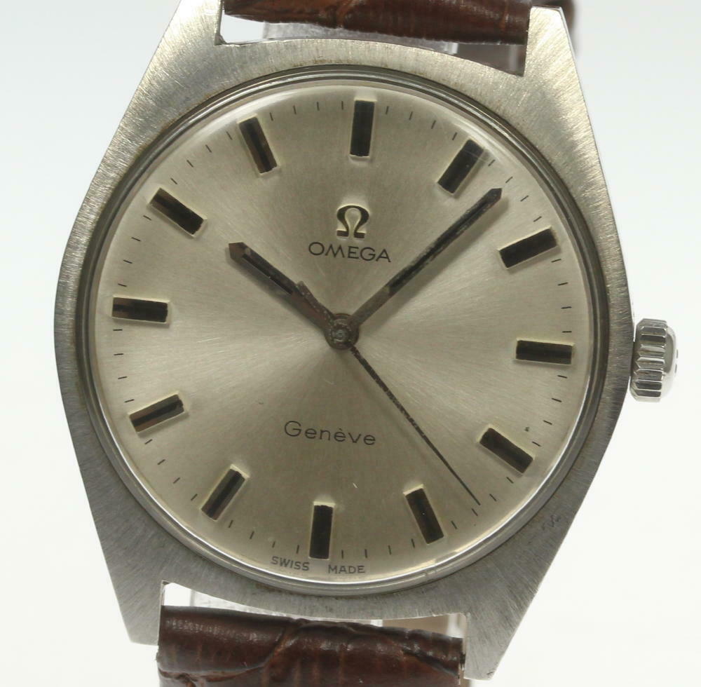

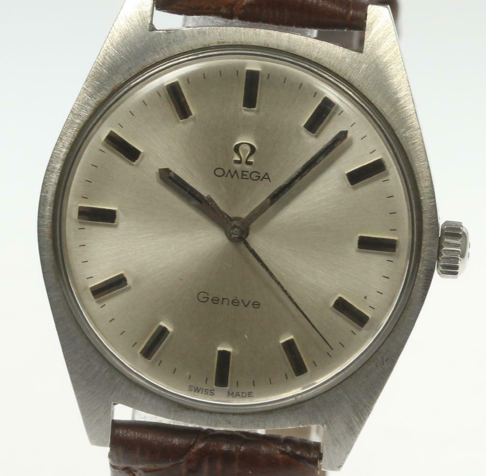

Also the dial seems to be in pretty decent condition, id guess its a redial?

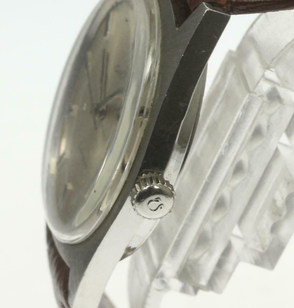

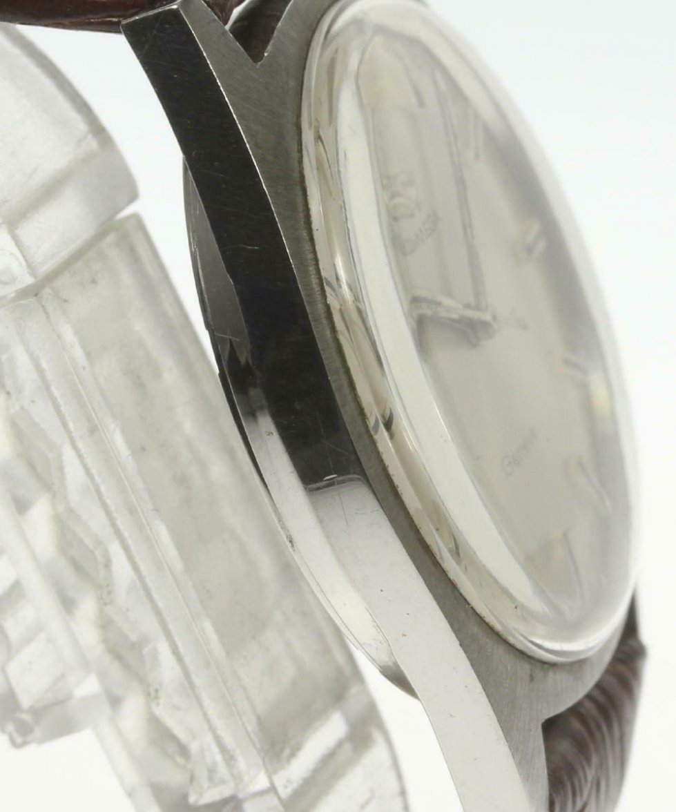

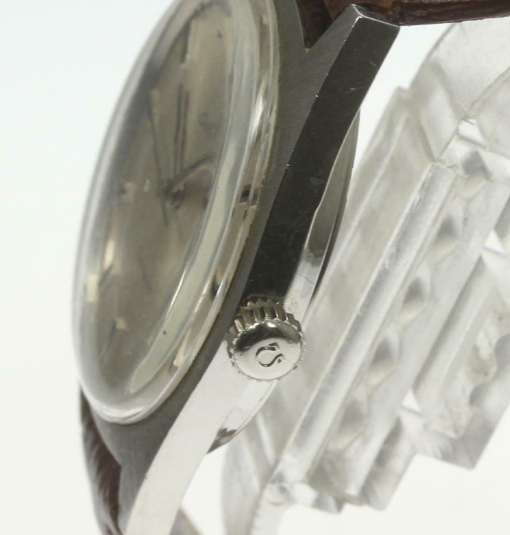

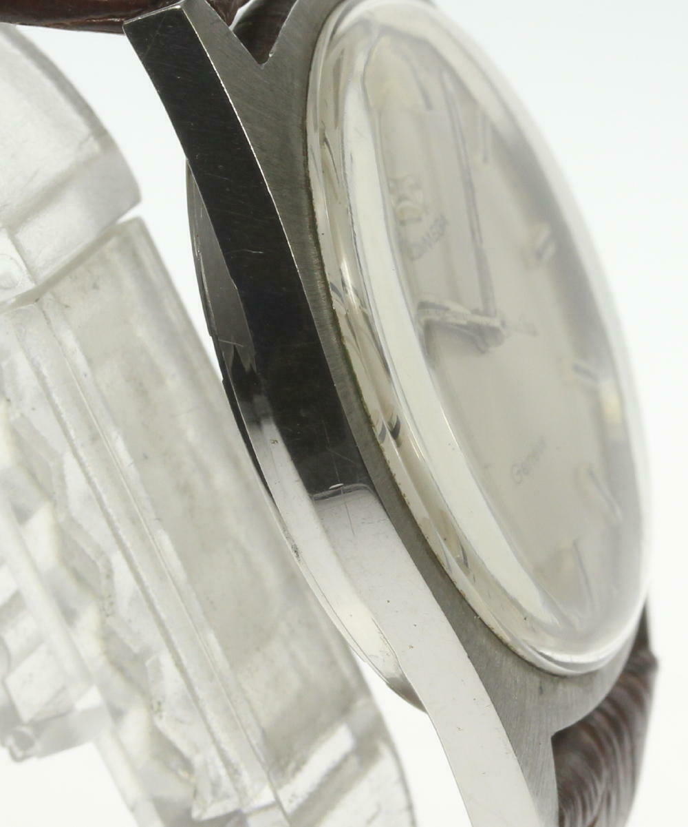

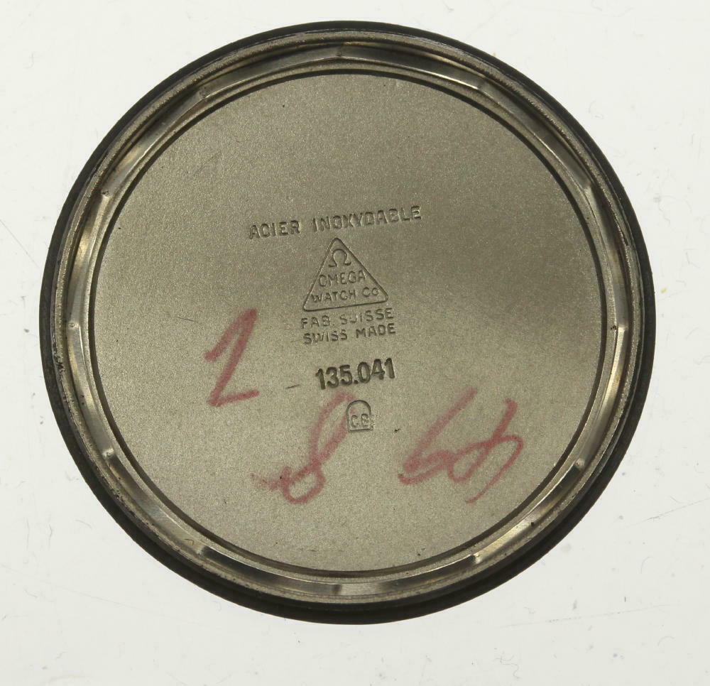

Last, but not least, the brushing on the case seems pretty fresh. Is that a technique that can be done with polishing? What were the Geneve cases originally like, brushed like that? Couldnt find a picture on the Omega vintage database (no picture available for 135.041).
Here's the link, and im also uploading photos from the listing: https://www.ebay.com/itm/OMEGA-Gene...633029?hash=item3d8db7b945:g:w8gAAOSwIJZdDHNI
Thanks for your time and expertise, looking forward to learning!

Looks like an entry level Geneve in decent original condition.
24,836
55,256
Halfhearted attempt to restore the correct radial brushed finish IMO.

I guess it's just lighting/photography that makes the movt. look odd.
The dial looks good.
The case looks refinished to me. I would expect it to look worse IRL.

Well known seller from Japan with honest offers.
Watch is running fast +20 sec a day, remains of the rotten gasket
spread all over the movement so a service (200 USD +) is inevitable
Add 20 % VAT on the price if you live outside Japan
Adding this to the not very good refinished case (see above): I think this is a pass
Actually that's the correct finish for these.
I agree that the radial brushed finish is correct. But looking closely at the case, it looks to me that someone has been attempting to restore it by hand brushing, and it looks pretty sloppy.
Would you have an example of an original radial brushed finish, or that of a proper restoration?
You can easily find photos for yourself with a bit of effort and research. It is a standard sunburst finish done on a lapping machine. The brushed lines should be very even, consistent, and straight.

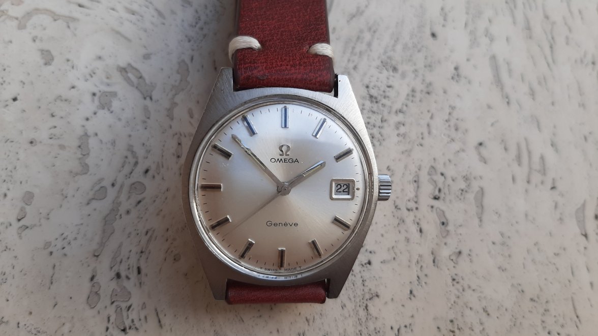

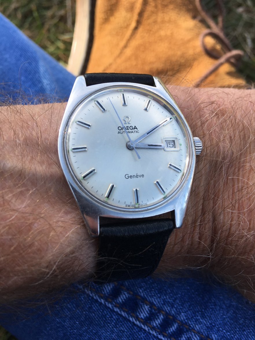

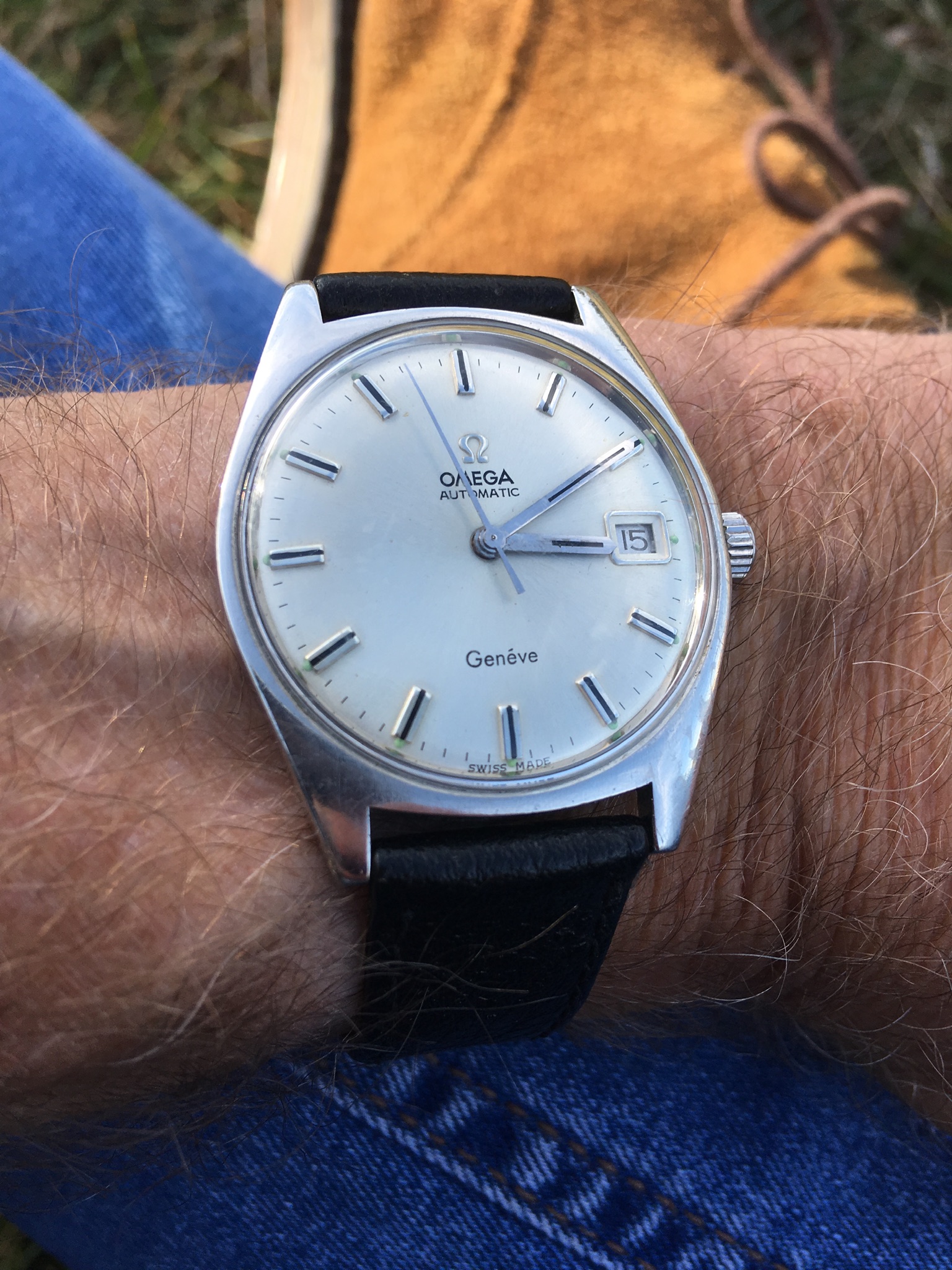

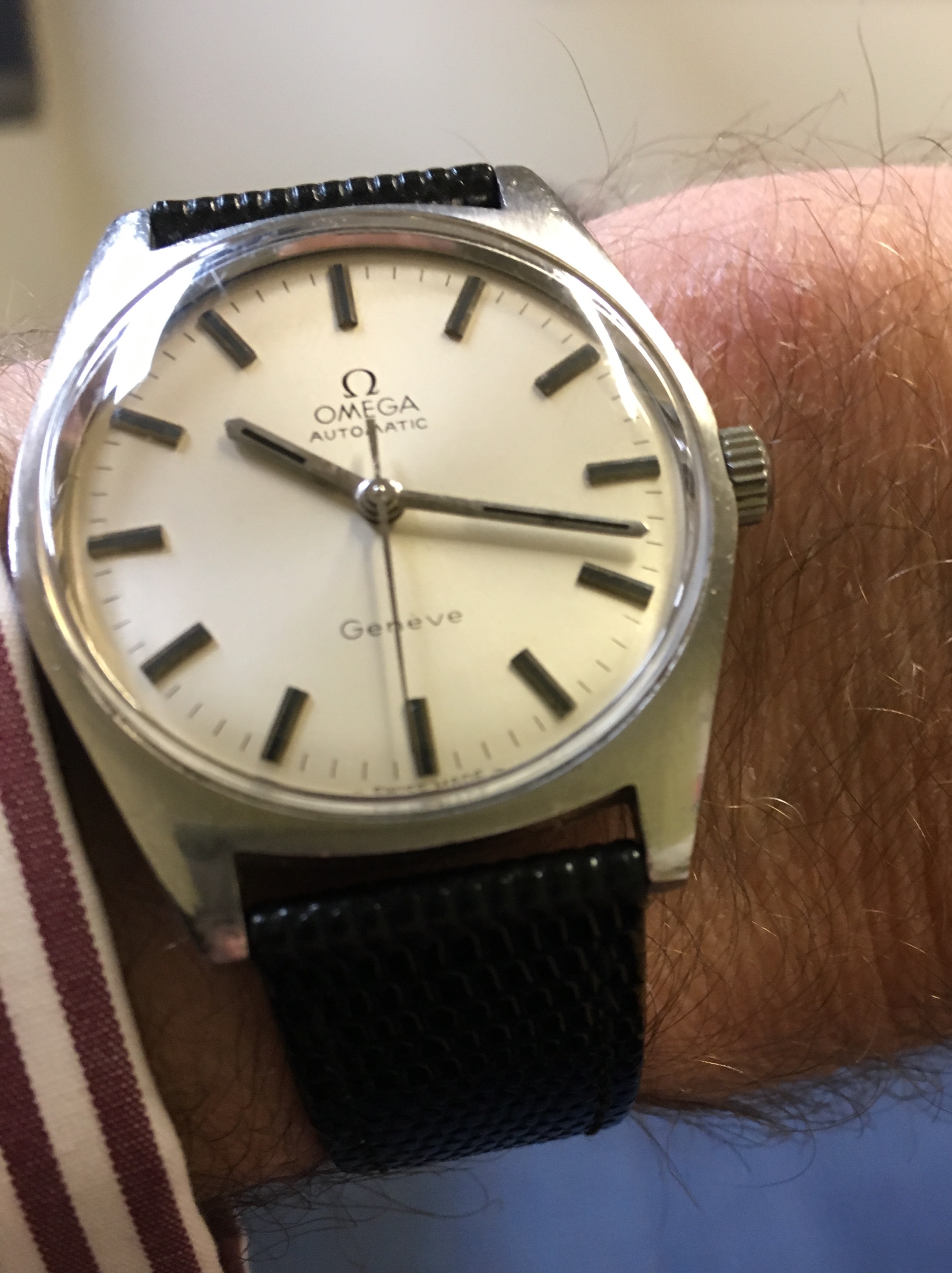

For comparison, I have this one with, I believe, the original brushed finish:
Gotchhaaaa, that does look more even than the one I posted but still hard to tell. Thanks for posting that!
