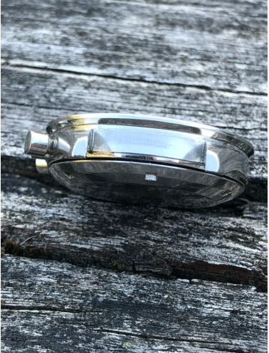

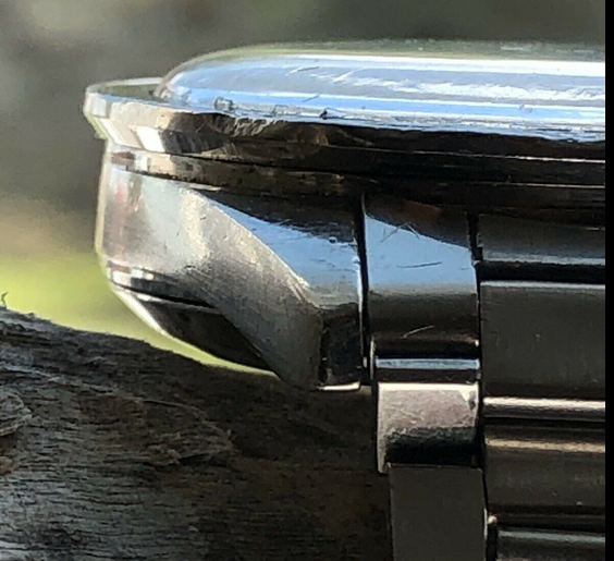

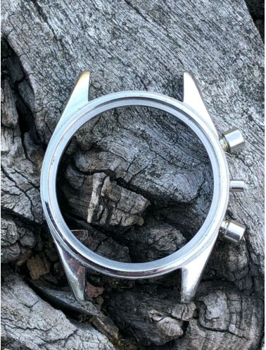

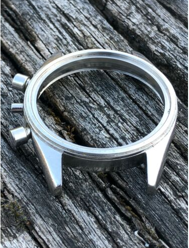

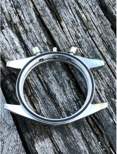

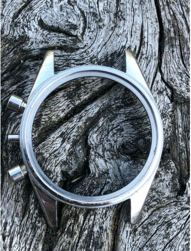

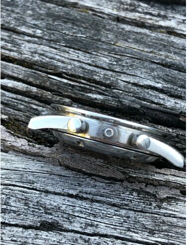

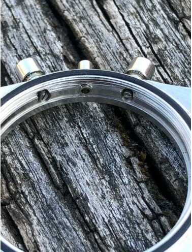

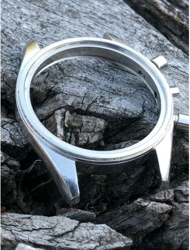

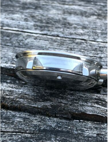

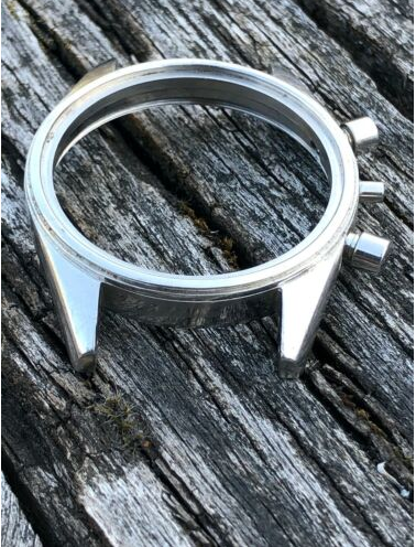

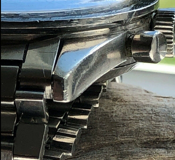

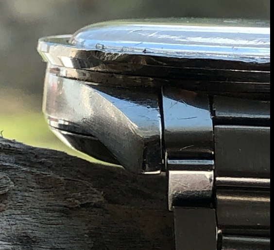

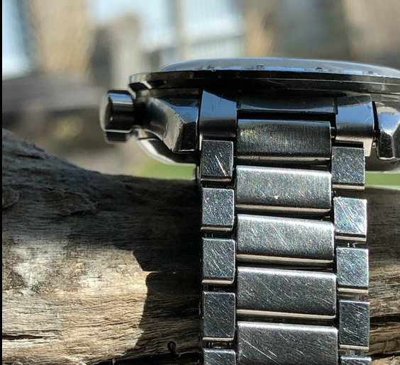

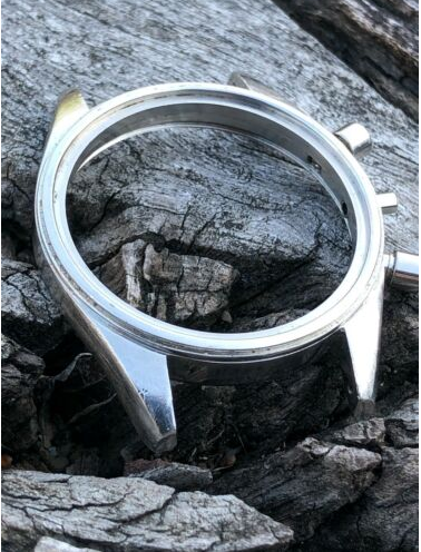

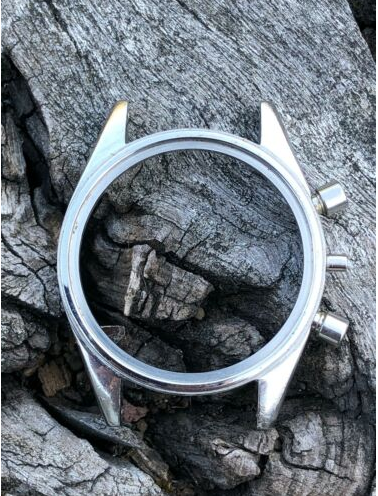

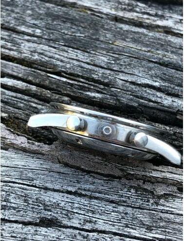

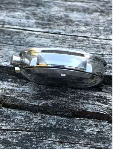

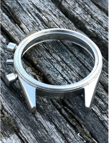

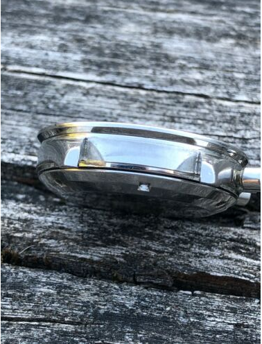

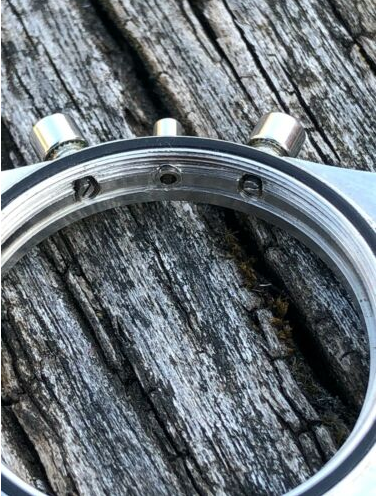

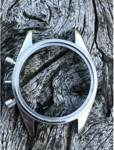

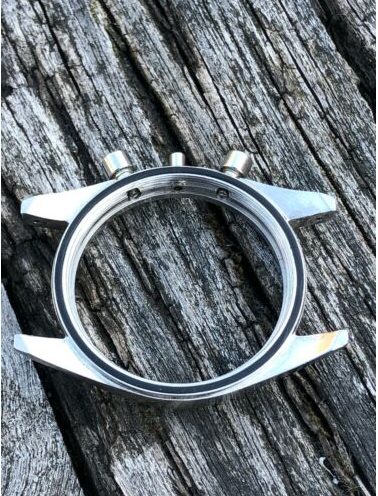

Hi, folks-- Curious how the collective wisdom would evaluate (and value) this case, from a 105.003-63 apparently. I am trying to educate myself and via pics, it is always difficult. I would say it looks like the bevels have been polished down and especially the ends of the lugs misshapen as a result? A lot of Ed Whites out there seem to look like this, even the examples in MWO. And then there there the un-beveled -64 cases....

IMO the -63 case should be beveled, and just the 64 is bevel -less.
3,653
7,770
They are both from the same maker HF and made for a short time only... I have seen -63 without bevels.
582
1,905
Have seen this on ebay. Interestingly it has screwed in pushers. My -63 has them as well.
10,804
16,814
We have discussed EW case variation at length on here previously, the -65 and -64 are now pretty widely known and agreed upon, there is still some debate on the -63 but on balance I am swayed to think that they were originally more like the -64 than distinctly bevelled -65. The point above about who made them is valid, the -63 and 64 share a maker, the -65 is by someone else. All these though have nothing like the excessive bevel seen on the FOIS. The OP case has clearly had some wear and maybe a polish or 2 but does seem to have the -64 type profile of no distinct bevel but a compound curved side. It may well be correct but a bit tired.

Yes I have read several of the OF threads on this, but as stated there isn't much (yet) on pre- 64 cases with regard to the bevel/non-bevel question. It's also odd that MWO does not discuss this non-bevel case phenomenon, which even in their own pictures in the book seem evident in -64 (and some earlier) straight lug cases.

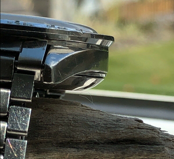

And MWO book is already in its 3rd edition and nobody cared to amend this particular content...
There is the question: do the authors not know or don´t they care to update?

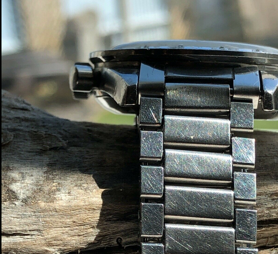

To me that looks like a -64...(edit : the one with the bracelet on...the case without a bracelet looks like a late 2998/105002 case...so maybe a 63???)
