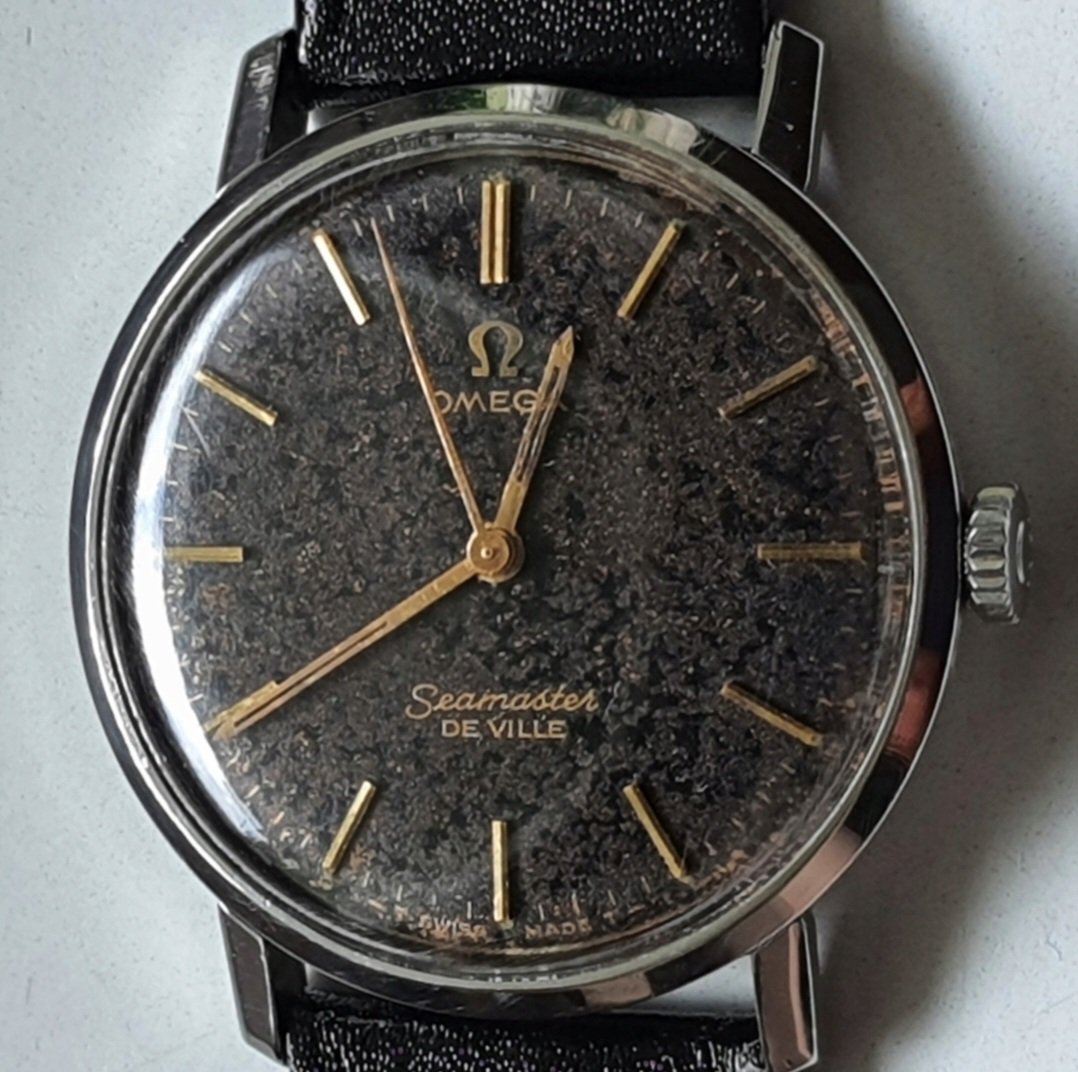

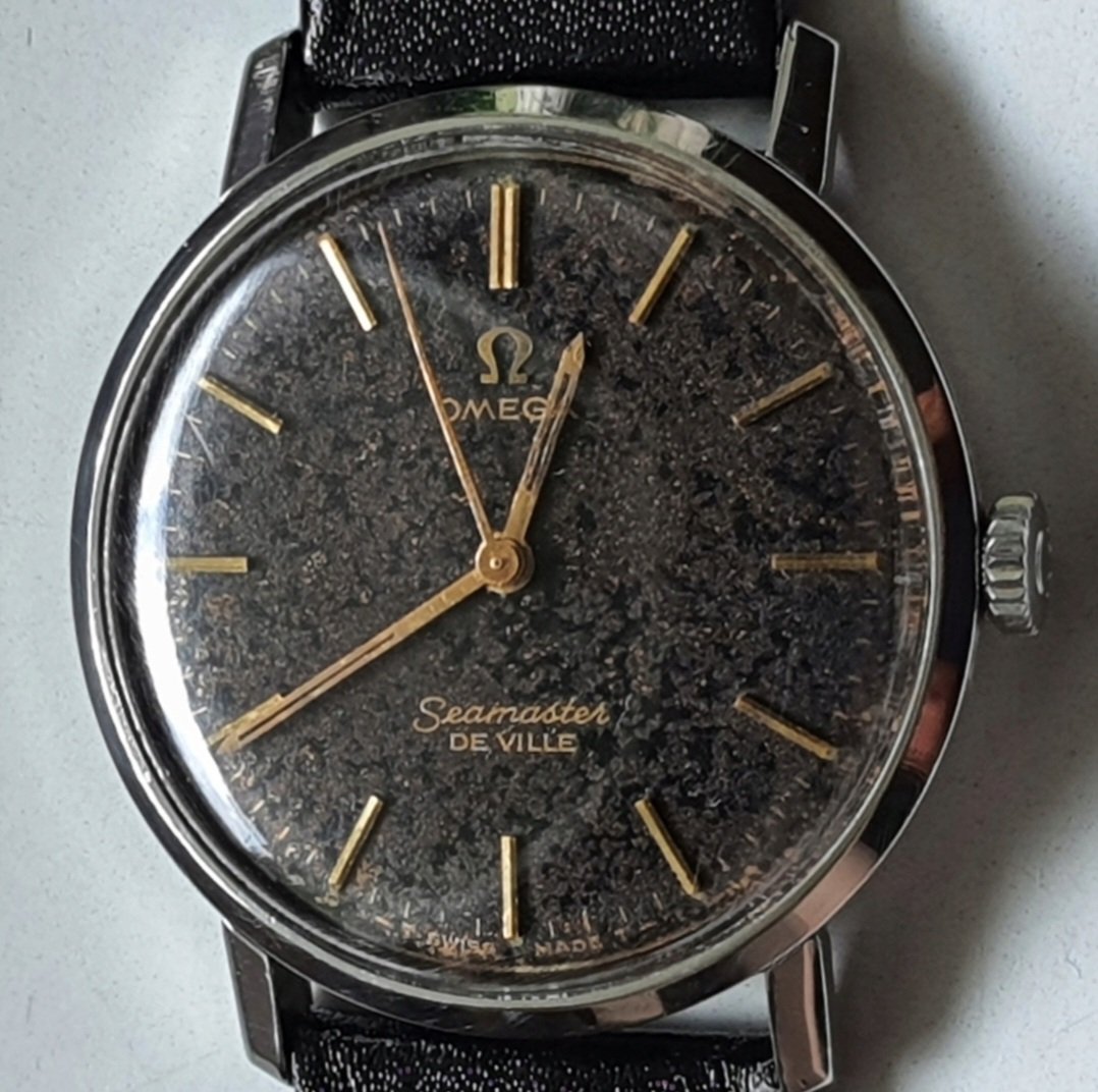

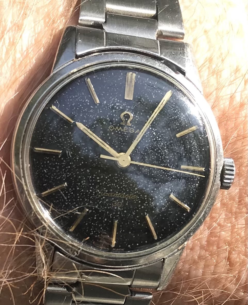

Hi, this is my first post here,
I' am considering buying this seamaster deville and want to check it autenticality.
Can you tell me something about the dial?
Thanks in advance
13,493
31,814
Authentic, yes, attractive no. Damaged dial, hour hand missing lume, second hand incorrect.

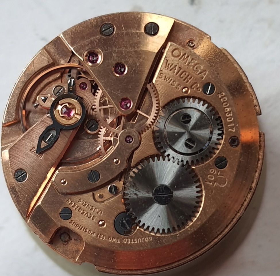

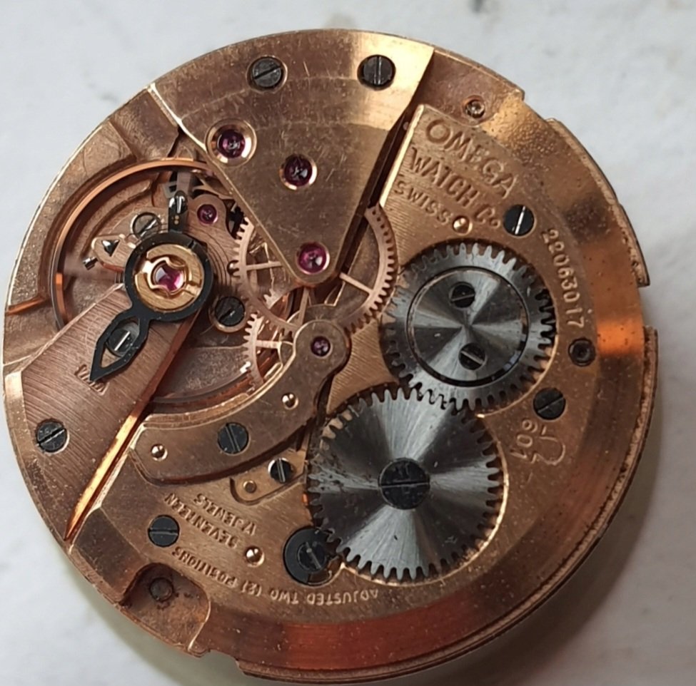

Thanks for the replies - can you tell if the movement looks ok?
Can you estimate how much it would cost to buy the right second hand?
13,556
23,504
Movement looks average. Appears to have mild surface pitting.
A second hand is likely around 30-100 of whatever currency, but finding once will be the issue.

Again - thanks for the replies

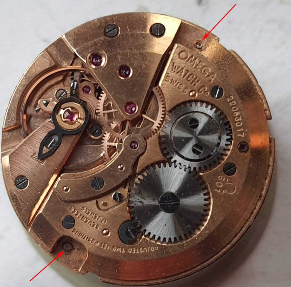

Does movement look like it was water damaged?
13,493
31,814
Yes, especially since the screws for the movement securing tabs are both broken off, plenty of other signs as well.

thank you for all the replies.
Can you estimate the worth of this watch?

Check ebay for similar model and condition to gauge the watch’s actual value.
At the end of the day, it’s worth what somebody would pay, given it’s current condition. I hope that helps.
