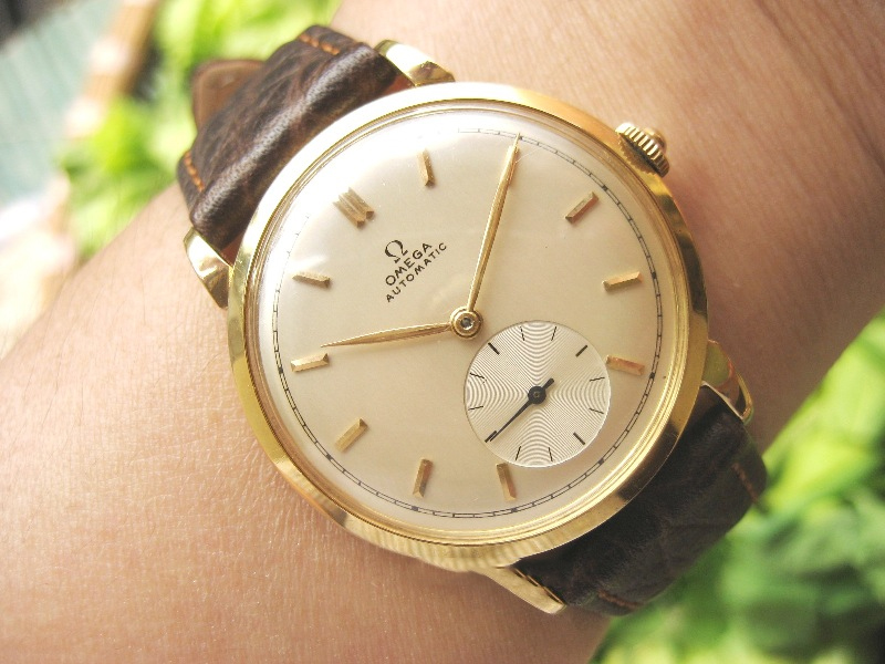

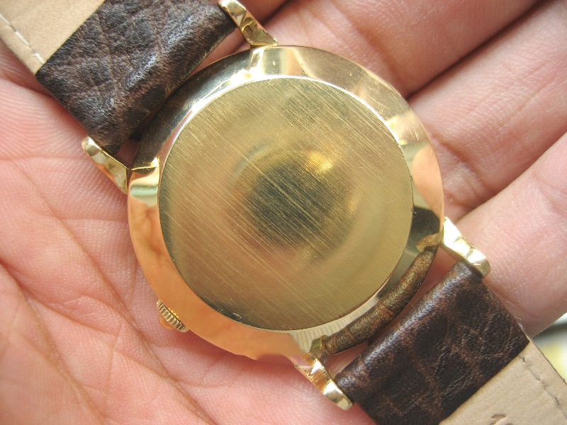

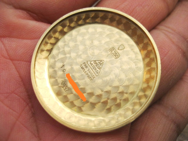

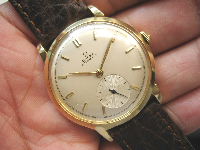

Hi All,

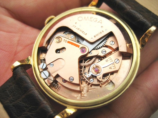

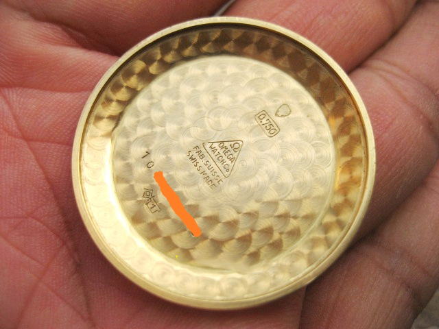

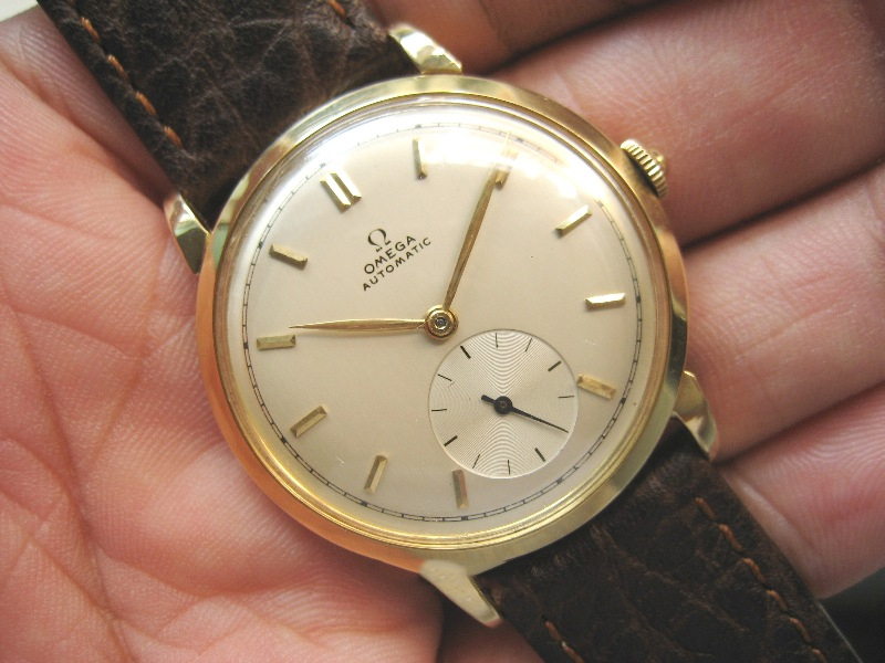

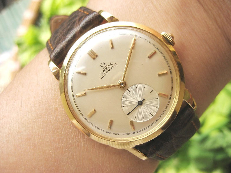

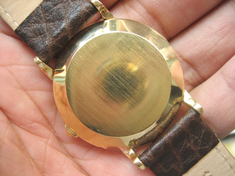

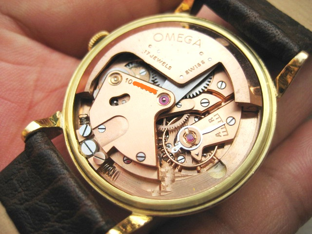

I'm new to collecting vintage Omegas so I was hoping to get an education/help from members of the forum. I know a seller that has several vintage Omegas and I'll start a thread for each one I am potentially interested in. This is the seventh one. Attached are some pics that are available and below is the information the seller has provided. Does this raise any red flags for anyone? And if this seems legit, what would be a fair price to offer (please be sincere in this feedback - I want to offer the seller a realistic price but one that is not unfair to me). Thanks!
Info:
Omega case 18K gold casting, automatic, manufactured in Switzerland around 1944.
  • v Germany 18K, still very new compared to the old (still the class of grooving outer shell, 4 ears and the back cover), inside casing seal gold, serial number and brand Omega;
  • Caliber 28.10 RA PC - version automatically first Omega, serial machine 10 million, produced around 1944 , the mechanism is very new and clean;
  • The original ivory- white dial is very beautiful, has begun to tinged with time but without any blemishes (the speck on the post was due to light effects ), the floating golden numerals are combined with the outer hour-minute division and the sub-gear at 6 o'clock are very classic;
  • of metal, glass and crown (very nicely) original 100%
The watch has a beautiful appearance and is still very new after nearly 7 decades of timekeeping (pictures do not reflect the natural beauty of the watch ), original and 100% authentic (not including strap and buckle), running steadily and on time, has a very high collection and use value.

That doesn't look like the original dial printing to me so, it will be interesting to see other comments.

Anyway: I vote redial as well

Honestly, the scripts are not up to factory standards.
Plus, the index at 7 seems to be squint - suggesting that indices have been taken out, dial reprinted, indices positioned in place,

Looks like a redial to me. But pics with a better resolution would be useful.

Sorry guys to contradict - IMHO this is a factory original dial on a perfectly preserved watch. I would go for it in a whim if the price was right.

Hi Erich,
Yes, could be! The case and the movement are indeed in excellent condition. I would like better pics to check the small second ring because it looks weird in the pictures we have at the moment. The scrips looks also a bit blurry, maybe because of the crystal plus the pics.

Agree, good eye! 👍

I am sure that several of you will question my assessment, hence I want to explain my verdict:
The dial is done in two-tone with a very narrow minute track which has a different graining direction.
Also some 30 mm chronometres have such delicate minute tracks. I have tried several dial restorers and asked them to restore dials with such narrow (thin) minute tracks in two-tone - all of them failed. If you know or find a dial restorer who is able to do this minute track correctly and so perfectly executed as on the OP´s watch please let me know. I would like to send him some "mission impossible" dials...
So when I see a dial with such perfect two-tone (extra narrow) minute track like this I am forced to assess it as factory original.
And its not only the dial - the movement looks fine (have a look at the screw slots!) and the case does not look overly polished. The whole package looks consistent. For me this is a perfectly fine and collectable timepiece.

This seems a very good point to me. I thought as well that the overall dial looks good and that is was consistant with the condition of the case. Although I tended to think it could be a redial because of the Omega script (not the script itself but the "blurry" aspect of the print) and the subsecond ring. But it could be because of the cristal and the pic.
