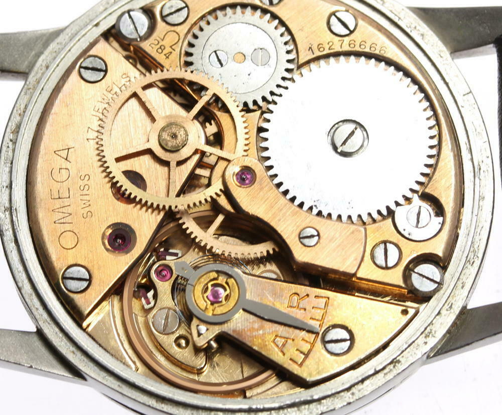

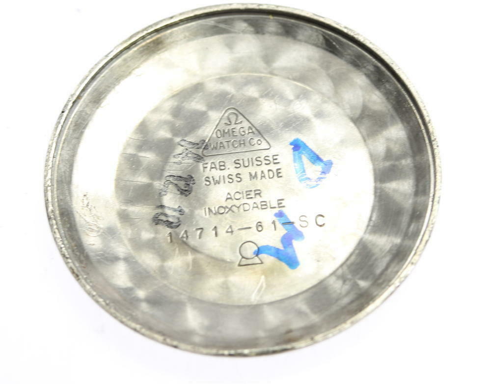

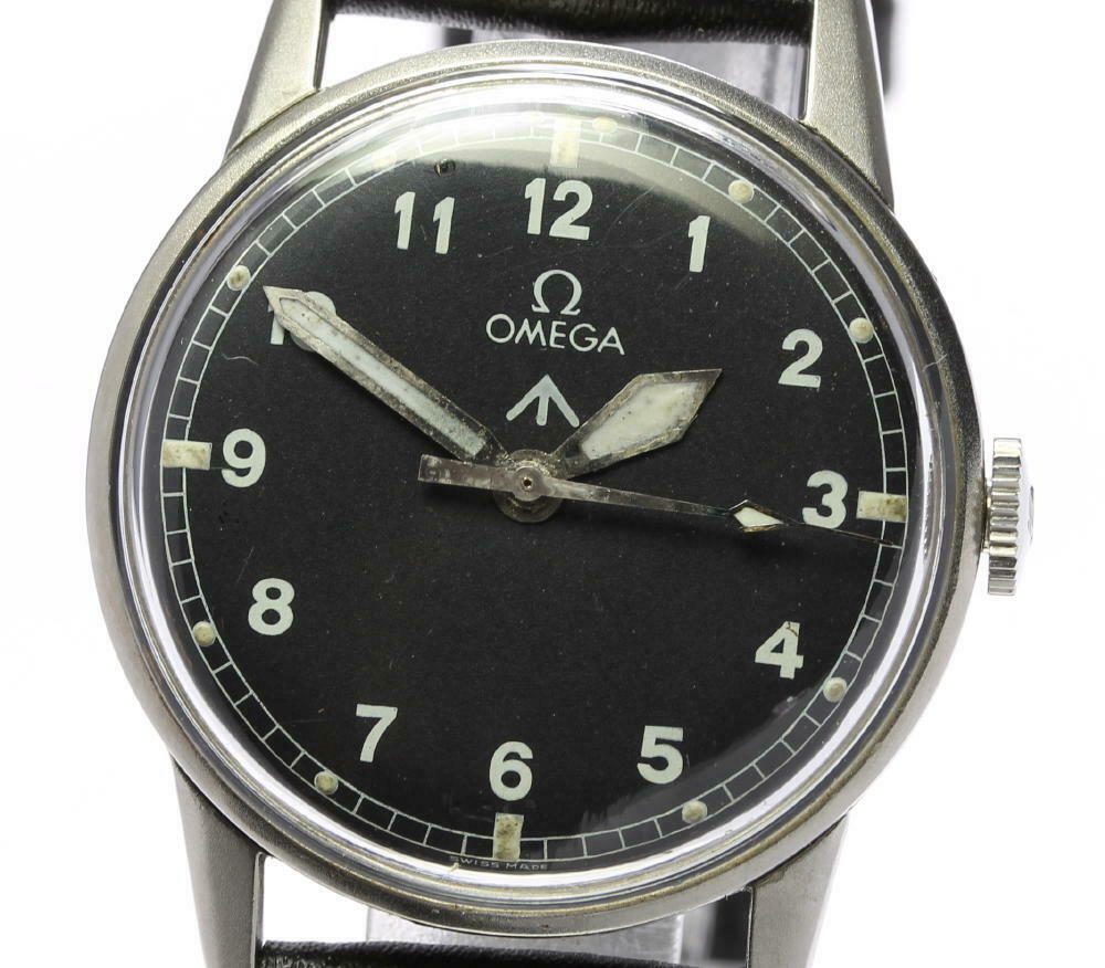

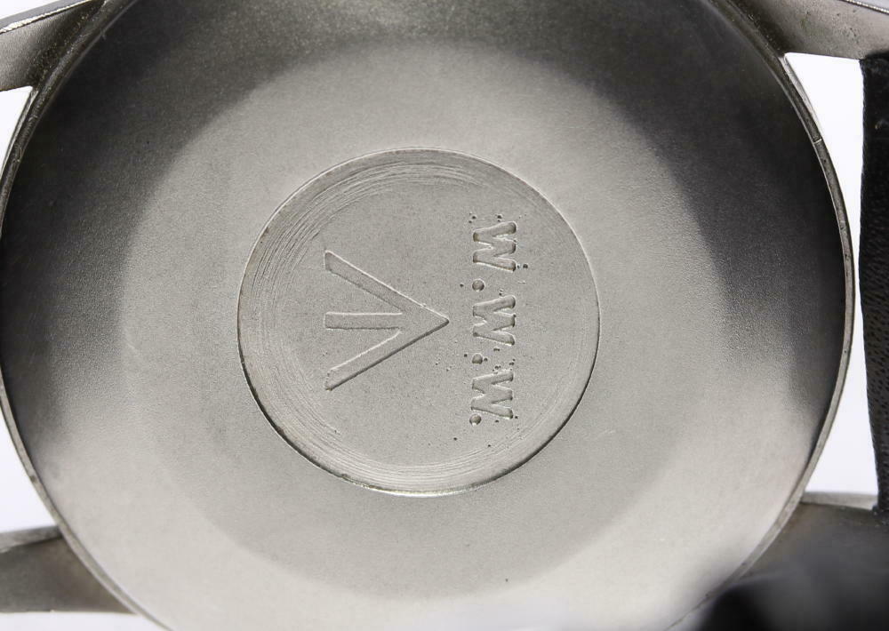

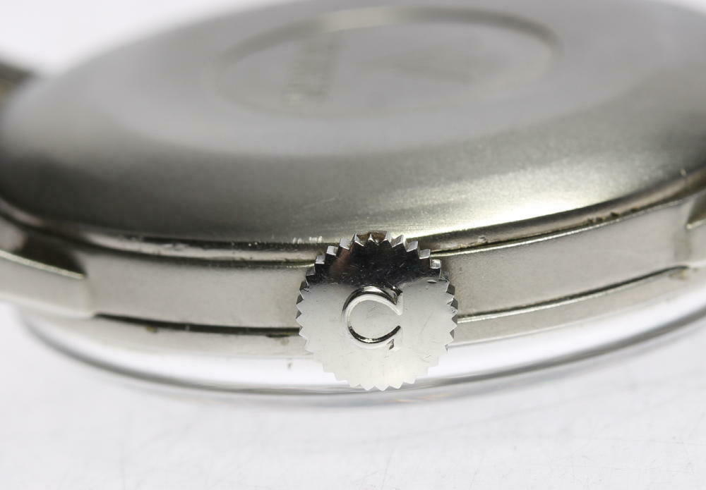

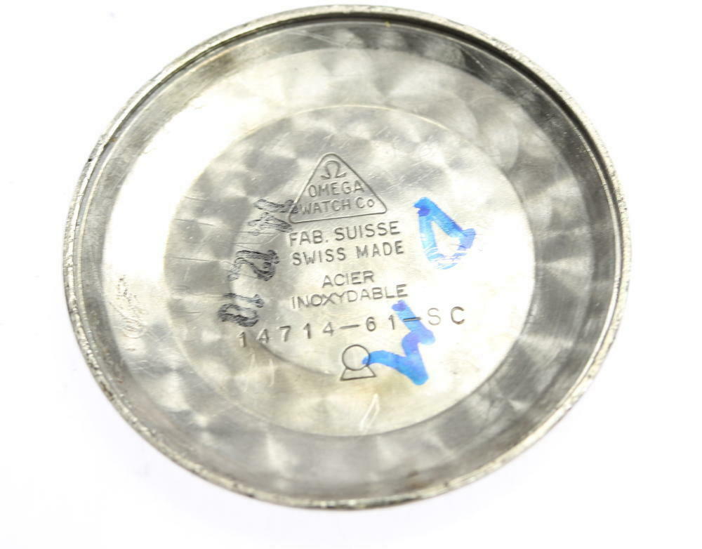

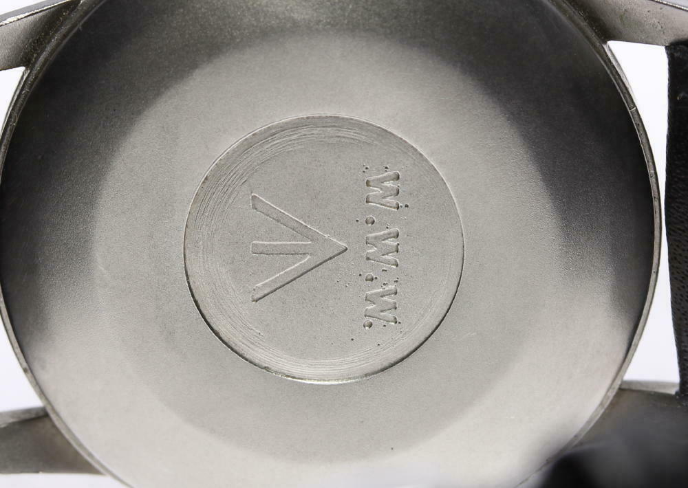

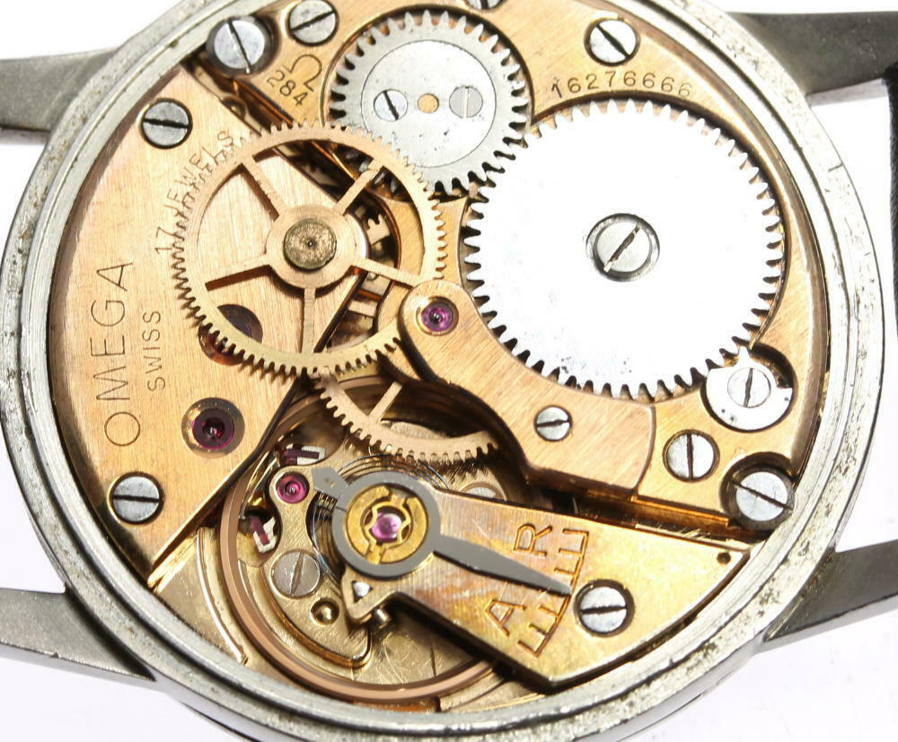

I just picked this up and wanted to hear your thoughts. The consistency of aging on the hands and the lume made me confident enough to bet it's not a fraken. At the same time, I just could not find any military issued 14714 on the web. Does it seem correct? If I request an extract from Omega archives, do you think I would be successful? Anything you could share would be greatly appreciated.

Before you ever get bamboozled again do your homework this one a easy fake to figure out. Dam a easy search of the net omega www issued watch and you would of passed on this pos fake. All 12 brands of the www issued watches have 15 jewel movements the movement in the fake 17 the dial and hands and case easy give away. I hope you can get your money back. Even issue marks are bad.
