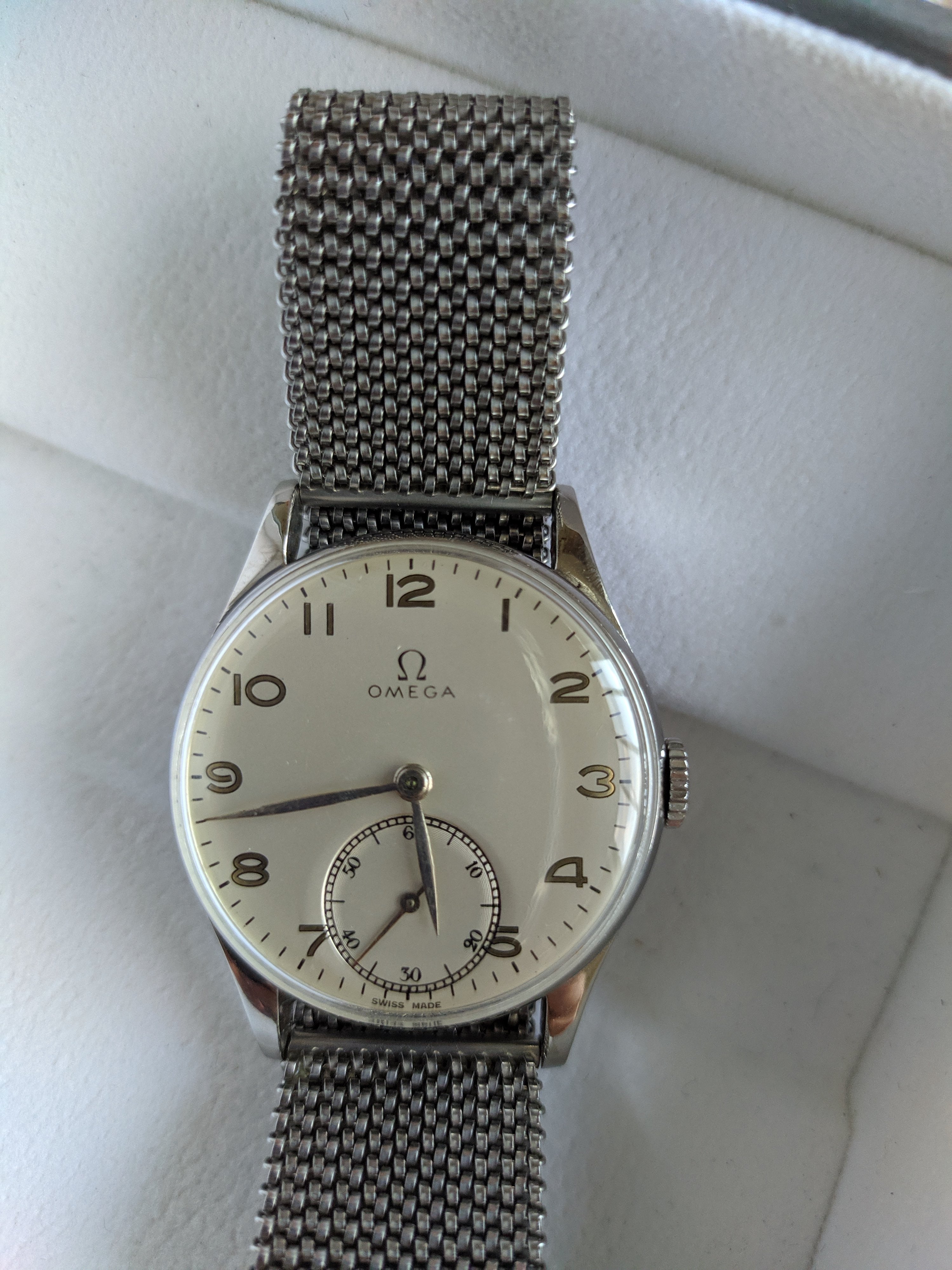

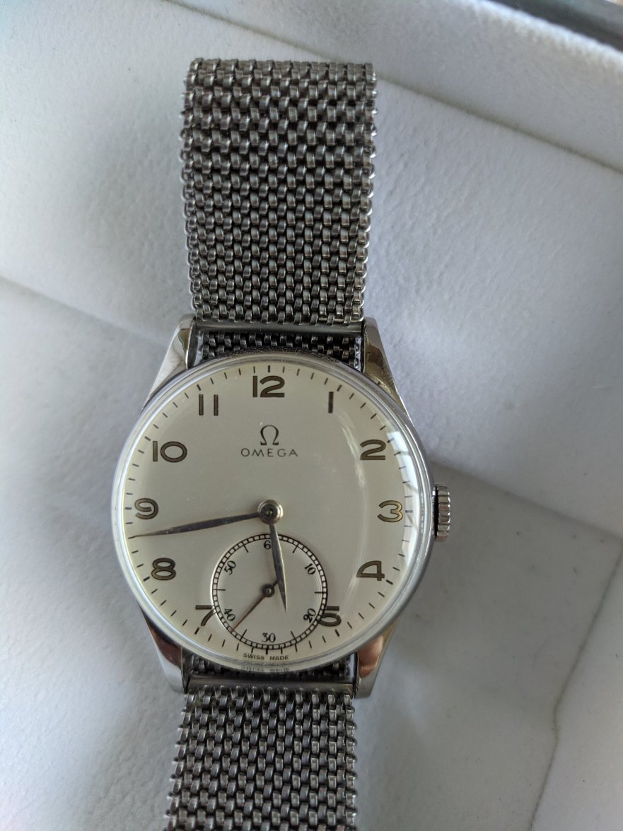

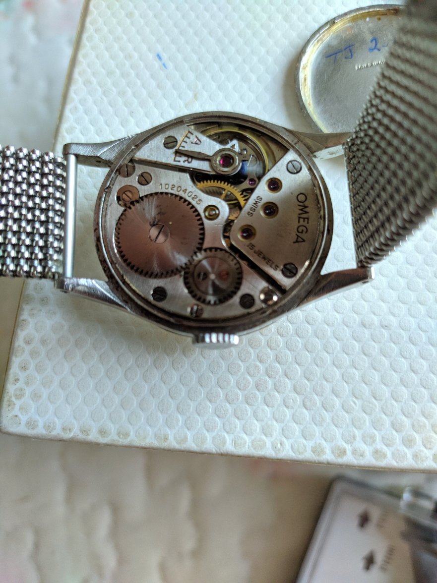

I just bought this 2390/2 omega online. I made my research but would like some advice about the dial, if it is refurbished, a redial or even original in pristine condition (i wish). Im not sure about the crown either, but seems legit to me. Thx

The dial has been redialed, but I think it looks quite nice.
Looking at this watch, the price was a bargain IMO.
2,326
1,887

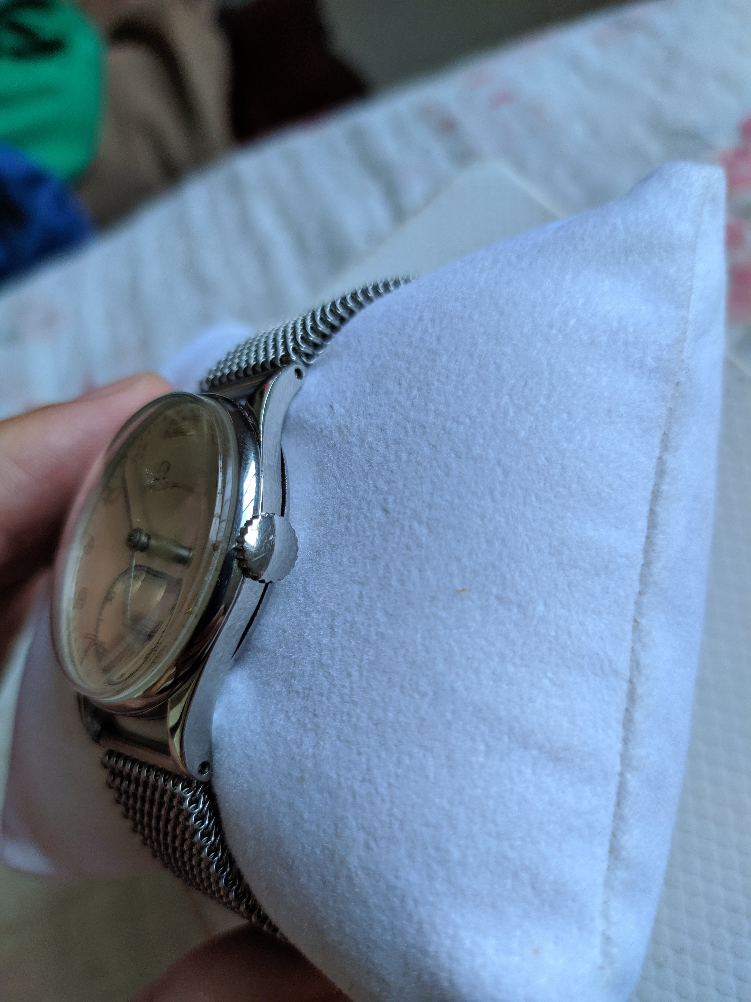

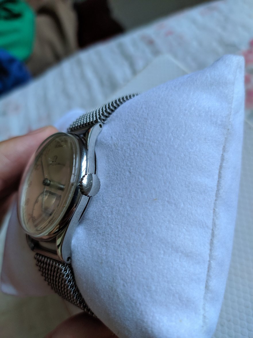

Your crown is consistent with an original from when it was first introduced according to an image on the Omega site.
https://www.omegawatches.com/en-us/watch-omega-other-omega-ot-2390
Mine is luminous, so there are some differences, but the shape of the Omega symbol and "OMEGA" are consistent with mine, so not a bad redial by any means.

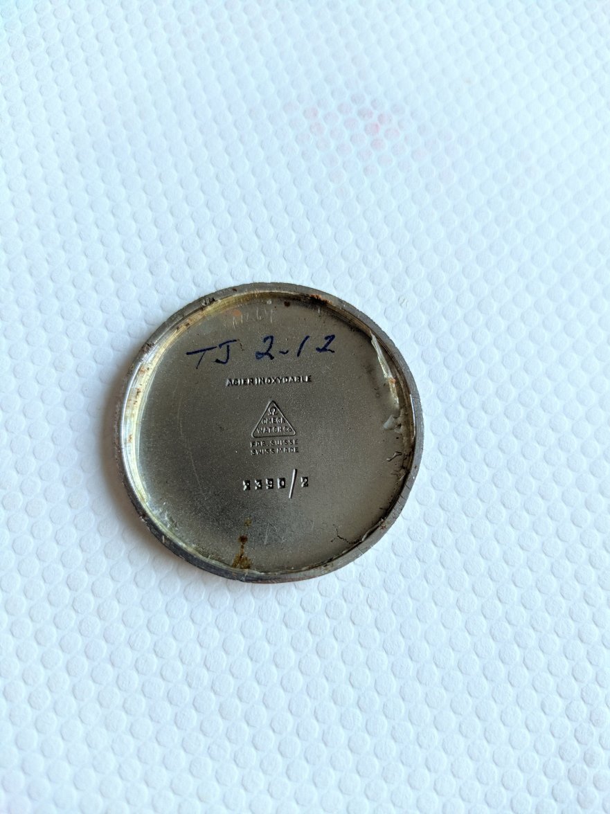

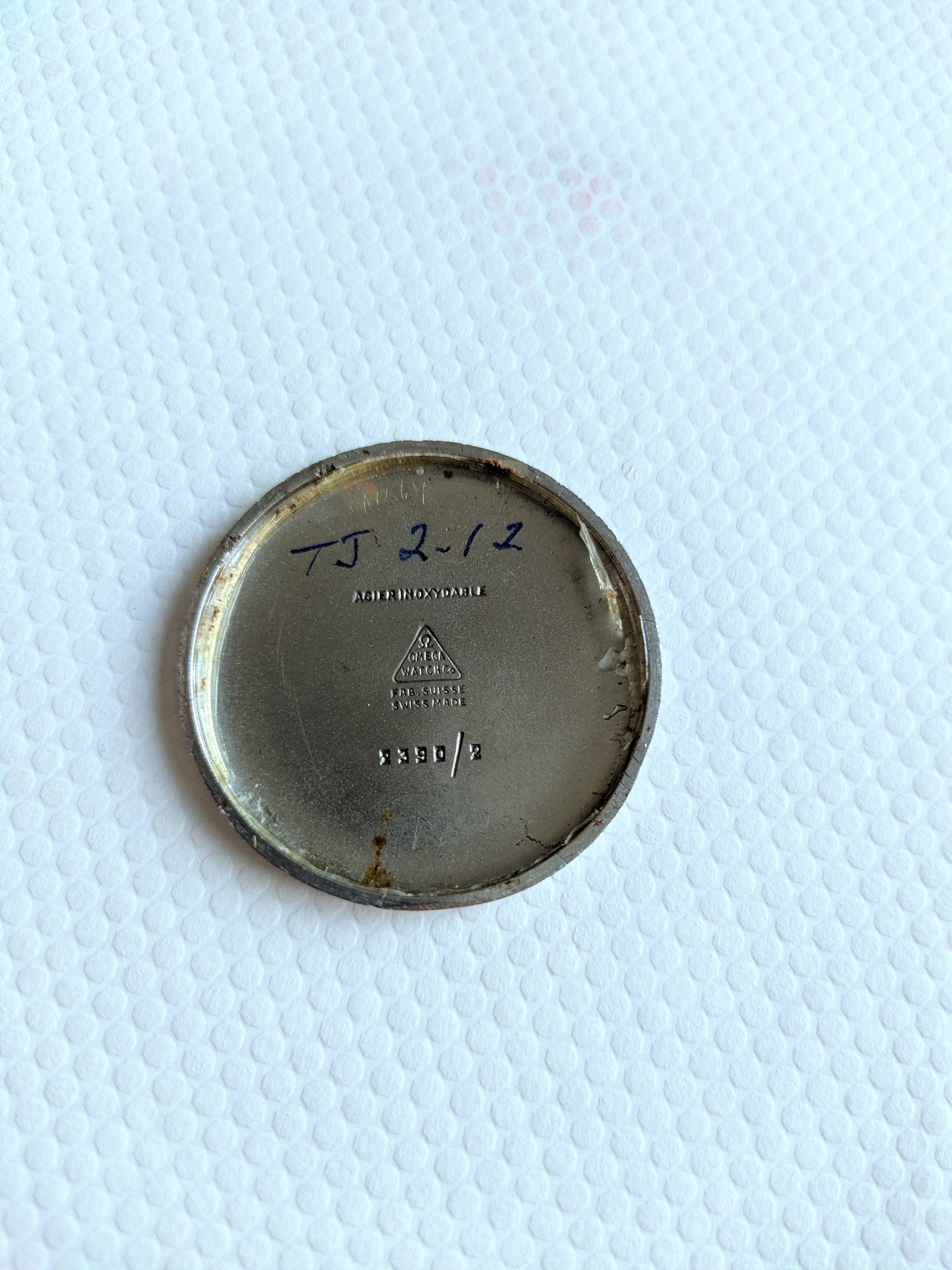

If you look under the balance, do you have a 30 or 30T1 or 30T2?
Good find with that super-rare Tessuflex bracelet in 11/16th. Wish I had one long enough. 馃榿

Thanks, any thoughts about the crown? I think the style is correct. Im not sure if if it should be signed tho.

If you look at the link I shared, you can see the unsigned crown. Yours was made just before that transition, and mine was made just after.

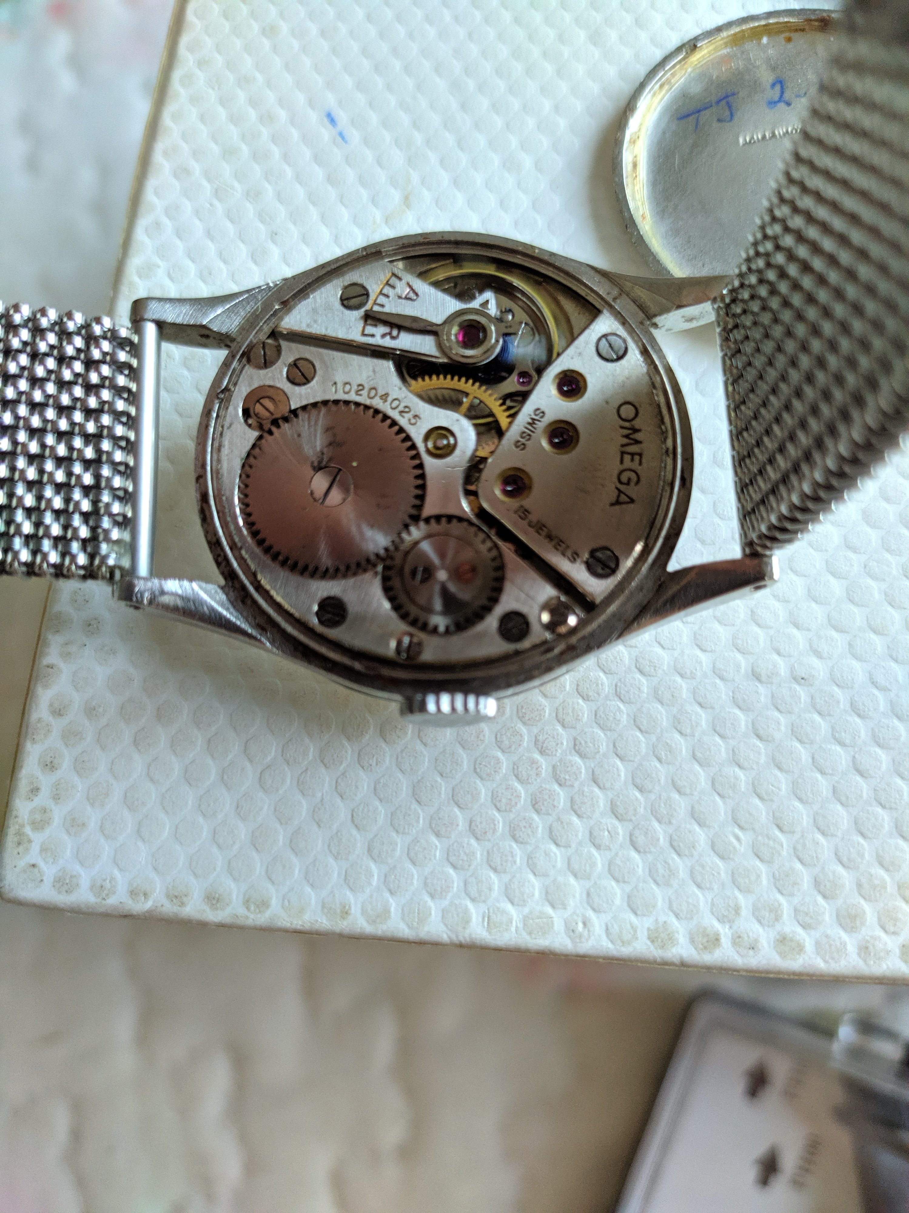

I set it to work as soon as i got it and the balance hasnt stopped yet. I tryed but couldnt see the number. As soon as it stops I will post here! Thanks about the crown advice

Its a 30T2, thx for all all help!
