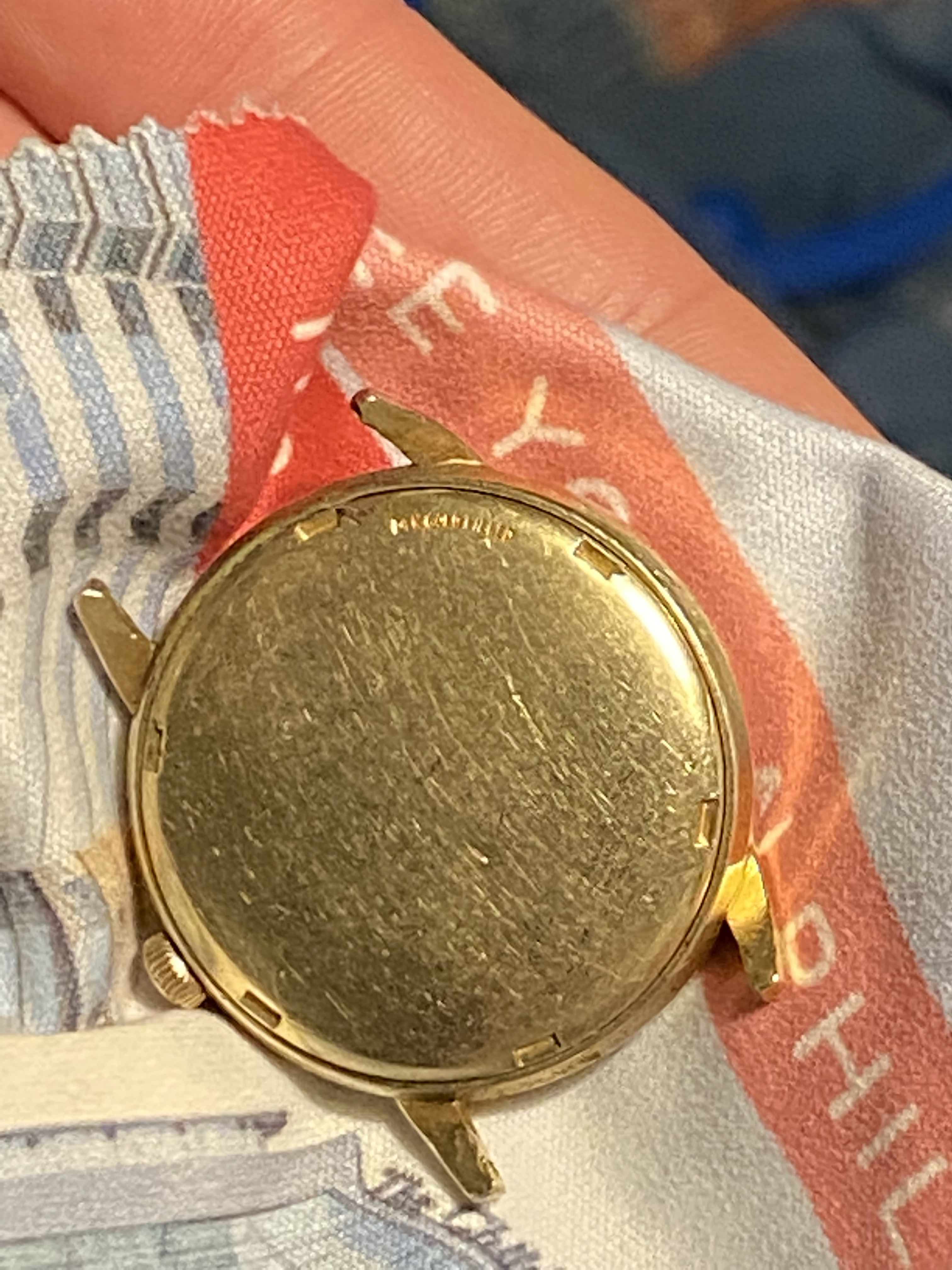

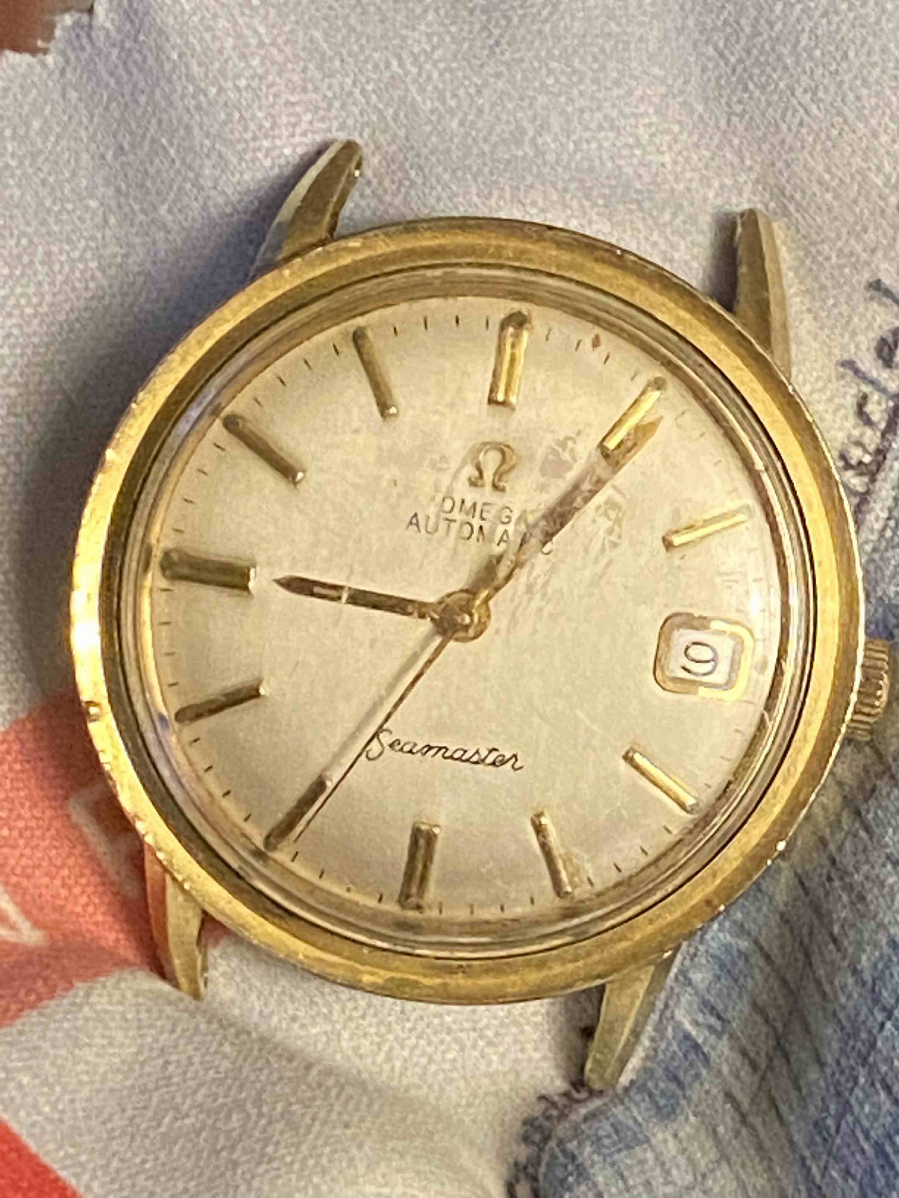

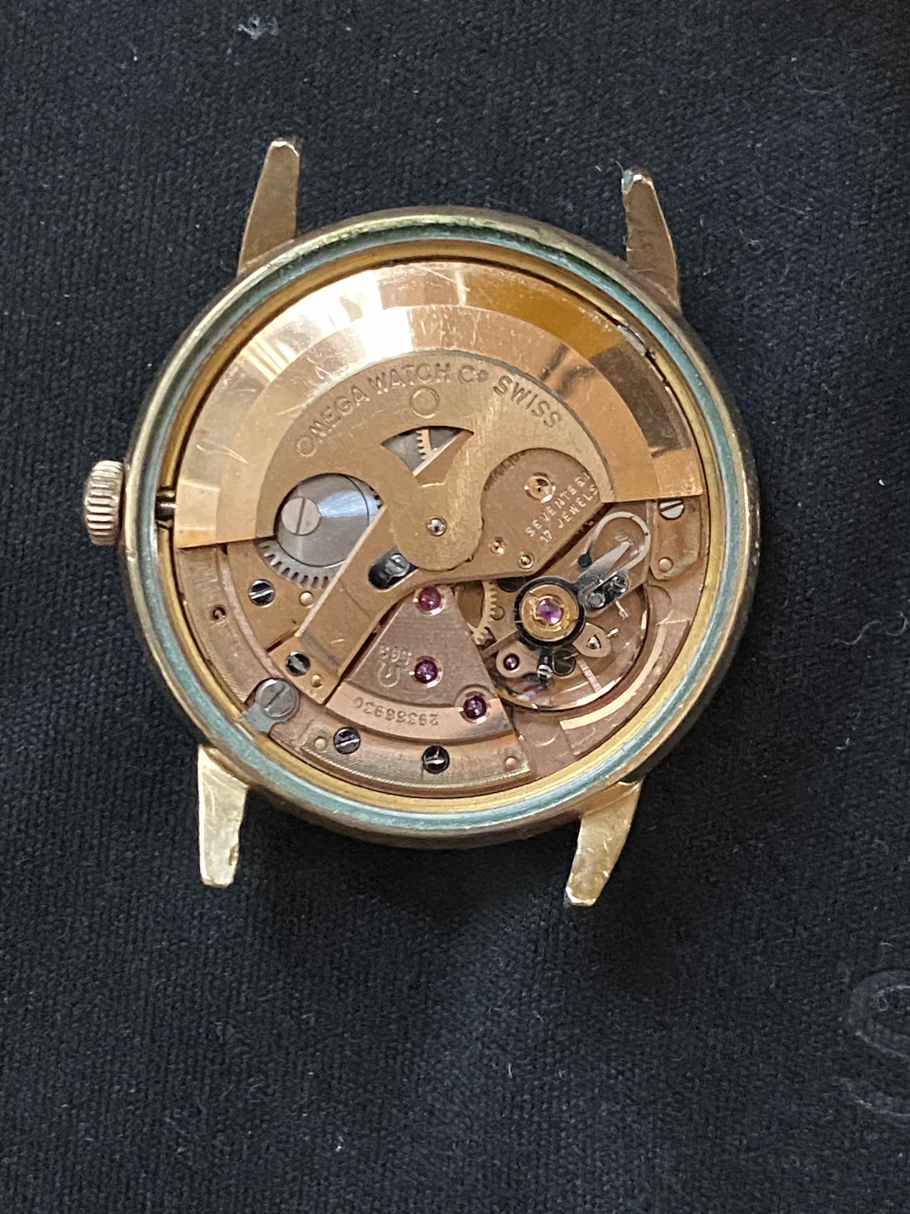

I'm interested in fixing up my father's Seamaster. He has been the only owner since purchase, serial number points to 1969 manufacture. It has a caliber 563 movement and keeps time but is well overdue for a service.
Based on researching the reference here and around the net, I identified some issues:
-Crown is not original, I would like to get an original crown
-Was re-dialed at some point. Typefaces on 'Omega' and 'Automatic' are wrong and missing 'swiss made'. The applied indices look good.
-Case is pretty beat up, though I'd like to keep it in that condition if possible.
I'm more interested in preservation over collectibility; given that, I was thinking of keeping the original dial and re-dialing instead of trying to find a replacement. My questions:
-What are the pros and cons of having Omega do the work vs a respected 3rd party watchmaker? And the cost differential?
-Would the dial need a full overhaul or could I just get the text re-printed?
-What should I consider doing re: service of the gold filled case? Is it best to leave as-is?
It looks like a watchmaker bent two of the lugs, which makes sense because this case had a weird 17.5mm lug width. I think I'll keep it like that as it would be hell to find a strap in the original size. Would Omega even be willing to touch the case? this reference was one of the American cased references.

I doubt anyone bent the lugs purposefully. It's amazing how often this happens, but nobody ever admits to doing it. Personally, I suspect that idiots try to hold a watch in a vise. Regarding the restoration, you have quite a project ahead of you, but it will be a labor of love. Any way you do it, the cost will be significant. If money is no object, an Omega restoration would be the easiest approach, since they will take care of everything, and they might have some of the original parts, you never know. If you want to do it independently, you can probably save money, but you will need to research the restoration of each component separately and identify a dial restorer (the dial will be completely refinished), a case restorer (not much can be done to the damage, but maybe the lugs can be straightened), a watchmaker to repair the movement (it has bad rotor rub), etc.
Frankly, I don't think I'd attempt a cosmetic restoration, but that is your decision. Overall, if you are determined to restore it, my advice would be to have the lugs straightened, the dial refinished, and the movement repaired/serviced. I would be very cautious about doing much to the case. The edges and facets of the case are actually pretty sharp and the major damage seems to be on the back of the lug, so I'm not sure you will be happy with a full restoration of the gold-filled case.

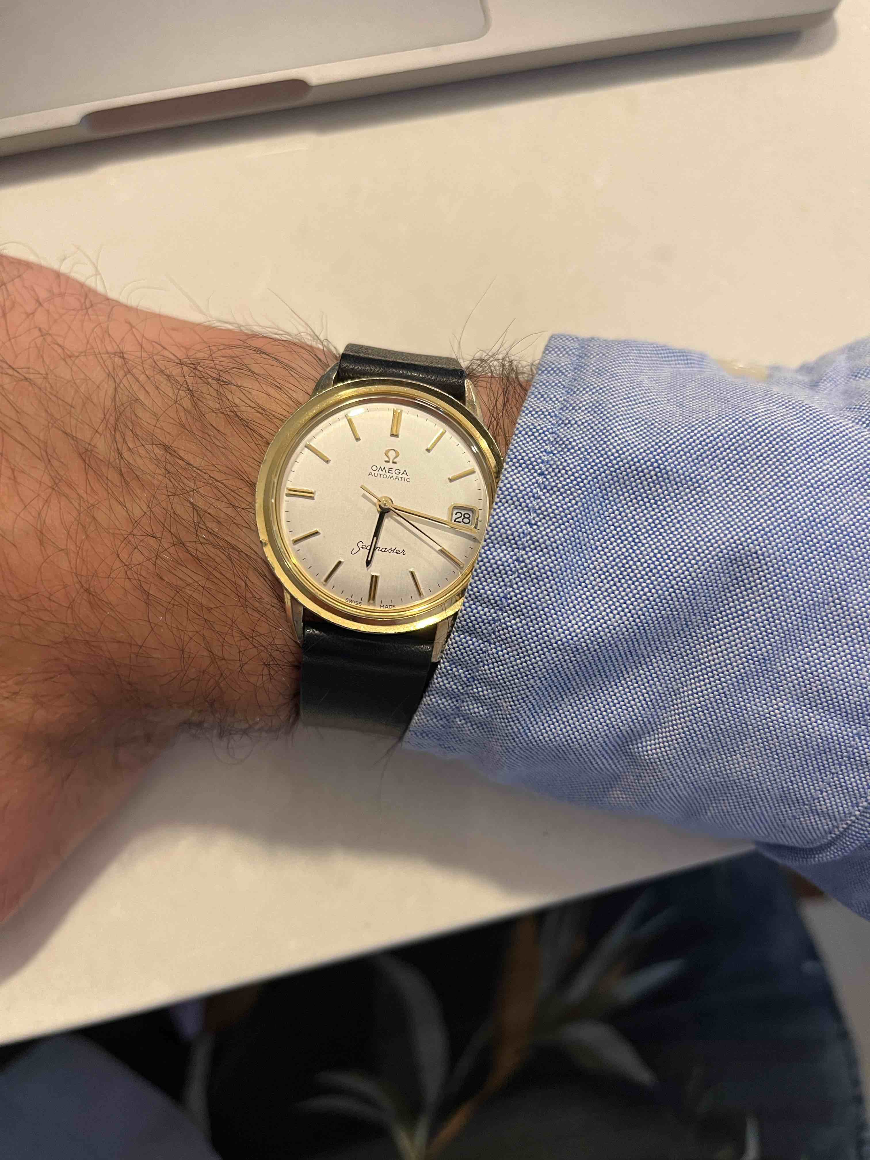

Just closing the loop here-
I decided to send to Omega and after ~10 months it came back looking and feeling as good as new. Thanks everyone for the advice, and grateful Omega provides this service.
