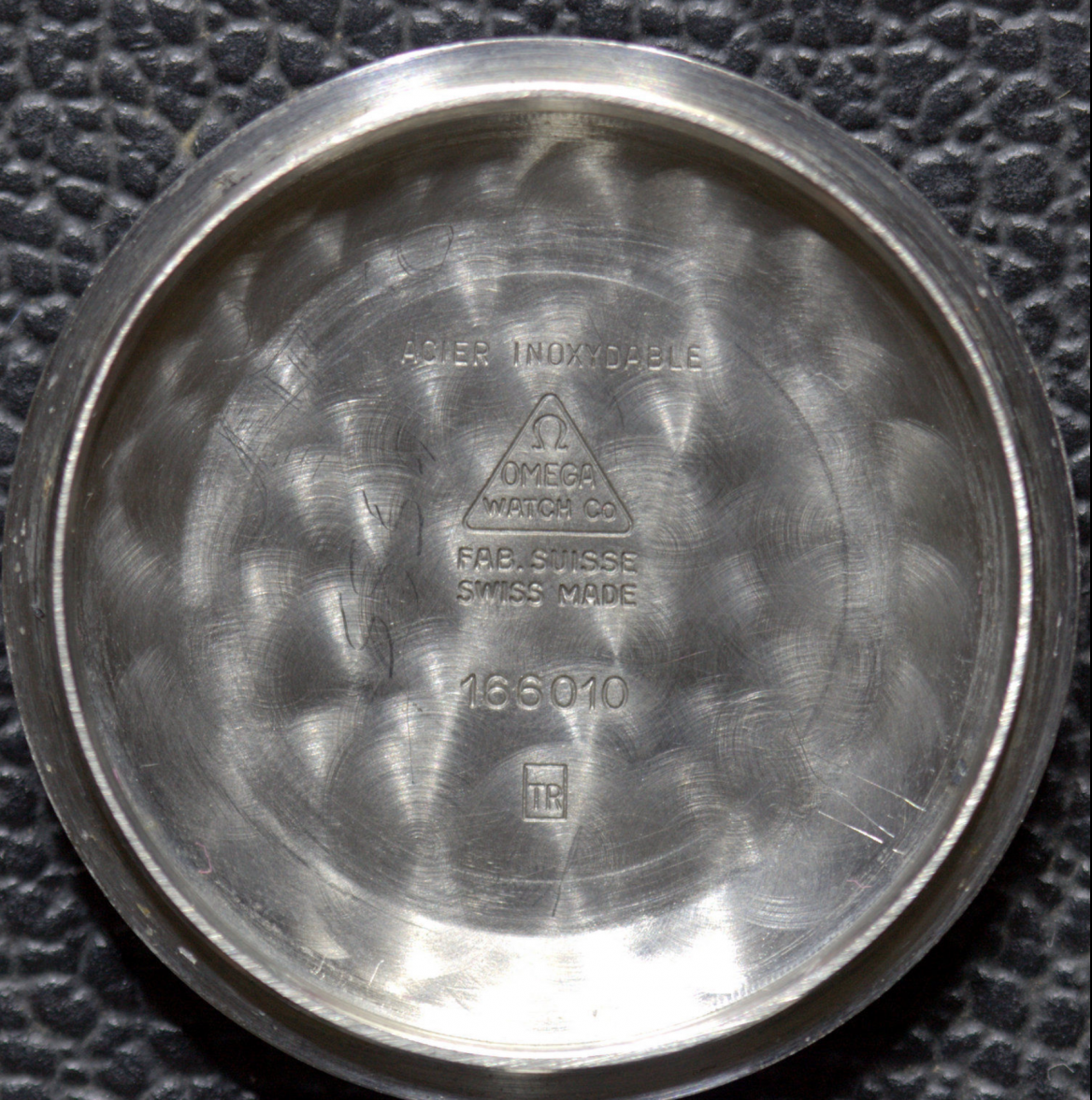

    I just purchased a Seamaster 166.010 cal. 562 for what I consider to be a pretty good price. It's my second vintage Omega, and is pretty close to being exactly what I wanted. With my limited budget, I couldn't pass it up, and I'm really happy with it.
    The watch was supposedly serviced before sale, and seems to be running well, although it's still a little soon for me to tell for sure.
    However, I have two issues with the crown. The most glaring issue is that the crown unscrews from the stem. I was winding back and forth between 9 and 1 to try to set the date, and after several cycles, the crown just fell off. I panicked, but quickly realized that it wasn't broken, but had just unscrewed. I was able to easily screw it back on, and can set the time counter-clockwise by turning the crown toward the 12 o'clock position. Handwinding toward the 12 position seems to be okay, but if I move the crown toward the 6 position, it begins to unscrew.
    The second problem is that the crown just seems to small. It was fairly difficult for me to wind, being so small. I initially thought it might be incorrect for the watch, but I'm not sure. My research says the crown should be a 069ST42524, which is 4mm. I don't own calipers, but using a ruler, it seems that the crown is 4mm, so I'm inclined to think it's the correct crown. However, I'm wondering if there is a bigger crown I could use to replace it, especially since the current crown in unscrewing.
    Is there a crown I can get to replace the small one? How do I go about fixing the unscrewing crown? Is it a job for a watchmaker, or is there an easy fix for it?
    Thanks so much!
    Edit: Does anyone know when the watch was made? I think it was the in the 60s but I'm not sure.

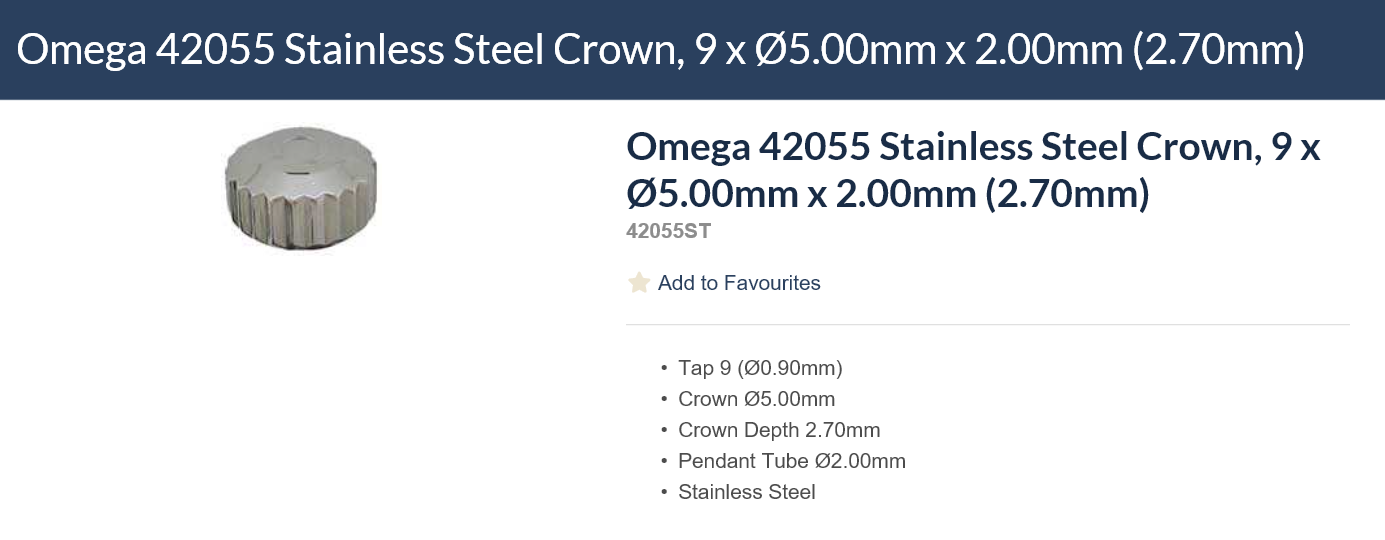

    I didn't previously know about the OVD. Thanks for sharing the photo. Based on that photo, it does look like the crown on my watch is too small. However, doing some research here gave me the part number 069ST42524 for the crown, which leads to this ebay listing: https://www.ebay.com/itm/Omega-Genu...itm=173431012893&_trksid=p2047675.c100623.m-1Purchases made through these links may earn this site a commission from the eBay Partner Network, which seems to be the crown that's on my watch.
    How can I find out for sure the part number for the bigger crown shown in the photo you shared?
  4. Archer Omega Qualified Watchmaker Aug 14, 2018
    26,470
    65,624
    The current replacement crown listed for you case number is 069ST42055.

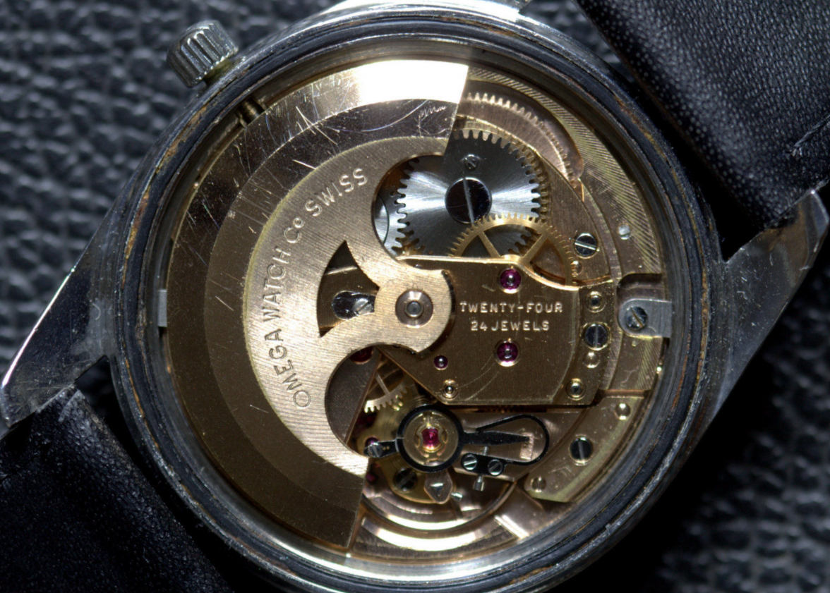

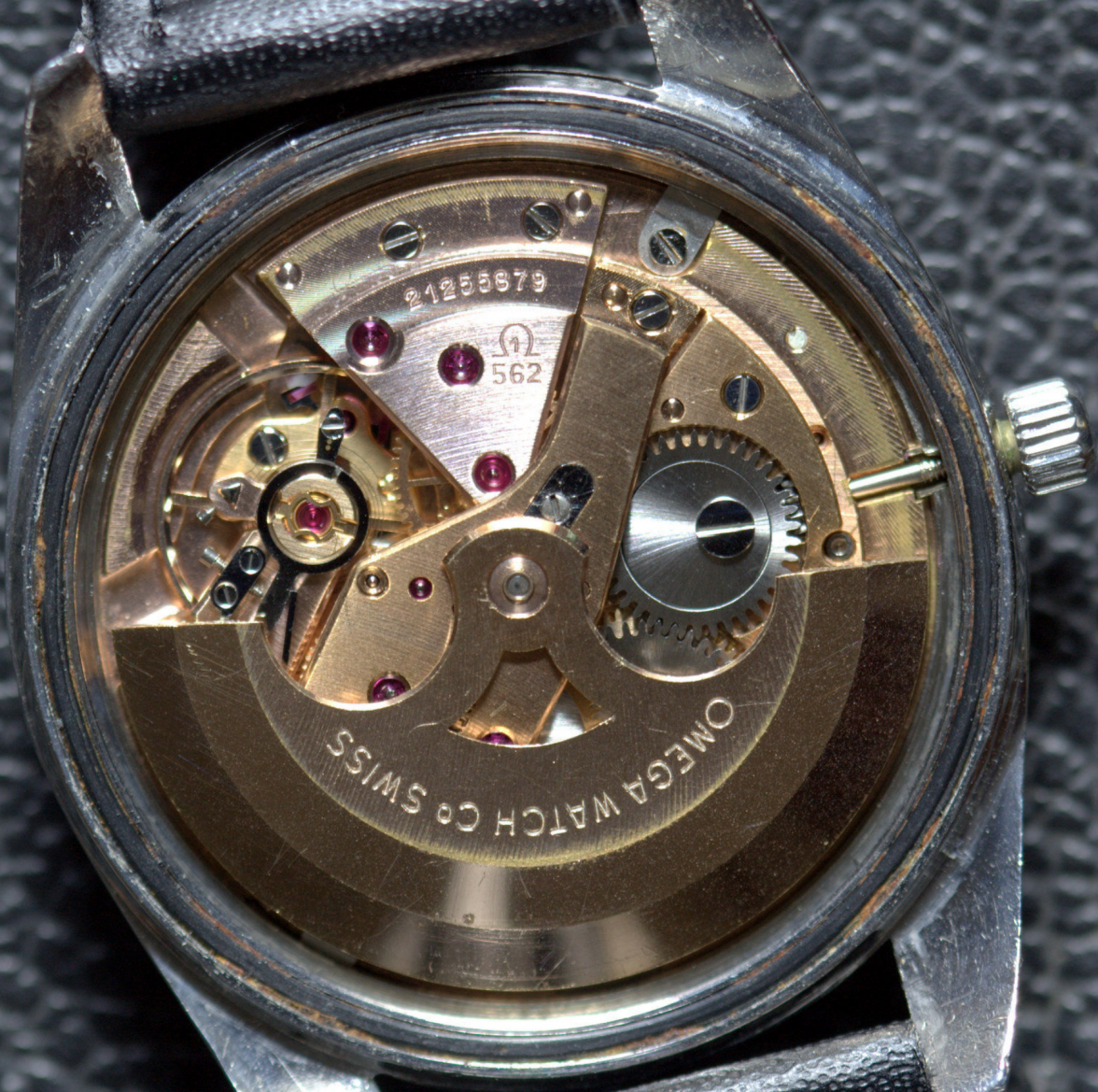

    Serial number of the movement is 2125.... so watch should be from around 1964
