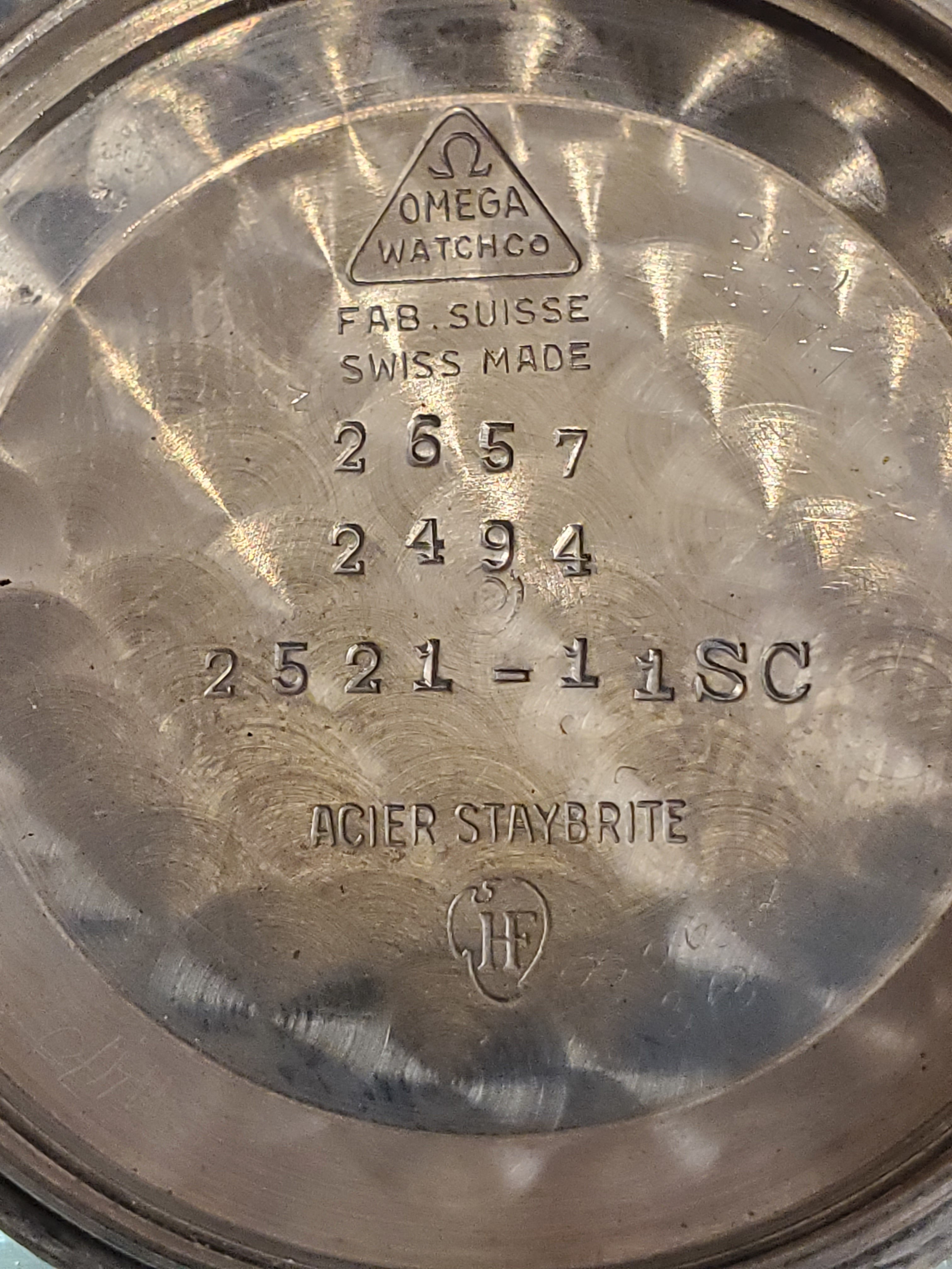

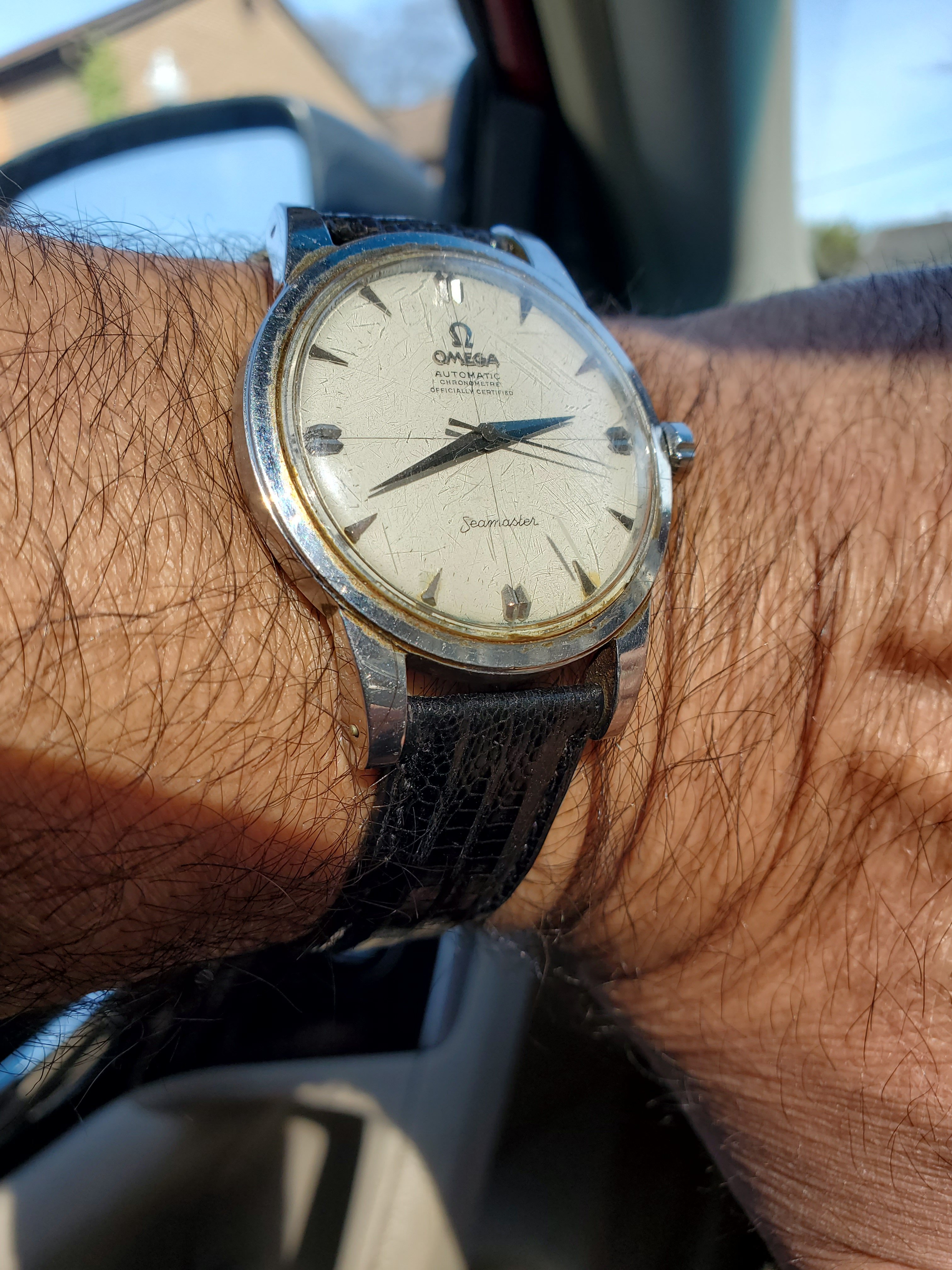

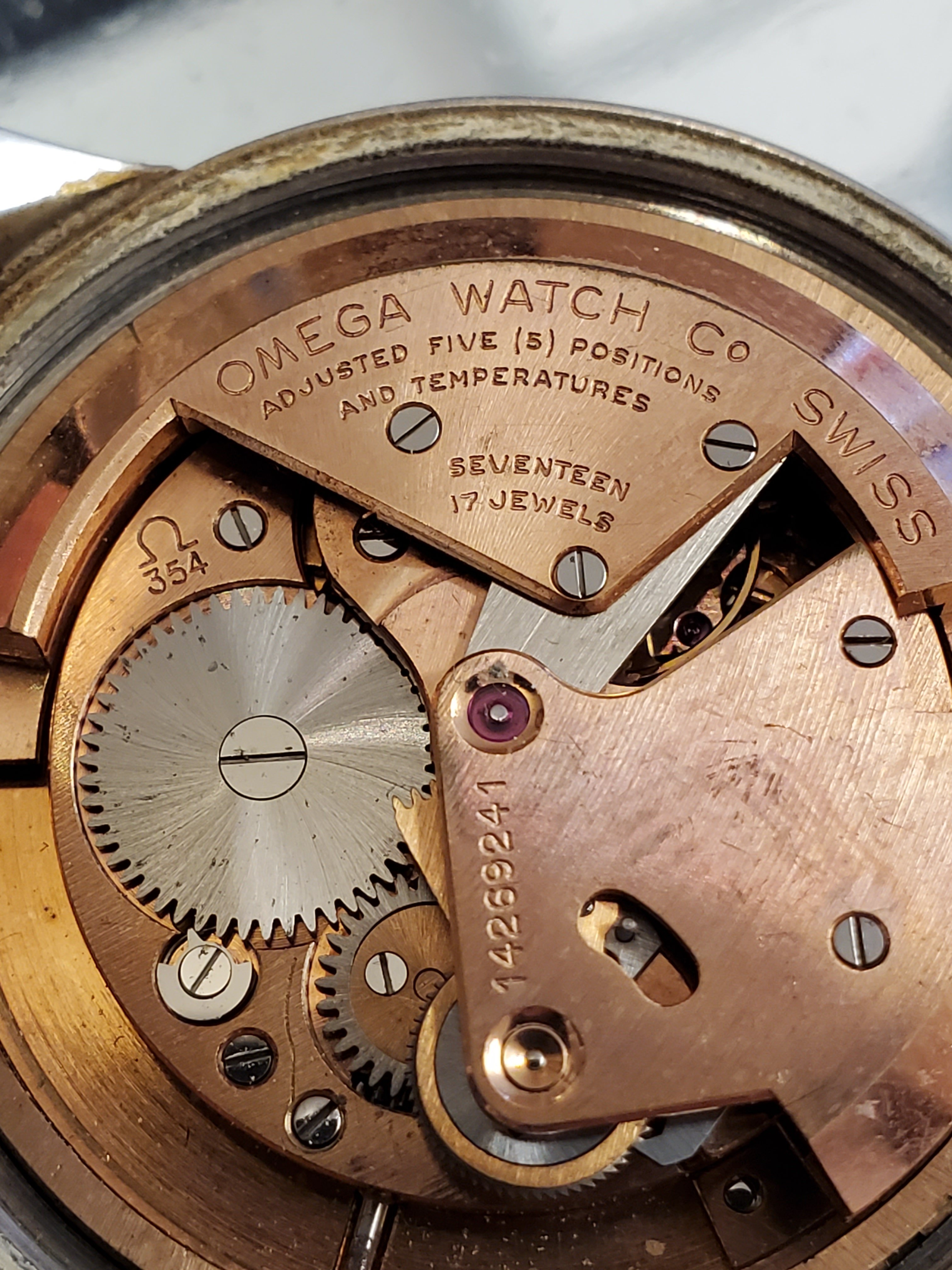

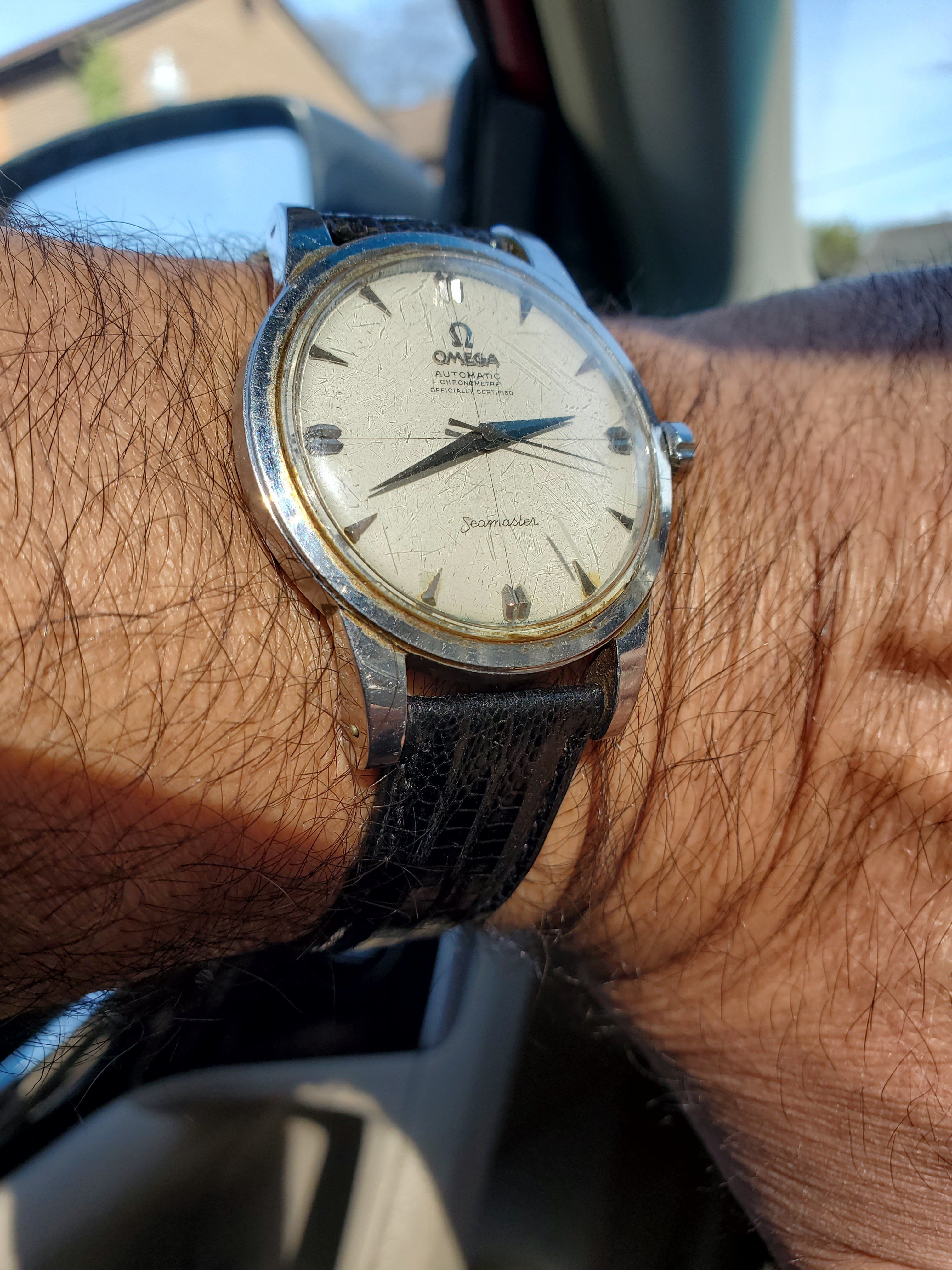

Omega Experts,
I'm a new member who recently was given my father's Omega Seamaster that he bought in 1954 in Cyprus. It has been sitting in a drawer for the last 40ish years and I'm not aware of whether it's ever been serviced. I'm sending it off to get checked at one of the shops I found recommended in this forum and I'm seeking your expert advice on what to approve being done to it and what to reject. Based on what I've read so far, I shouldn't have the case machine buffed but ultrasonic cleaning is fine, right?

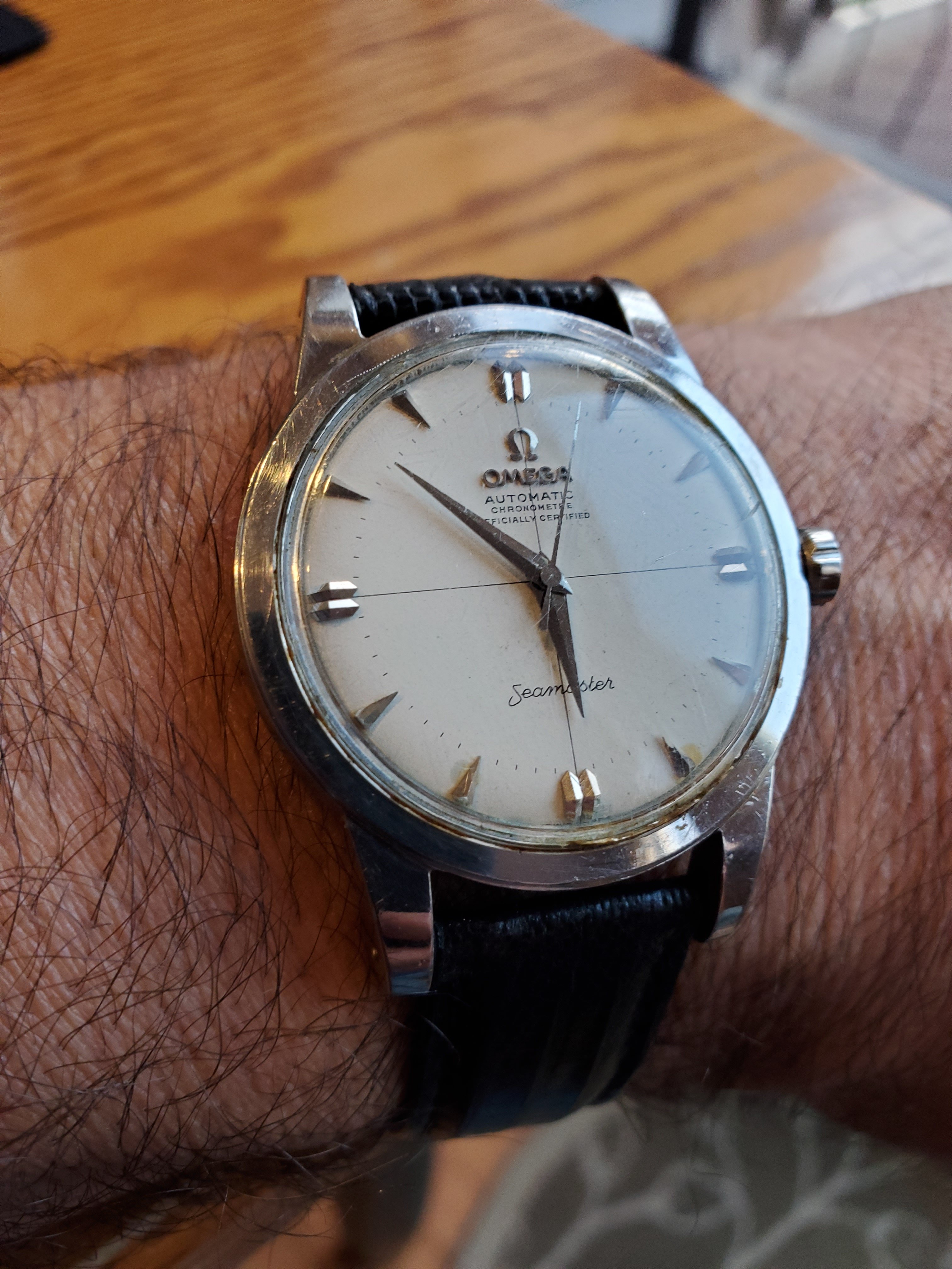

The crystal has some scratches but nothing significant. Should those be polished out or left alone?
I expect it to be serviced, oiled, new seal, and checked for accuracy. Anything else you recommend?
Below are pics of the watch. I'm looking forward to getting it back from the shop in a few weeks and wearing it proudly.
Thanks so much for your help. I've learned a lot by reading the various threads and am amazed at the amount of information you all have provided.

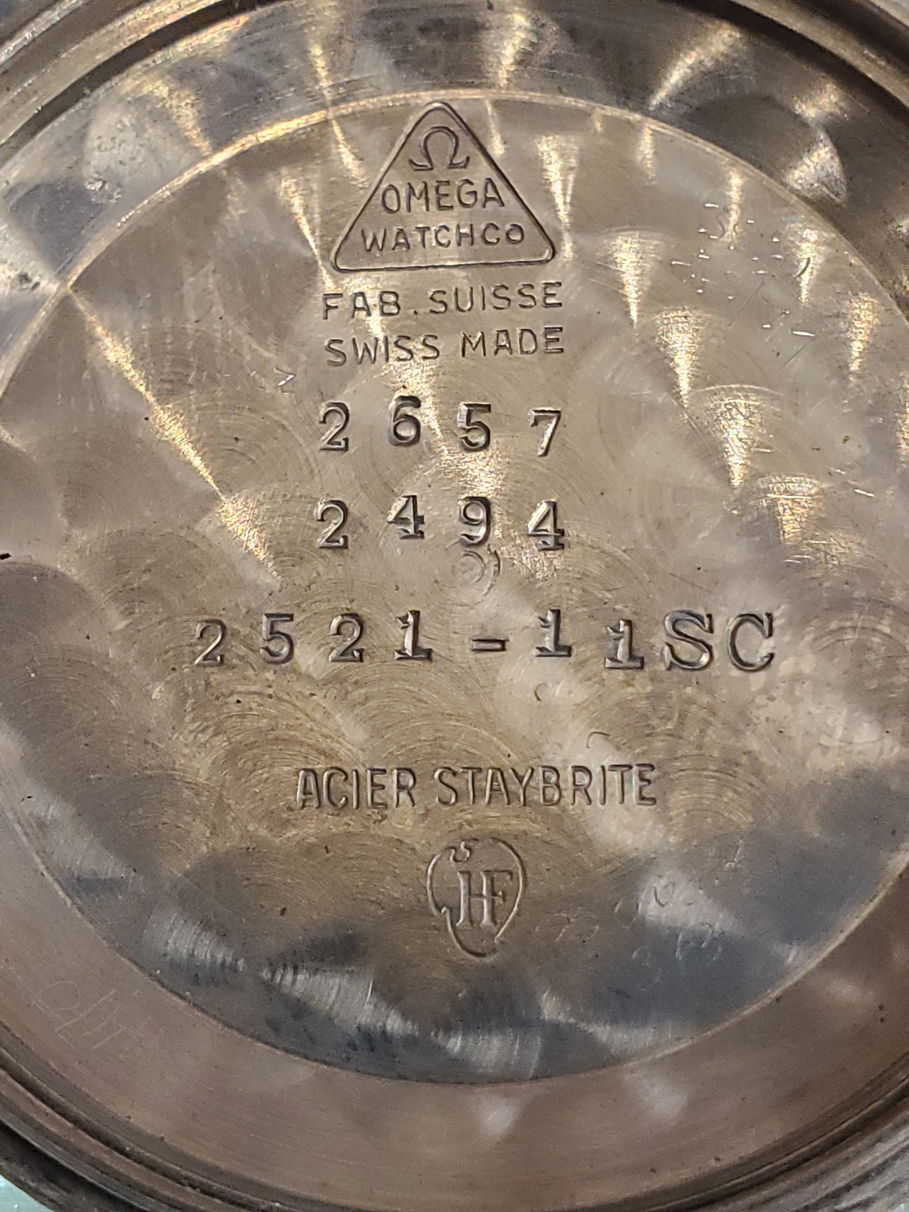

Quite a desirable model that. Very few 1950s Seamasters were chronometer rated, and if it is a 2521 it is a jumbo at 36mm so again one of the more sought after variants. Was it purchased from a NAAFI? That would be a third layer of interest (but doesn't add much extra value)

What a great piece, you are really lucky to have that handed down.
Ultrasonic cleaning and crystal polishing are fine. Just make sure no dial cleaning (or hand polishing) is attempted.

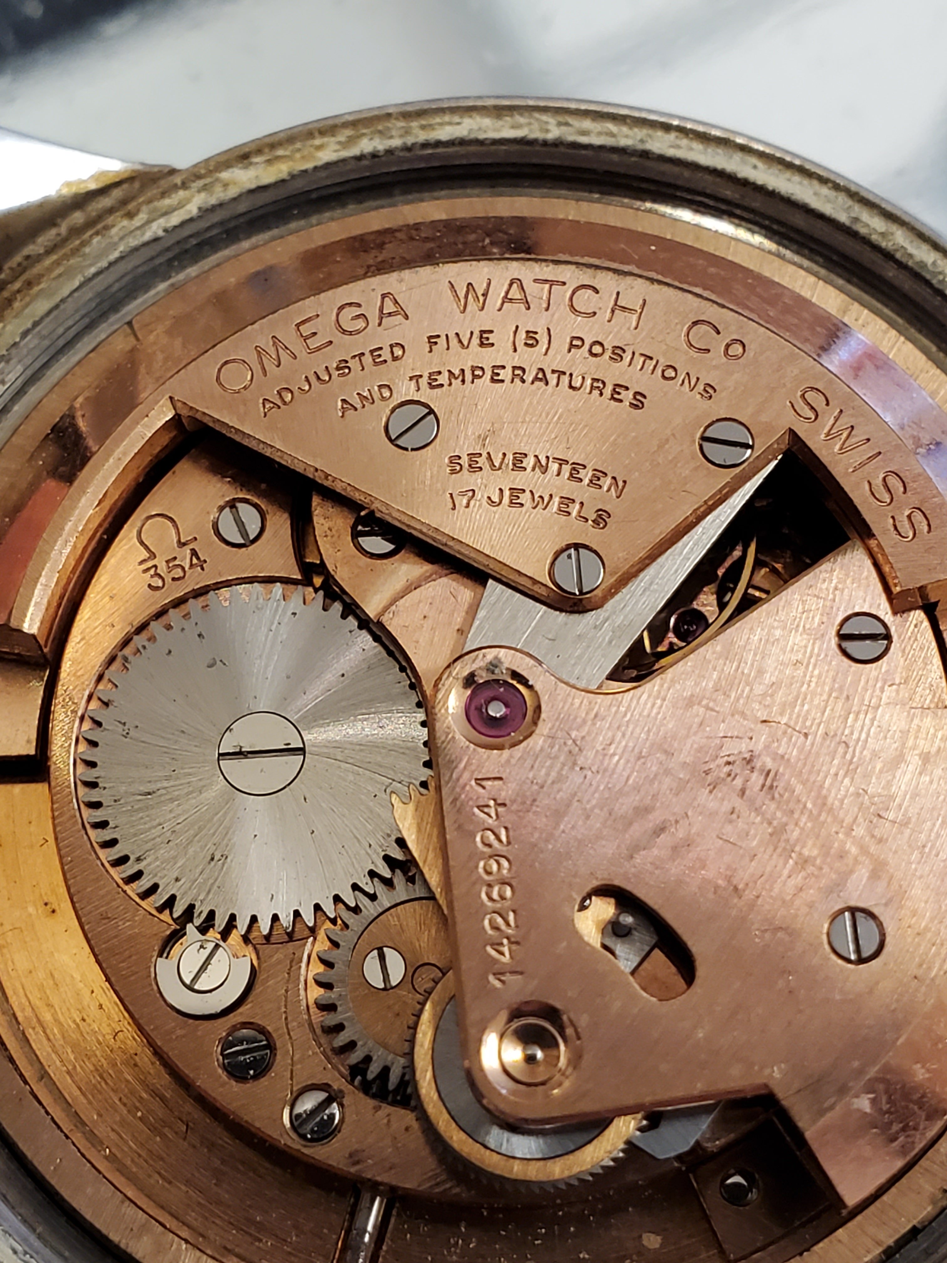

I have nothing to add to the advise already given, but praise. It is beautiful! I like it! Especially the bumper chronometer movement and the flat-top-S Seamaster script.

Hi @GWahoo and welcome.

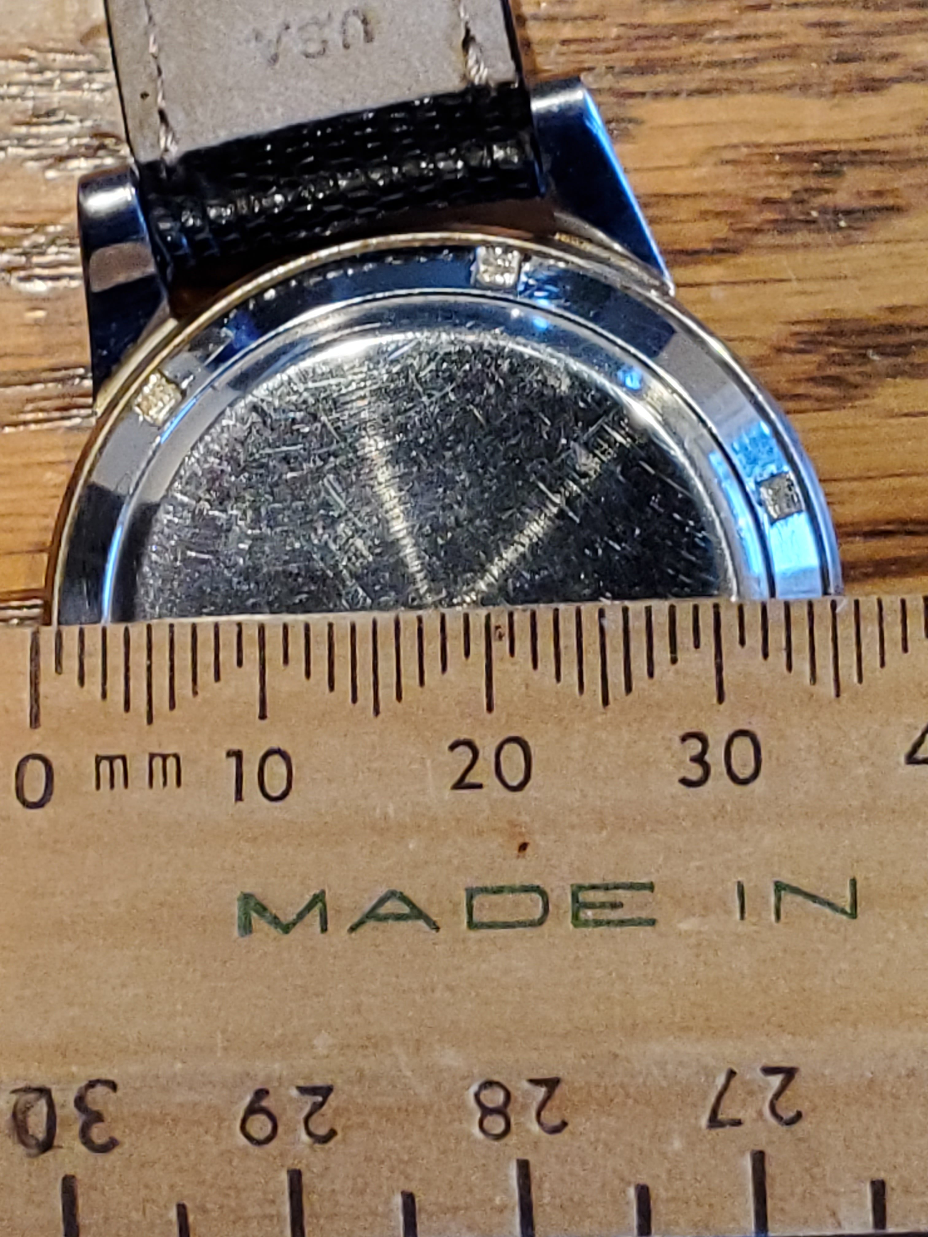

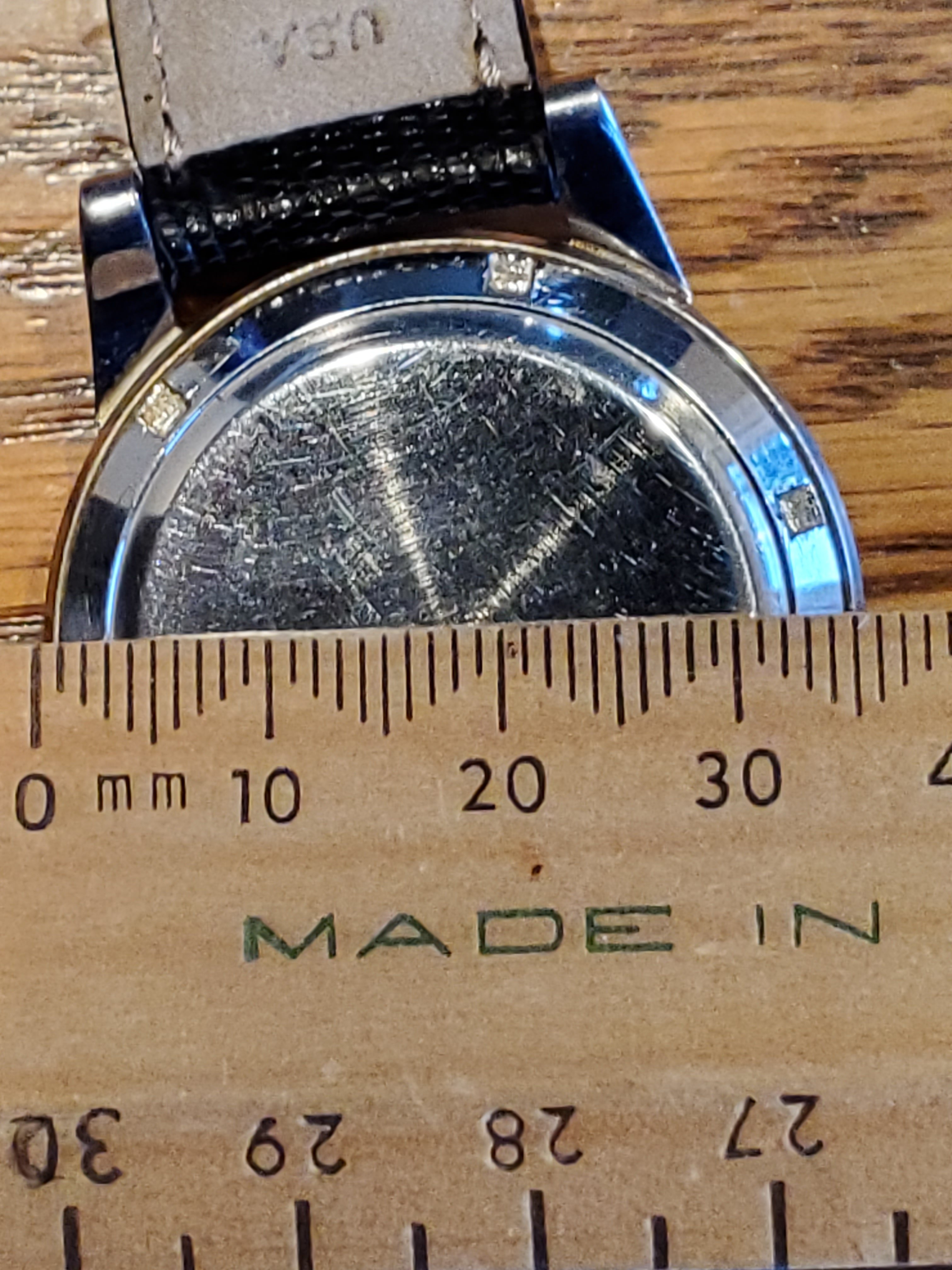

I also have nothing to add, but would be curious to know the size of your watch. Like @padders mentioned, if your Seamaster is without the crown 36mm large, it would raise the collectibility and rarity of your watch even further. Can you measure it?
I particularly love Seamasters from the 50s, and have never ever seen anything like your watch. Congratulations and thanks for sharing!

This is a spectacular hand-me-down. Chronometre grade Seamasters are quite rare and your's is in great condition. Good on you for having it serviced - polishing the crystal is perfectly fine. Enjoy this special watch - your father had great taste!

Wow! Thanks for the abundance of positive responses and information. I'm so glad I posted here but sorry for the duplicate pics in my first post.

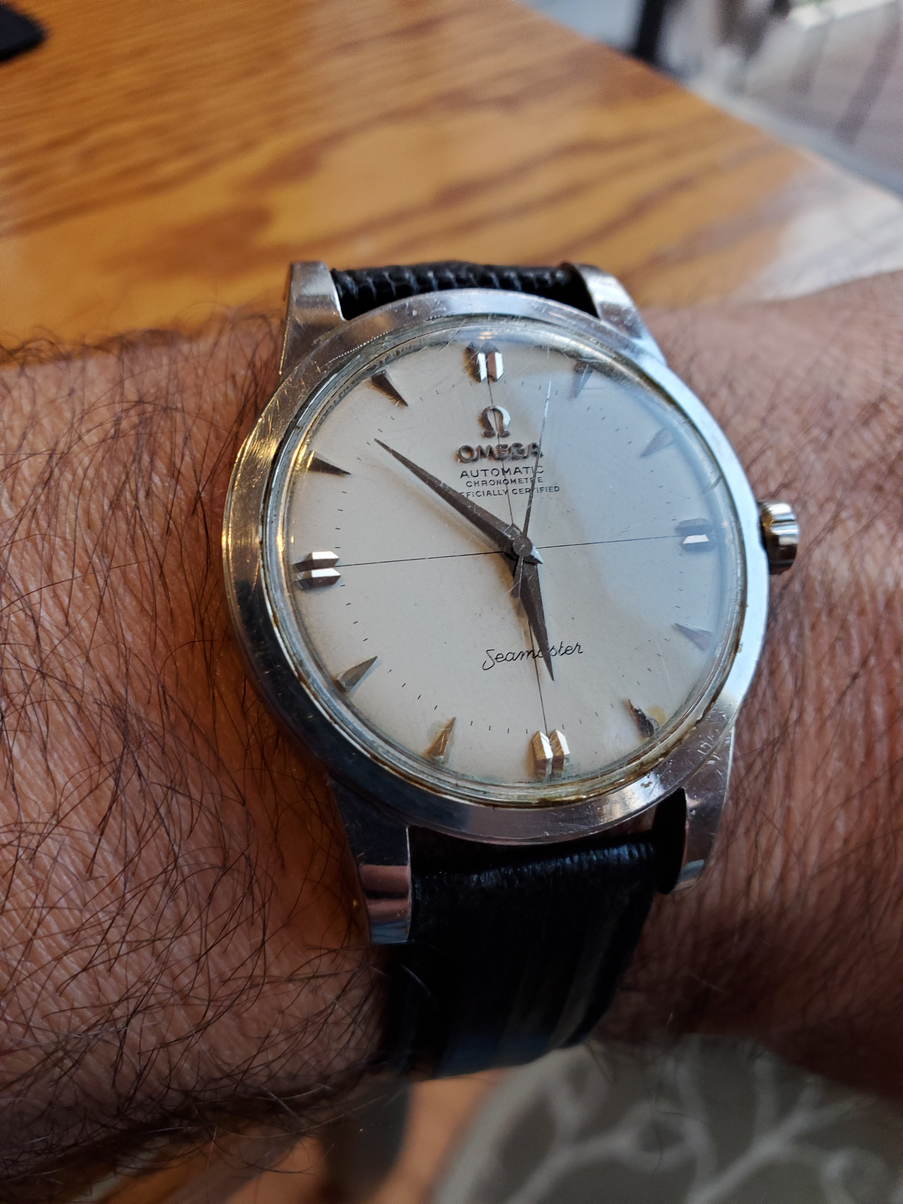

I'm not sure where it was purchased, my mother assumes it was at a jewelry store but doesn't know for sure. I think it's 36mm (see pic below) but I'll have the watchmaker measure it when he receives it. Also, below is a better view of the scratches on the crystal.

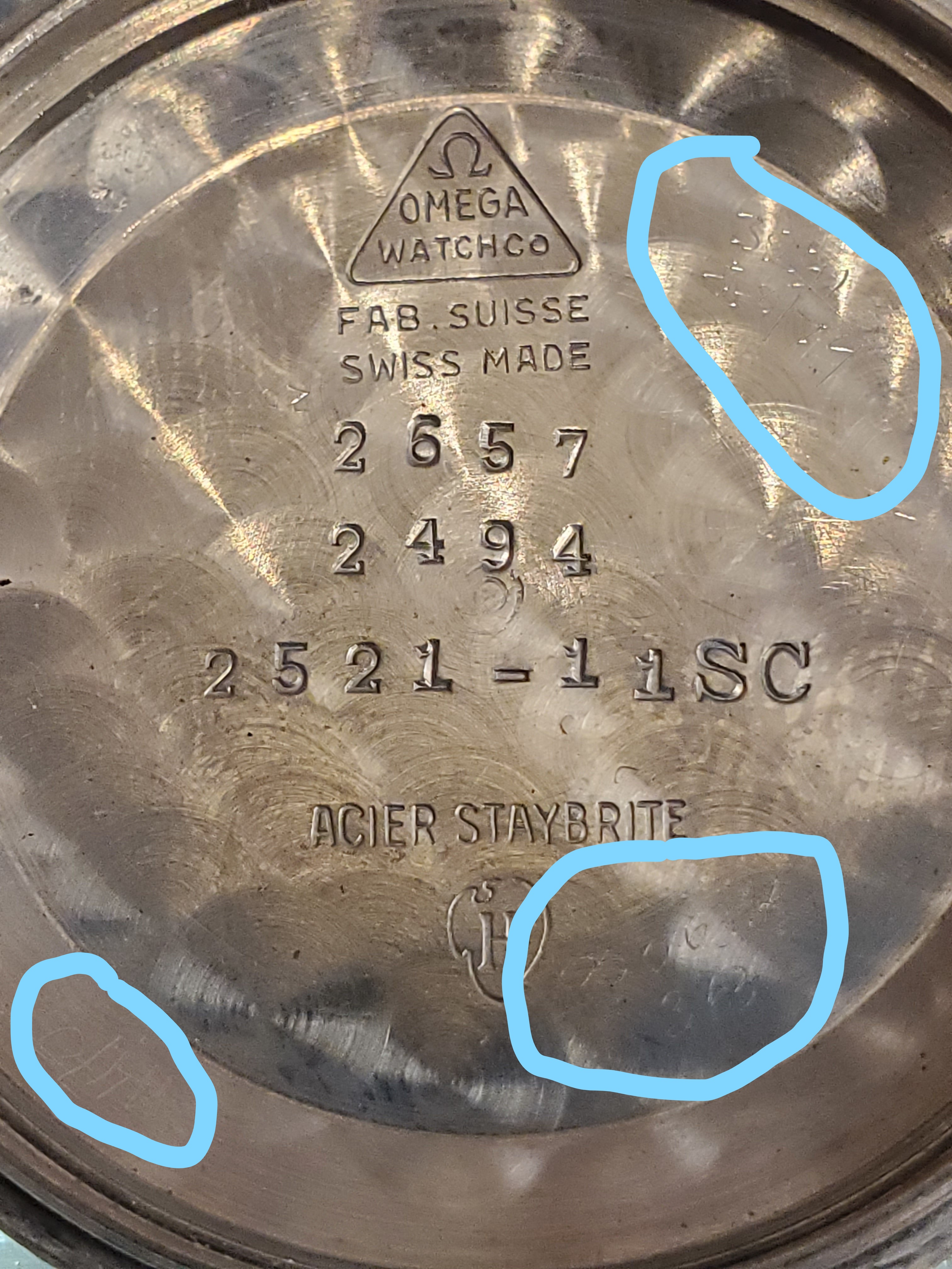

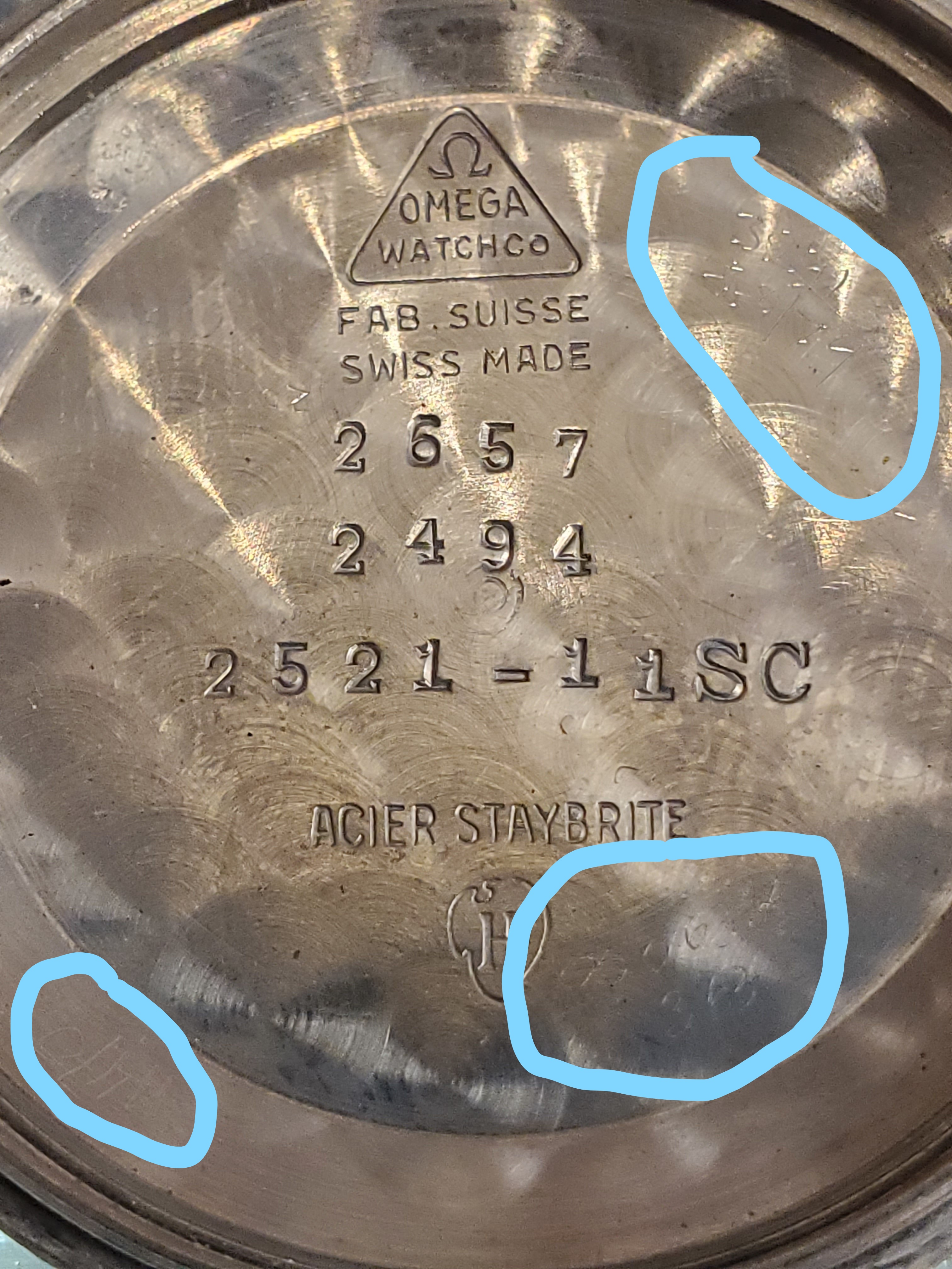

Am I seeing what might be a faint service marks on the inside of case back? Maybe it has been the spa!
and after posting the photo, I may have found yet another mark just to the left of 'Swiss'?

A proper service of a water-resistant watch requires caseback gasket, crown, and crystal replacement. Collectors faint when you suggest that but you might not mind. That crown is still available new, and sometimes the crown tube is worn and needs replacement as well.
It's up to you what you decide, but I encourage the resealing for water resistance, because it also keeps dust out of the movement, and parts for those movements are few and far between.

The marker configuration is rather uncommon, and the dial condition is really uncommon! It is not an outrageously expensive vintage watch (a beat up, common as muck Rolex would have been worth more...), but it is a real collector's item.
Re. value, a watch like this would probably fetch <US$2,000, but for insurance purposes you will need to look at what a similar new item would cost today. The best reference for this purpose would probably be the limited edition 1948 Omega Seamaster, which is around US$7,000.
