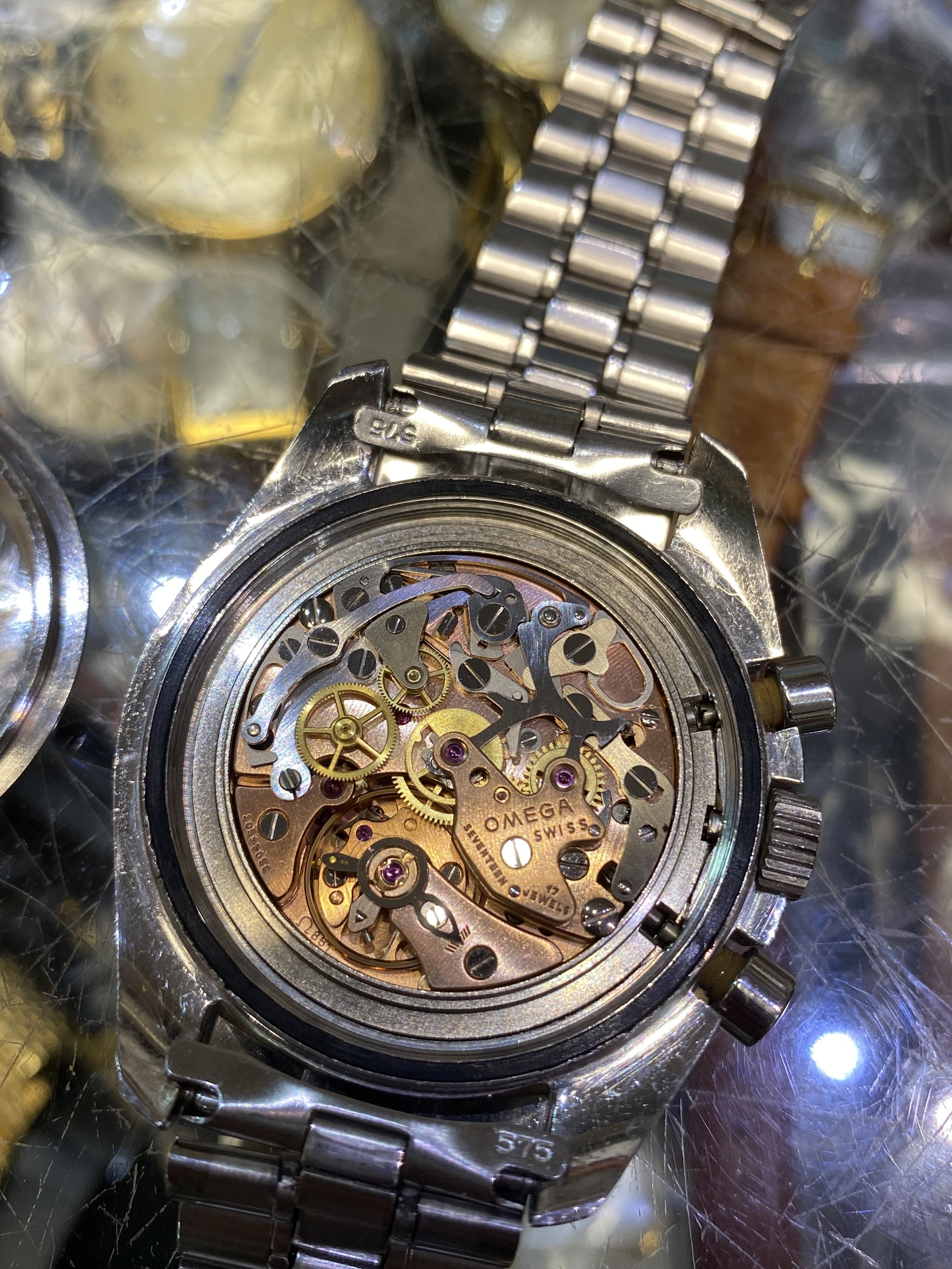

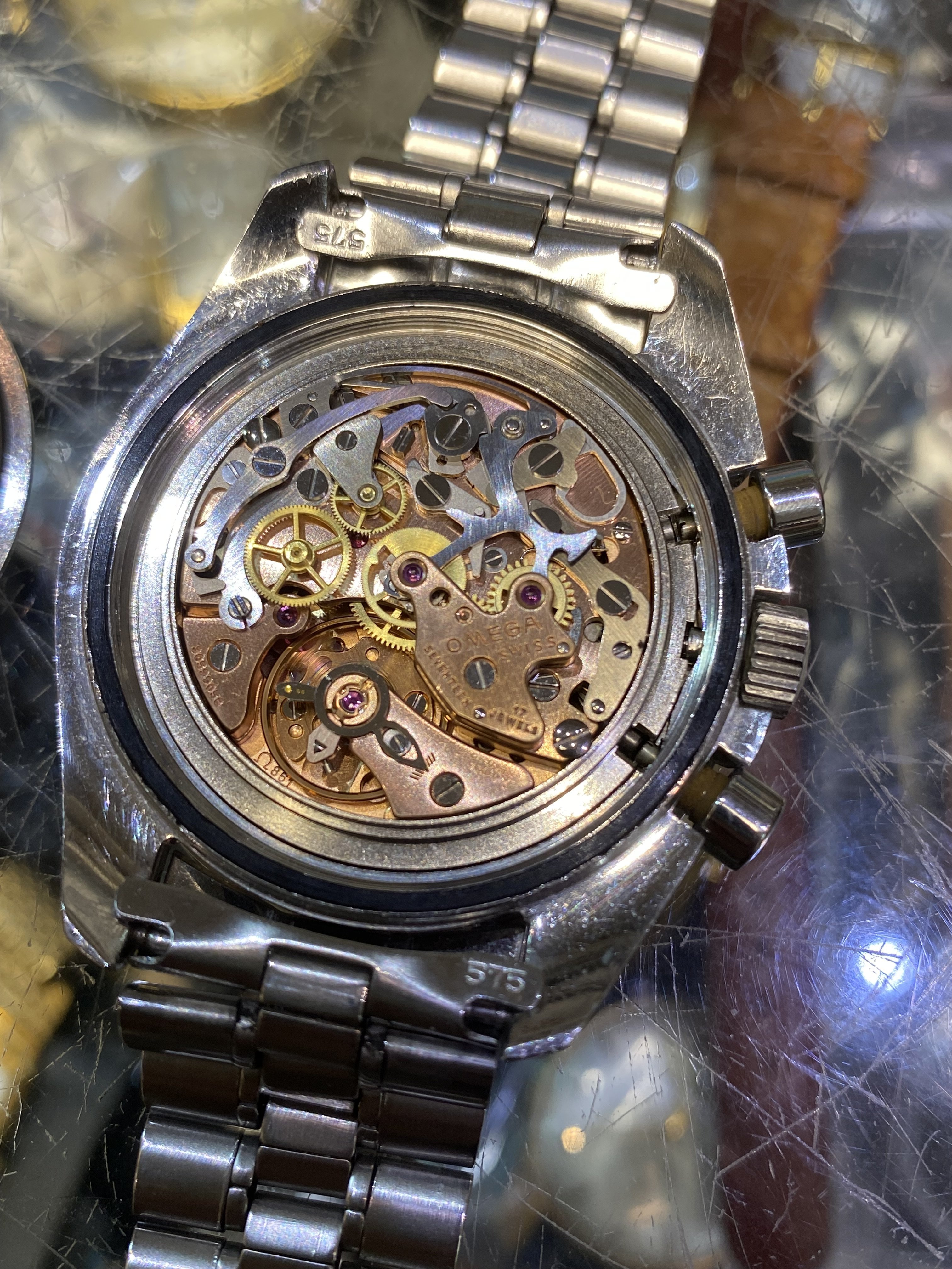

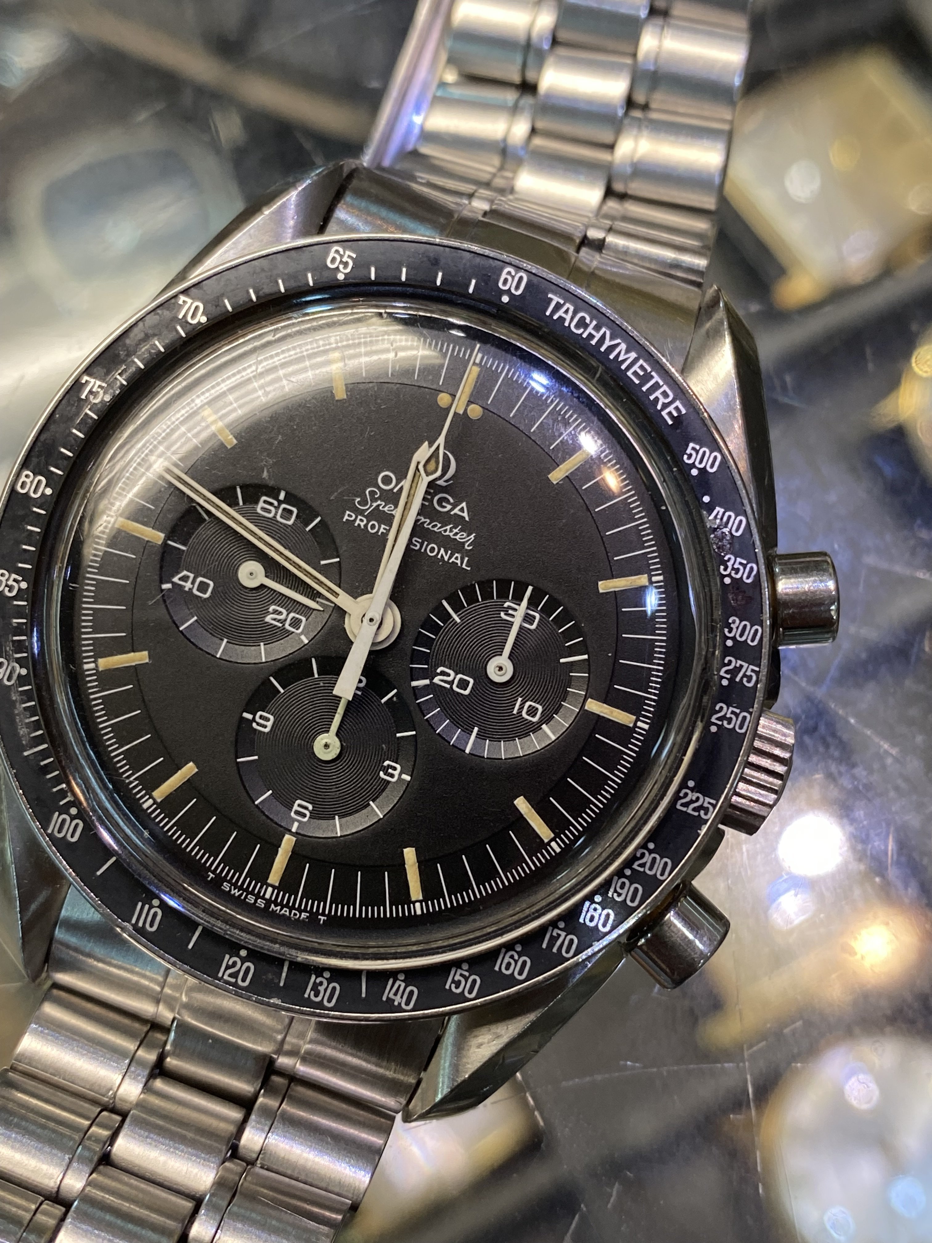

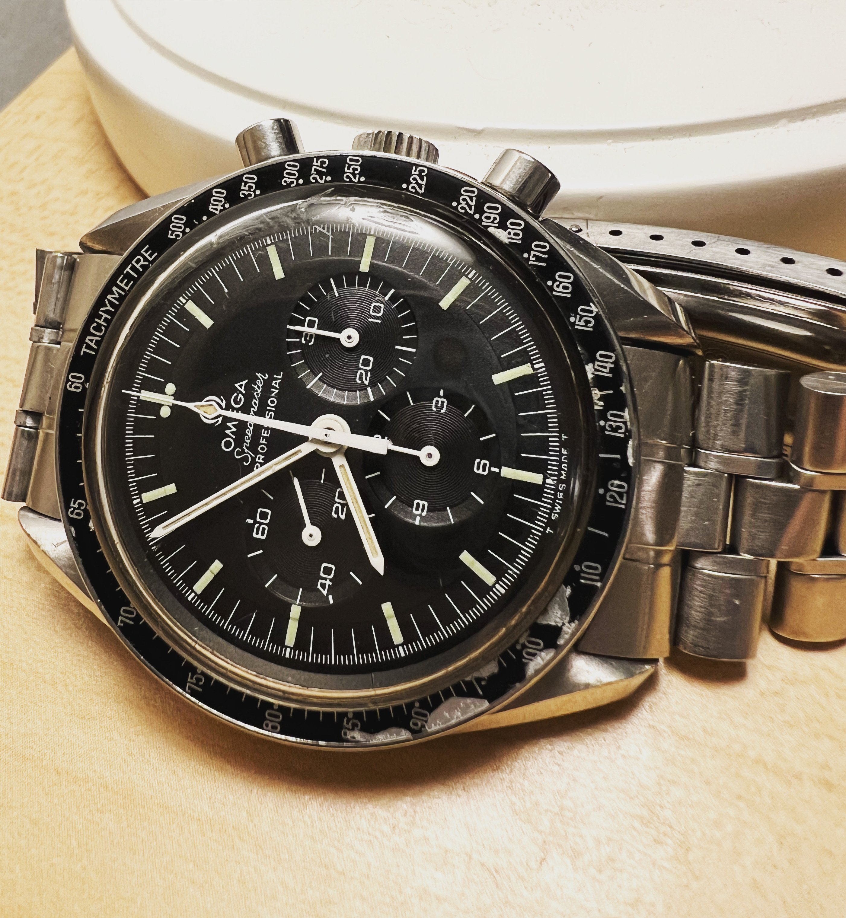

Hi All,
I’ve found this Speedmaster 145122-69ST and before I take the plunge I thought I’d reach out to the omega community and see if anyone can talk me out of buying it. Everything seems to match up from my research but I’m no expert. The dial is very nice, hands are okay, bezel has some dings. The serial number 305XXXXXX seems to match the case number. Here are the pictures.
View attachment 1645405 View attachment 1645406

Looks promising but you’ve missed one crucial piece of information
14
28
Ah got it. The watch is being offered @5600 usd.

Factoring in a service, you'll be in it for the low $6k USD. Doesn't seem too bad to me, I've seen a helluva lot worst than that deal.

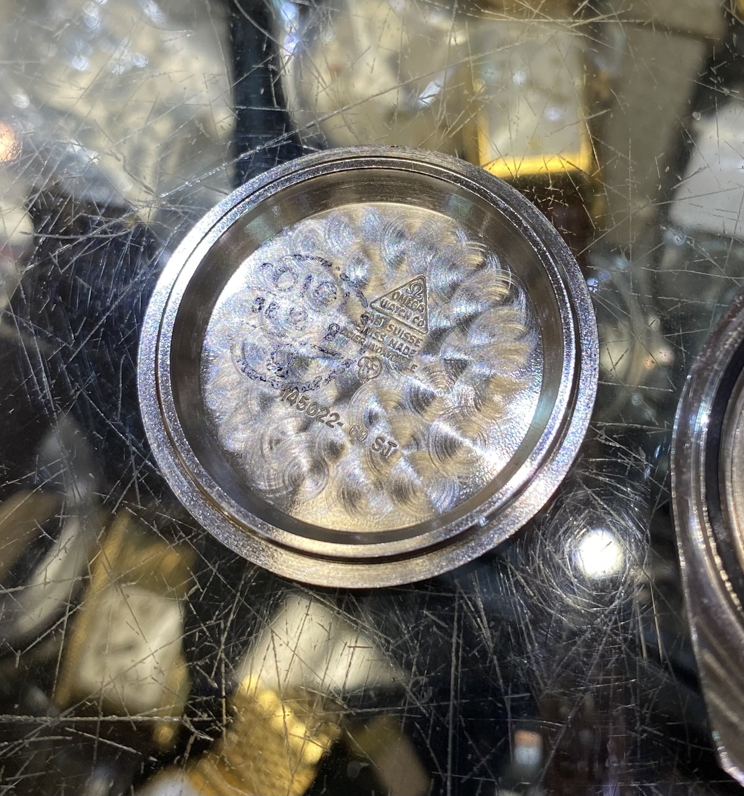

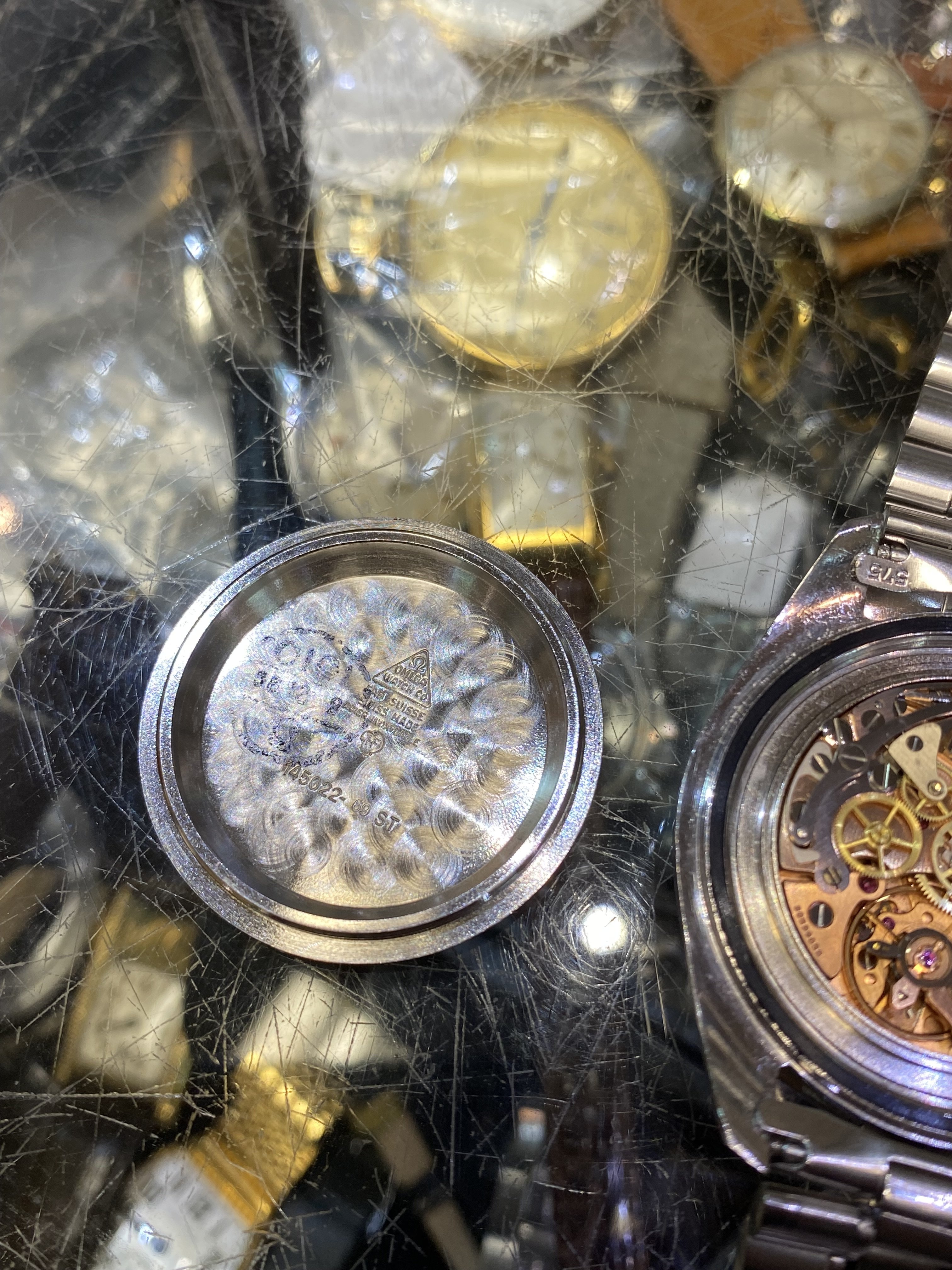

Have tried to see if there is an Omega logo on the crystal?
Any service/owner history?
And take a look at this lovely website (you might have already been there...):
https://speedmaster101.com
Do you have more pictures?
Showing the sides and the caseback?

It’s a buyers market at the minute. Price isn’t terrible but I’d try and get it for 5k.

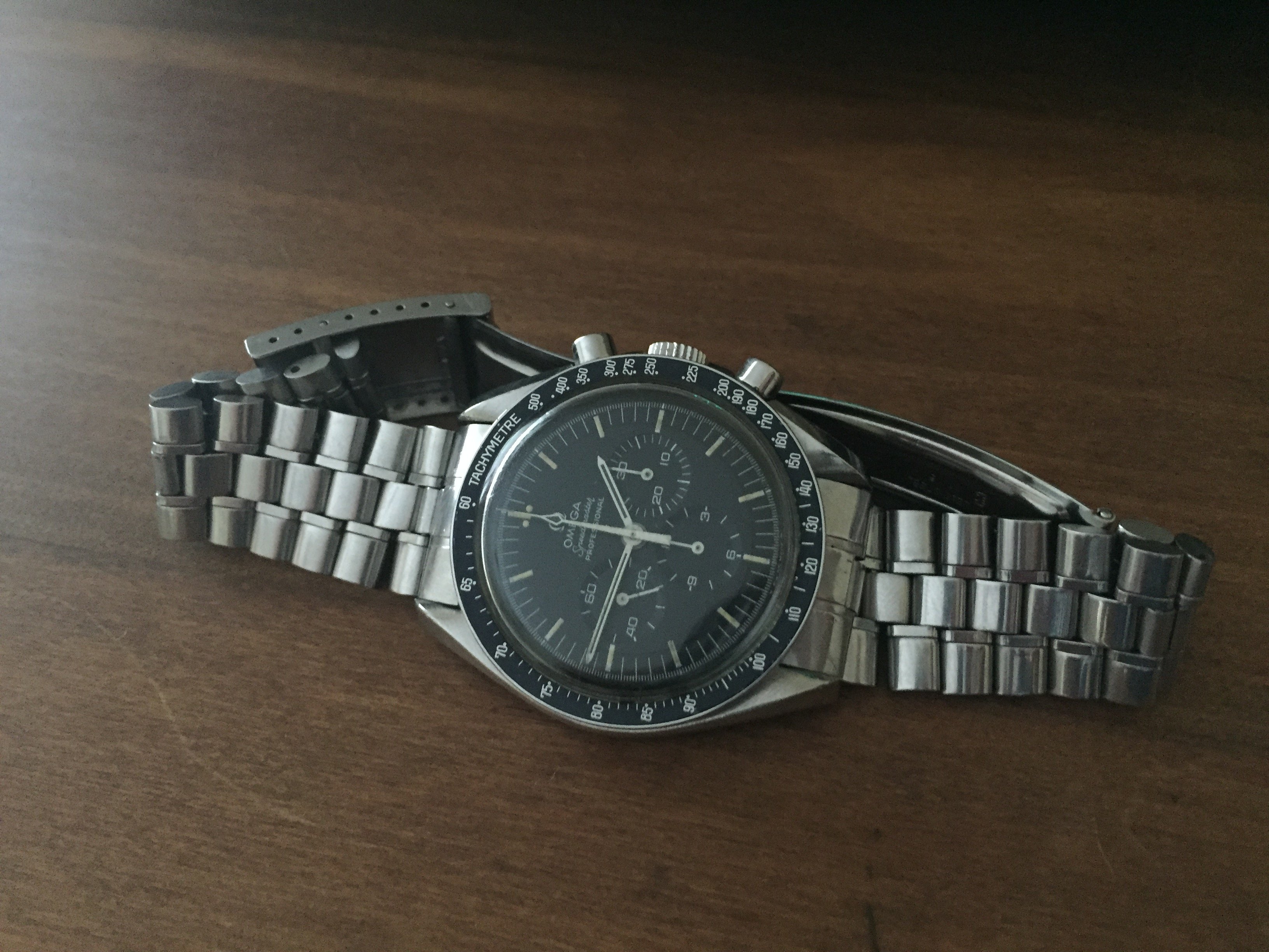

I have exactly the same watch, 30.58 serial, including the 1116/575 bracelet, bezel etc, so seems original/legit, and all is as stated about the final price... I love how it is aged, exactly as mine, except the bezel, mine is more dinged.

Nice watch with the original 1116/575 band.
The crystals seems to be a later specimen though.
All in all, needs some tlc, but 5600.- USD is a good price for the watch IMHO.

Nice example after service you will have a very good wearable Speedy! Good luck

To me it looks like there is a lot of black retouching on the bezel. If it is done with a Sharpie, expect it to fade in a year or so.

Well spotted- I see area several areas below 400 and 350, what other areas do you have concern about?

To the left of 60 it looks like a couple of spots of retouching. Between 80 and 70 the black looks very mottled and something is going on there maybe a mix of polishing and retouching. To the right of 120 it also looks like retouched damage. There is a lot more so just look carefully. I don't mind it, just factor it into your final price. For me it would also be a challenge to do it better than what was done previously, but that's just me.

Here’s my 220 Error bezel with some untouched bezel scars, on orig 1116/575 Enjoying it scars and all. Did time in Vietnam. 1970.
