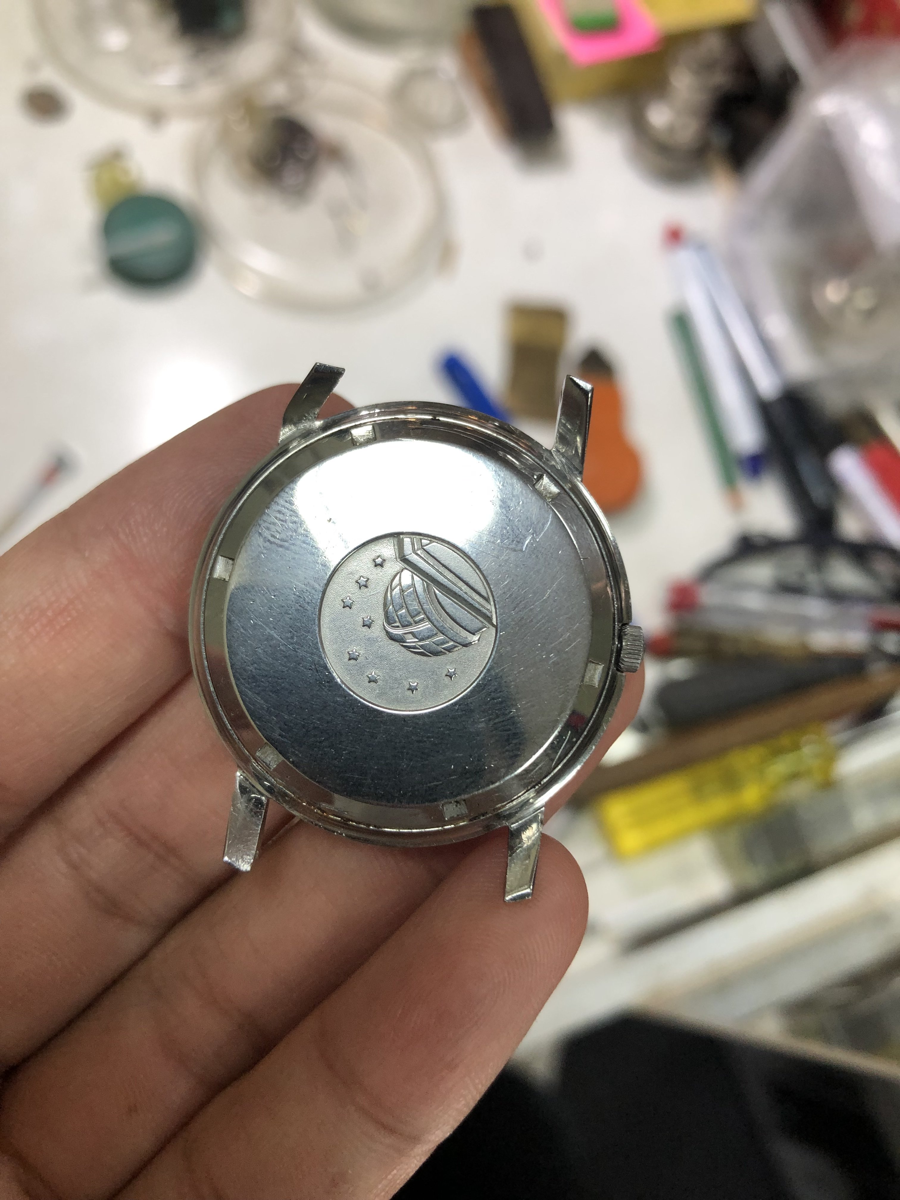

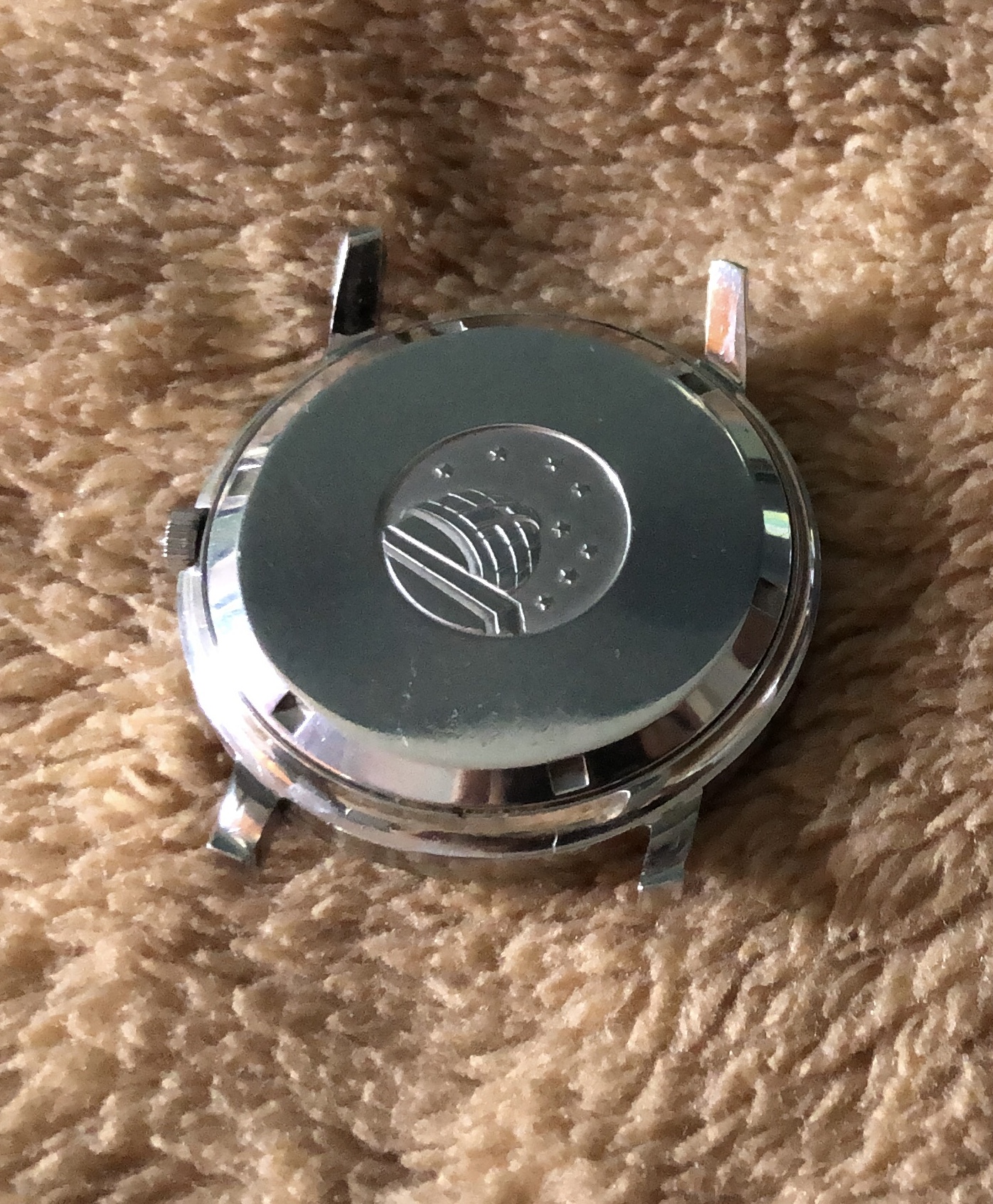

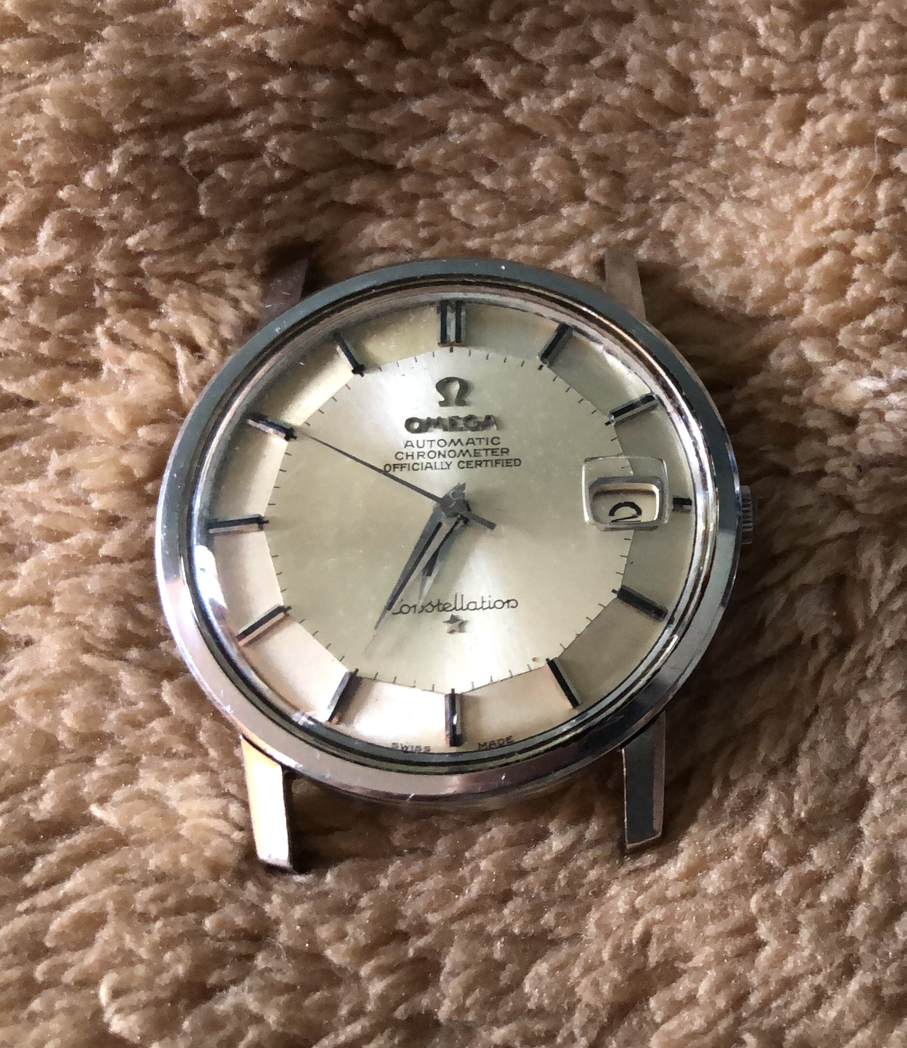

Hello guys, need abit of advice here.
Watchmaker damaged the lugs while trying to open caseback. Watch in question is a constellation 168.010. It’s my second piece and the case is in pretty good condition too.🙁
Is there anyway back for the case in terms of repair? He offered to find someone to repair it
not quite sure what to do here. So upset about this but he is my regular watchmaker. Should I ask for a full compensation for the watch case?
43
123

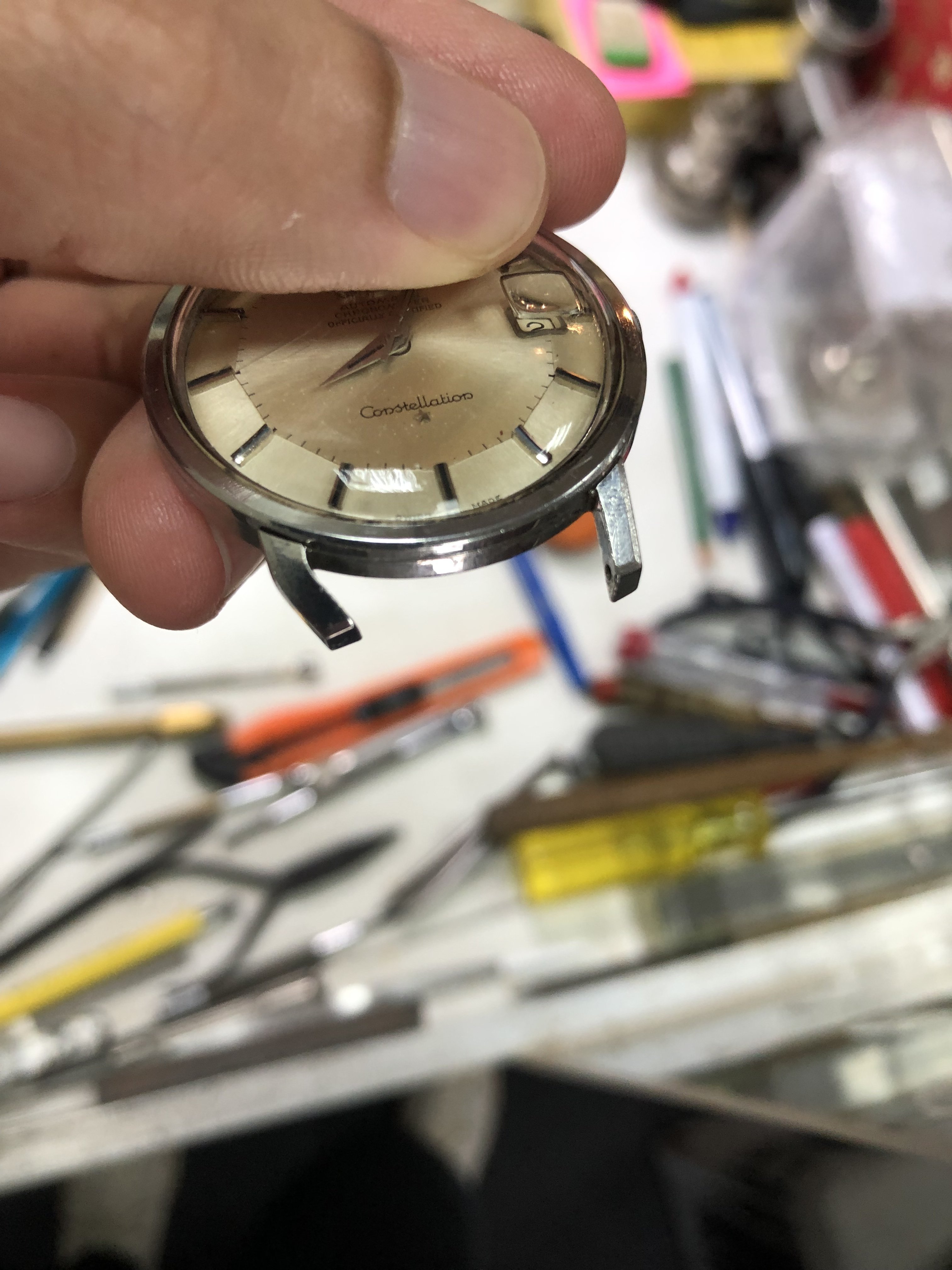

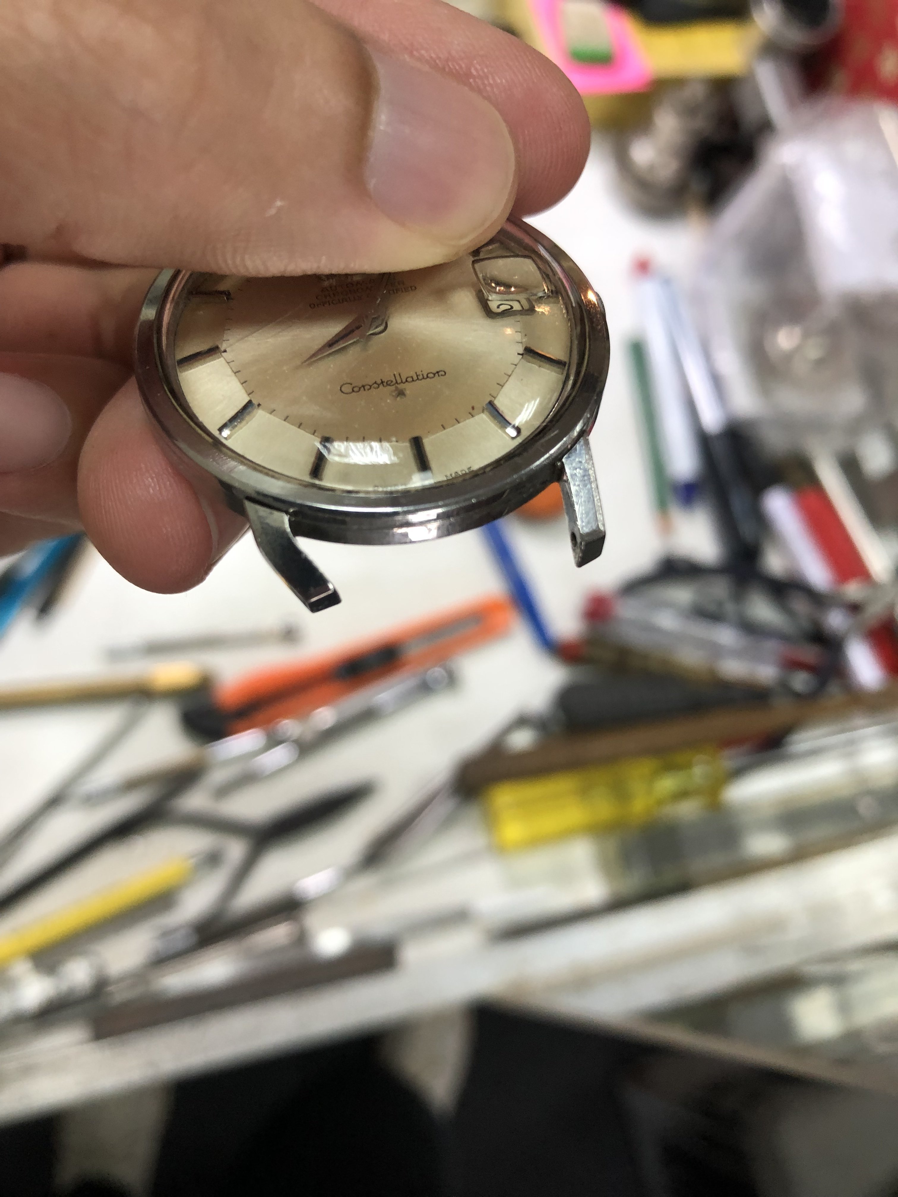

He was struggling to open the case back. Saw it slipping off a few times from his bench case opener. Upon closer look, the holding legs on his case holder are super worn 🤬

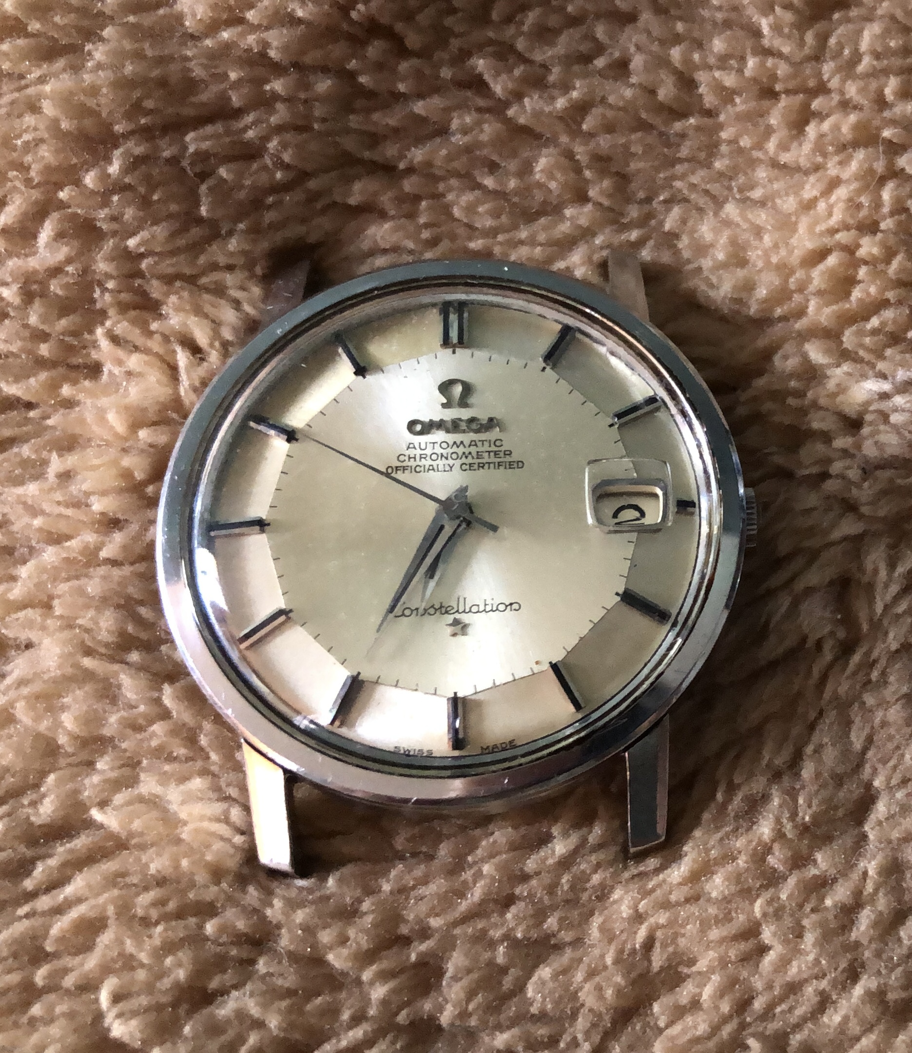

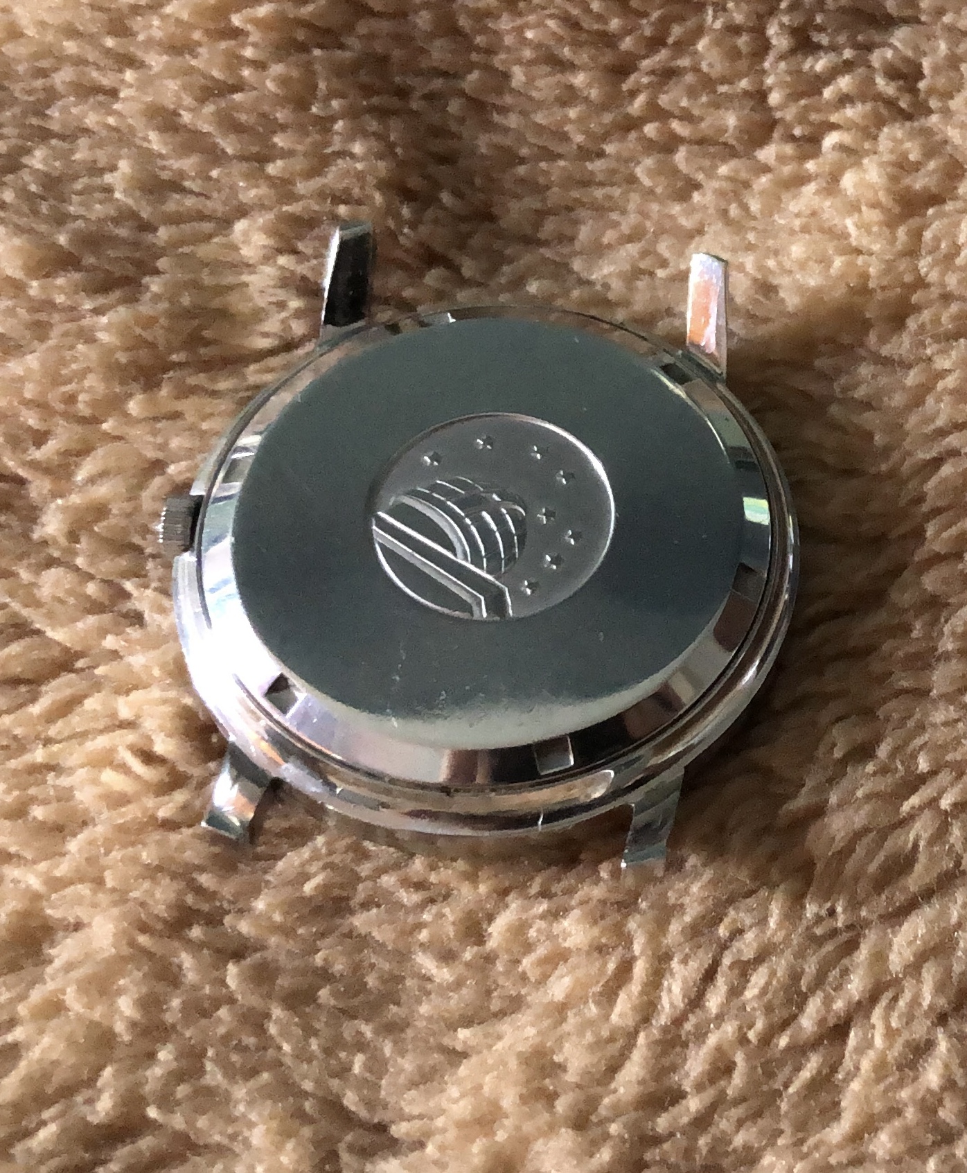

Some photos before the lug was bend

Seeing this watchmaker's work table - I'd run away. Not to leaving him a watch.
The best solution for you is to sell the watch to him at the market price and forget about.

How in the hell did he do that?
Most likely when he had the case clamped in the case opening vise, he had the pins that hold the case spaced too far apart. The force ends up being at the very end of the lug, instead of being near the actual case, where it should be...
