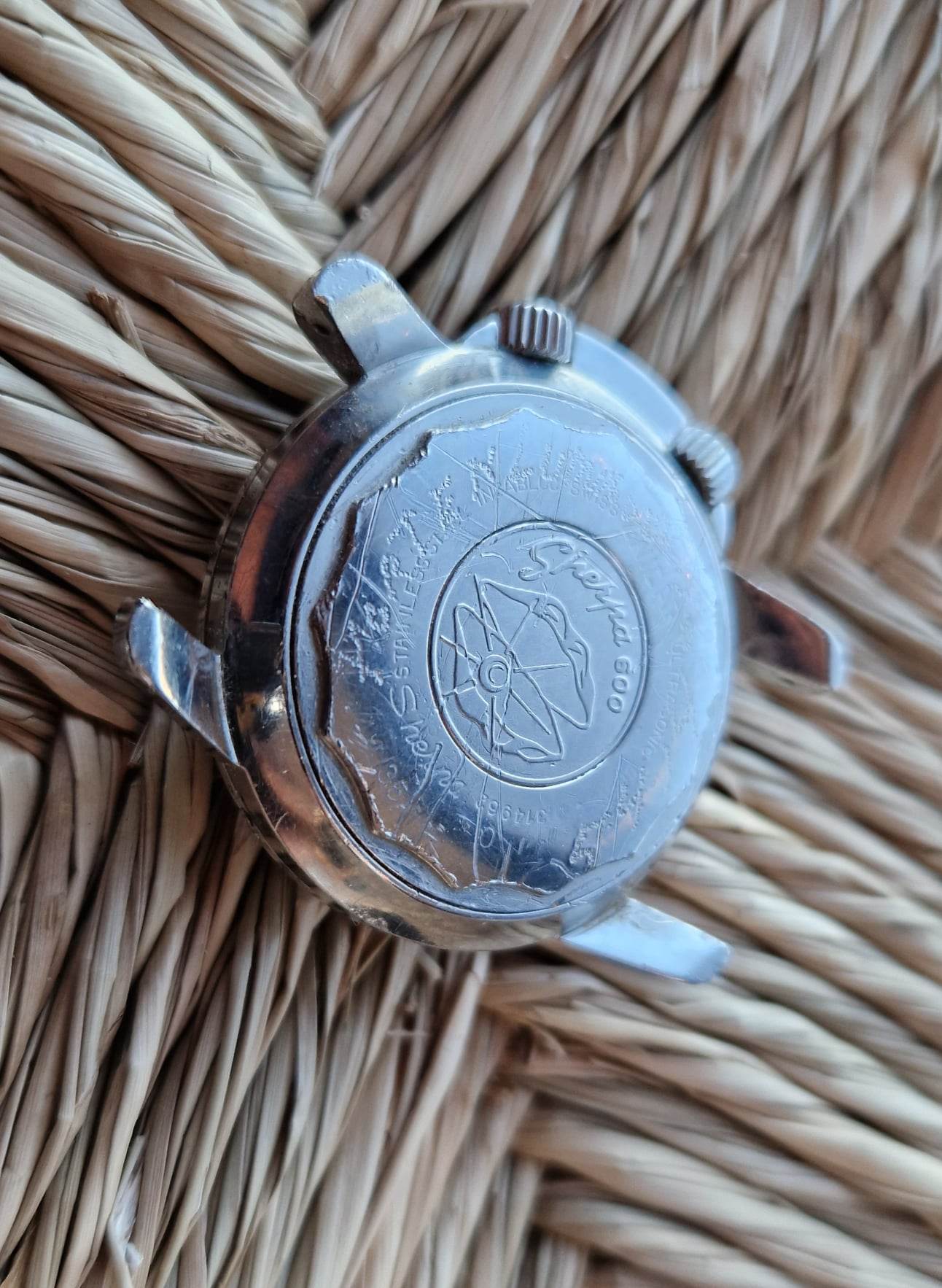

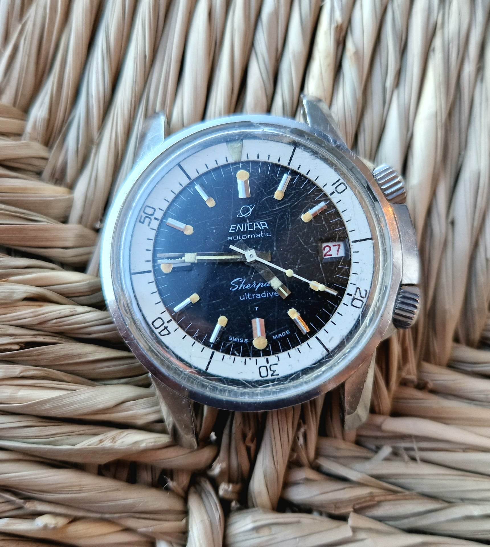

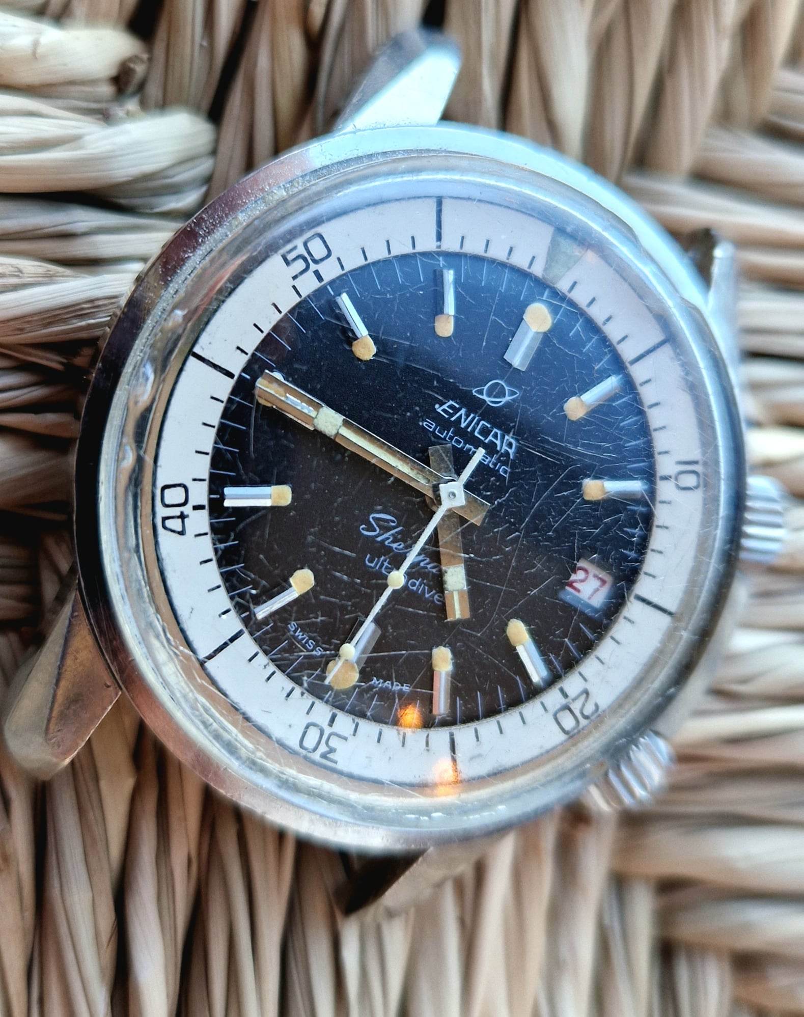

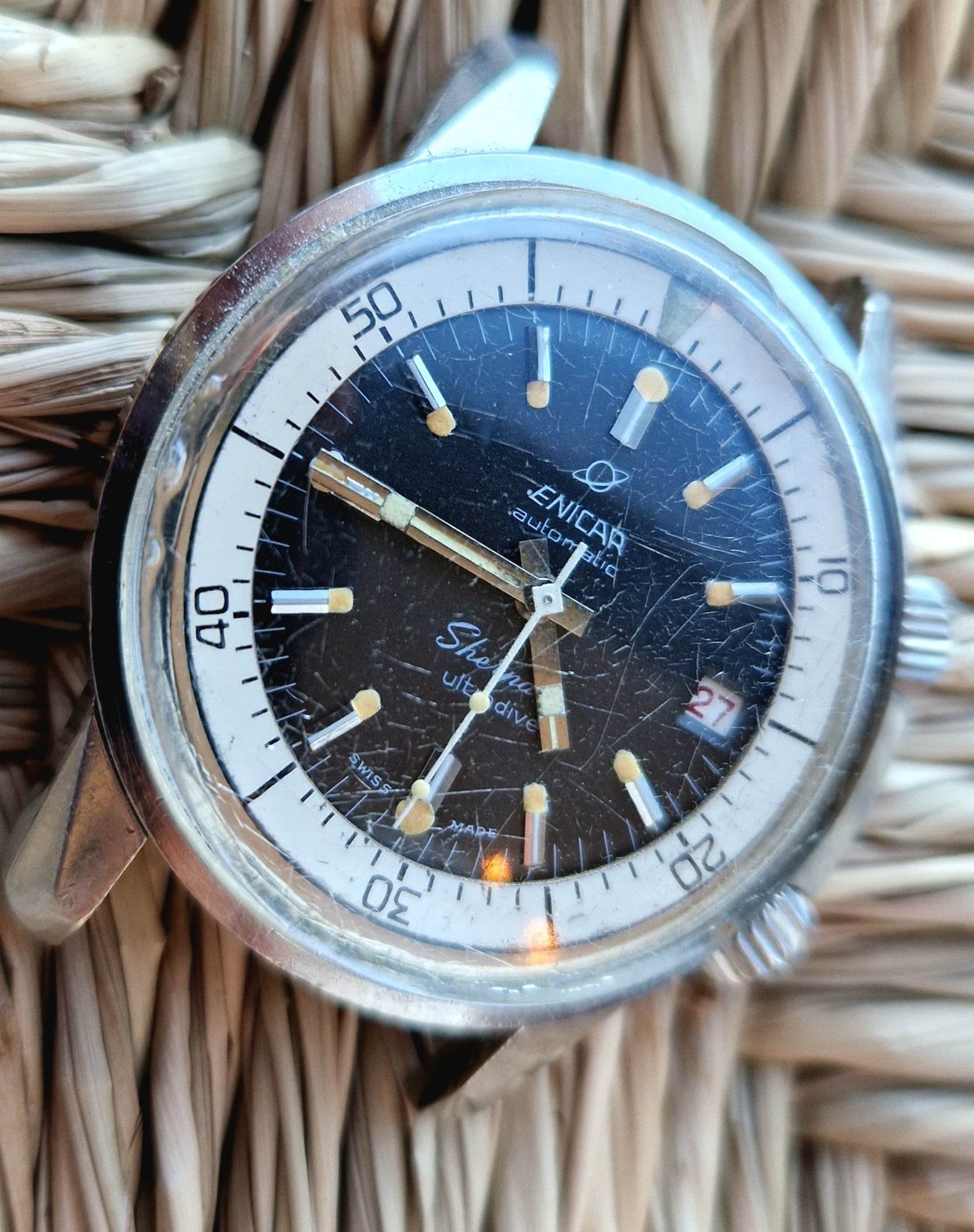

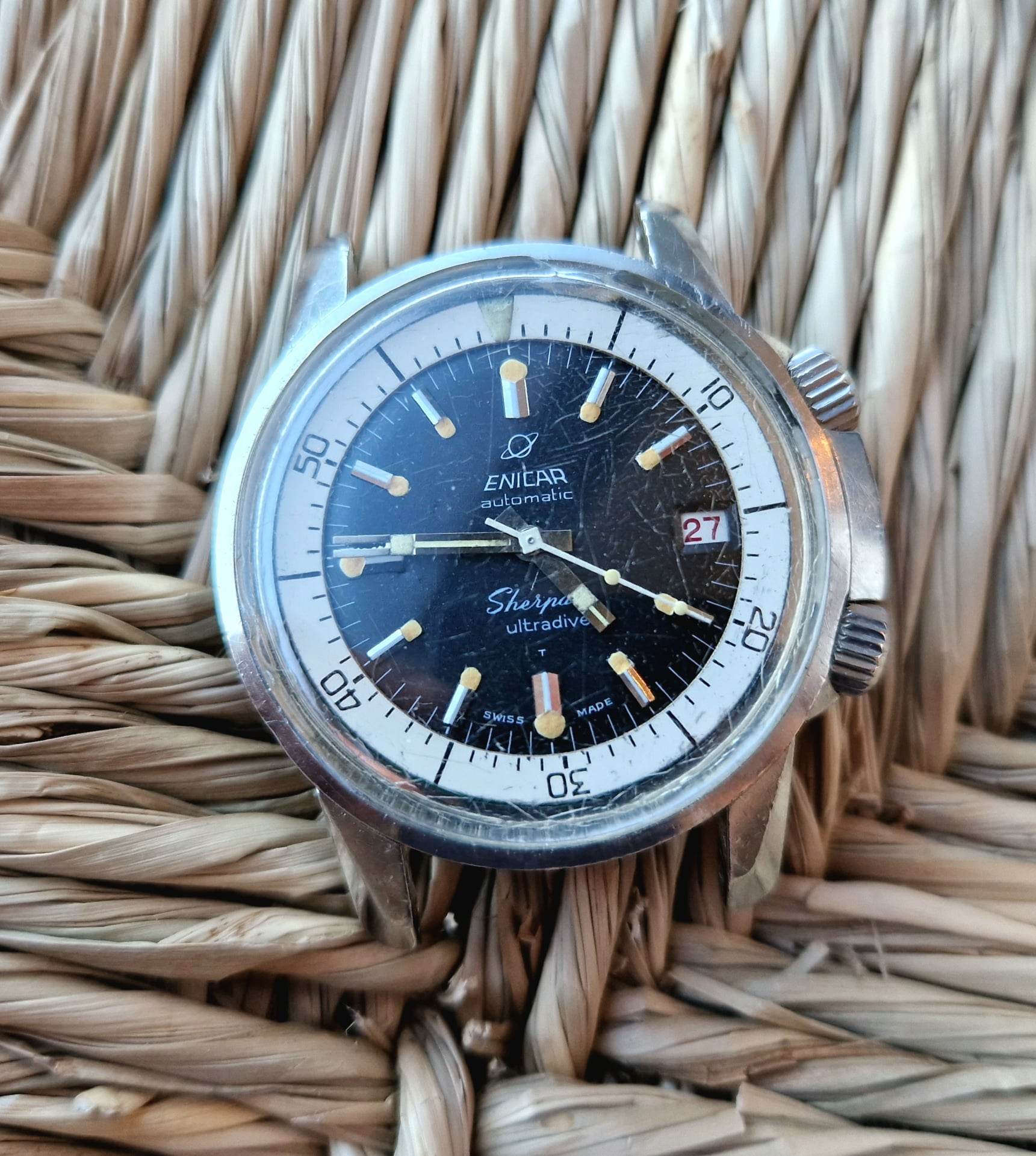

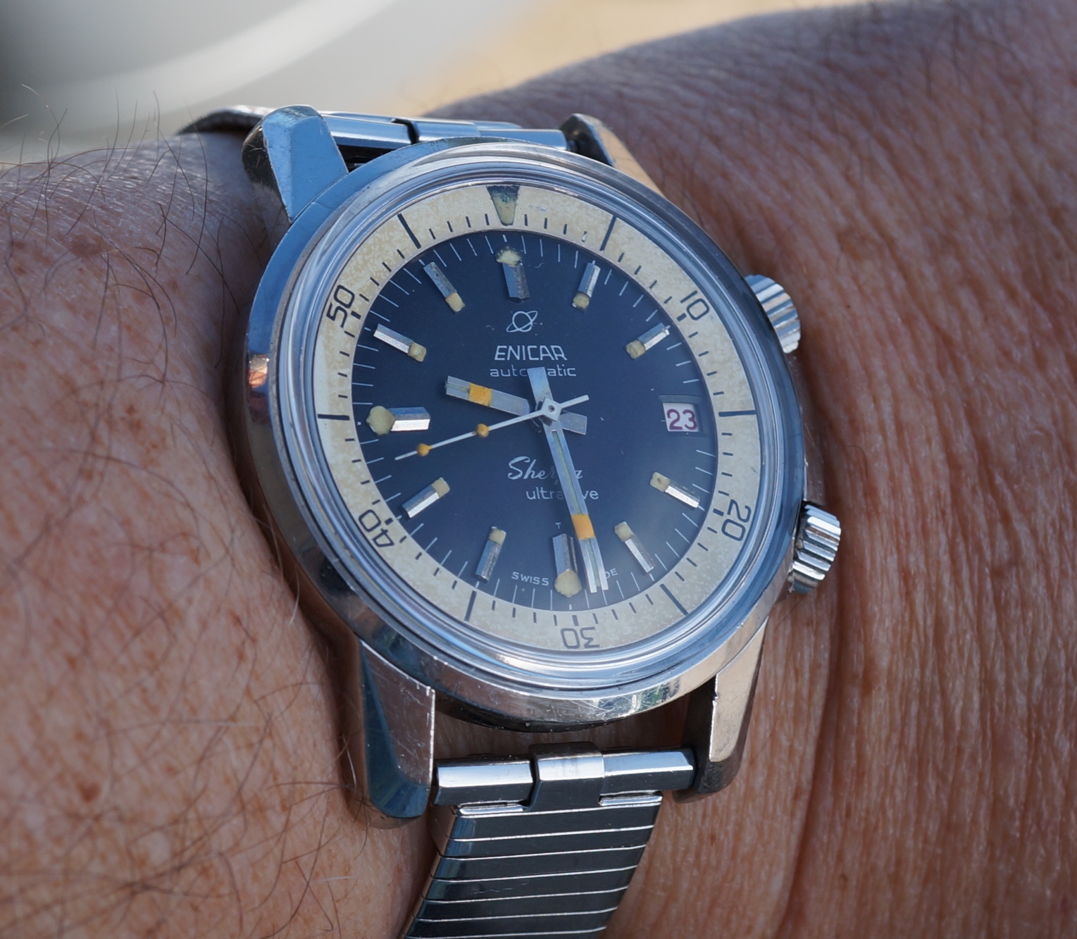

Hi guys,
I need some help with my most recent purchase, a Enicar Sherpa Ultradive.
The watch has had one owner (before me) and was bought in the 60s and used in a professional capacity.
My thoughts:
I believe it to be a MK1.
The dial is in excellent condition, the scratches you see is on the crystal, and correct.
The double lollipop second hand looks good with some of the original lume.
The minute and second hand looks correct, but are relumed?
The bezel looks correct but is relumed?

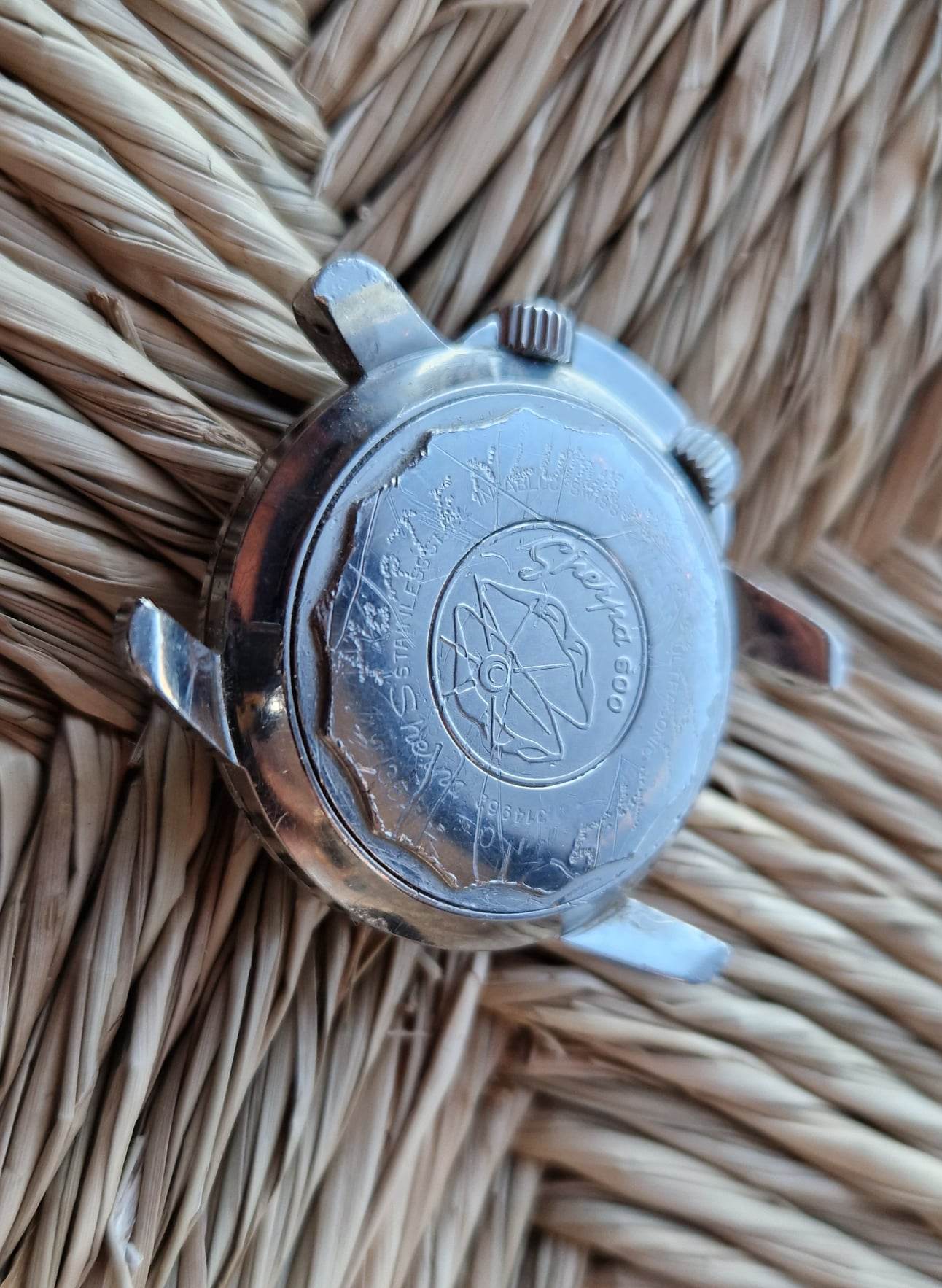

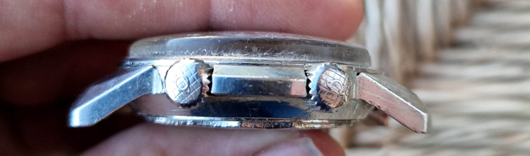

The case is has some dings and the caseback looks awful, but correct for the watch.
The crowns looks good.
The movement is original and is in working order.
Please correct me if Im wrong 馃榾
Im sending this to be serviced, would you relume the bezel and hands to match the dial?
All help is appreciated 馃榾

Keep the thick crystal if at all possible, hard to find.
Keep lume as is, if you want originality.....thats how this lume should look.
Don't touch the bezel
Sorry about the back, but these UltaDive double pip examples are uncommon
Congrats
Congrats
Thanks, and thanks for valuable information 馃榾
The crystal is not possible to save, Im afraid.
Everything else will be kept as is 馃憤

Of you like to match Lume, match it to the Bezel Lume. I would not touch it. Maybe stabilize it from the back of the hands....
Keep an eye out on e*bay for crystal.....good luck
