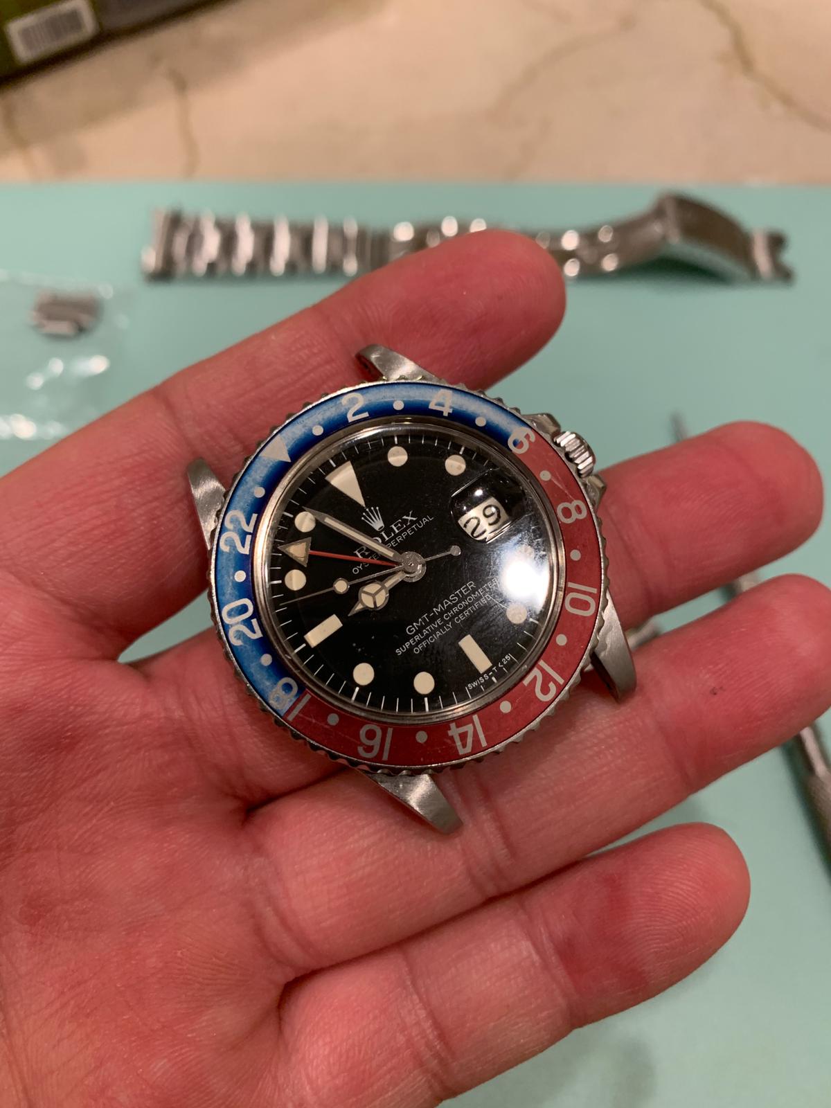

advice need for legit check 1675 or 16750

Could well be a MK IV or MK V in that serial but definitely not a MK. II. Insert, as stated, is a later one but appears authentic.

Well , I’m not comfortable to buy a possible franken watches by paying USD11.5 K .. I prefer the originality. I will keep looking for the right and correct piece. I appreciate your advice . 😀

I have always been skeptical about the Mk2 5M serial watches, but they are discussed here in case anyone is interested:
https://gmtmaster1675.com/mark-2/
The buyer needs to do his research and decide for himself what his comfort level is with the originality of this. Alex is experienced and is obviously not a believer. I'm not really comfortable with it either. I would run a search on rolexforums and see if this issue has been discussed. Here is one thread:
https://www.rolexforums.com/showthread.php?t=623730
The insert is clearly a later blue-back, but the cost of a replacement may be priced-in if you decide that you are ok with the dial and case combo. Depends on the currency of the 11.5k, since we don't know if that's USD, Euros, or GBP.

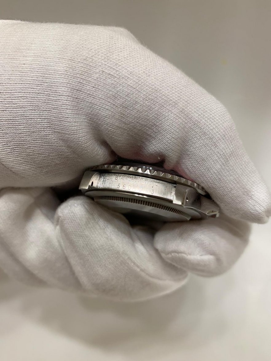

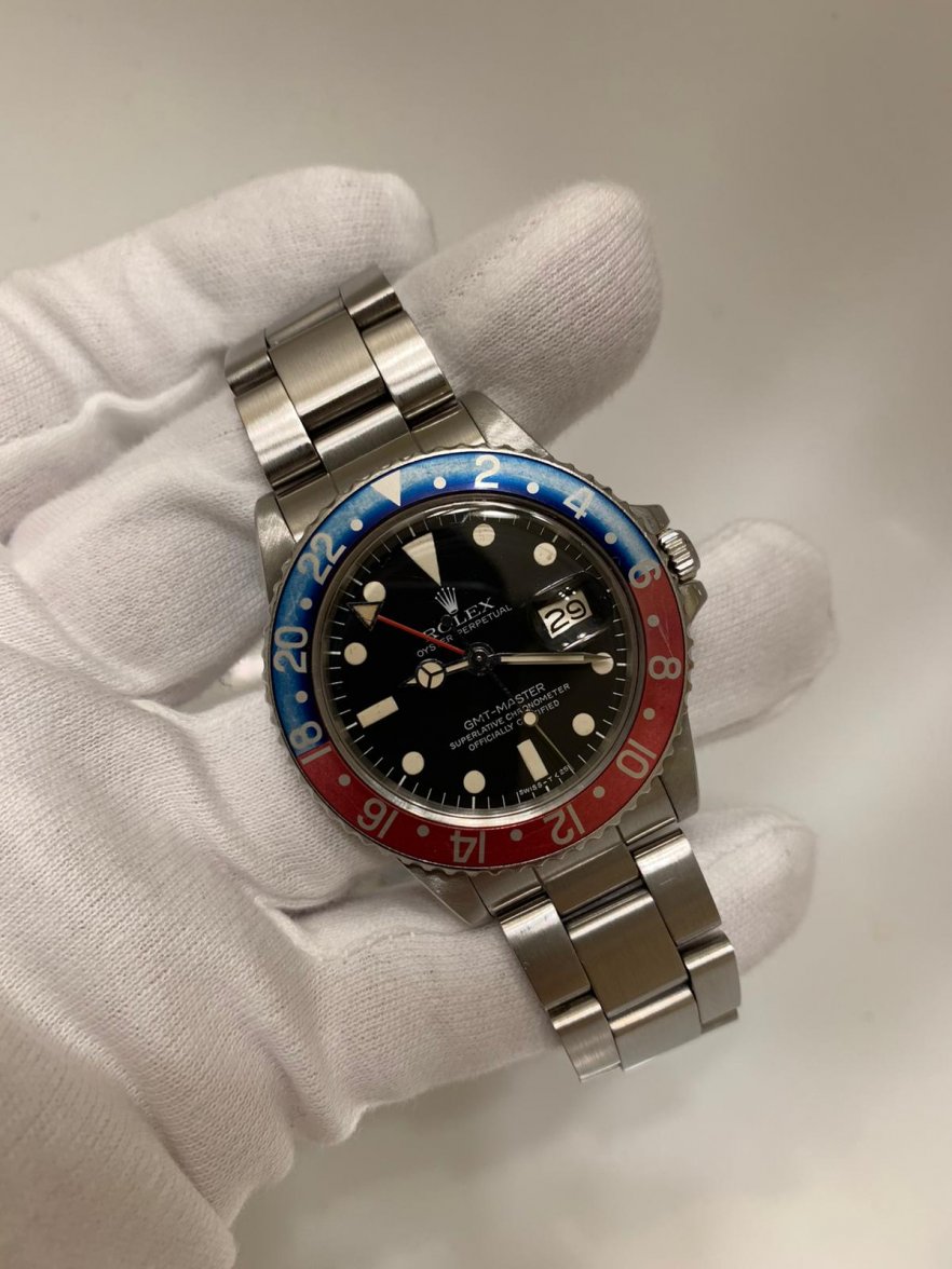

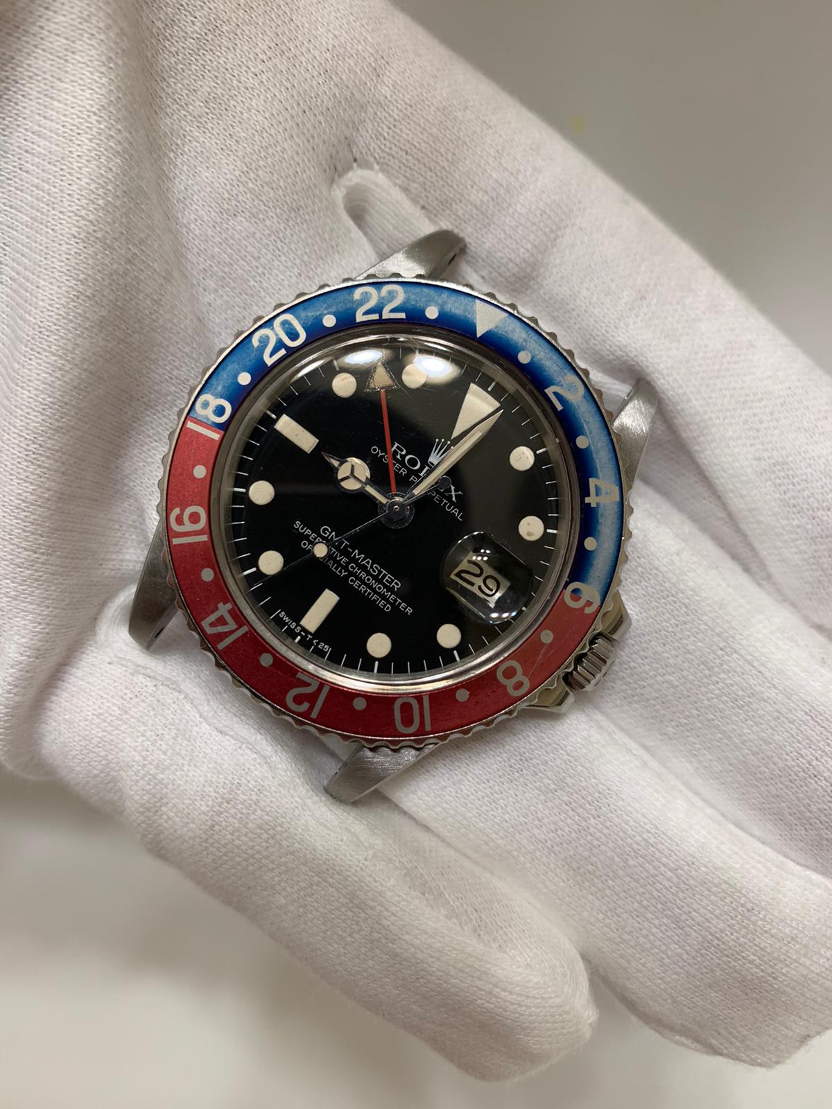

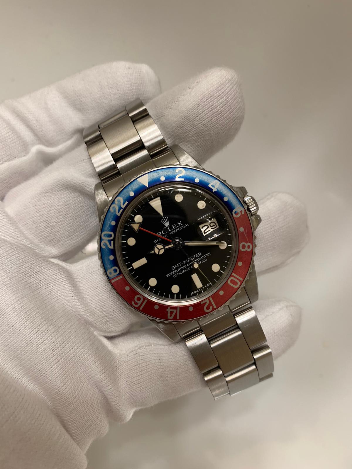

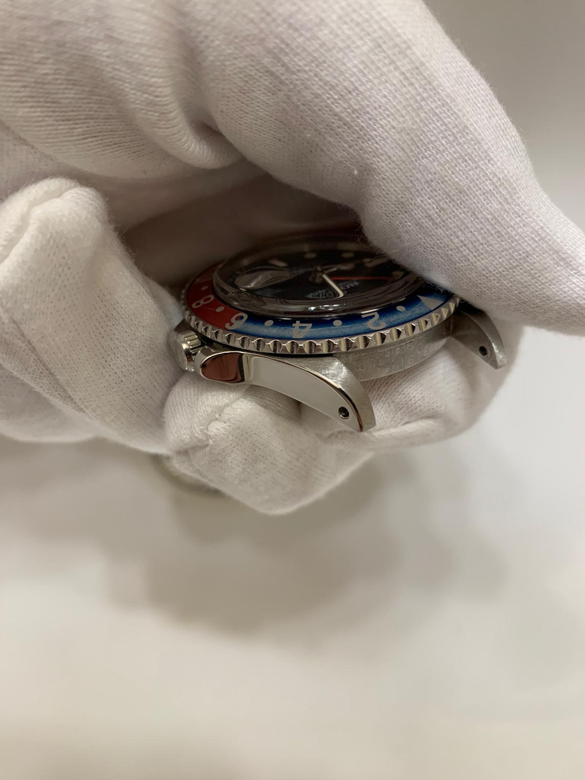

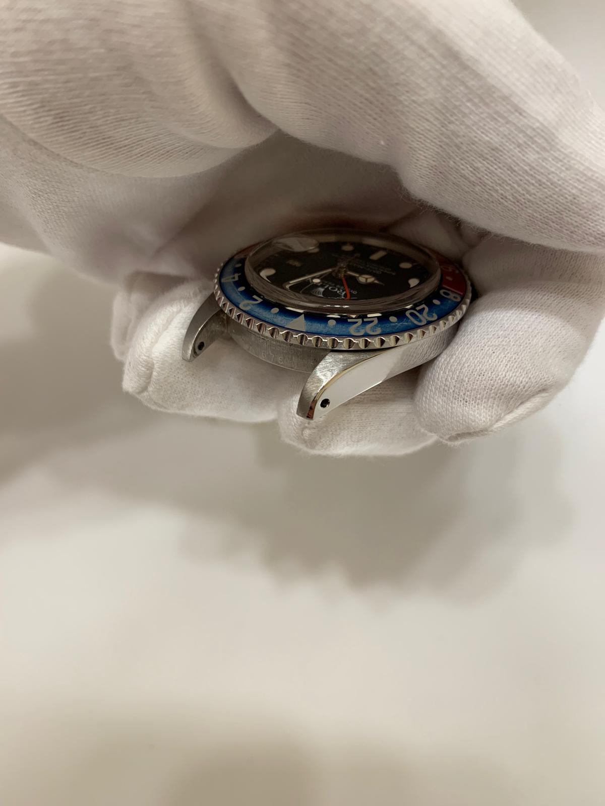

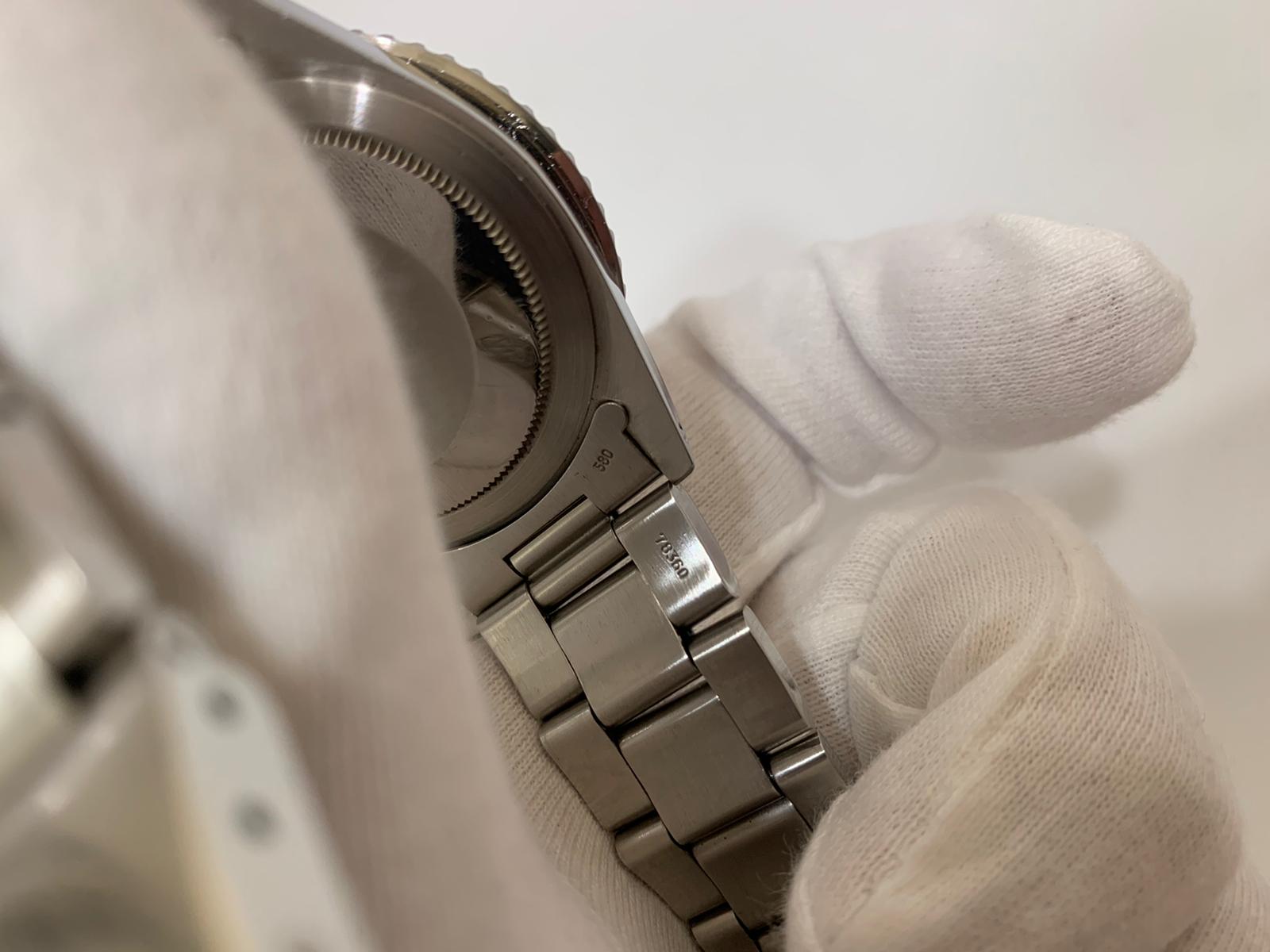

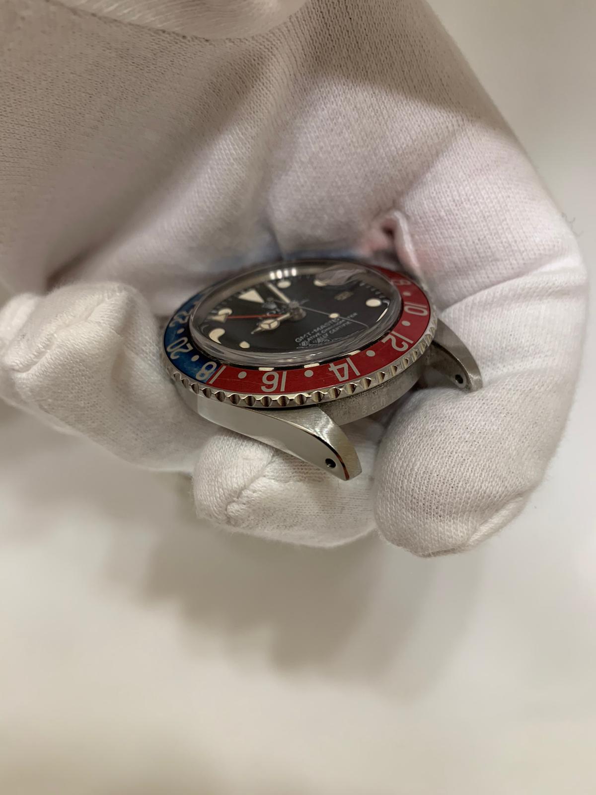

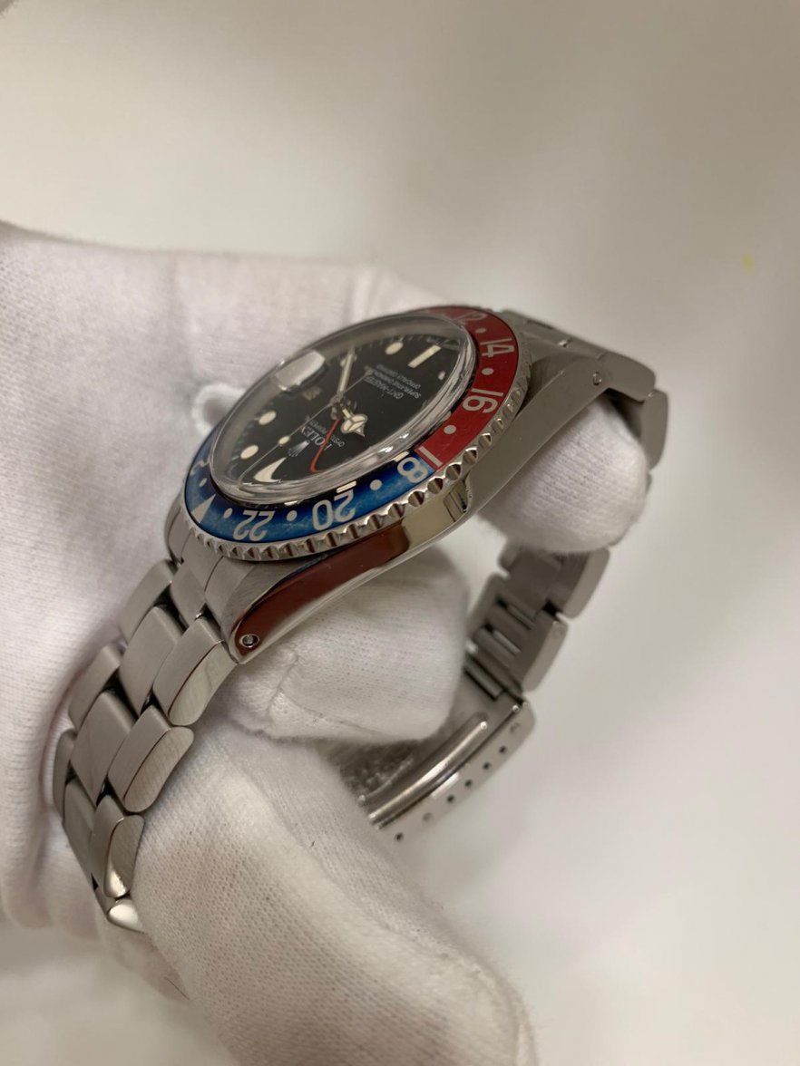

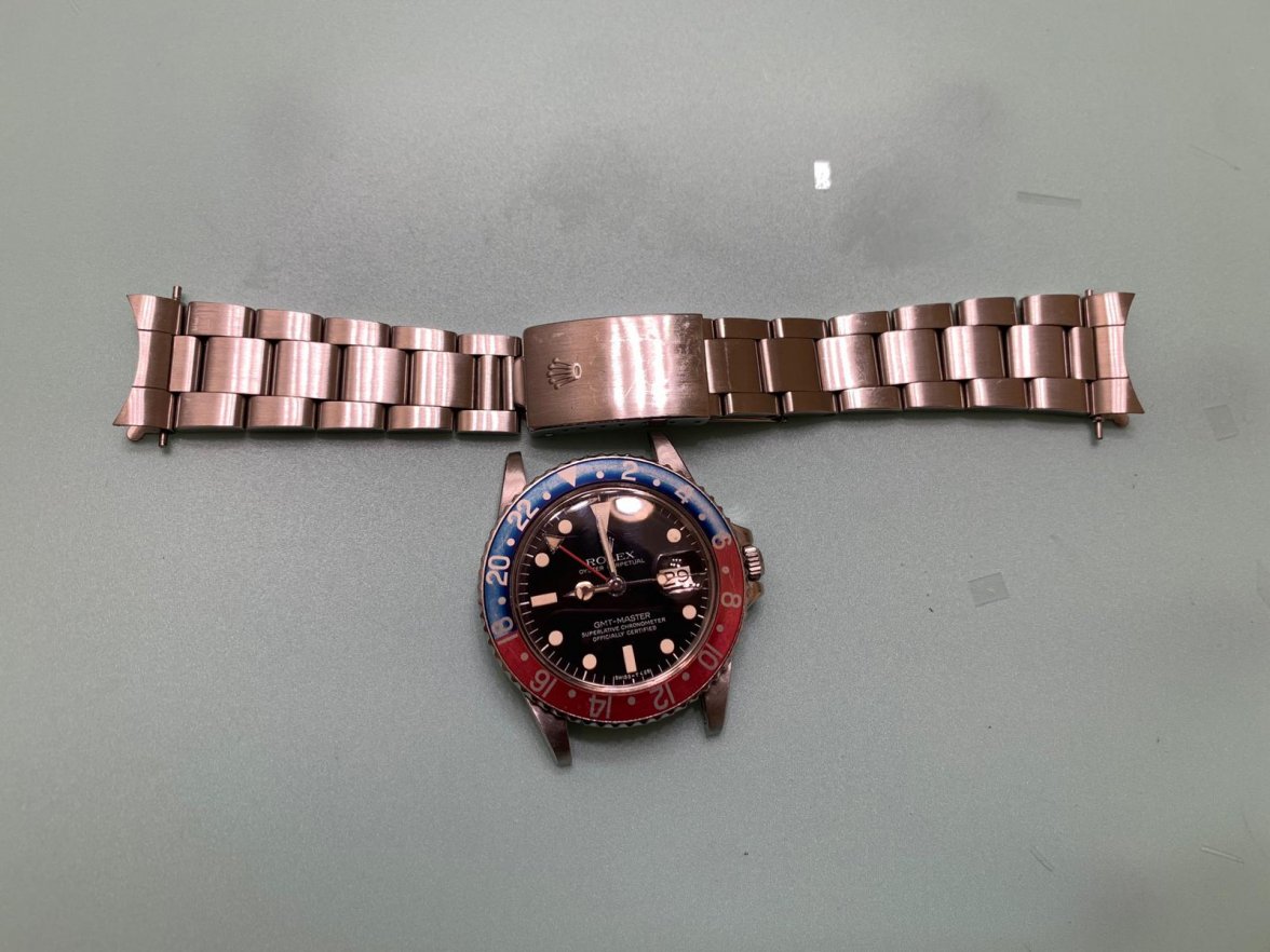

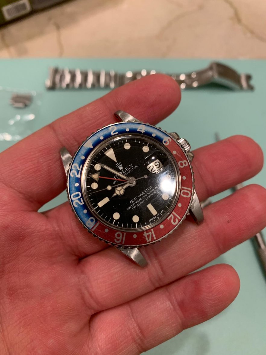

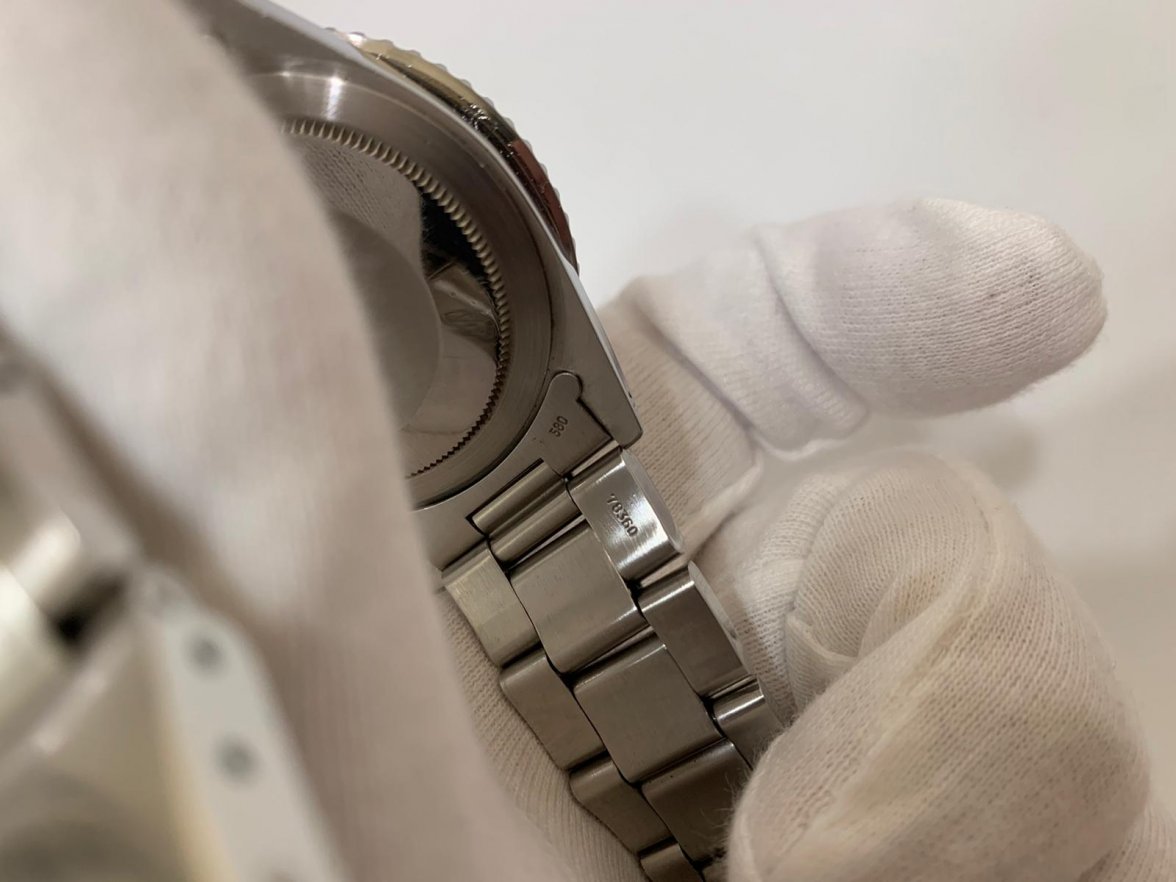

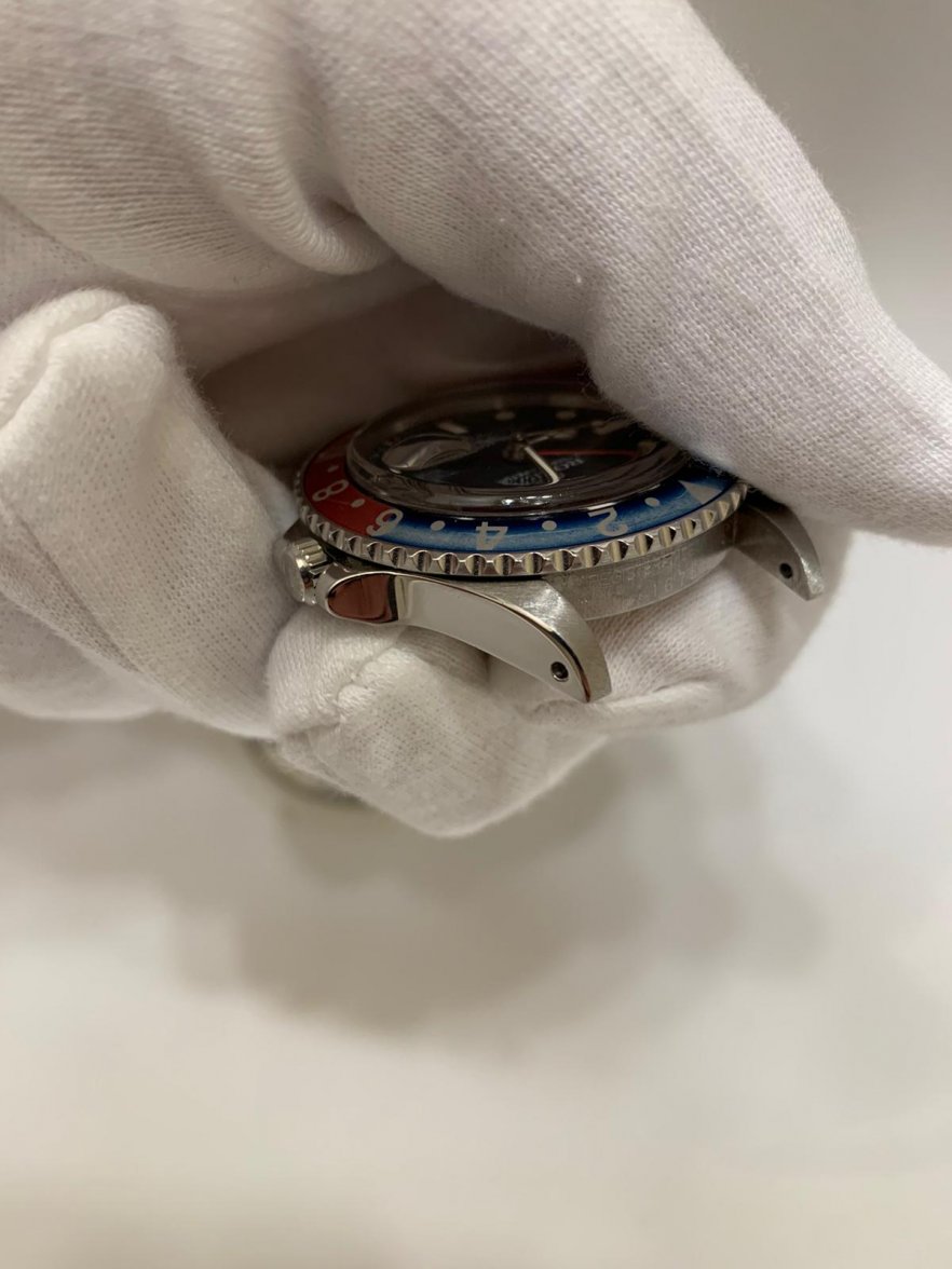

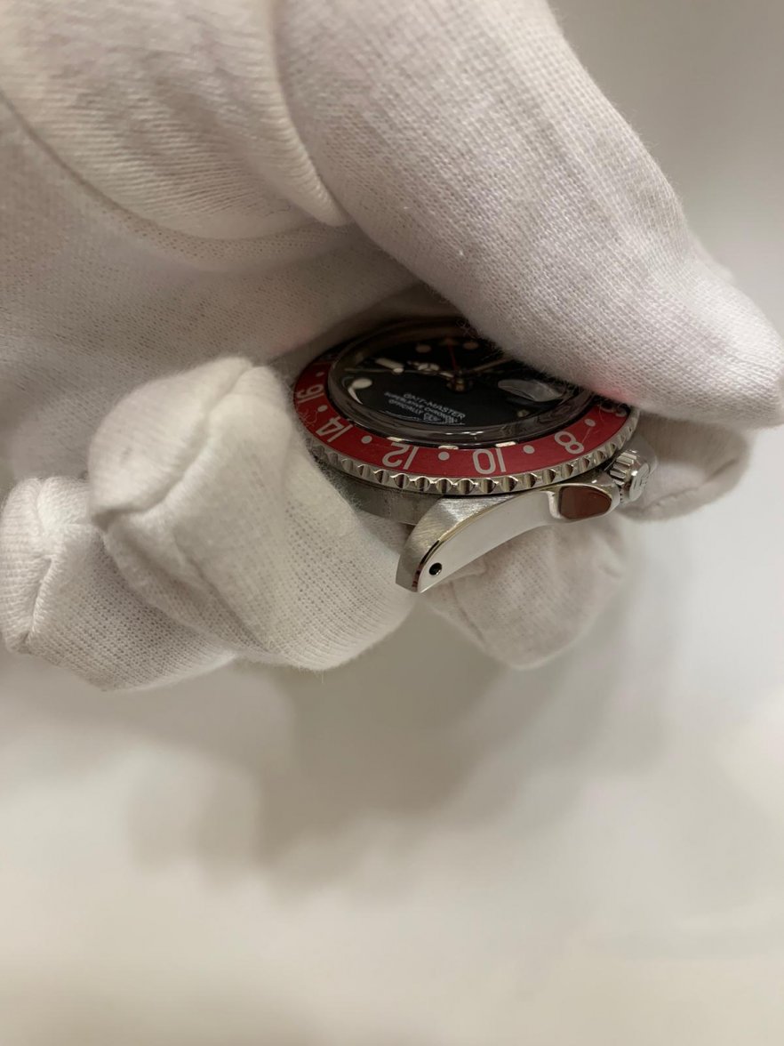

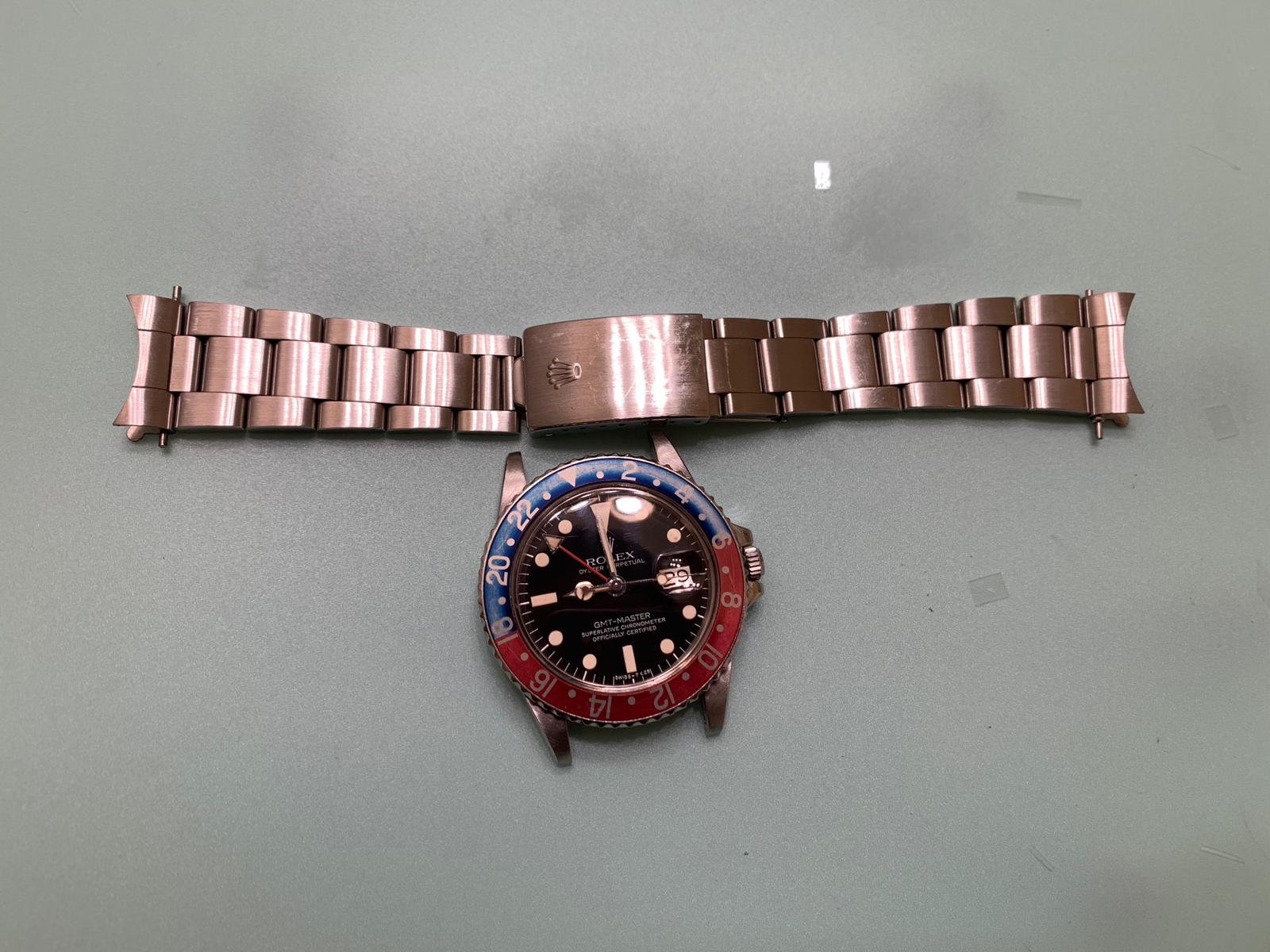

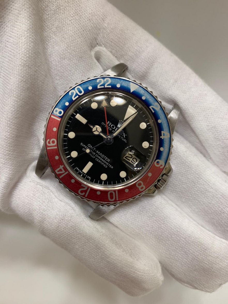

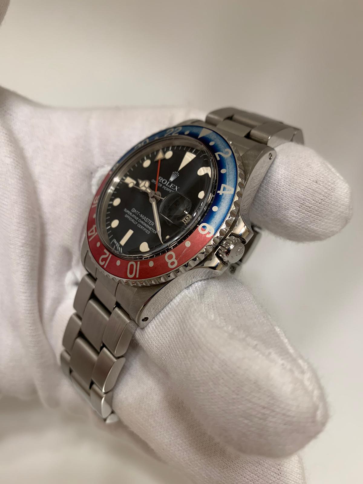

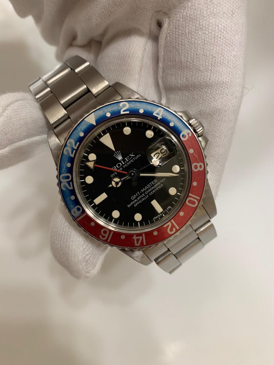

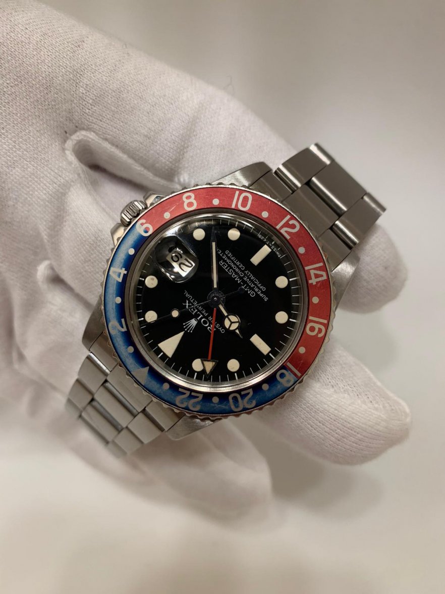

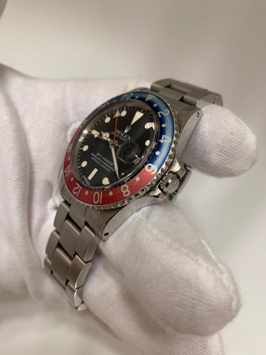

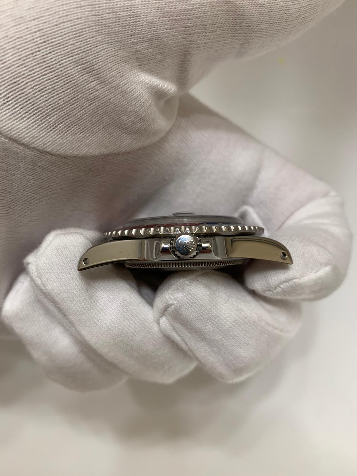

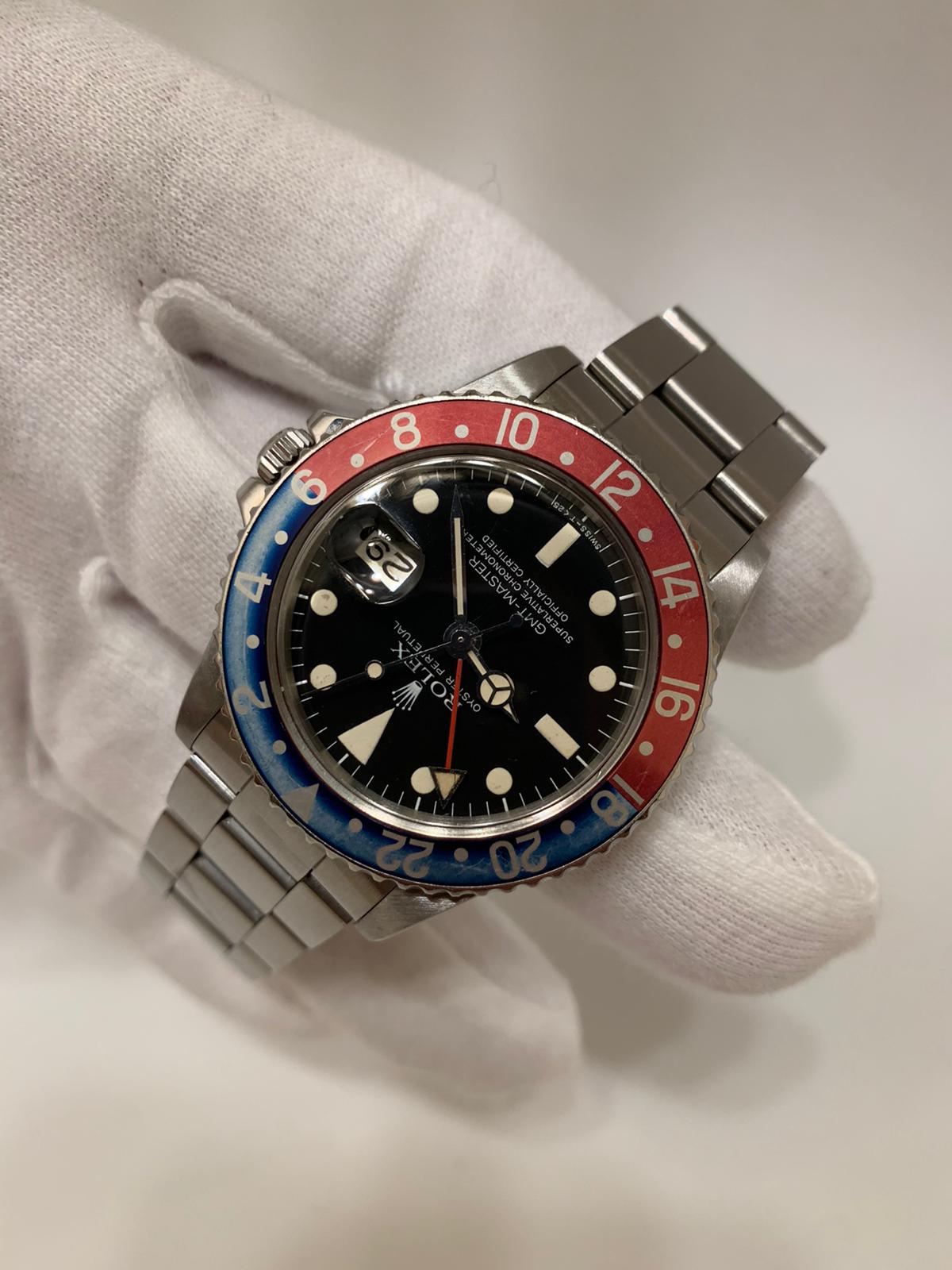

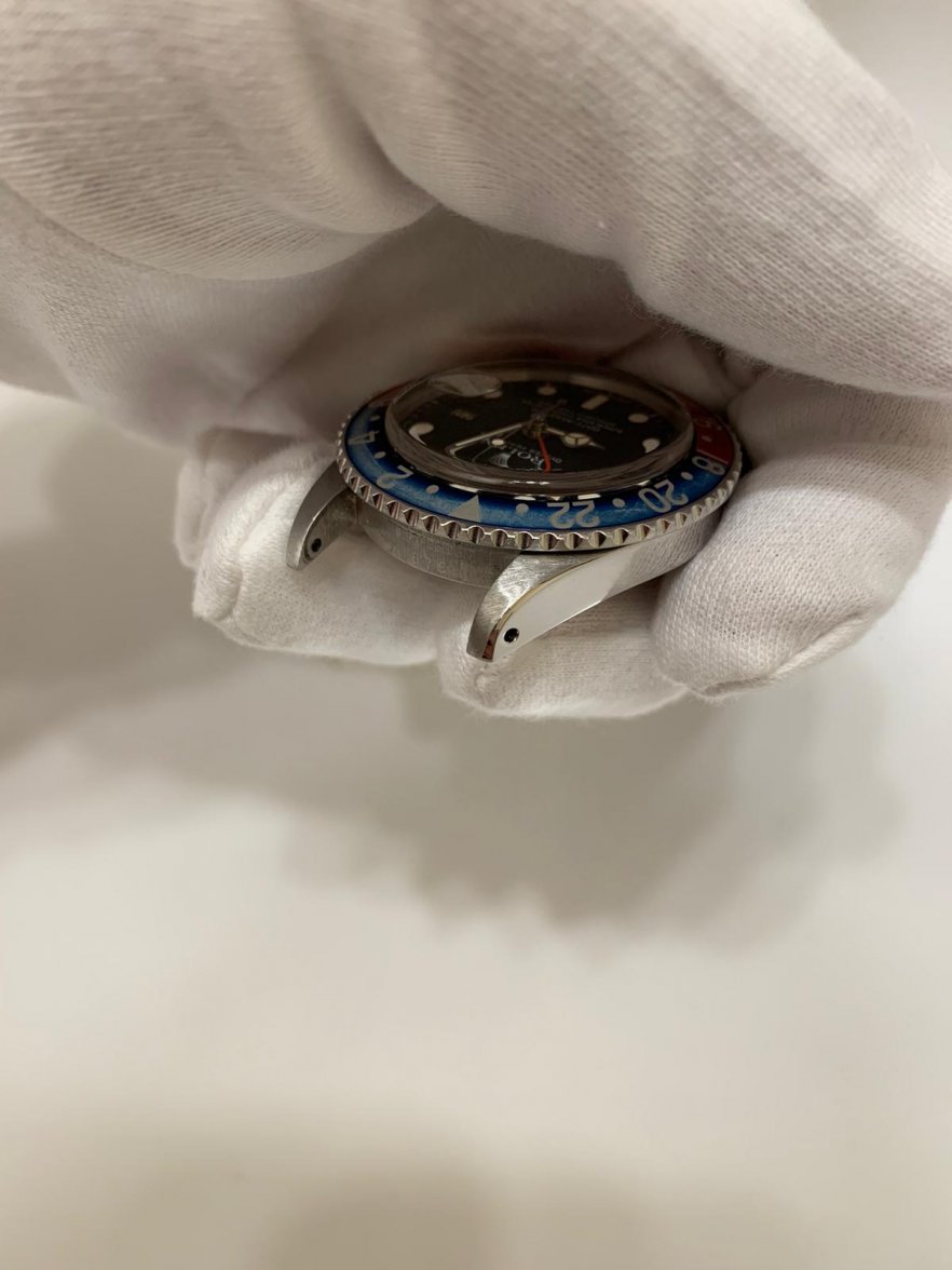

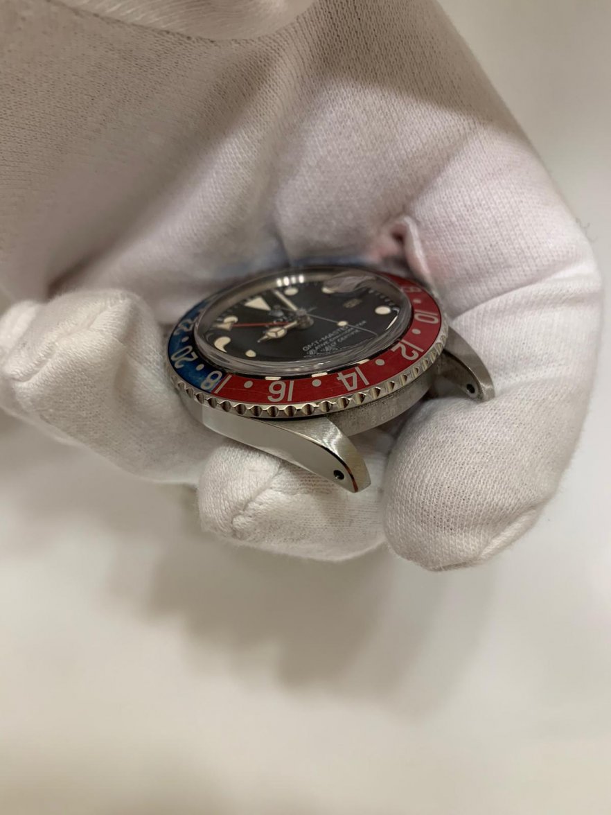

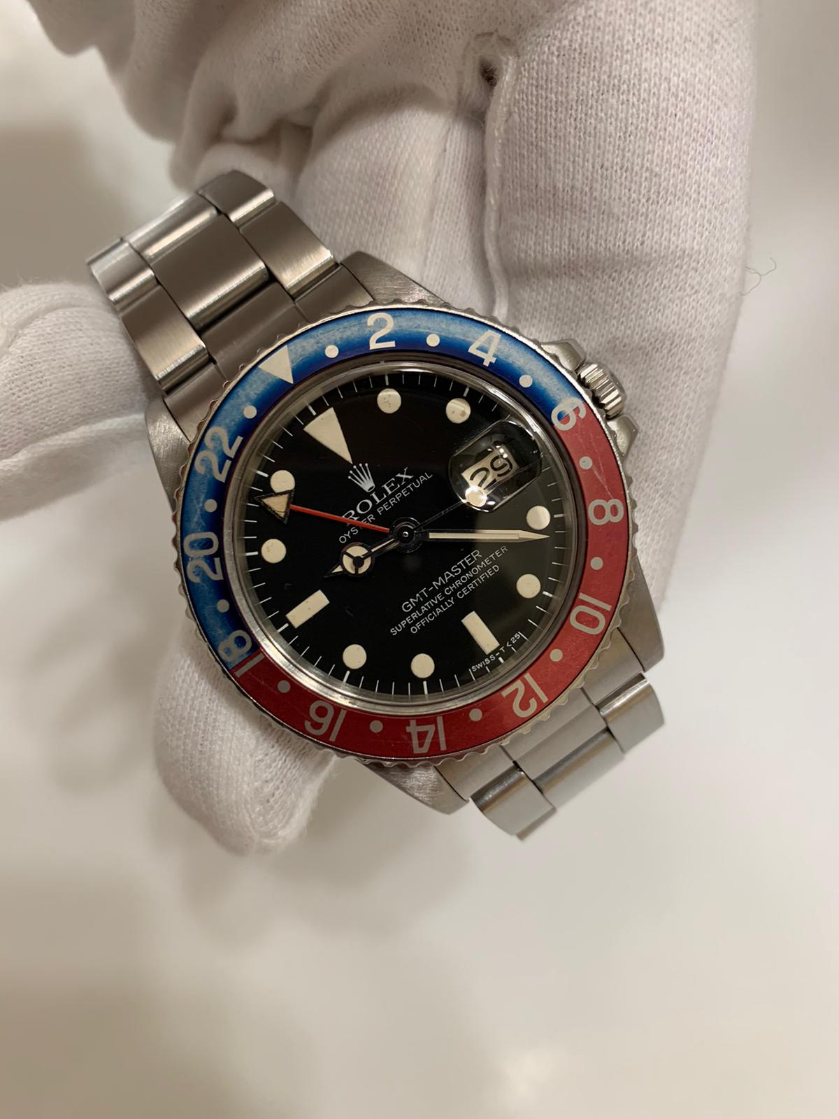

Good day everyone !
May i ask your opinion about this 1675 whether is correct piece ? plenty of pictures provided 😀
5M serial , 1978 year . MKV dial . 78360, 580 endlink. Thank you.
2,216
6,900
Looks good to me, has the correct dial, bracelet and nice blue jeans faded insert. Only item of note is the GMT hand which needs further attention. Not sure if the tritium is cracked or it's a blemish on the crystal. It's also different color which makes me think it's might be re-lumed or replaced. Lastly, case has been freshly refinished as well.
If priced appropriately, I wouldn't hesitate.
16
Yes, i noticed the gmt hand issue. thanks for the highlight

Mark V indeed but as stated GMT hand may not have been born on that watch. Can you share the price?

seems hard to get 100 % original .
