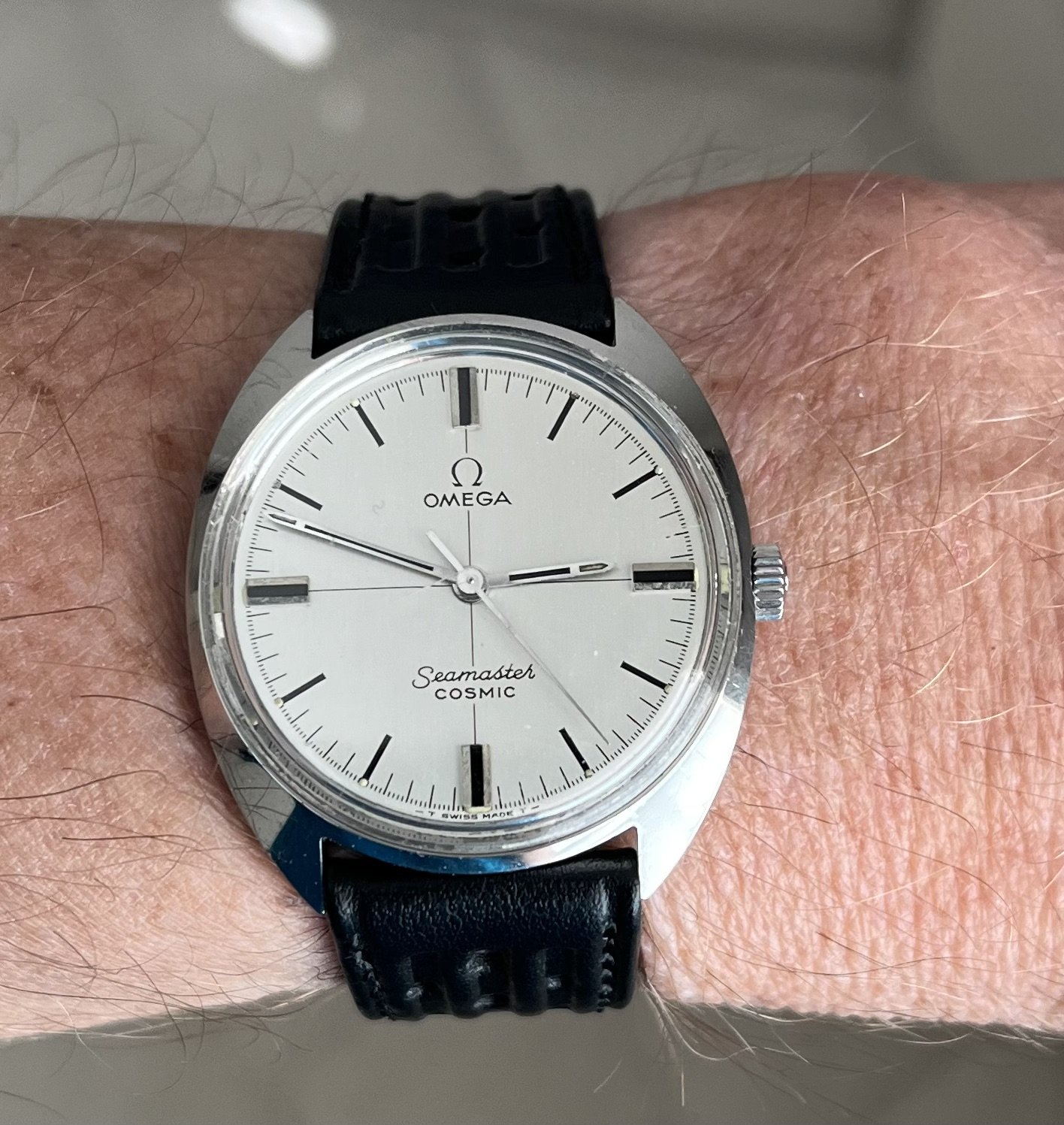

I would love to see your 135.016!
15cm wrist:
Lots more in this thread, though I think most (all?) there are pictures of the larger version, which is itself rather small by today's standards.
As to the original question, it the quick-set really is broken and it's not the case that the seller is simply ignorant of the unusual mechanism, then, yes, the movement is broken. That fault alone would not prevent the time-keeping function from working perfectly, but it could be a sign that the movement wasn't treated well. Unfortunately, as you've probably noticed, the watch has a monobloc case. The only way to access the movement is by removing the crystal, which sort of requires a special Omega tool. (It is possible to remove the crystal with a standard crystal lift.) So the seller may well be unable to provide any movement photographs to verify its condition.
