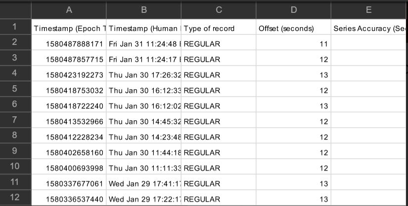

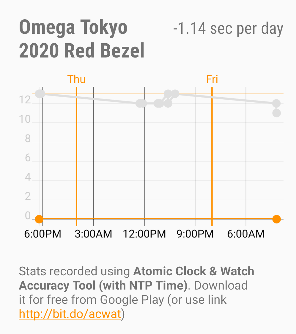

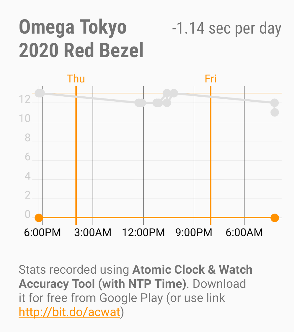

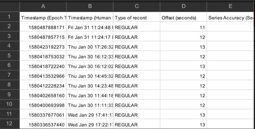

i finally was able to figure out how to use one of these watch accuracy apps (android) and tried it over two days. well, with the dial up, it's pretty accurate! i am certain that over the first 1 1/2 weeks of my receiving my watch (that was around 3 weeks ago), i noticed it was running 1 minute fast per 24 hours roughly. however, the watch was mostly resting on its 9 o'clock side as i wore it only for around 2-4 hours per day, so not much.
after i complete a longer test period of my current test (dial up), say for another several more days, i'll test with the watch resting on its 9 o'clock side again.
in the meantime, over the last 2 days, these are the results.
needless to say, i'm pleased (if these results are to be trusted) and hopefully, when i go to test the watch laying on its 9 o'clock side again some time next week, it will also test well. i would not know what happened a week and half ago when it was entirely obvious it was running roughly 1 minute fast per day. you just couldn't miss that! strange.

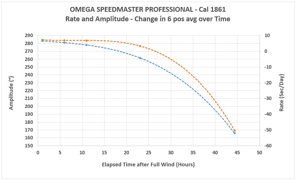

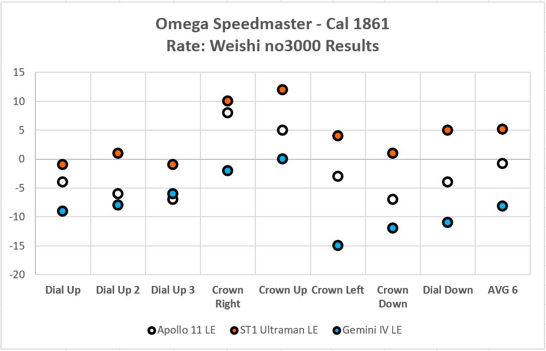

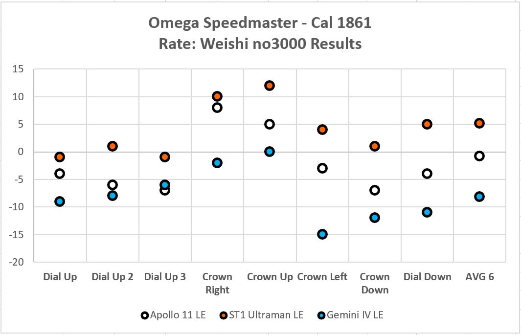

Here is data I collected with several of my Speedmasters over various positions. Definitely a positional variance but not even close to a minute per day.

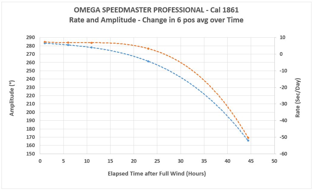

Here is another chart showing how a typical Speedmaster starts losing time after initial wind (hence @Archer question about full wind). The more time that passes, the more time the watch loses (not gains).
