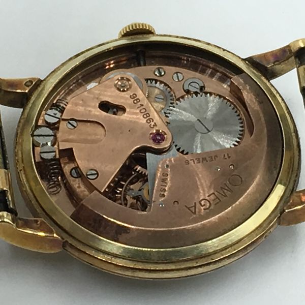

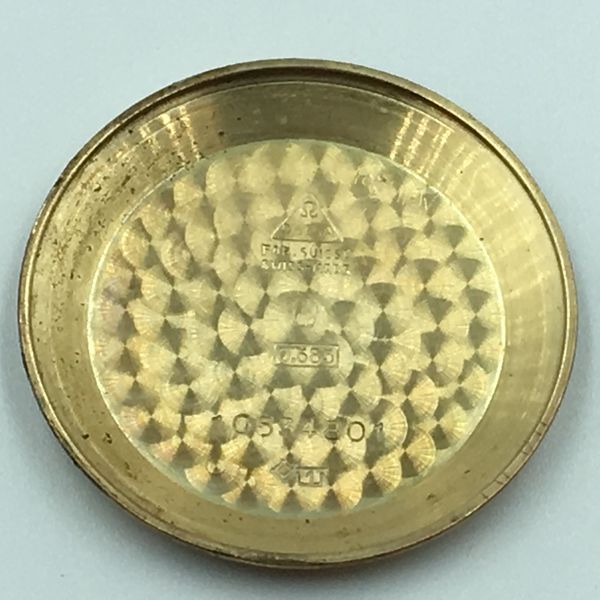

I'm only about a year into vintage watches and am still developing my franken-watch/redial radar, but I found an estate sale listing that caught my eye.

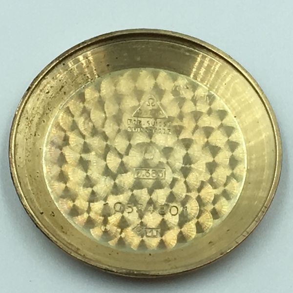

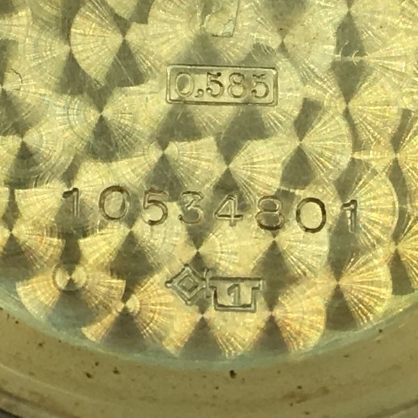

From what I can tell, the serial number (10534801) on the case back indicates it's from 1944.
There is no size listed, but based on comparable watches I'm guessing that it's 34 or 35mm. (If it ends up being 32-33mm I'll be pretty disappointed.)
Questions:
- Any obvious red flags that I'm missing?

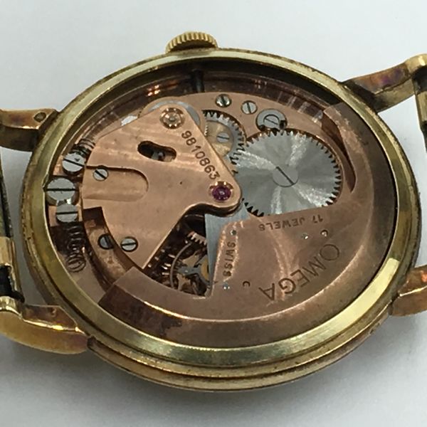

- What does the serial number on the movement indicate? (9810863)
Thanks in advance for any guidance and for building such a great resource here!

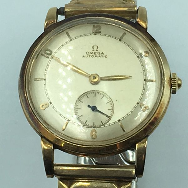

It is one of the earliest omega bumpers I've seen. It is powered by a bumper movement caliber 28.10 and cased in 14 k with a correct crown.
Diameter is about 33 mm.
The bad thing about it is the repainted dial that hurts the value a lot.
Serial #9.8 mil means it was manufactured around 1937/38.
4,453
11,355
I agree with Hoi about the model and movement but I have a feeling the dial is original. Hard to tell from that one picture, but worth a gamble if the price is right. Let me know if you pass or it isn't to your liking! 😉
Edit: there is something funny with the 5 o clock marker though, as it looks a bit shorter than the others not touching the minute ring.

Got it. Man the redial-detection skill is a tricky one to nail down.
Interesting bit of history implied in this watch though (and other 1944 omegas I suppose) that the movement was made before WWII and then the rest was made or possibly just stamped afterwards.

I see that did you notice the 7 is sitting back a bit as well. I would think these are hand applied, could it just have been a QC issue? You mentioned different length I don’t see that but could just be my eyes.
1,232
5,685
Manufacturing techniques weren't that much developed back then, dials weren't that crisp always. Or it could be an early redial, dial style looks more late 40s/early 50s than late 30s to me, but I don't know if redials were that good back then. This watch looks pretty real to me, and it's beautiful.
