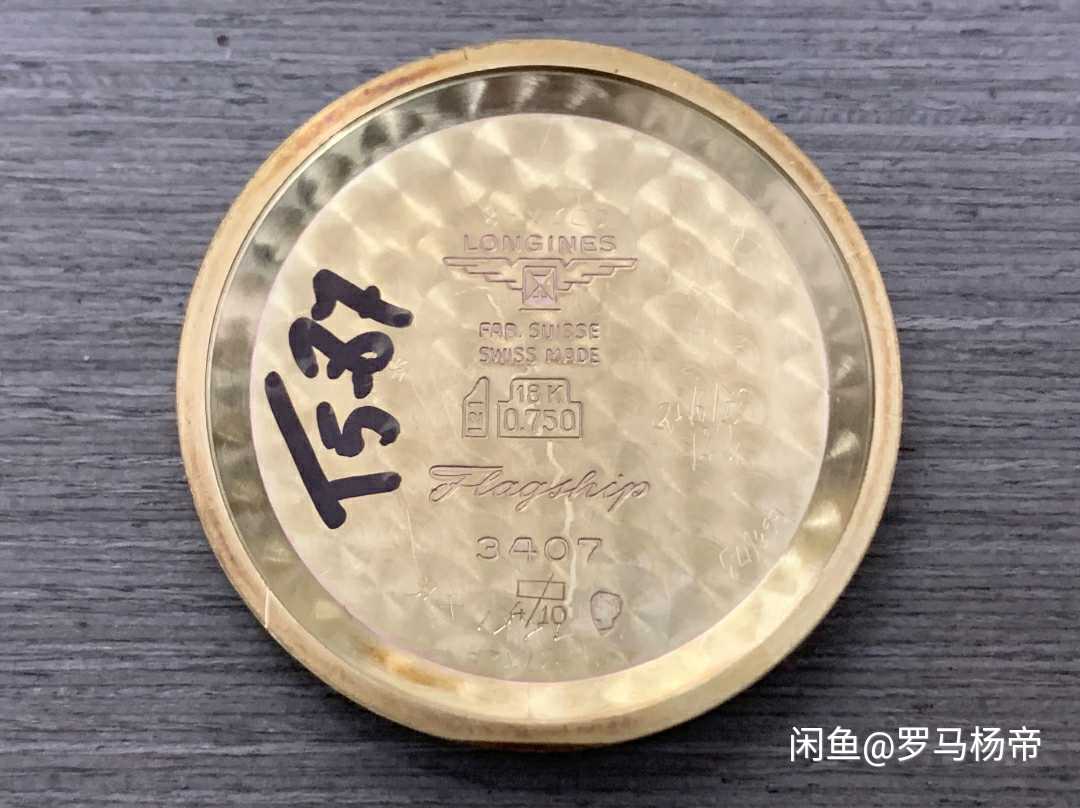

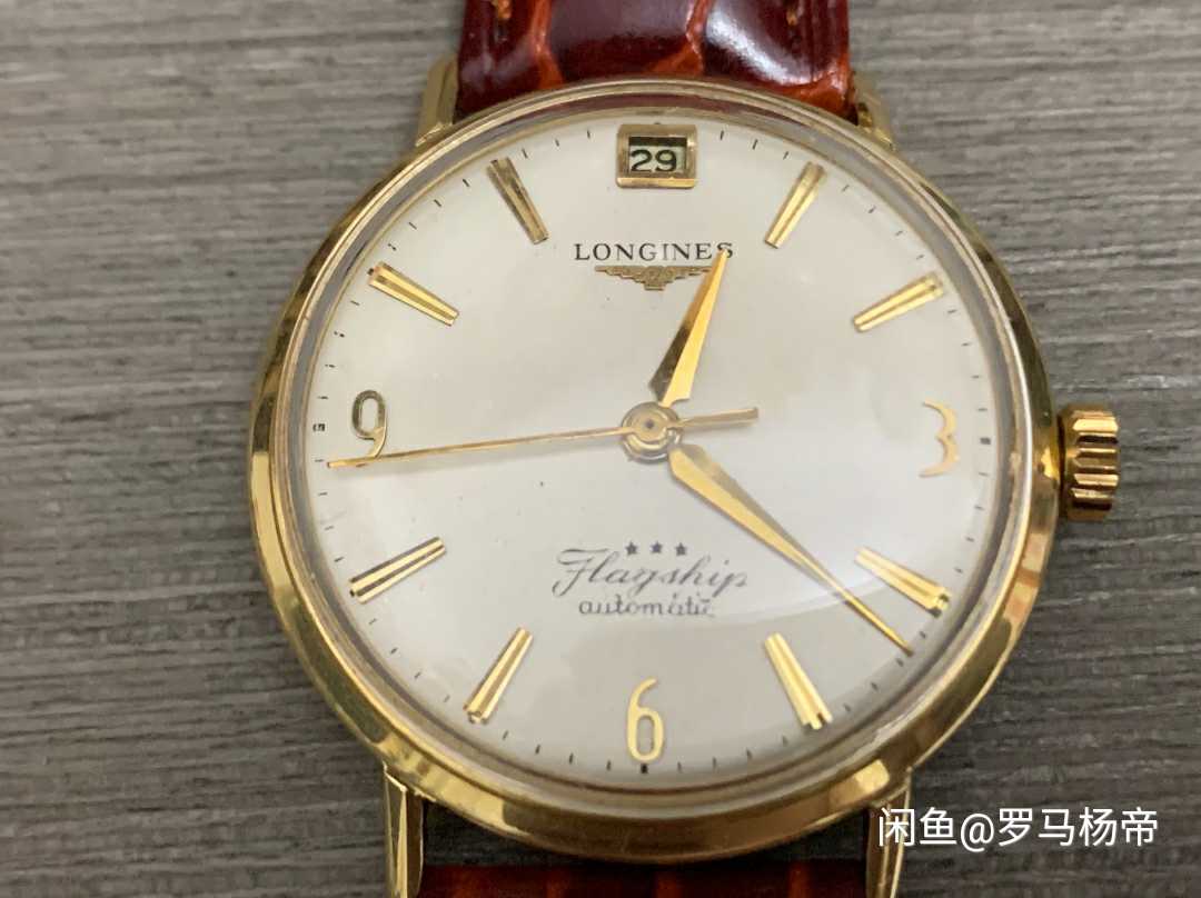

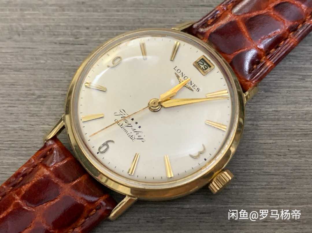

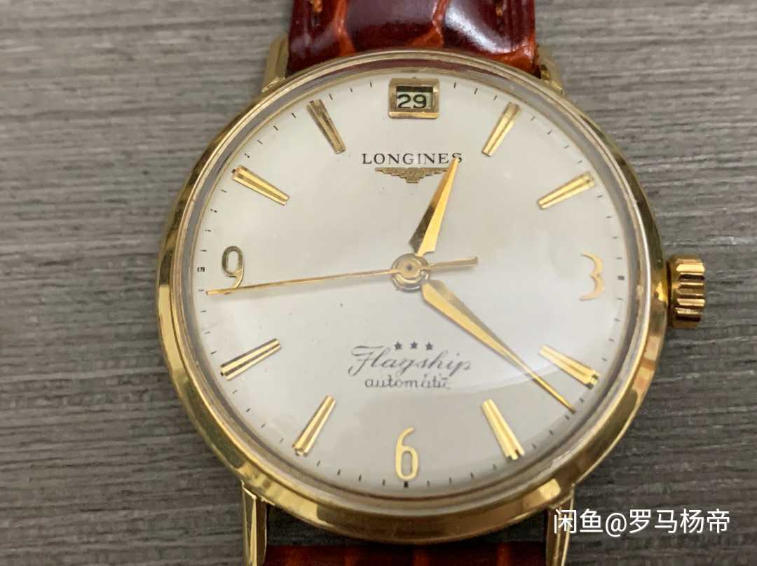

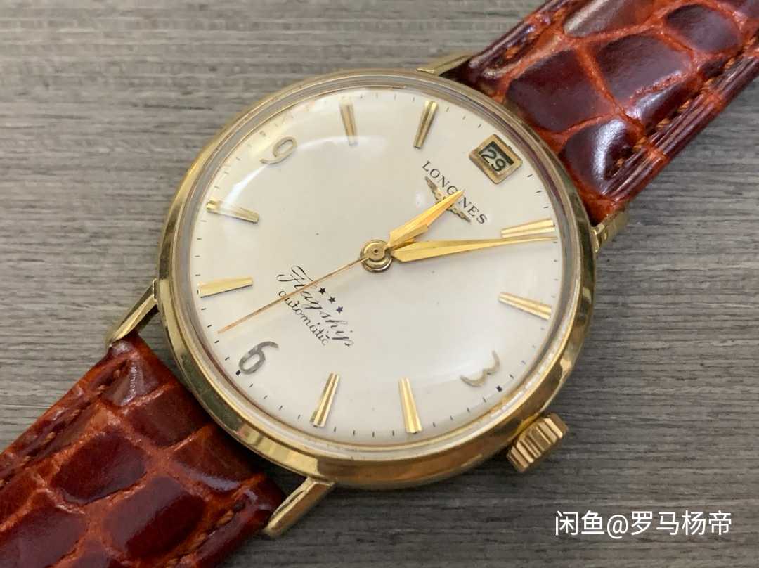

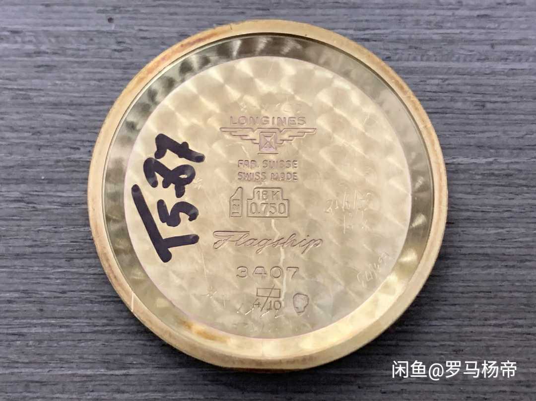

how about this watch?
why this watch dial without "SWISS MADE"? maybe it not the original dial?
thank you!
8,248
29,147
The lack of "SWISS MADE" is not a problem, but it does appear to be a relatively crude redial.
374
344
Is it just me or does the ship in the word Flagship seem to be curving or dropping away. The c in automatic also appears to drop below the baseline. The stars are not quite in alignment either - it looks a little more like Orions Belt.
I would be a little worried about the hour hand position compared to the minute hand. Although the watch shows 12:21. The hour hand seems to point to the 3 minute marker, well forward or where one might expect it to be.
I like the dial markers and indices a lot and the case seems in reasonable shape.
