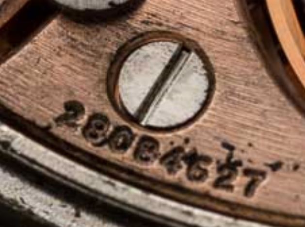

So -as every Friday- I check if there are new offers from a well-known watch dealer in Germany
Today I found a -74 Speedmaster with step dial.
Interested in knowing if it is an early production which could confirm the step dial I check the serial and it turns out to be 28084627 which is wrong for that reference (too early) and -after taking a look at Ilovemyspeedmaster.com- seems to be no Speedmaster movement at all
So watch out and check what is offered!
Happy hunting

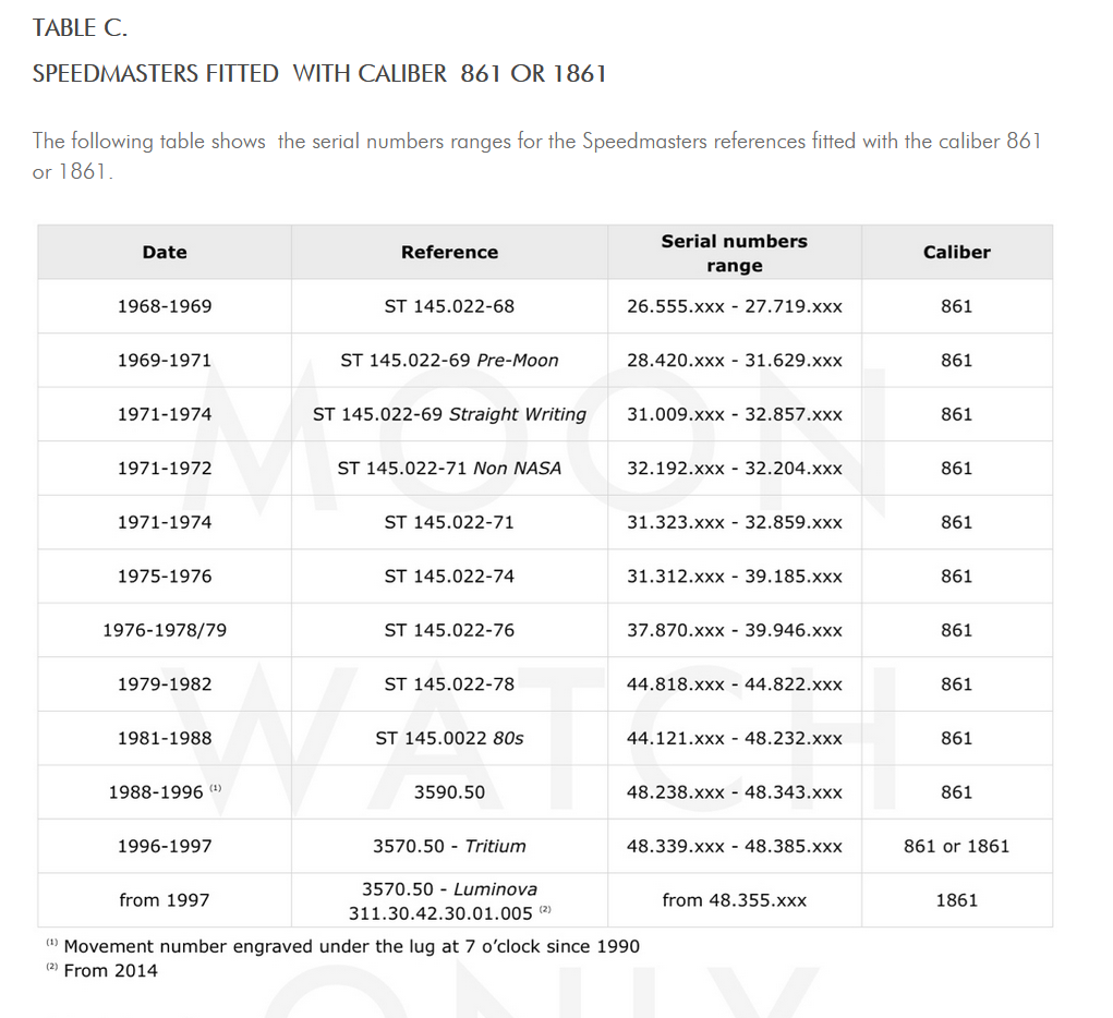

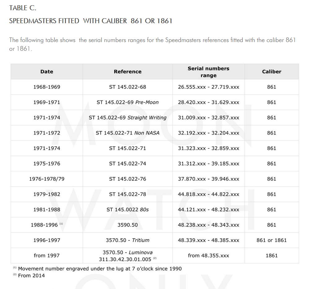

The movement also seems to be atrociously filthy. I remembered reading a thread from a while back about abnormally low serial numbers in -74's. This is the one I remembered, which has a picture from MWO addressing this issue, and how there are many -74 with steel brakes:
https://omegaforums.net/threads/ebay-145-022-74-with-low-serial-number.101522/
In that case the movement was WAY too low, but in this case there may be a bit more room for fudge factor. But regardless the consensus then was basically that if the dealer wants to sell a -74 that seems to have too low of a serial, they should be offering it with an extract.

Even if just the caseback was wrong - ilovemyspeedmaster says "No moonwatch" (for 28084627)
5,059
15,583
Because (from here) ...
Edit : and I quote "The recently serviced watch (300; +0s/d) is in very good running condition, keeping very accurate time." ... yup, that movement looks recently serviced allright...as recently as 1970...
