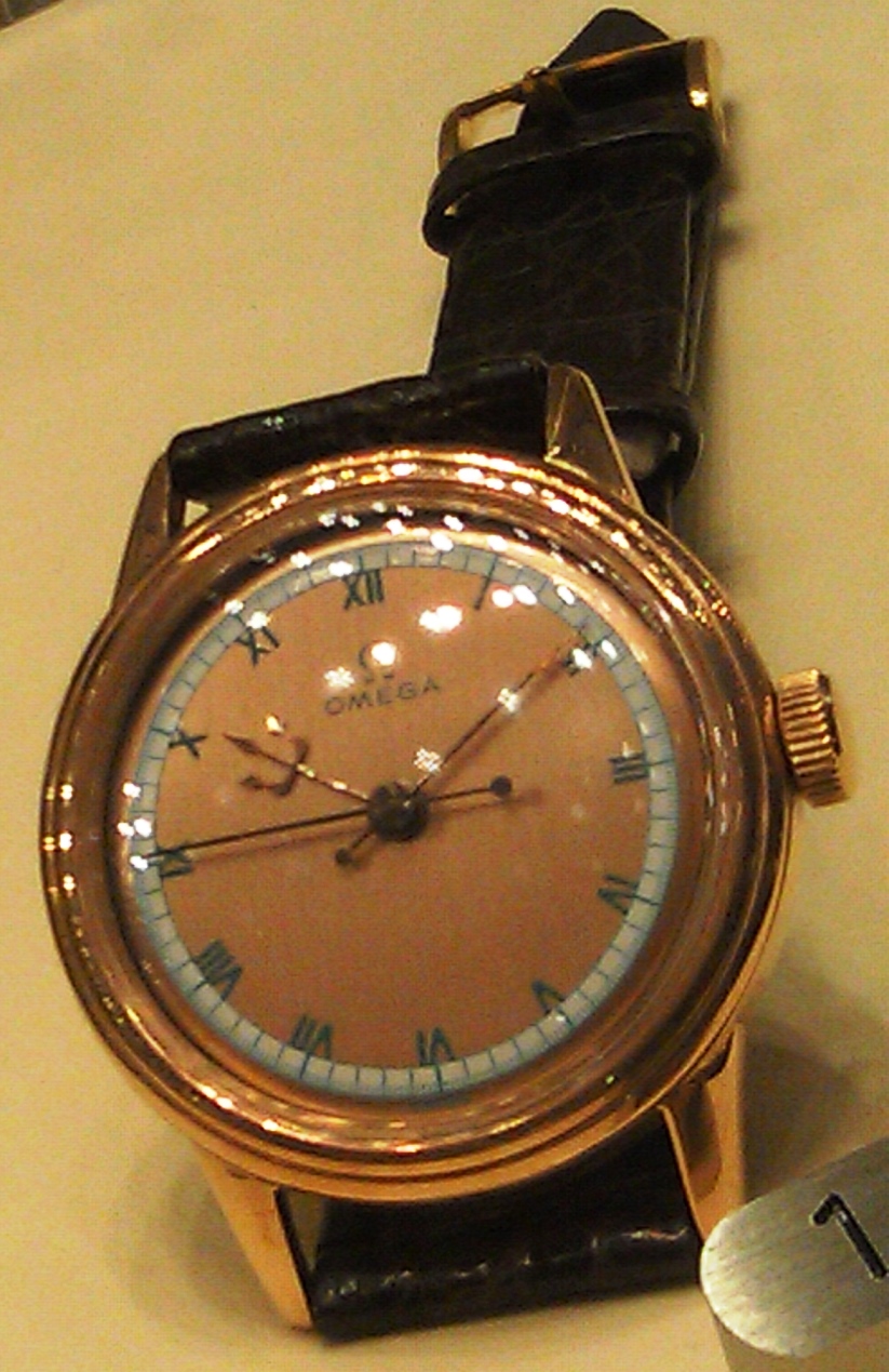

Very nice, described like a Da Vinci 😉 I must break into the chronograph world at some point, any ideas?
Well, you are an Omega guy, so Omega seems an obvious place to dip your toe. I've heard they make chronographs...😉
Tissot & Lemania are good alternatives that do not come at as high a markup.

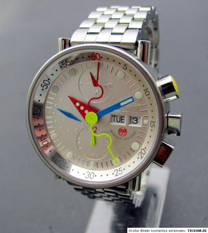

Sure - we'll call them 'Warhol' hands. 😜
You do them waaay to much honor, and I'm not even a fan of Warhol's. I vote for "Happy Meal" hands, "Lego" hands, or "Alain Silberstein is Laughing at Your (Considerable) Expense" hands.
