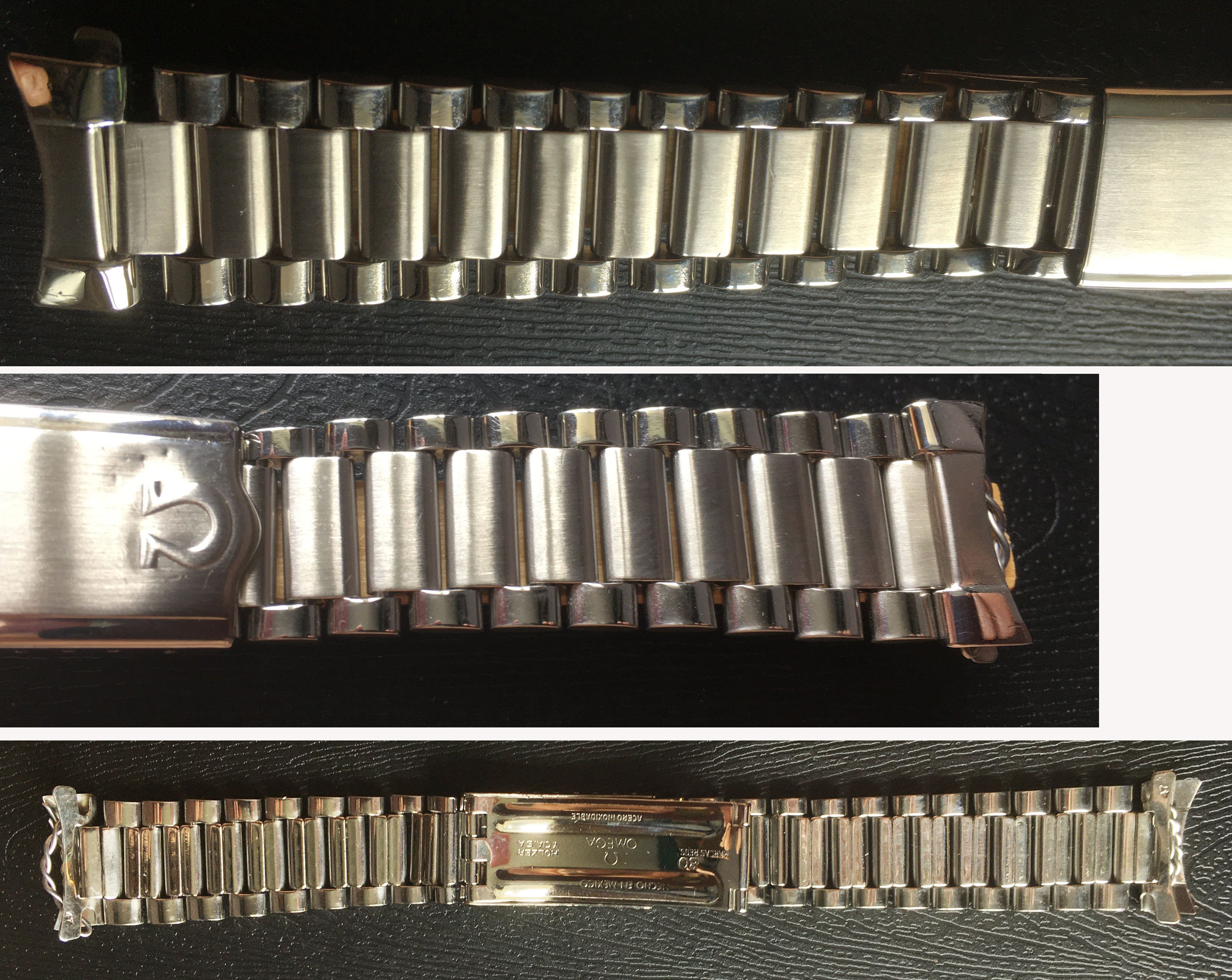

while tidying up my bracelet boxes, found this Holzer Omega bracelet. If i recall well, I got it about 15 years ago from a Texan seller.

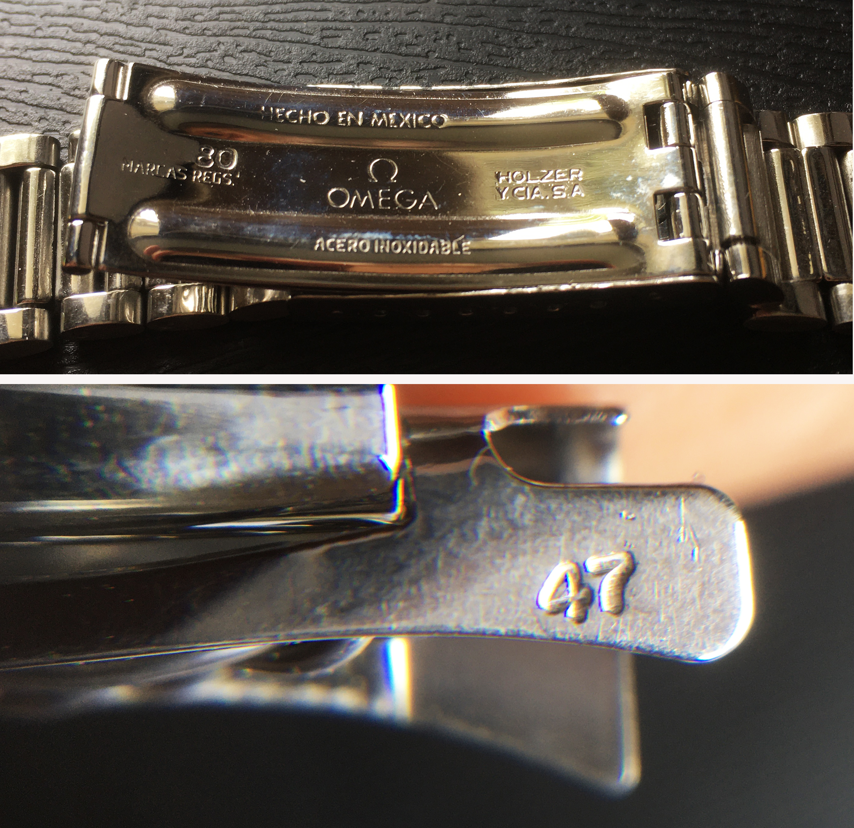

But it is not the Holzer that is seen more frequently. It has flat links, resembling those from 1039, 1035 etc - they are not however elastic. the endlinks are marked "47" and are 20 mm. The clasp is marked:
Hecho en Mexico
80 MARCAS REGS
Acero inoxidable
HOLZER Y.CIA. S.A.
We know the history of Holzer as the Mexican Manufacturer for Omegas in all South America, but I cannot recognize one type with these flat links.
1- Is it genuine or some Franken?
2- which watches could have fitted to?
Best wishes
Franco
PS: looking in past Omegafoums post, have found an Omega 1155 bracelet near identical, with 47 endlinks. But the clasp is not Holzer, is marked Omega only
Follow-up: According to many, the end links do not belong to this bracelet, and probably also the links and the clasps were not born together. Basically, an assembly of parts :-( Thanks for your help.
