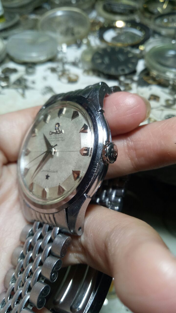

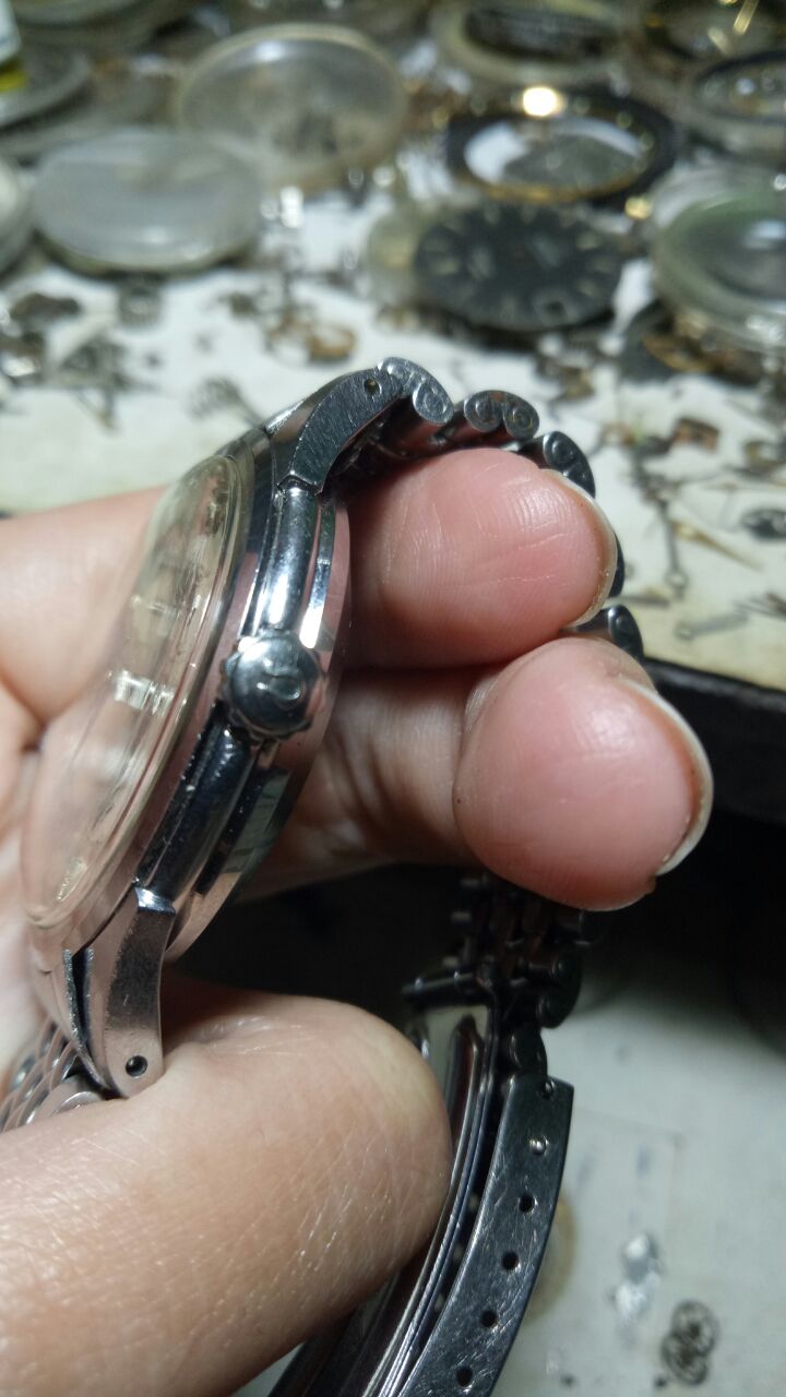

I'm inclined to think that the clover crown is not original. Given the wear, although only moderate, of the case back medallion and generally nice patina of the case with a gentle round on the lines of the bezel and lugs, I would think the crown would not be so sharp if it was original to the watch. Also, is the crown partially pulled out in the pic? Otherwise it would appear to not be sitting as snugly over the crown pipe as it should.
I've been collecting Constellation ads for quite a number of years and I have never seen an ad showing these earlier Connies with a clover crown. Seen plenty of ads for 2852 models and beyond, and a 1956 version of the 14355. But, I think in these earlier 2648 and 2652 models there appears to be a consistency in the decagonal crown. This is not the slim decagonal, but the fatter version that fits the 2.5mm pipe size. They're still available at Otto Frei.
Cheers
Desmond

Well, the design story would dictate that it was a decagonal, although I have seen some US retailed versions with a crown very similar. It's an old crown by the look of it, and probably needs replacing. I would source a decagonal while they're still available.
Cheers
Desmond

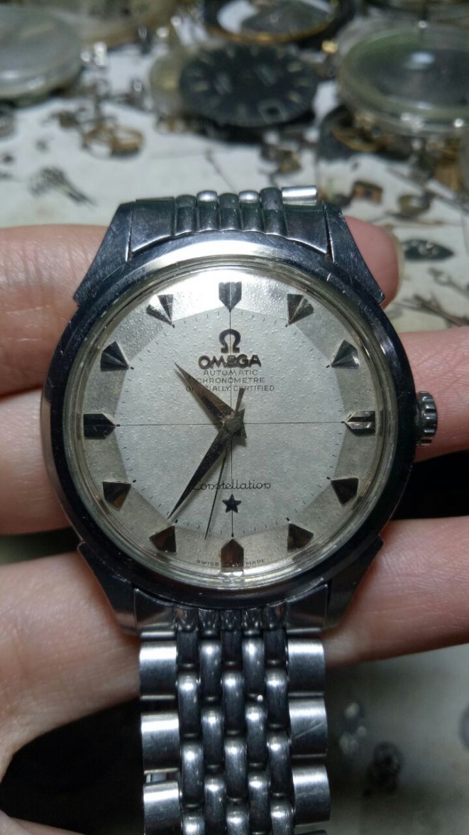

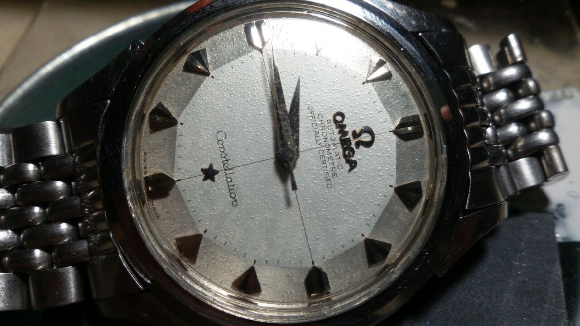

And the dial though, is it original? Looking at the font the index the cross hair and the increment?

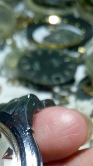

Can we get a close up of that black dial in the background
I could make some request, she's a friend of mine that "has been in industry" for several years now back in my hometown. And yeah I can't go back to "educate" these friends yet. I'll post it later

Looks original to me

Hi Desmond,
Thank you for your inputs!
I've tried to find a decagonal crown that could go with this one, but I kinda failed... 🙁
But a friend got me this clover crown, From here I see that it got serial numbers of 16xxxxxx which indicates that the watch was produced around '58, and the crown, it fits snugly in place, but I wonder if this was period correct for the case as well? 2852 with clover crown?
Thank you!
Best
Jev

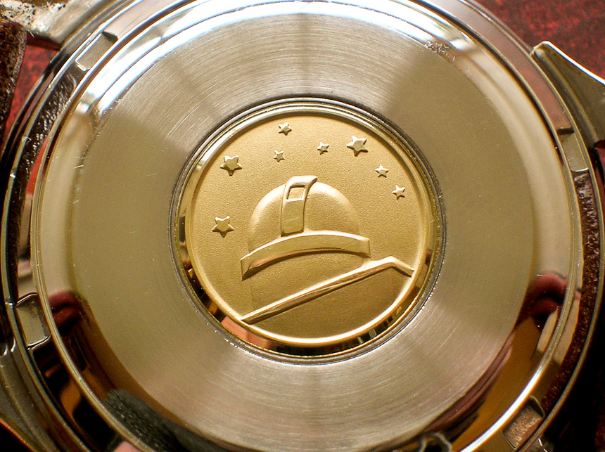

Here is a close up of the medallion, which looks so fresh that I am going to be worried about wearing the watch now -
Looks fantastic! Great find and you just have to keep looking to get what you want...
Lovely watch and that dial is killer!
