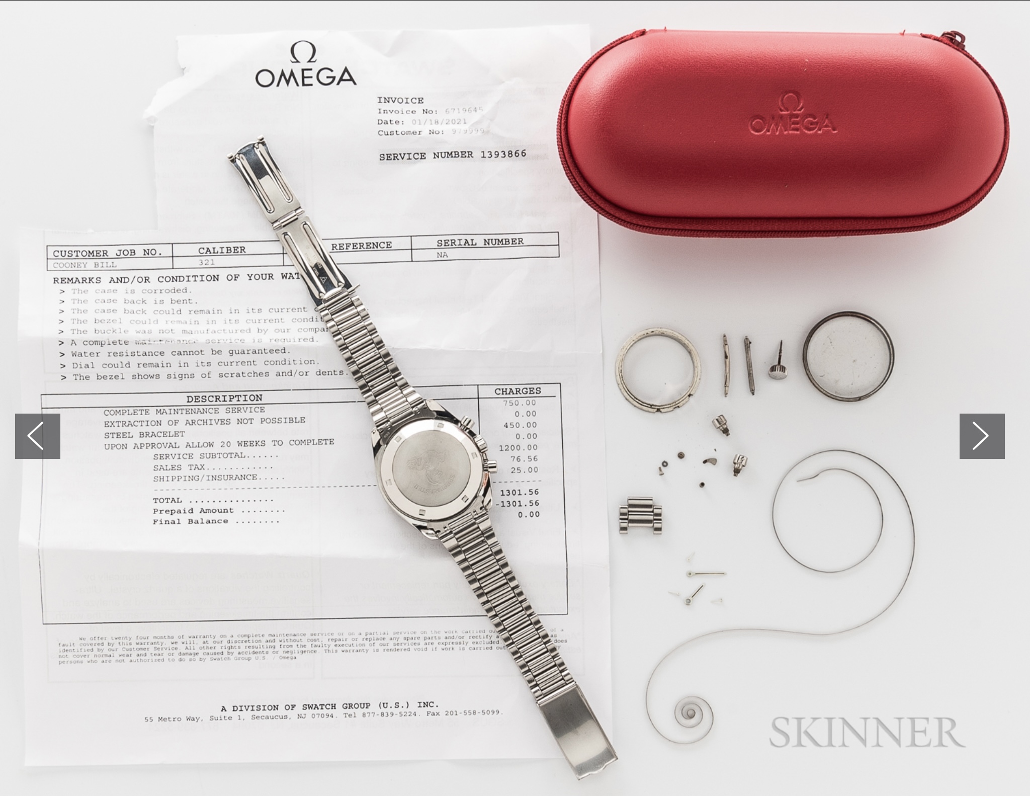

What we are offered is a 145.012-67 with service papers from Omega NY and some parts for a low estimate of $6,000.

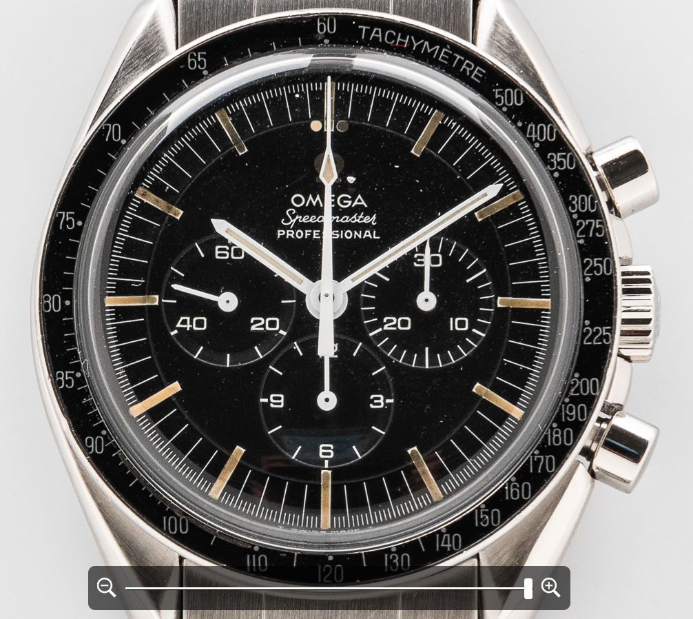

The first thing to note is that the DO90 bezel is present and the dial is also original.
The second obvious issue is the service bracelet.
Always when looking at a speedmaster with any issues (which most of them do) we have to look at price, or value. This watch is being offered at an estimate of $6,000- 8,000. We have to add 25% so 7500 to 10,000.
So now I look to see if there is anything that would stop me buying at this level.

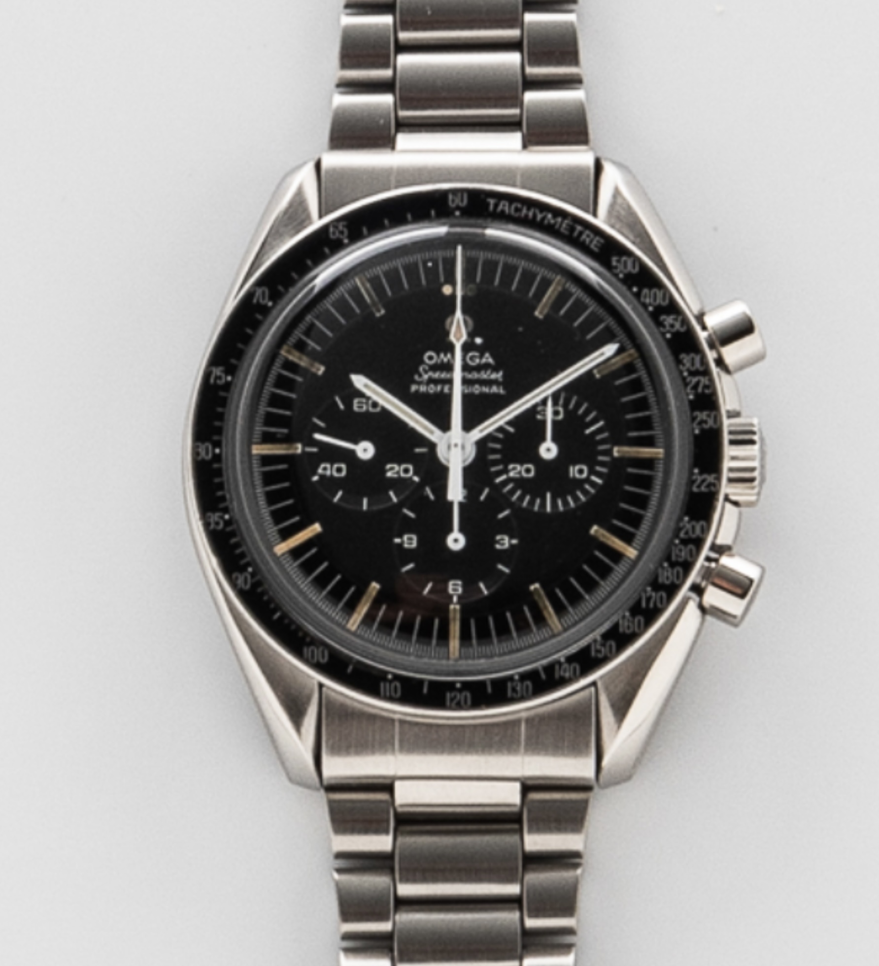

The above photo is not flattering, and I am convinced it could look better with a better lighting. However it does show decayed plots (algae). The hands have been replaced and don’t look right, too white.
The one thing I can say is that it is not an exiting or attractive watch in the way that would make one rush to buy it, but at the right price it could be. We could repaint the hands and that would make a big difference, and remove the incorrect bracelet.
BUT...let’s review the service invoice, there is a lot in there.
There is a wealth of information on that paper, and a big red flag because it mentions that an extract is not possible. So what we have to assume is that the movement is not original to a speedmaster. This knocks the value hard.

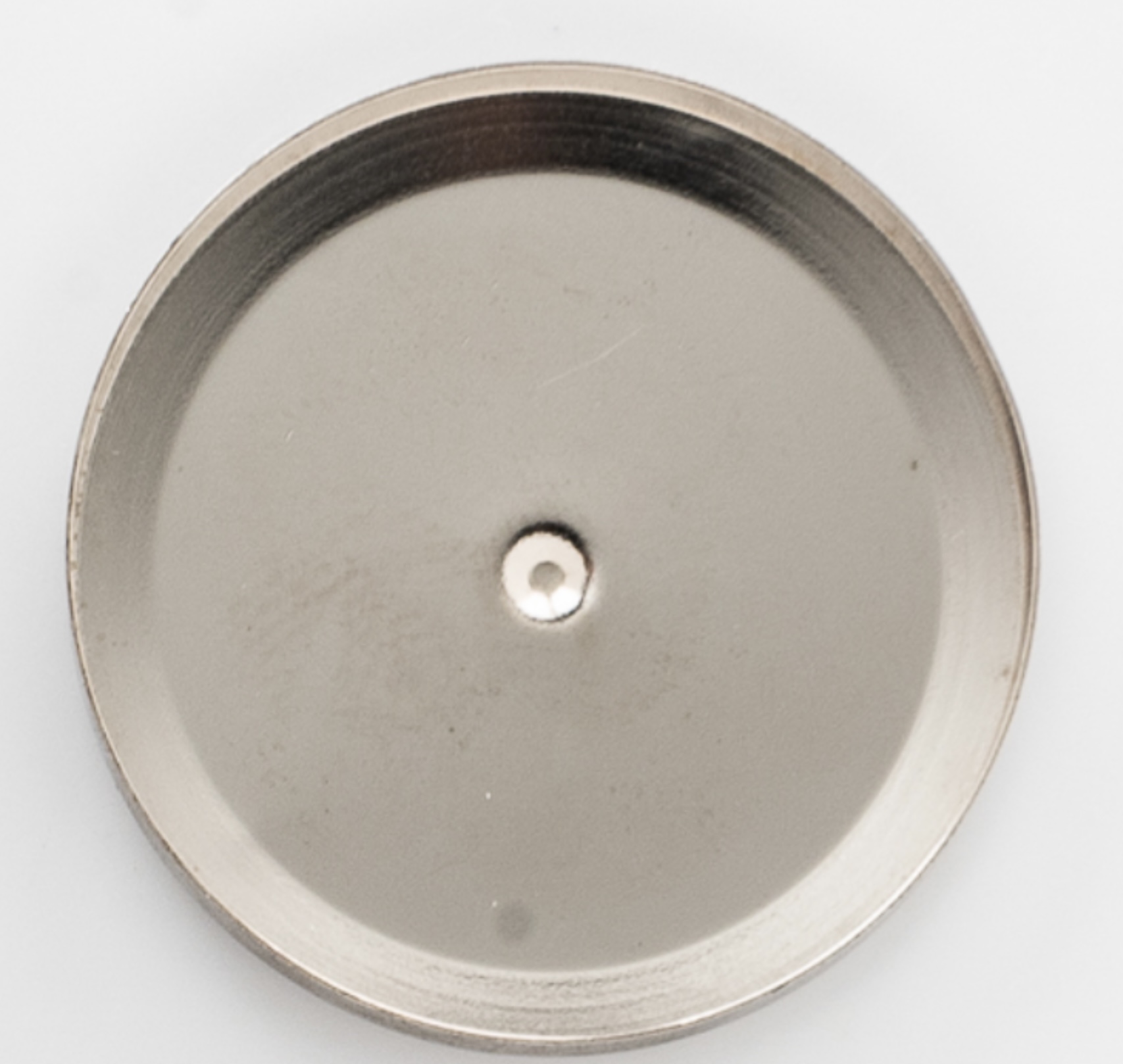

The bent case back mid corroded case don’t help.
In today’s market a $7500 for a 145.012 is something to look at, but I think knowing the extract is unavailable, combined with the decayed dial, corroded case and bent case back this watch will struggle to find a buyer.
and I have not even mentioned the dust cover...

I agree w/your sentiment above, SF. To me, the first thing that stands out is the dial, it's not attractive, then the hands and lastly, the case, which has also been poorly polished. But, as you mention, there is a price for everything. If this was being offered for $5K, I'd definitely think about it to use as a beater watch.

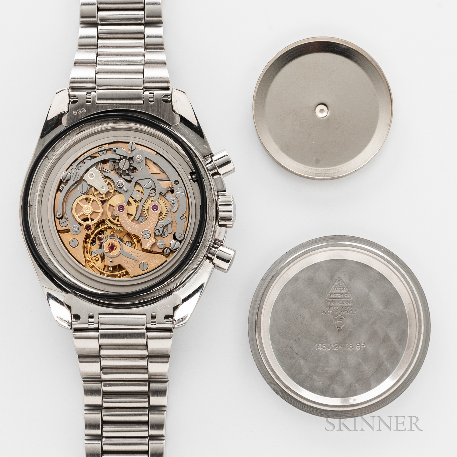

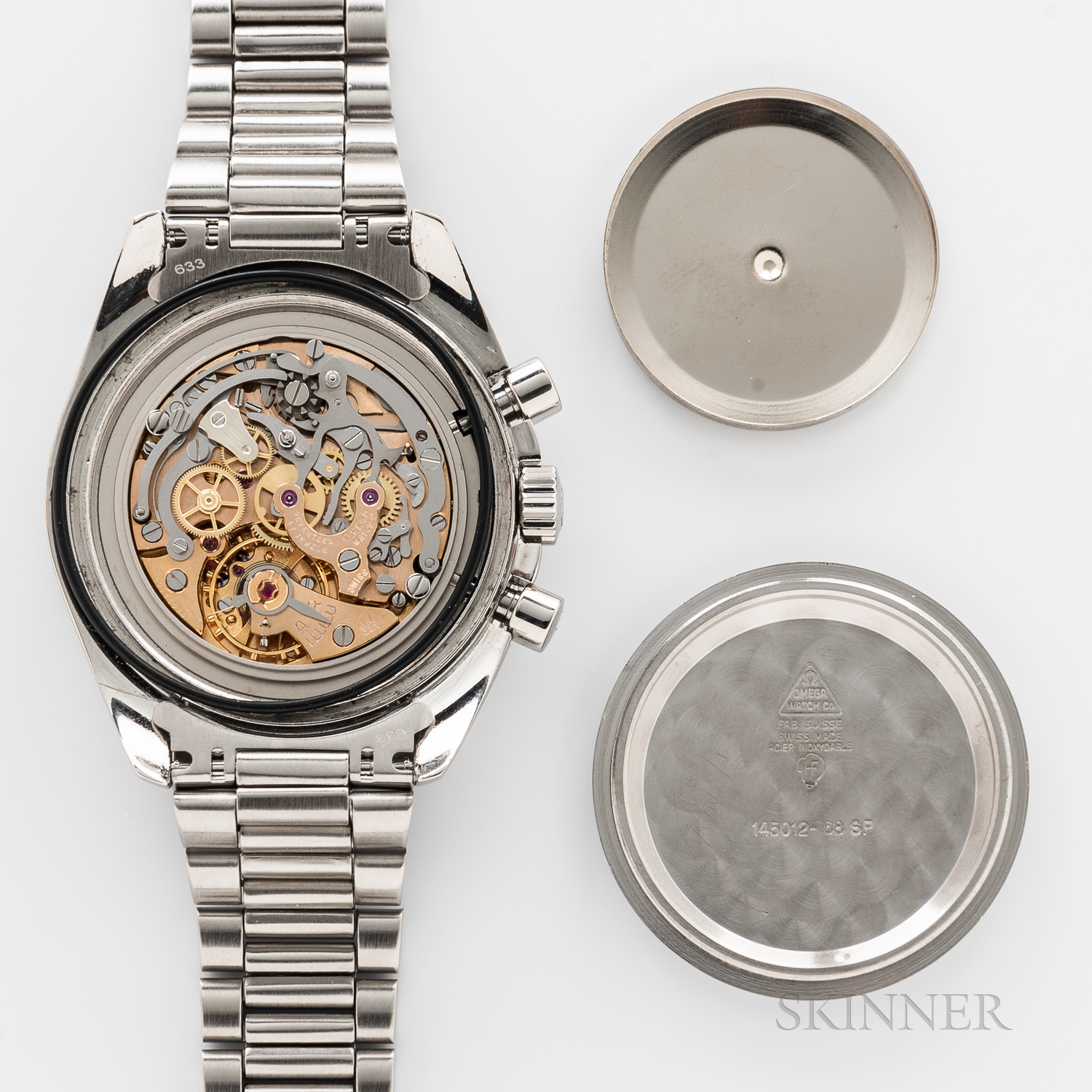

But yeah, first gen movement starting with what looks to be a 19xxxxxx SN (I eagerly await the peanut gallery comments about my vision) ...

Notice the symmetrical clutch bridge. Maybe the movement is from an older model.

Interesting that the plots are darker at the top, and gradually morph to beige at the bottom. As if there was some sort of asymmetrical exposure to the elements.

unattractive dial .... wrong clutch bridge for the reference .... someone really worked on that movement to make it 'look' all same.
Gasket leak at top of case letting more moisture in?
