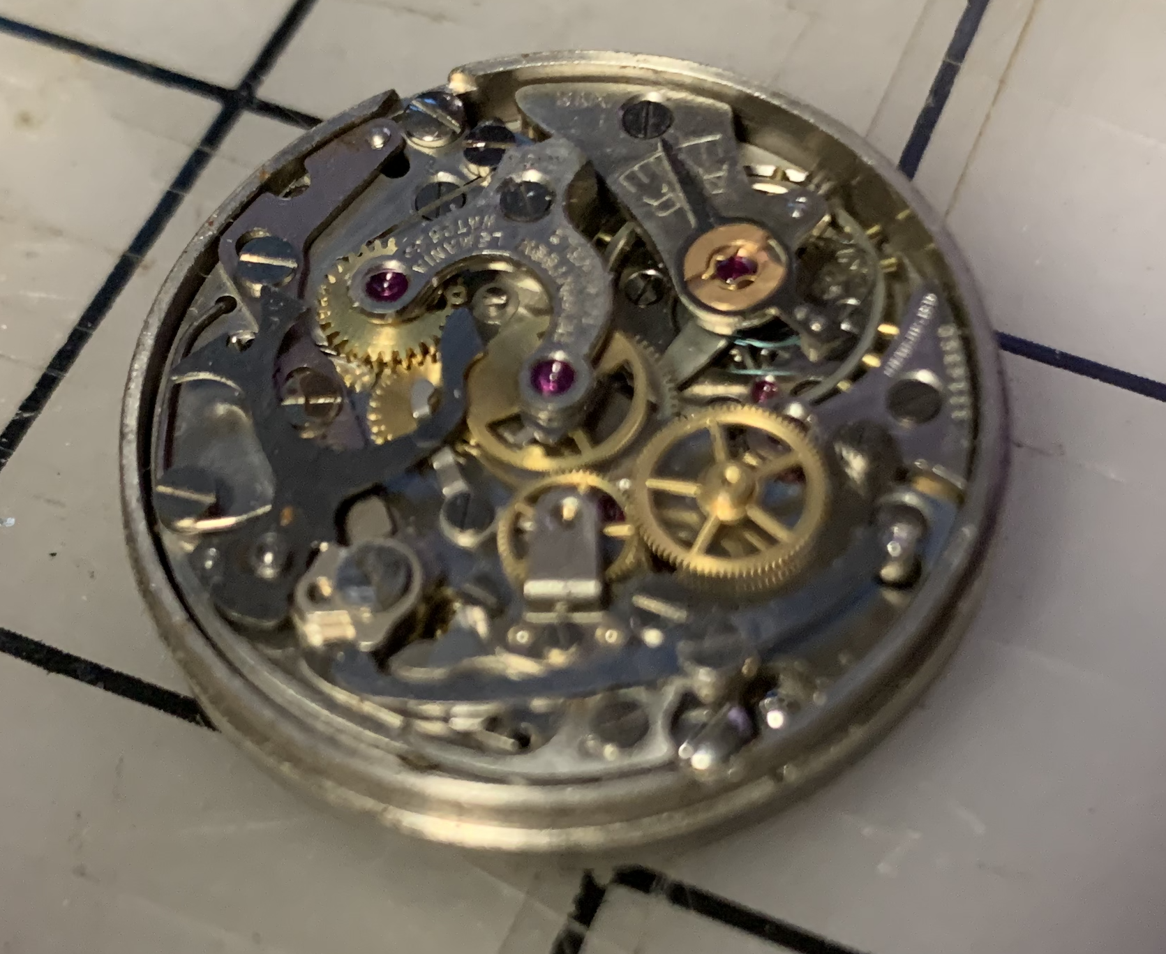

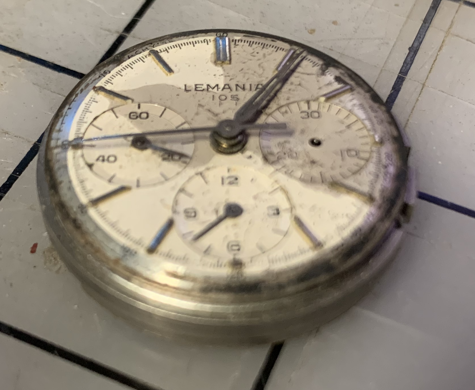

This watch as a bit of a story. When we were at the factory, they said Lemania did not sell watches with a dial marked Lemania. One of the Nawcc members said that this watch was a FAKE. becouse of that. His attituse was a lot of the reason I left the Nawcc. I think he has passed on now as this was over 25 years ago.
The stained dial is how I got the movement. I was thinking of attempting to clean it, but after watchin some you tube videos is seems that attitudes on these old warhorses have changed.
This movement is also a lot smaller than the CH27 c12 derivatives.
The movement itself is in pretty good shape. I am using my cellphone for these photographs as I have yet to set up the camera I bought last week for macro photography.
If anyone knows the caliber off the top of their head It would save me time looking it up again.
This is a movement I would love to case up again. Lemania is one of my favorites and what inspired me to collect in the first place. Not really sure how one would go into looking for an appropriate case for this. Quite possible that the case was scrapped out. I would be wanting to put it into something plain and simple like stainless steel.
Edit: the background grid is one inch (25.4mm) so it can be seen how small this movement is.

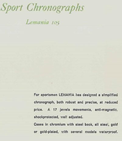

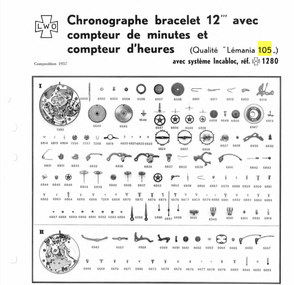

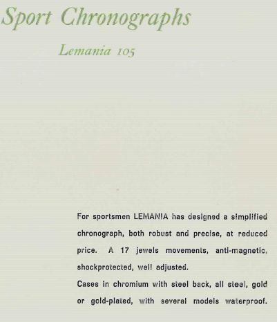

Hi.
The giveaway to the caliber designation is the number 105 on the dial.
The above are from the Lemania fourniture catalog and from a 1956 UK dealers brochure.
Your caliber 1280 movement would be 27mm in diameter and is a simplified caliber 27CH-C12 (25xx).
