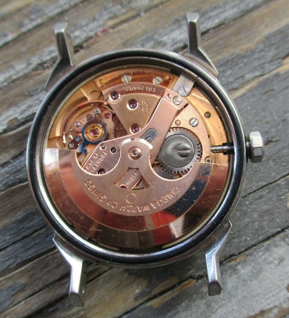

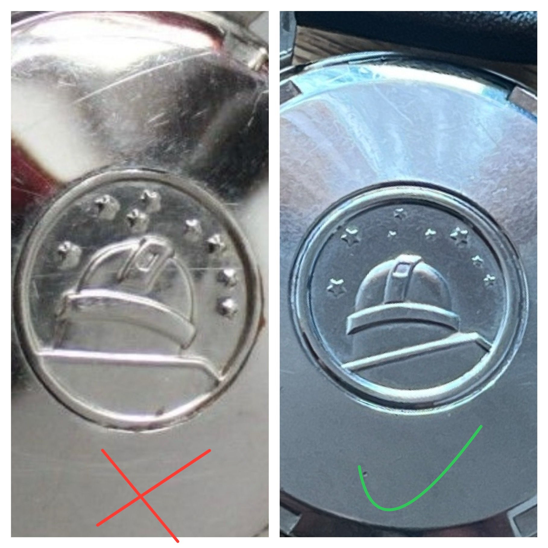

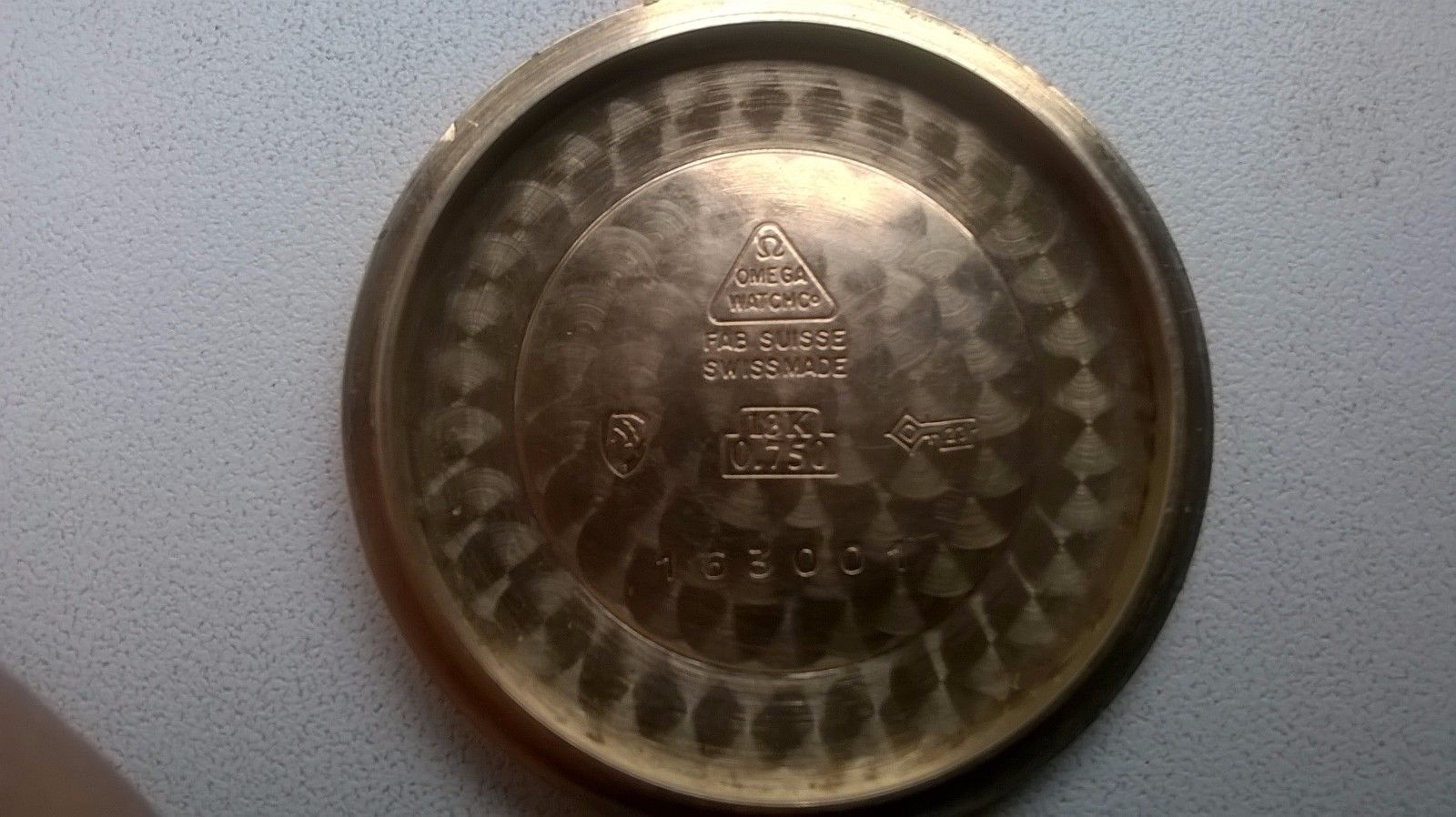

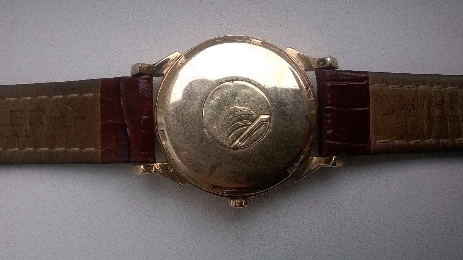

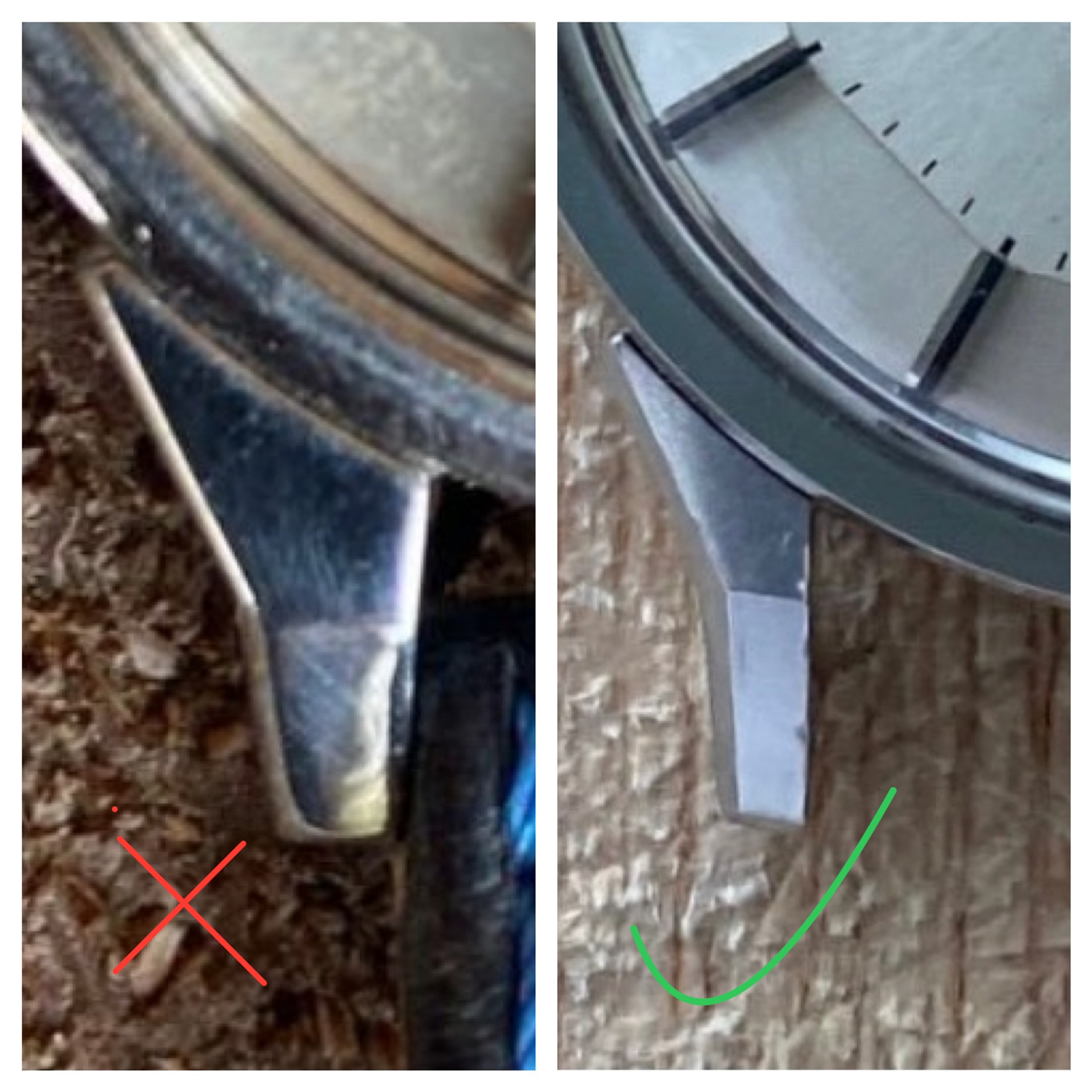

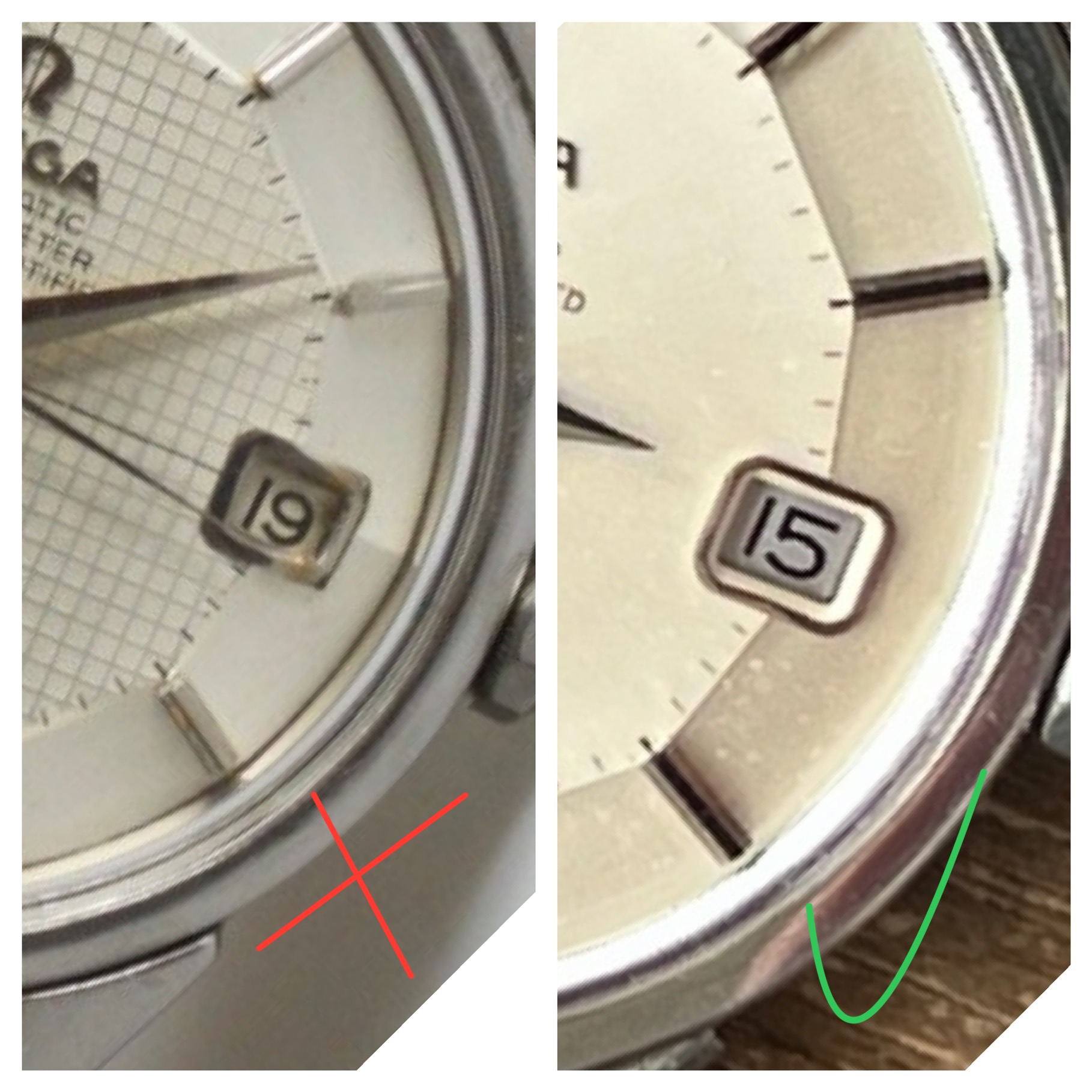

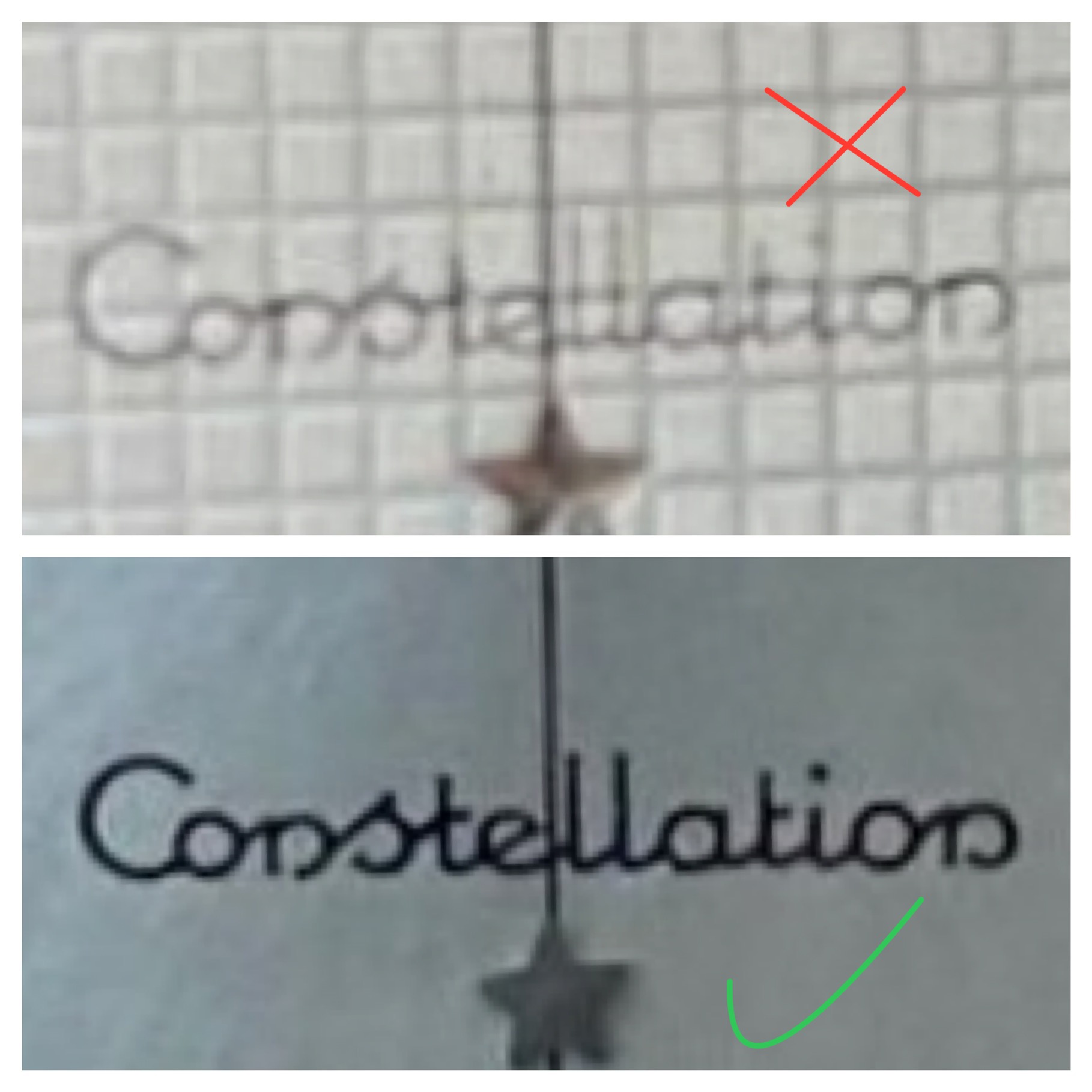

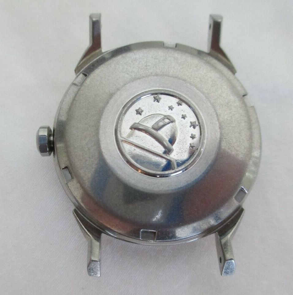

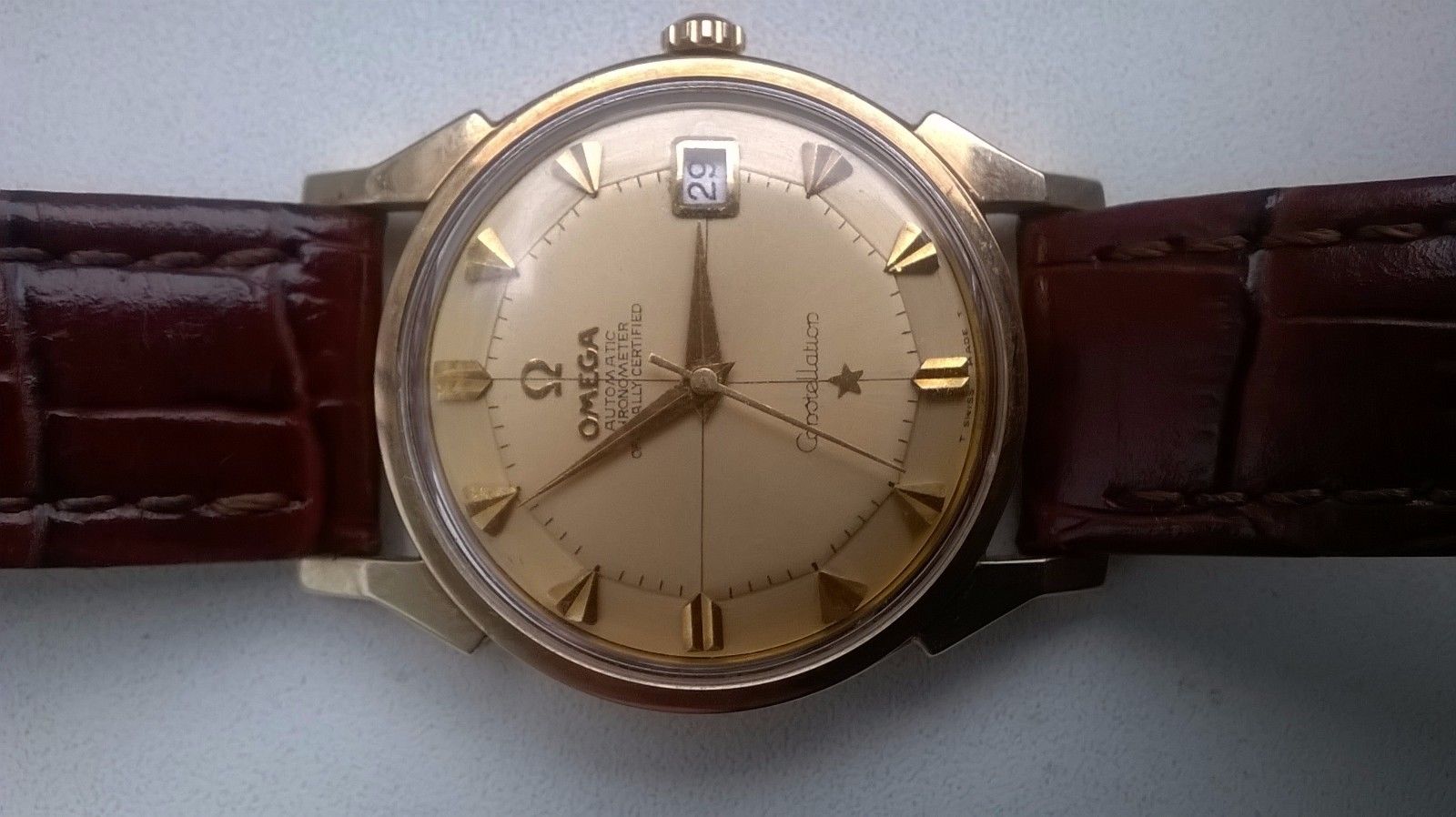

Posts 3,592 Likes 13,544 MtV ·Jan 25, 2023 X350 XJR The only genuine part is the movement and it's incorrect for a Constellation. This sums it up quite nicely. What a piece of garbage. Someone will get burnt on it, and most likely it won’t be just one person. A few comparisons to make this a little easier for anyone in doubt:
Posts 6,829 Likes 10,498 Peemacgee ·Jan 25, 2023·Purrrr-veyor of luxury cat box loungers We haven’t had one of these ‘spot the difference’ games for a while but they are always worth posting for old and new members alike. well done @MtV 👍

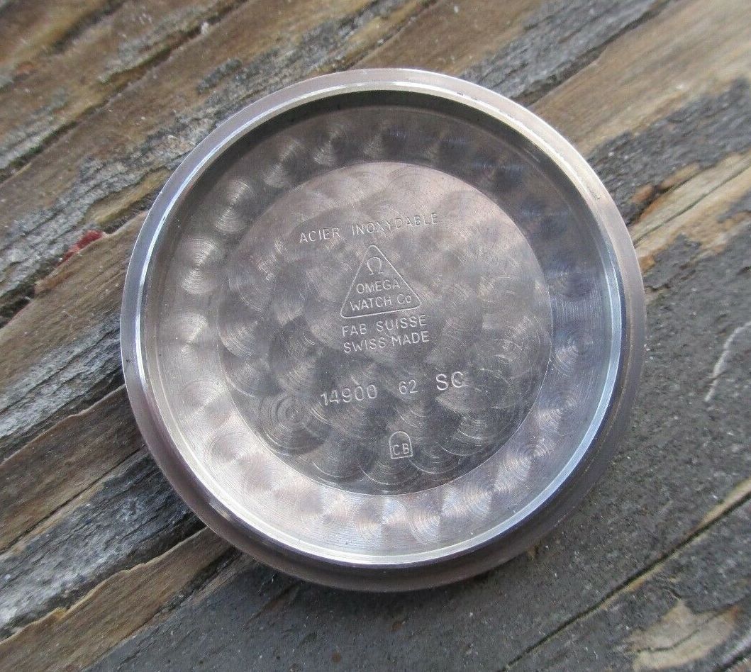

Posts 6,829 Likes 10,498 Peemacgee ·Jan 25, 2023·Purrrr-veyor of luxury cat box loungers Difeer I love those extra big stars on the caseback so much 😁 This is a good call on SS and gold cap cases but be aware that you will find ‘generous’ ( huge) stars on English and French solid gold case medallions.

Posts 699 Likes 701 blueteg ·Jan 26, 2023 Lots of good info in here, particularly with the photo comparisons. 📖 Thanks @MtV

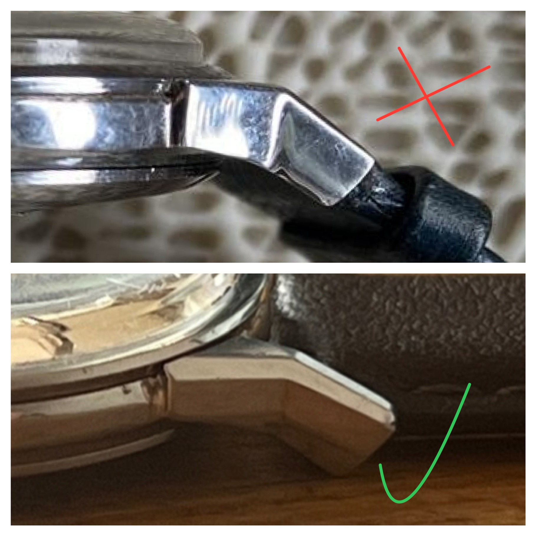

Posts 3,592 Likes 13,544 MtV ·Jan 26, 2023 RevZMan123 Did they BEND THE LUGS of another reference? It's just a fake case, I believe.
