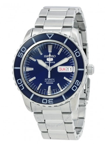

    That watch is now in my shop and I thought I would post this in the open forum so we can get more input.
    So my first impression right out of the box is that this is a very good looking watch, and I wondered if Faz would let me keep it! :) I don’t have a blue dialed watch, and this one is a very nice blue – not too in your face but not too subtle either.
    So let’s look at the exterior first. I don’t know what grade of steel Seiko uses, but the finishing on the case is quite nice. The top surface of the case is a simple circular grain, with polished facets on the lugs, and a straight grain finish on the case sides. Looking at the polished areas with a loupe, I can see what in car terms would be called a bit of an “orange peel” effect, so it’s not as smooth and perfect as I’m used to seeing on higher cost watches. From the way I look at things all the finishes on this watch should be easy to reproduce, or in some cases even improve, by any watchmaker who is proficient at case refinishing.
    Some photos:
    [​IMG]
    [​IMG]
    [​IMG]
    [​IMG]
    The crown is large and easy to grip, but has no logo on it, which I found odd. I did note that when screwing the crown back down, on a coupe of occasions it didn’t catch right and I had to back the crown up to get the threads started – something I don’t normally find I have to do actually.
    The bezel is easy to turn – maybe too easy, and despite the fact that the ratcheting of the bezel feels very imprecise and somewhat wobbly, when you back the bezel up to a hard stop the bezel lines up perfectly with the dial, so marks for that. But the feel of the ratcheting doesn’t inspire confidence. The bezel insert is very nicely done, and in that previous thread someone mentioned that it might be metal that has been lacquered over. I’m not sure of the exact process but in any case it’s very nice, but how durable it will be over time remains to be seen.
    The sapphire crystal is nice, has a slight dome, and appears to be AR coated.
    The dial and hands are well executed, however some small details are missing. The hands are simple and flat, with no angled surfaces on them as some other brands may have. The markers on the dial are well done, but again are rather flat and plain.

    Since this ended up being a very long series of tests, I'm going to stop here, and will post more in the coming days about the remainder of the testing and my observations.
    As always, questions are welcome.
    Cheers, Al
