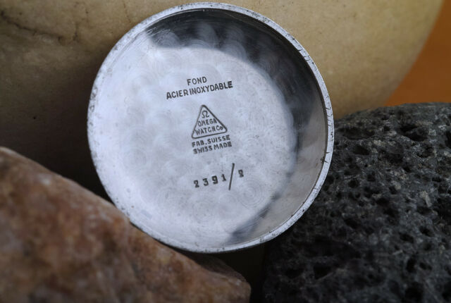

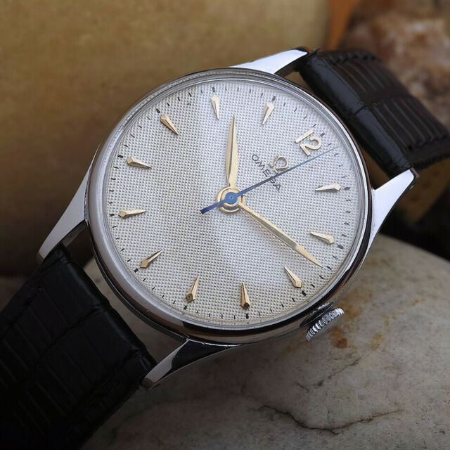

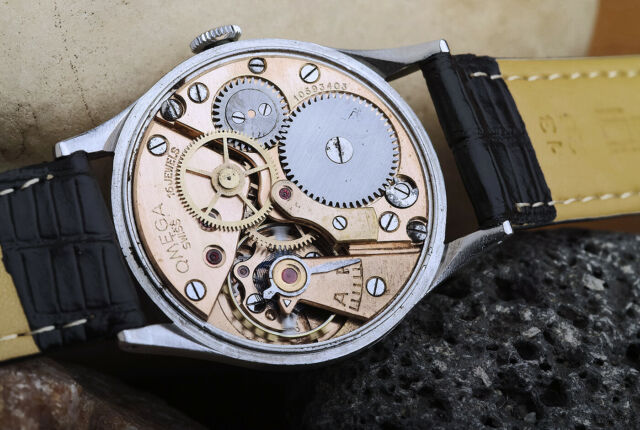

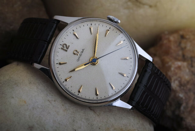

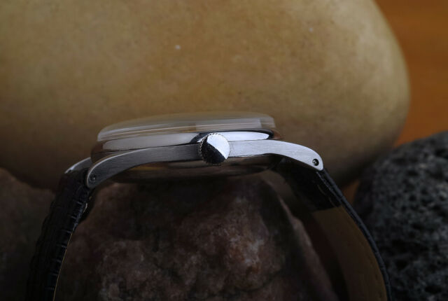

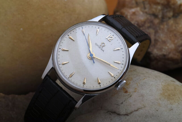

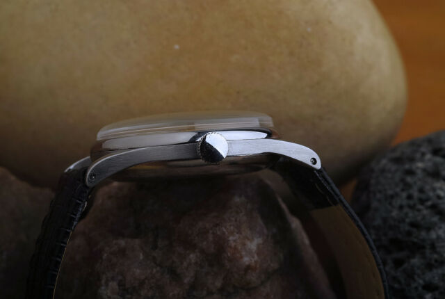

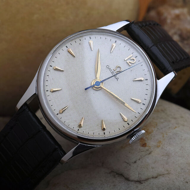

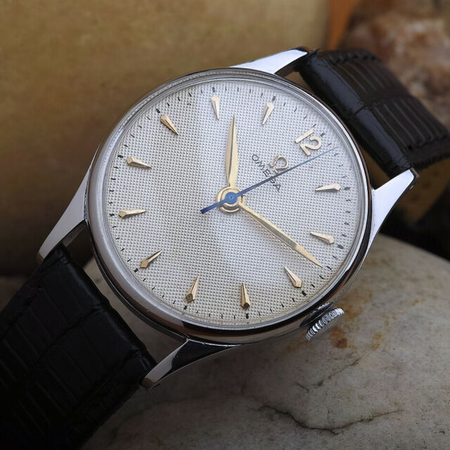

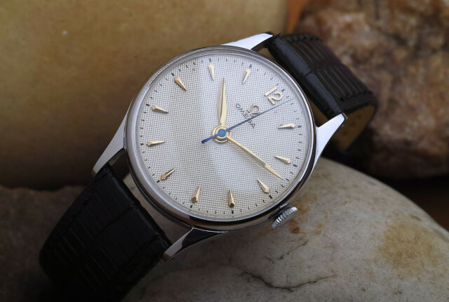

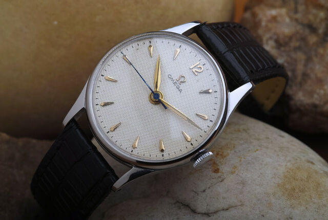

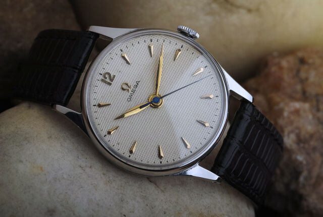

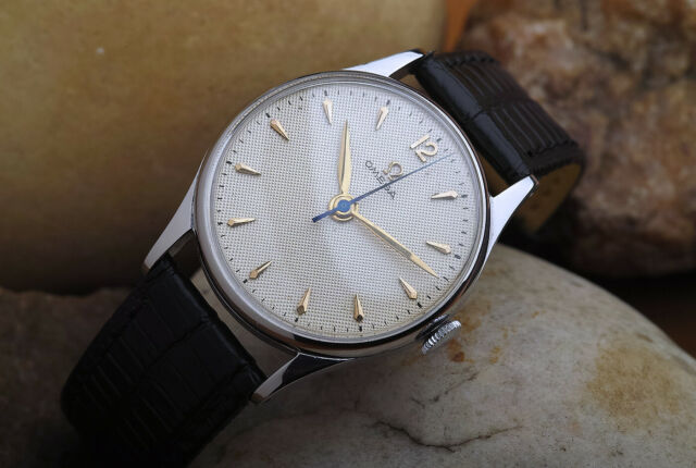

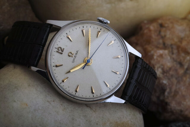

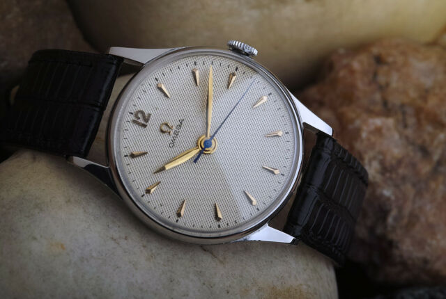

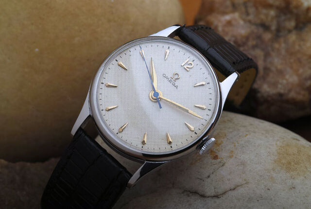

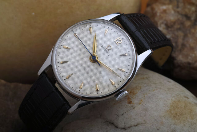

Hi, I've seen this watch on eBay, which seems to be a quite rare version of 30T. It's the first time I see the model and I cannot find another pic on Google.

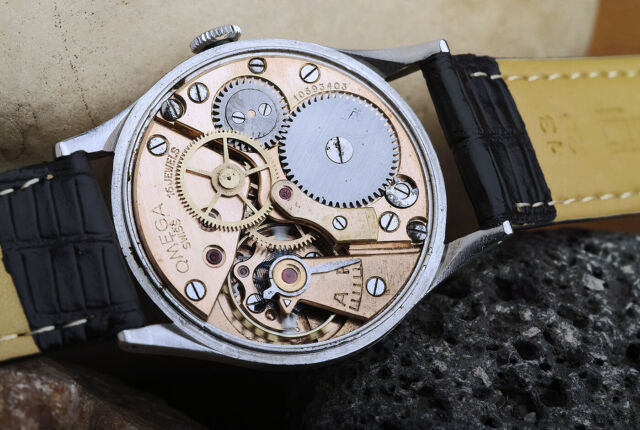

The caliber should be 282 30T2 SC PC with 16 jewels. A service might be necessary according to the dirty looks.
Is this a good piece worthy of 688 USD? Thanks.

I'd say it's a redial with dubious hands. I might be wrong though...
judging by the photo it is not a 282 nor a 30T2 SC PC... this is a regular 30 T2 SC - no PC which means shock absorber, clearly absent ...

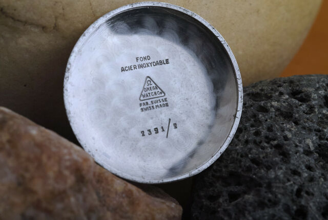

I had the same reaction, for what it's worth, the watch just doesn't look right to me. Feuille hands could be correct, but not those hands, they are the wrong shape; I'm not even sure they are Omega hands TBH. The dial appears to have alignment problems, especially with the "12" (although a straight-on shot would help), the minute track looks a bit too sloppy, and no SWISS or SWISS MADE. I just have a bad feeling about it. Also, based on the case-back markings, this would appear to be a chrome-plated case (or perhaps bezel?). If so, the plating looks like it's in good shape, but I would definitely prefer to find a full SS case.
