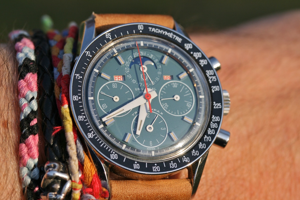

    Here is an old photo of my teal baby, no longer mine, but gives you an idea of what it should look like..
    Cheers,
    David

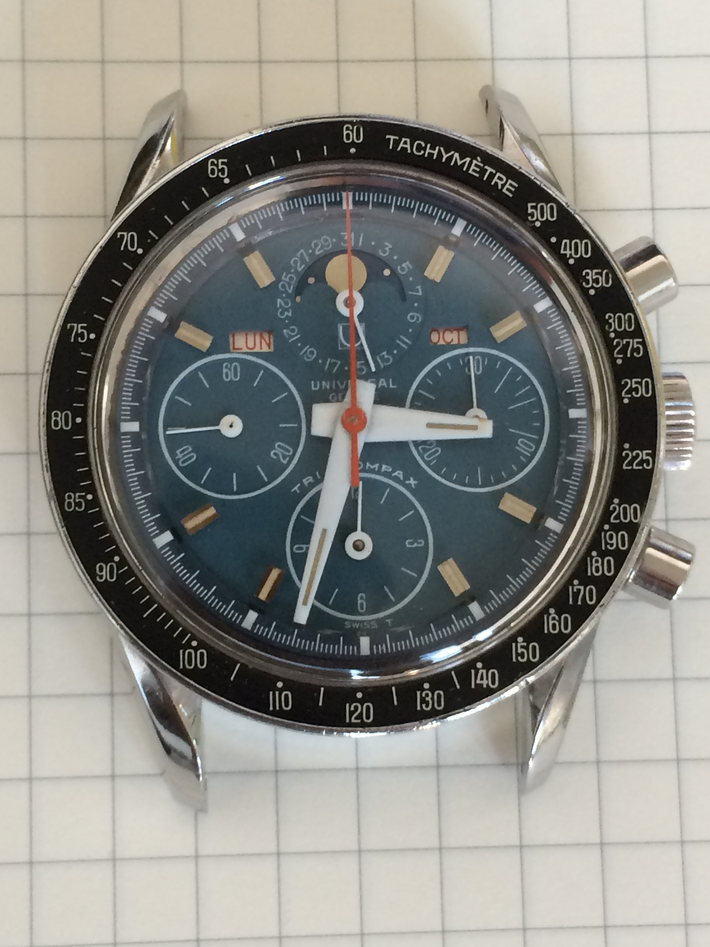

  11. avantnoire Feb 21, 2014
    106
    108
    Here is a crystal logo shot...
    D

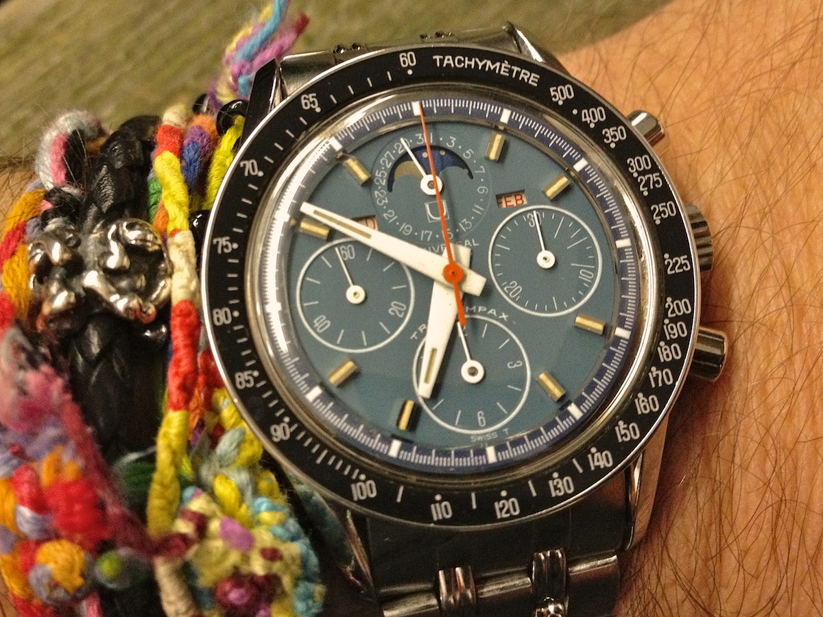

  12. avantnoire Feb 21, 2014
    106
    108
    And lastly, the sun on the dial shot..
    D

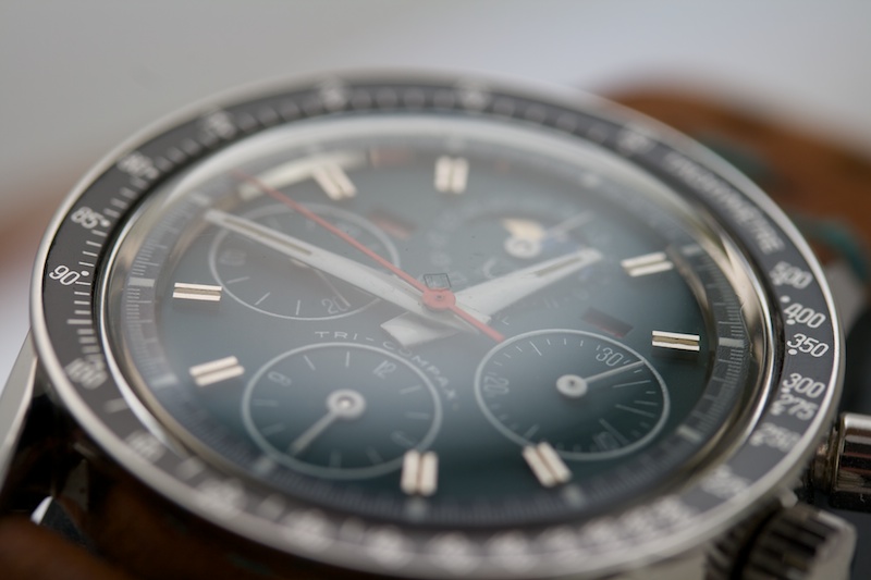

  13. woodwkr2 Feb 22, 2014
    1,366
    819
    You inspired me...
    Sadly she hasn't seen too much wrist time of yet... haven't had a chance to fix a fiddly issue with the hands yet.
    *Wrist shots to follow at some point.

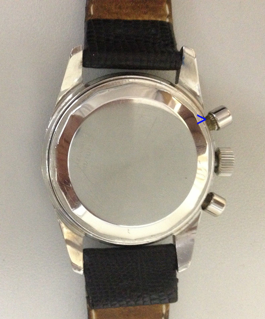

    Before anyone gets too excited and rushes off an over-expensive bid... just thought I'd point out that the original watch in question may or may not have an expensive problem with one of its pushers.
    Virtual high-fives for whomever can spot the easter egg first.
    ELV likes this.
  15. ELV Feb 24, 2014
    14
    I think no one is up to the challenge, would you care to share?

  19. woodwkr2 Feb 24, 2014
    1,366
    819
    Bingo!
