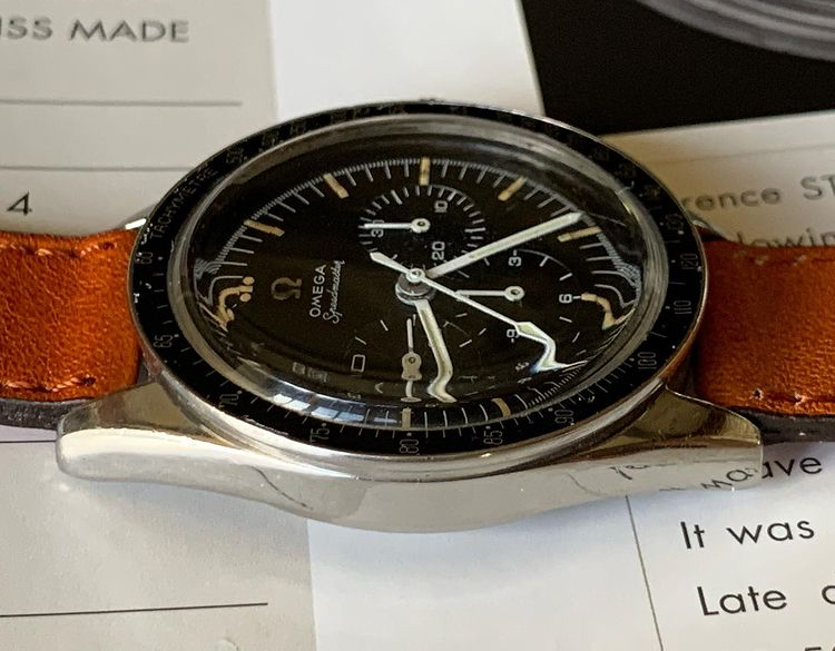

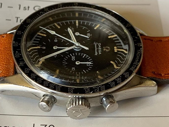

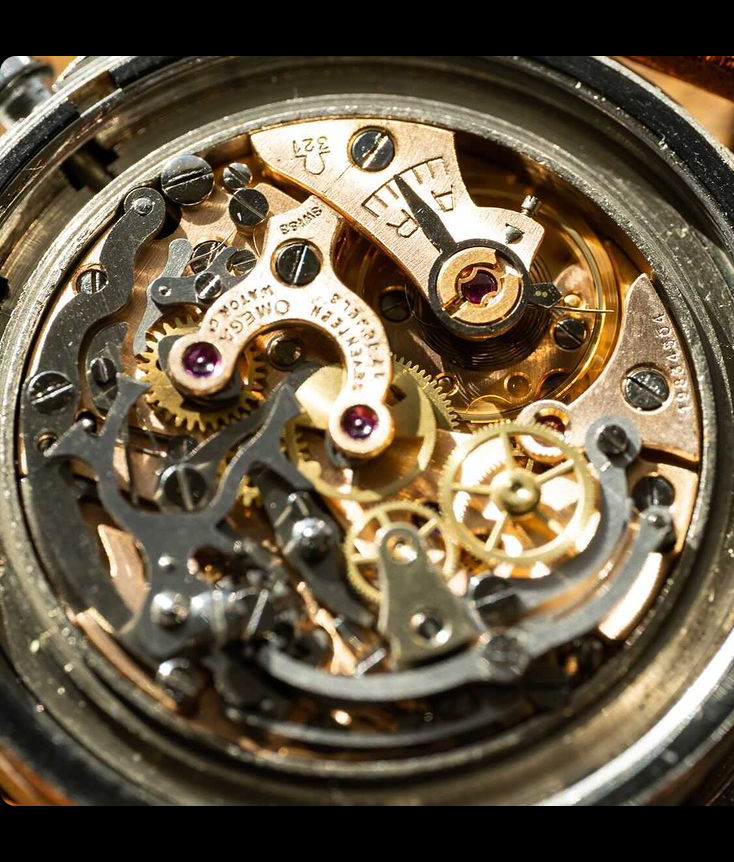

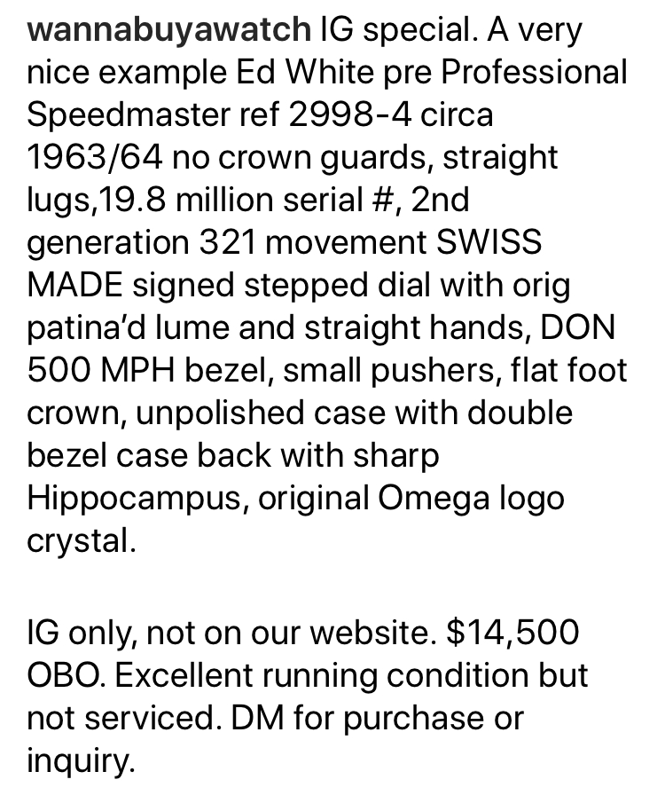

i saw this 2998-4 Speedmaster for sale on Instagram this morning. At first glance the price of 14.5 OBO seems very fair... but, all isn’t right. No images of the movement or inside of case-back, the hands are baton and the movement number is listed as 19.8, a little high for a 2988-4, more likely a 105.002-62, maybe a 2998-5.
A 2998-4 should have alpha hands and thin baton or possibly a lollipop chronograph hand. Hands have been questioned on IG.
All the more reasons to do your due diligence.
Thoughts on this one... and, no, I’m not buying.

Über-polished caseback.
Obvious wrong hands. Sweep second hand seems too short.
Damaged 12' lume plot.
No silver rehault on the service crystal.

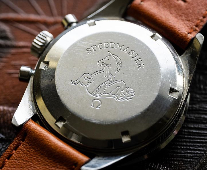

No pictures of the movement nor of the inside of the caseback.
Maybe a good price for parts.

It's pretty clear that the hands aren't original.
Let alone that minute hand that is not Moonwatch hand. 👎

I found this all perturbing as I know the dealer and I know he has the book, "Moonwatch Only" in his library. It was so obvious that so many things were wrong with the watch, as stated... the hands, the damaged lume plots, polished case, minute hand not even a Moonwatch hand, the movement number associated with the reference, and, finally, no movement or inside of caseback images.
Why? Yes, I know the answer.

My guess : complete built-up watch from parts. Maybe not even a Speedmaster movement (321 Seamaster ?)...

As my eyes are getting better for this sort of thing, I think I can confidently say now that that case has been polished quite a bit.

Dealer sent me images of the movement and the inside of the case back and I responded with this DM
“Definitely concerns about watch as a 2998-4 should have alpha hands and a thin baton chronograph or lollipop hand. The movement number is out of the range of a 2998-4, and indicative of a later reference. The minute hand is not a correct Speedmaster hand as the lume is way too short, should extend almost to the base.
If you have reference book “Moonwatch Only”, compare images of the 2998-4, and movement numbers.”
Dealer replied," I see, we do have the book in the shop and I will check it when I'm in on Tuesday."

Like I said I know little about Speedmasters. Reading this thread I didn't really see much complaining about the actual description the OP posted (with the exception of the "unpolished case") but more about the originality of the watch (which is not mentioned in the listing). Collectors won't touch this watch because it was built with parts, but it is still a "nice" watch for those who don't dwell into the minutiae of originality.

Hmmm, how about the ad identifying it as both an Ed White and a 2998-4? I didn't bother reading closely past that one, but I did also chuckle at "500 MPH bezel" (the wording -- never seen one identified like that). I was surprised to see such a description from a regular seller.
