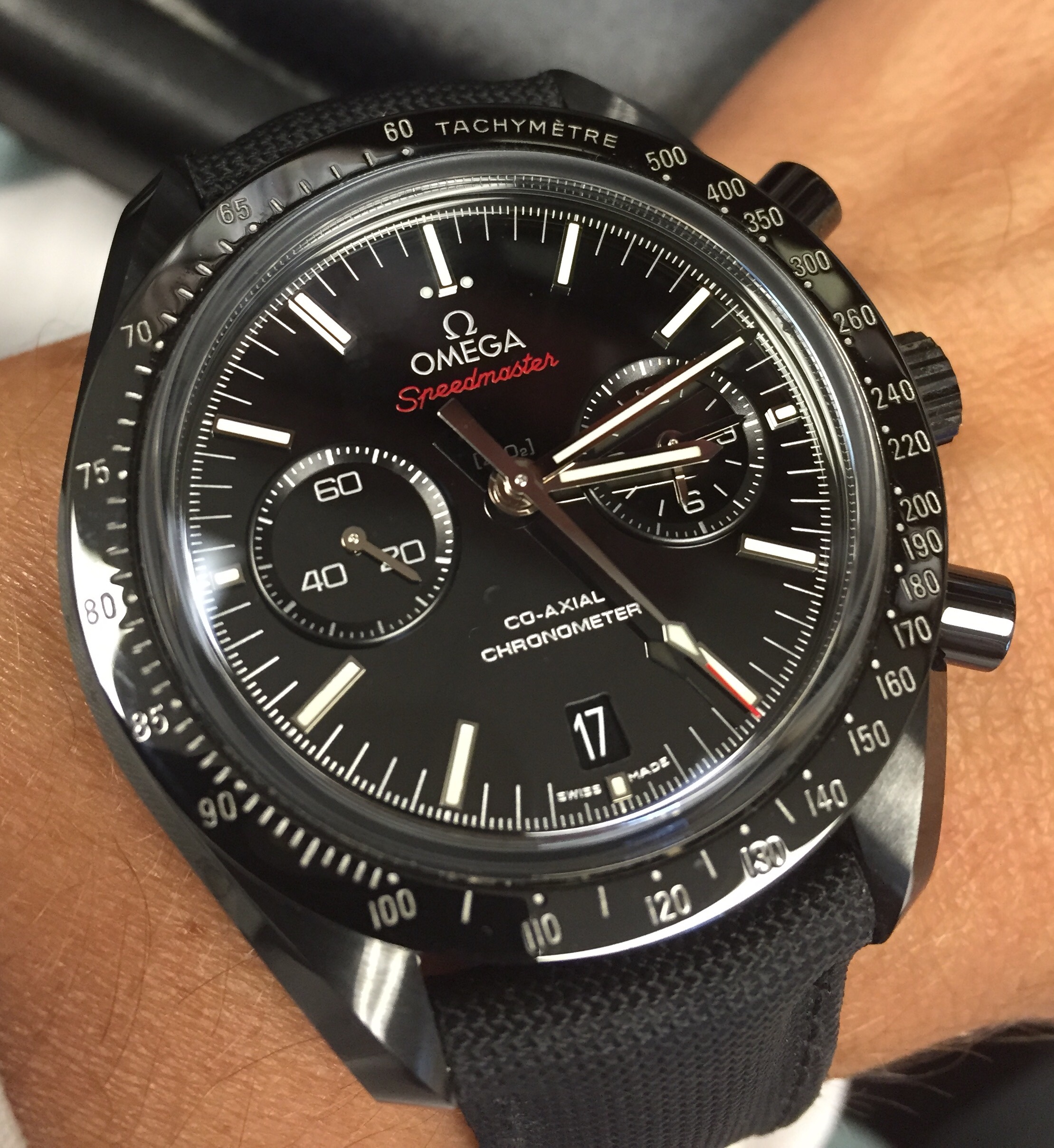

I recently purchased a new Omega 9300 caliber Dark Side of the Moon. I don’t wear the watch every day and I often wind it for extra reserve power. I find that after about 36-40 hours of not wearing it, the watch stops. Can anyone explain this? The watch is supposed to have 60 hours of reserve power. Thank you.
