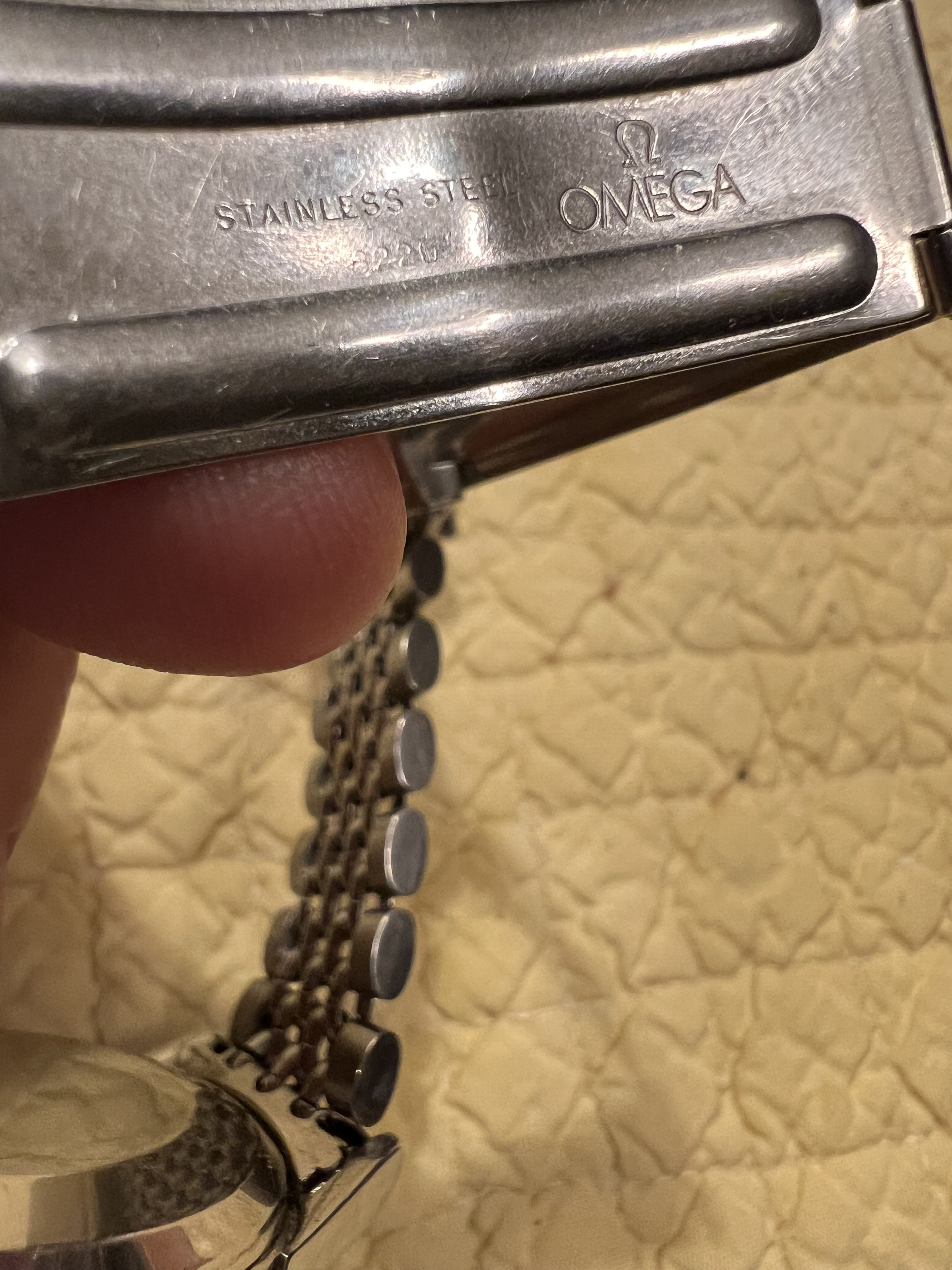

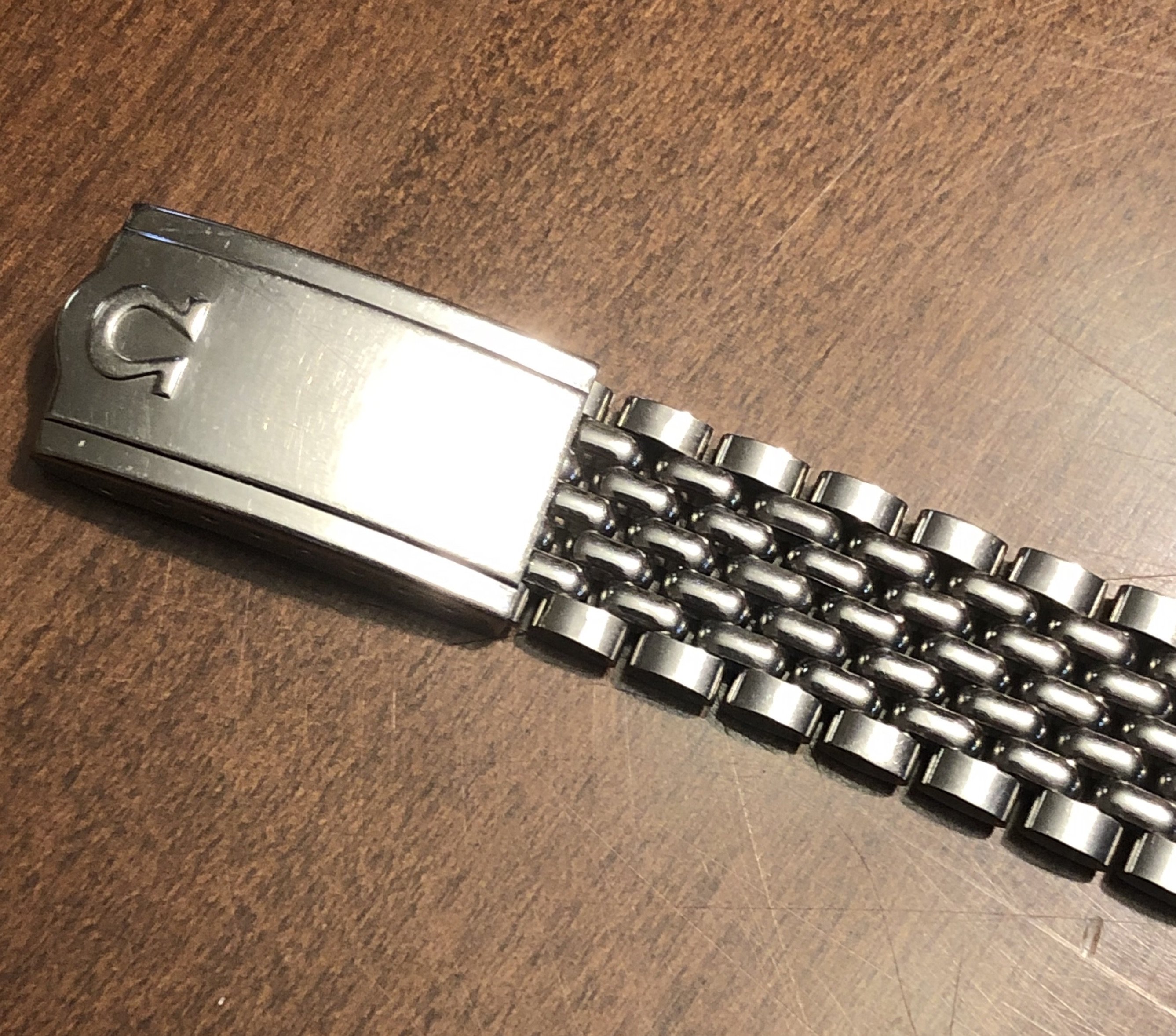

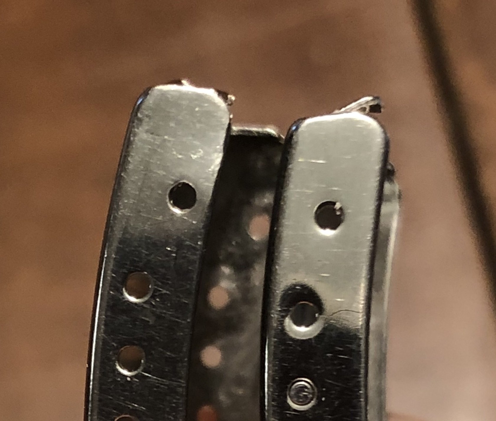

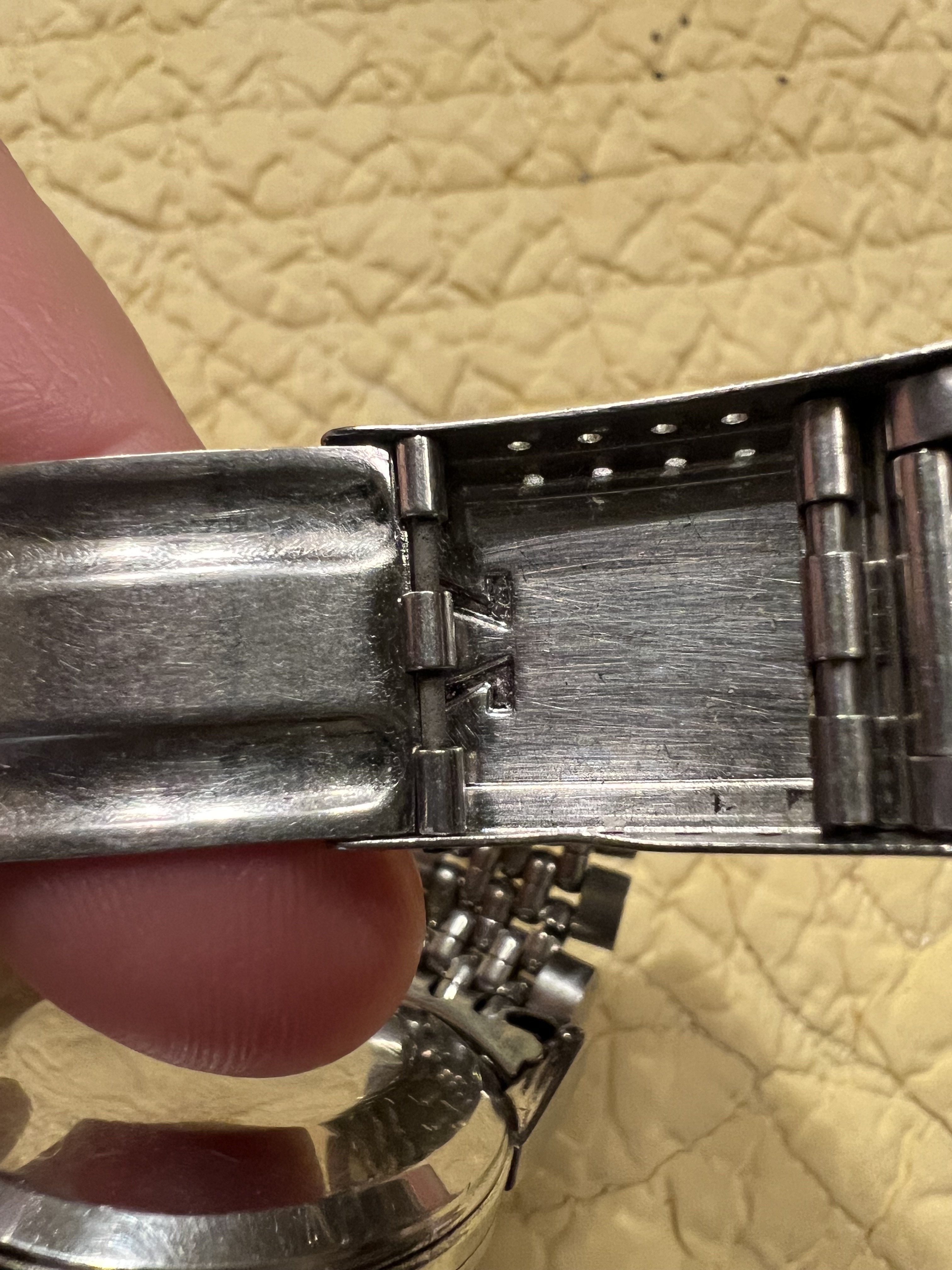

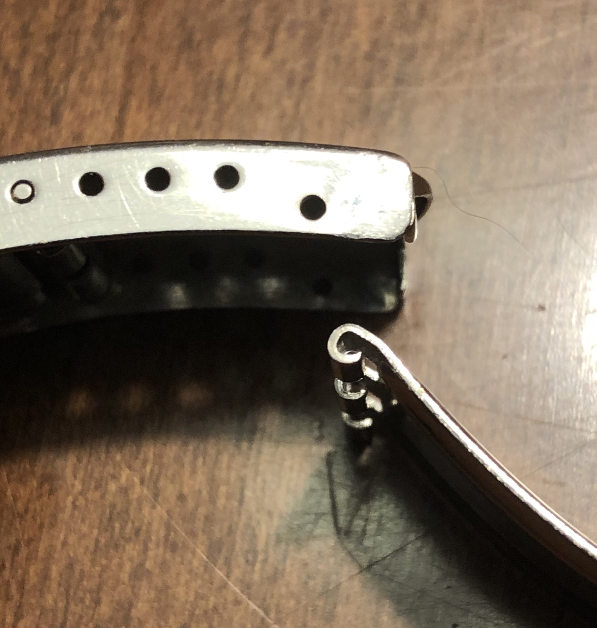

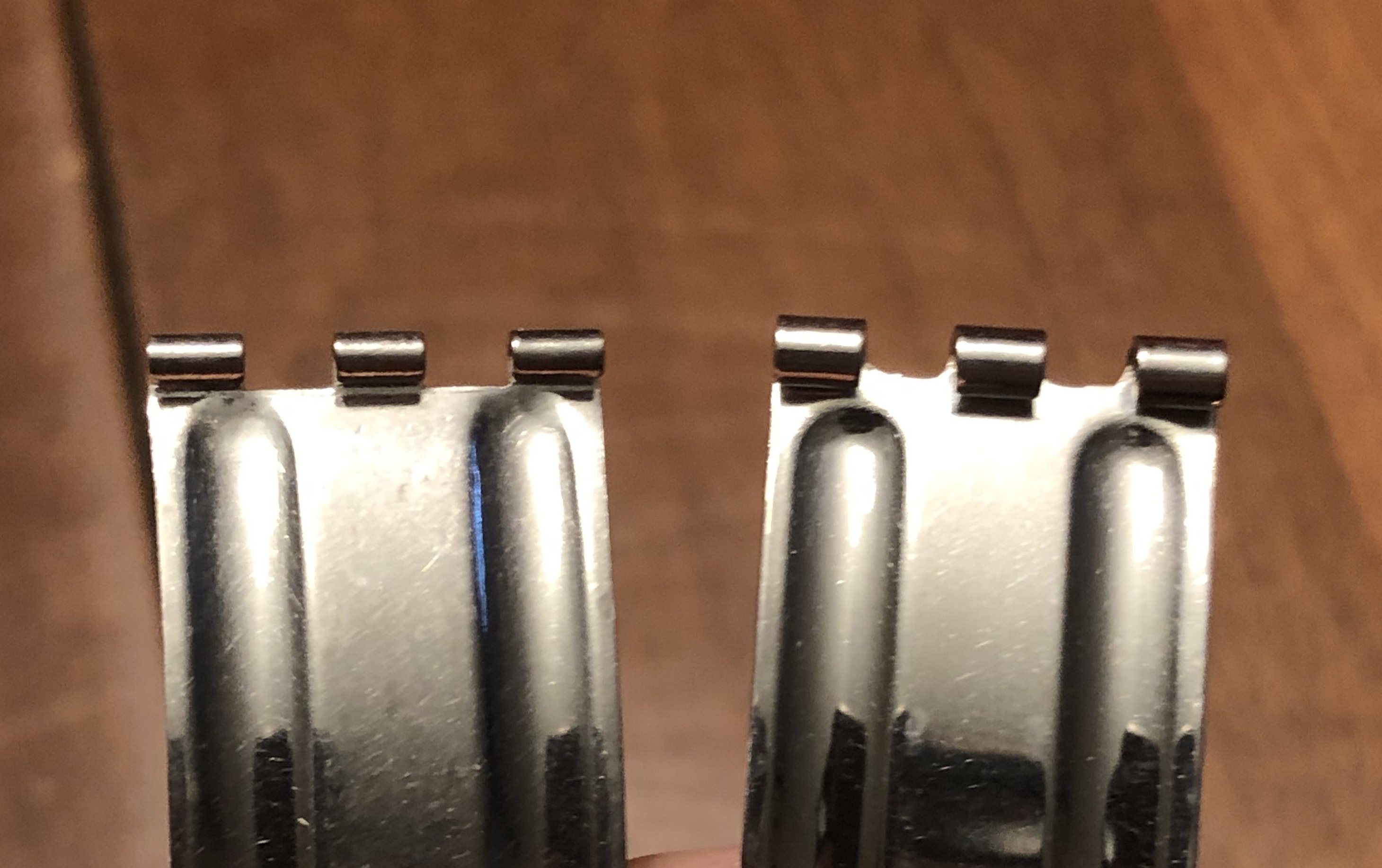

I recently received an 8220 that is missing the pin to attach the blade to the clasp. In my 1502 and 1036 bracelets, they are attached by a springbar, however, the loops at the end of the blade are too small to accommodate a springbar in the 8220. I am thinking that perhaps a press-fit pin is used, or maybe a rivet. The clasps are the same. Does anyone have an 8220 bracelet to check. Many thanks.
8220 on left, 1036 on right.

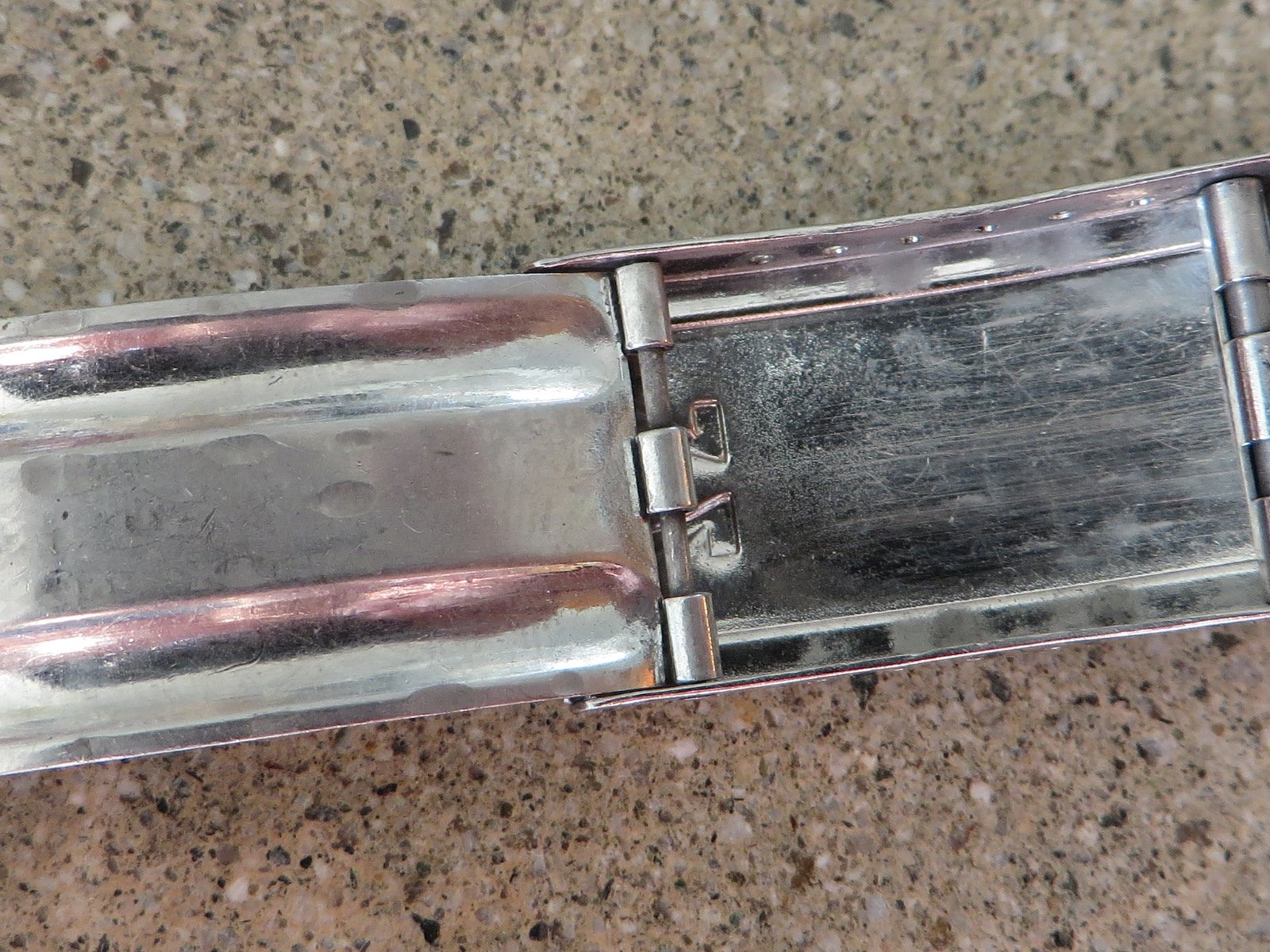

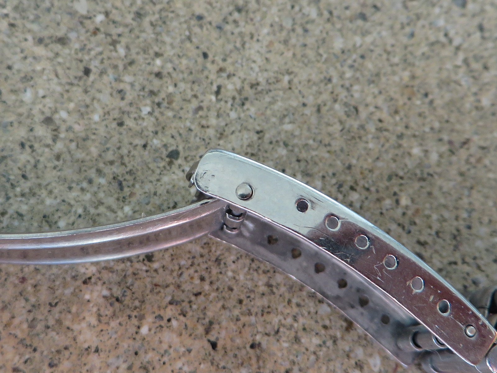

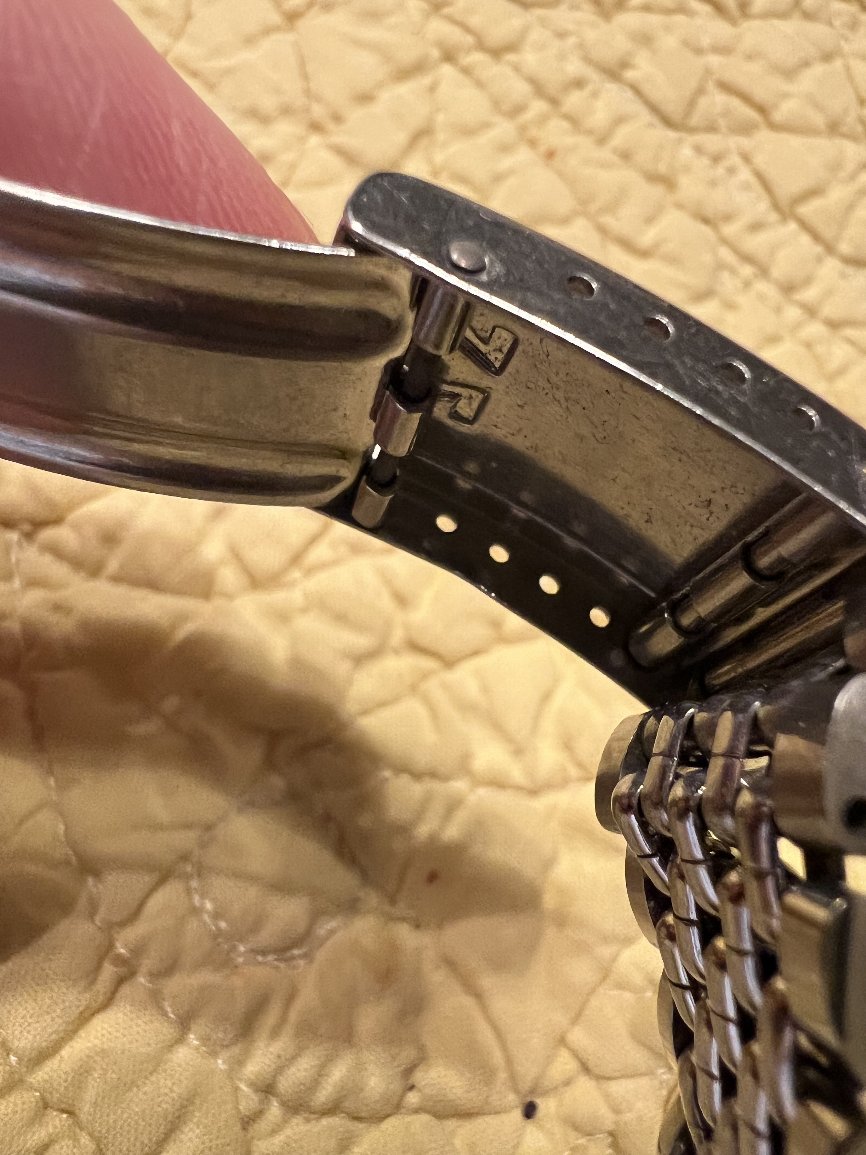

The first one I pulled out has a headed pin/rivet 1mm in diameter, but I know I've seen them with a straight headless pin as well.

That's great info, this should be an easy fix.
